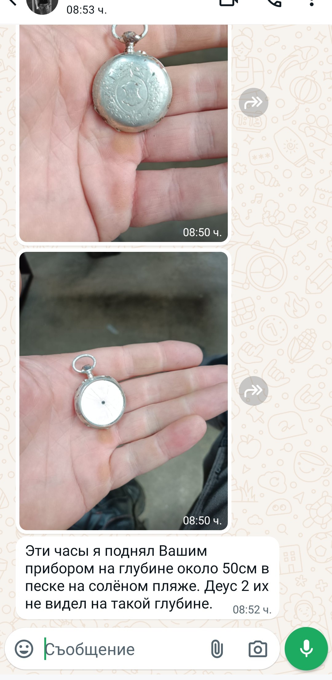

                  Posted by a Ukrainian living in France. A silver watch found on the ocean shore 50cm deep in the wet salt sand.
                  And many more similar reviews from people for whom it doesn't matter who thought what about this detector.
                    LRL dowsing has survived as a human activity since prehistoric times.
                    Why?
                    Well, it sometimes happens that someone manages to "locate" something with dowsing rods and similar devices.
                    The "fact" that someone somewhere found something with "something"... a very strong argument!
                    At the same moment, I changed all my life attitudes when I heard about that fact!
                    And now I have decided: I BUY!
                    ....... Minelab....!
                      I wouldn't laugh at anything until I got to know it in detail. That speaks of immaturity! What you have decided is your personal business and hardly anyone cares.
                      Smart people are mostly interested in the performance of a detector. Others look at how beautiful or how intricately made it looks.
                      What in the sense of walking with a beautiful toy, with which I will return with empty pockets?​
