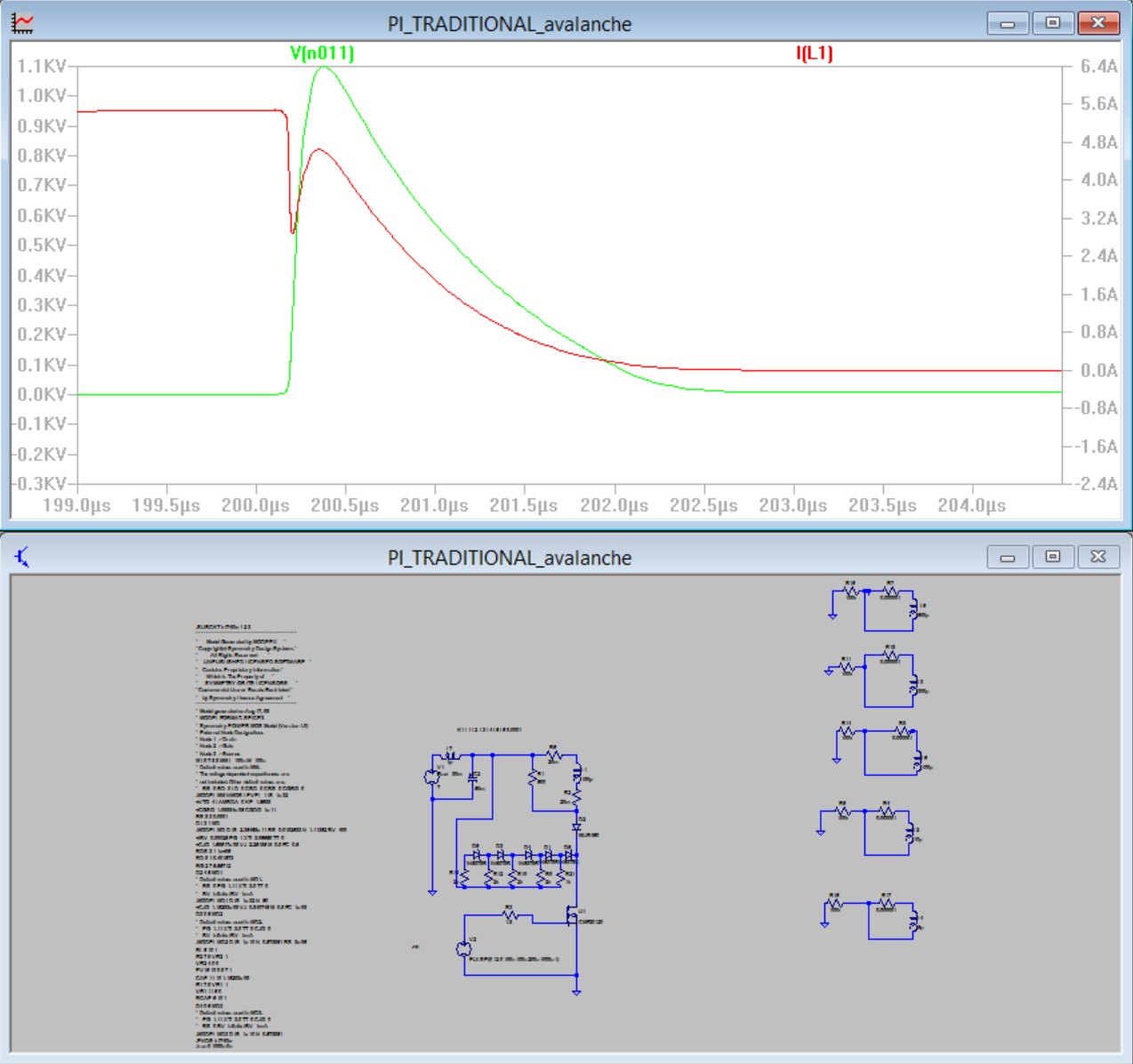

                  While we have the sim at hand, we could look at the target response.
                  We see the TX eddy currents in the targets, to the time of TX switch Off and then the new eddy currents generated by the switch OFF di/dt.
                  v(n011) is the coil voltage decay
                  I(L2), ..L3, L4, L5, L6 are the responses of targets with TC's of 5us, 10us, 100us, 500us
                  We see how the short TC target eddy currents raise to a certain level during TX, but then start decaying again.
                  The long TC eddy currents keep increasing right to the time of switch OFF, because their TC is longer that the TX time.
                  We see that the switch Off must first destroy the negative eddy currents from the TX before it can build the positive eddy currents from the switch OFF.

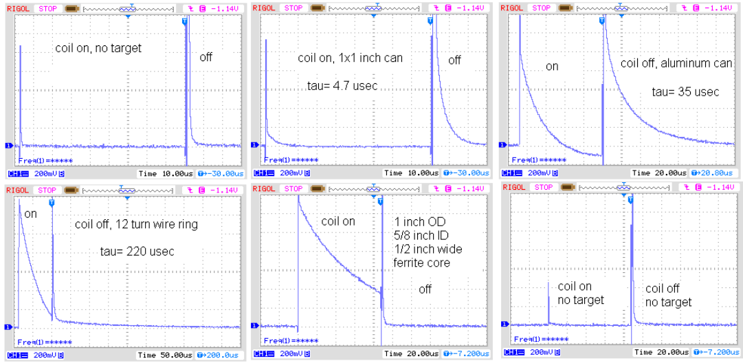

                  If I plot the target during coil turn on with LTspice I get a similar response as you did in reply #44. If I plot the on response with a DD coil on the bench I get something different. Low tau targets have a higher response at turn off, high tau targets have a higher response at turn on. The turn on response is highest at the start, then decays instead of increasing. Any idea why? Been thinking about looking at the target during coil on and off times.
                  • #54
                    There are several significant to consider:
                    1) For the ON time, the TX current pulse shape is very important.
                    To get similar results, the pulse shape needs to be the same.
                    2) The simulation does not take into account the Earth's magnetic field.
                    Even in air tests, the Earth's magnetic field is always present. When we switch TX ON, the coil field changes the field vectors of the surrounding Earth field. Near the coil this generates a relative strong target response which then again decays.
                    3) The induction balance of a DD coil is not perfect.
                    This caused the switching noise and coil transients to be relatively more visible than the target response.
                    4) The ferrite core.
                    There is a very vast choice of ferrite cores available. A core might be optimized for a 50Hz frequency or 5MHz frequency.
                    Running out of time, will continue...........

                              1) Any idea what the transmit pulse would have to look like to cause the on target signal to be opposite what we both get with the spice simulations, Or is something else causing it?
                              2) If there is an effect, doesn't balancing the coil for a zero signal cancel it out?(Missed Carl's reply while I was replying)
                              3)The switching transients are less than 3 usec long. The rest of the no target trace is a lot less than the target traces.
                              4)I have a couple different ferrites. Both have a similar response as some clay from the yard, maybe the same.
