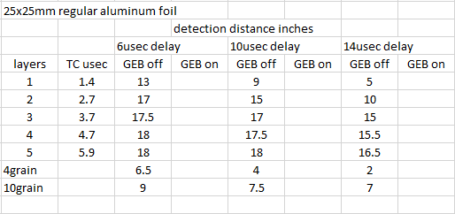

                      Hello Qiaozhi, i'm confuse about this;
                      As for a PI, the pulse rate or pulses per second (pps) refers to the number of high current pulses that occur over the time specified. Rates vary from a few hundred to several thousand per second: Generally, more pulses allow for a little better averaging and thus a little better signal to noise ratio. However, a detector will have a tendency to consume more current with a higher pulse rate. A faster pulse rate doesn't mean a detector will detect small gold better. In fact, it is quite easy to build a PI that has a very low pulse repetition rate (PPS) that is very sensitive to very small gold while designing a PI with a high PPS that is not sensitive to small nuggets.
                        This just means that the pulse repetition rate is not the main factor for detecting small gold. The most important thing is to reduce the decay time of the coil current so that you can sample before the target signal has disappeared.
                          An example changing target delay time I posted awhile back, sampling sooner. The lower the target TC the greater the detection distance difference with changing delay time. Increasing sample rate reduces noise and increases average coil current. My tests, I haven't seen a big advantage increasing sample rate from 1000pps to 3000ps or 5000pps. Some have seen an improvement.
                          (Chart)4 and 10 grain are gold nuggets
