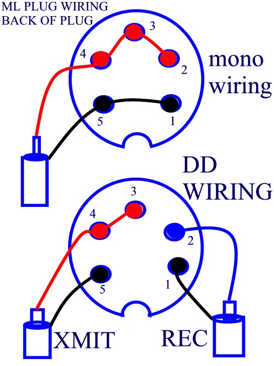

    1. Here is the original User manual (attached).
    2. Garrett SeaHunter MkII mono coils work very well with the Crossbow. I've tried both the 14"x10" and the 8". You will have to change the coil connector to suit.
    3. Any other mono coil should also work, such those from Minelab and White's Electronics.

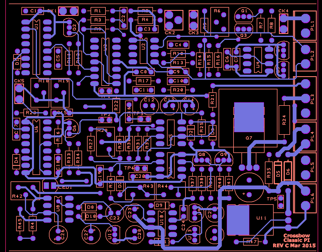

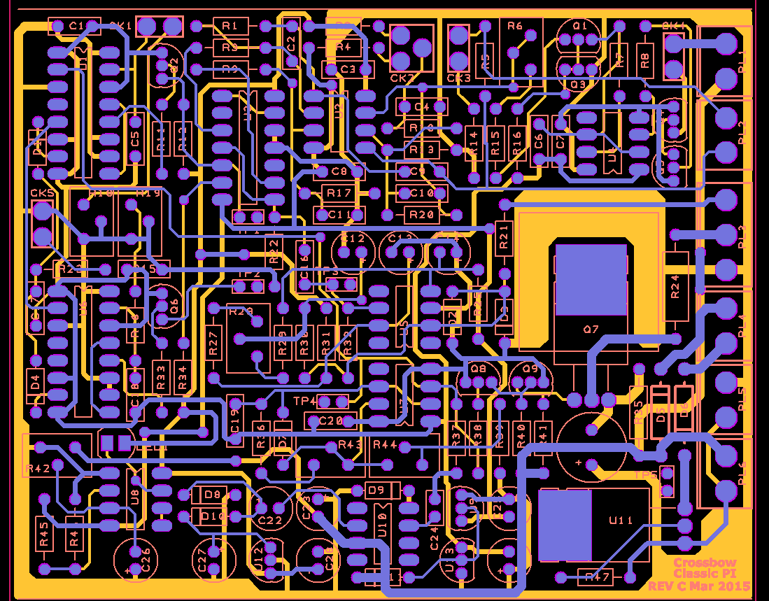

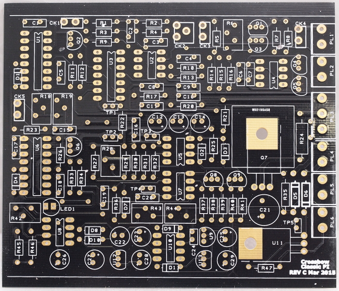

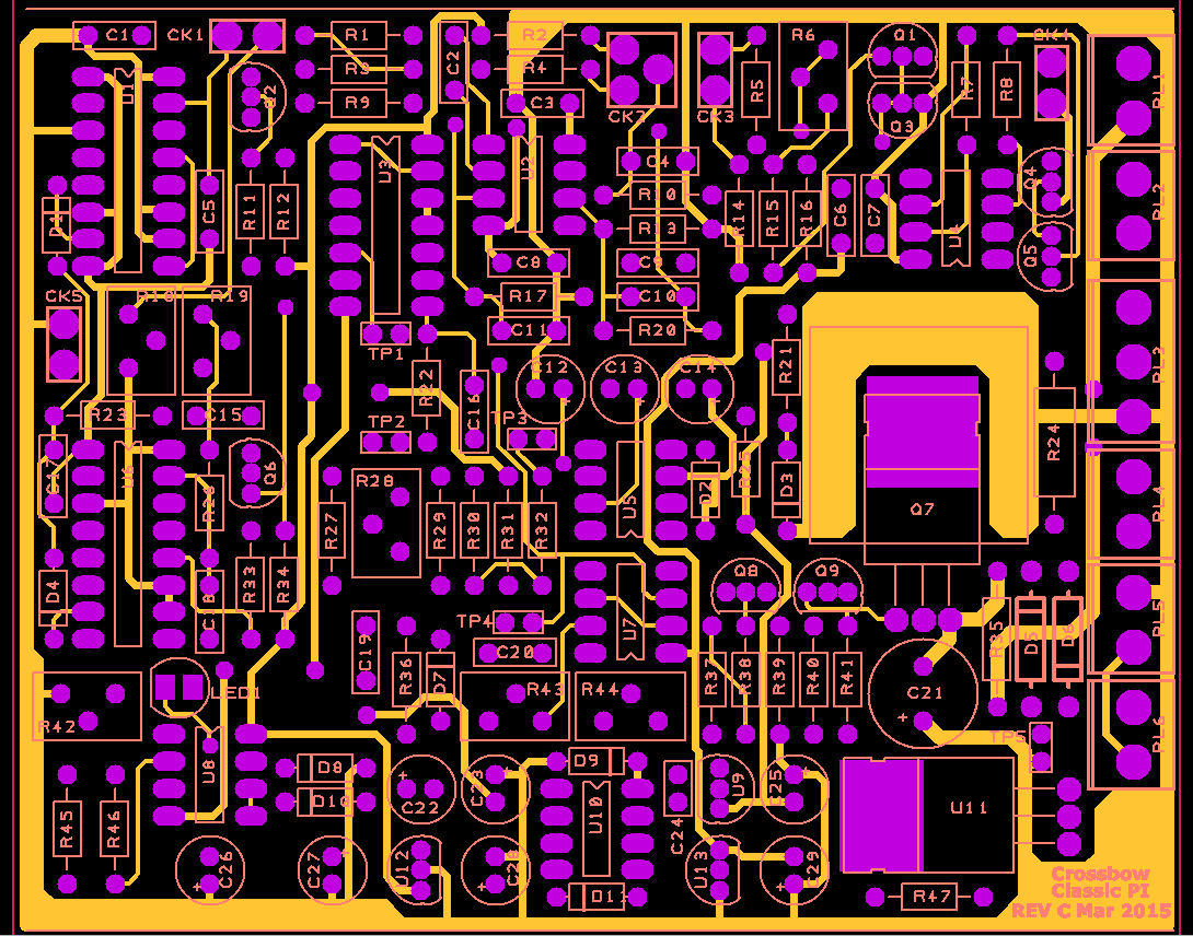

        Please note my forum is a closed forum only for those that had purchased a Mirage PCB in the past. The Crossbow sub-forum is part of the Mirage Forum set up for 12 or so of us who were building/experimenting the CrossBow.
        For the most part the CrossBow sub-forum has been inactive for the past year or so.
        2 maybe 3 members were successful building the CB but, there were issues and challenges with both revision B and C.
        Rev. C was the last George sent us. I did not complete mine as I was too busy with the Mirage Pi project.
        The files below would help anyone attempting the build.
        We attempted to make a pdf. building instruction file, we were up to page 9, not completed but, helpful.
        CROSSBOW GERBER FILES.zip
        Crossbow Classic PI - Schematic.pdf
        CROSSBOW PARTS LIST.pdf
        Minelab_GPX_Coil.pdf

        Added Info from George:
        The original Crossbow coils have the damping resistor in the coil shell,but you can put the resistor inside the enclosure, on the back of the
        coil connector, if you would prefer.

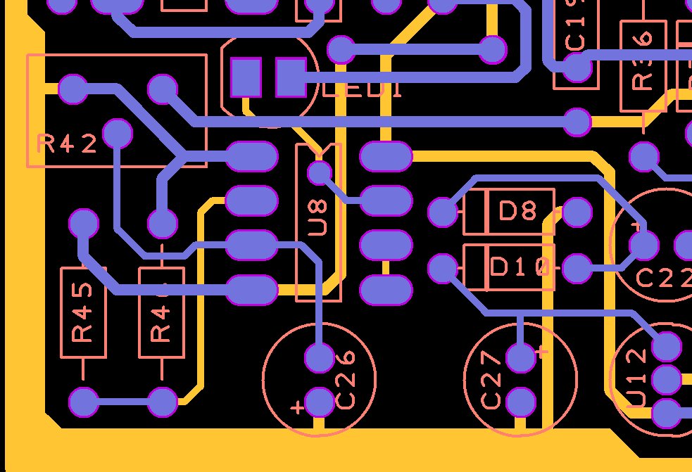

        Here is the calibration procedure that I used:
        1. Power the detector from a bench power supply set to 10.5V. Adjust R42
        so that the Battery Low LED just turns on.
        2. Connect battery pack.
        3. Adjust the TX frequency to 1kHz (1000pps)
        4. Adjust the TX pulse width to give 200mA quiescent current consumption
        (with coil connected). The pulse width should then be approximately
        120us.
        5. Disconnect coil and set voltage at preamp output to 0V by adjusting
        R28.
        6. Set Sensitivity pot (R6) to mid-position.
        7. Set minimum delay setting (R1 to 25us. You may be able to set this
        to a lower value, depending on the coil.
        8. Set secondary sample pulse (R19) to 400us.
        Kind Regards
        George
        R24 is a 3R3 value resistor that is placed in series with the coil to
        limit the maximum current. The idea here is to get the current to level
        out so that it's not changing rapidly in the opposite direction when the
        MOSFET switches off.
        The original Crossbow uses a 5-pin connector for the coil, and pins 1, 2
        and 3 of PL3, go to pins 1, 5 and 3 respectively of the coil connector.
        Then, for a mono coil, pins 1 and 5 are shorted together inside the coil
        plug. This will give you the flexibility of also using an IB coil if you
        desire. When using commercial coils (that do not have a resistor in the
        coil shell) with the Crossbow, you can place a 470R damping resistor
        across pins 2 and 4, and wire the mono coil plug so that pins 1, 5 and 2
        are shorted together, and likewise for pins 3 and 4. If the damping
        resistor needs to be a lower value than 470R, you can then fit a
        suitable high value resistor (low wattage) resistor inside the coil
        plug.
