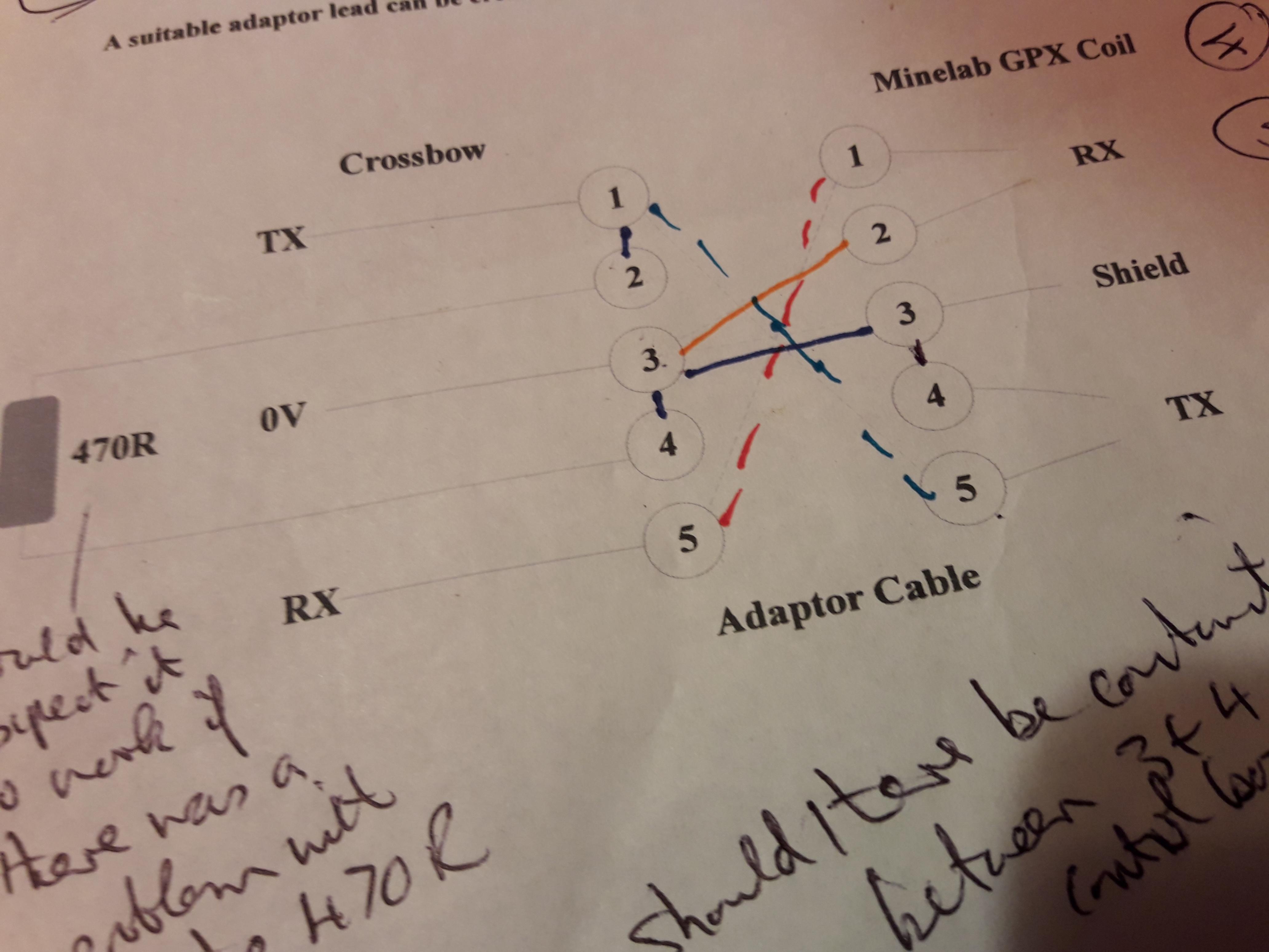

          It sounds like you forgot to add the two links in the adapter cable between pins 1&2 and 3&4. Otherwise the damping resistor isn't actually connected to anything.

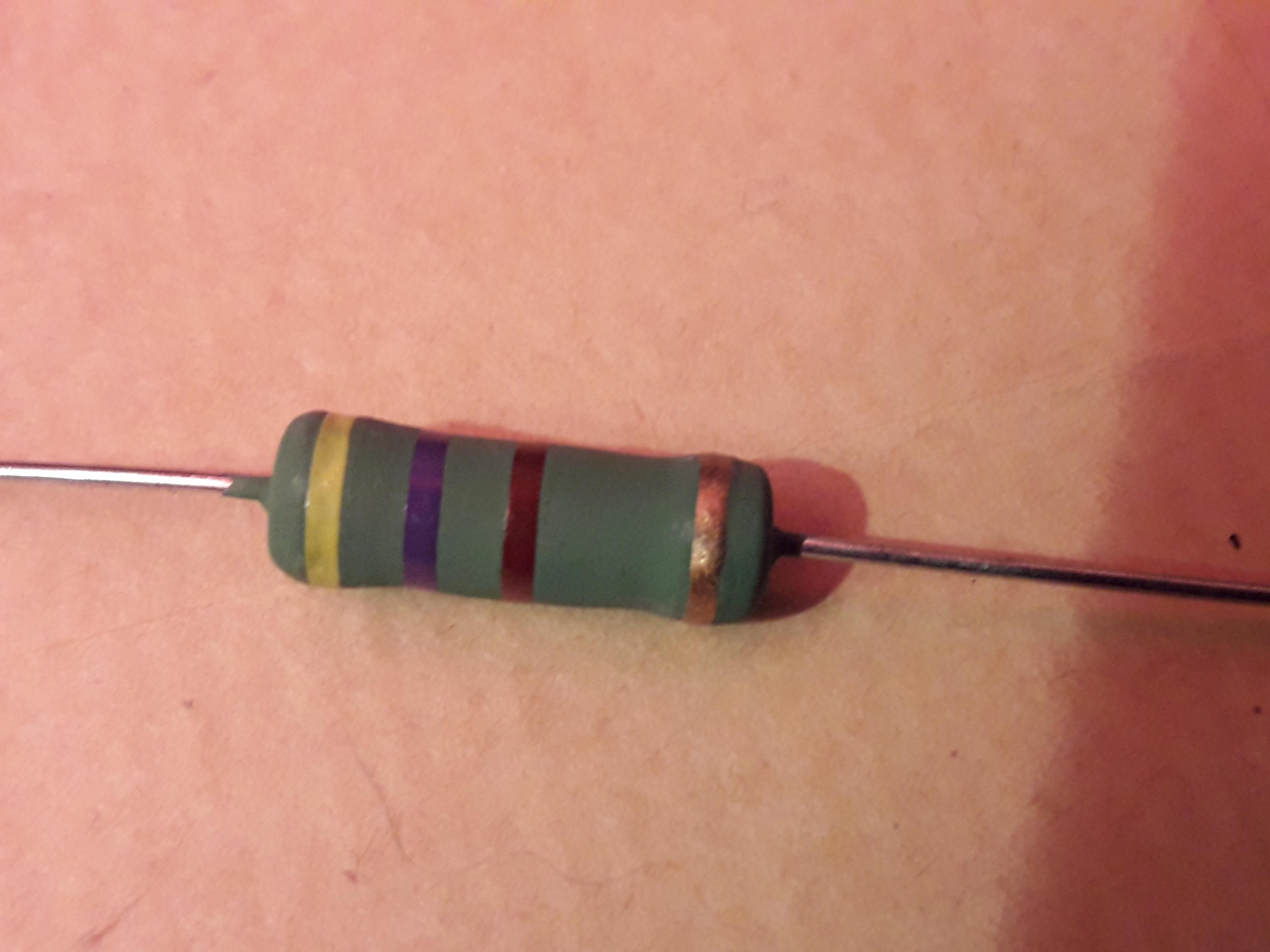

            Picture of resister used. It wouldn't surprise me if I have used wrong type.

              The resistor pictured is fine.
              The connections between pins 1&2 and 3&4 are shown in the "Minelab DD Coil.pdf". These need to be done in the adapter cable plug (as shown), not the coil socket in the back of the electronics enclosure. If you put them in the coil socket, then the original coil will not function correctly.

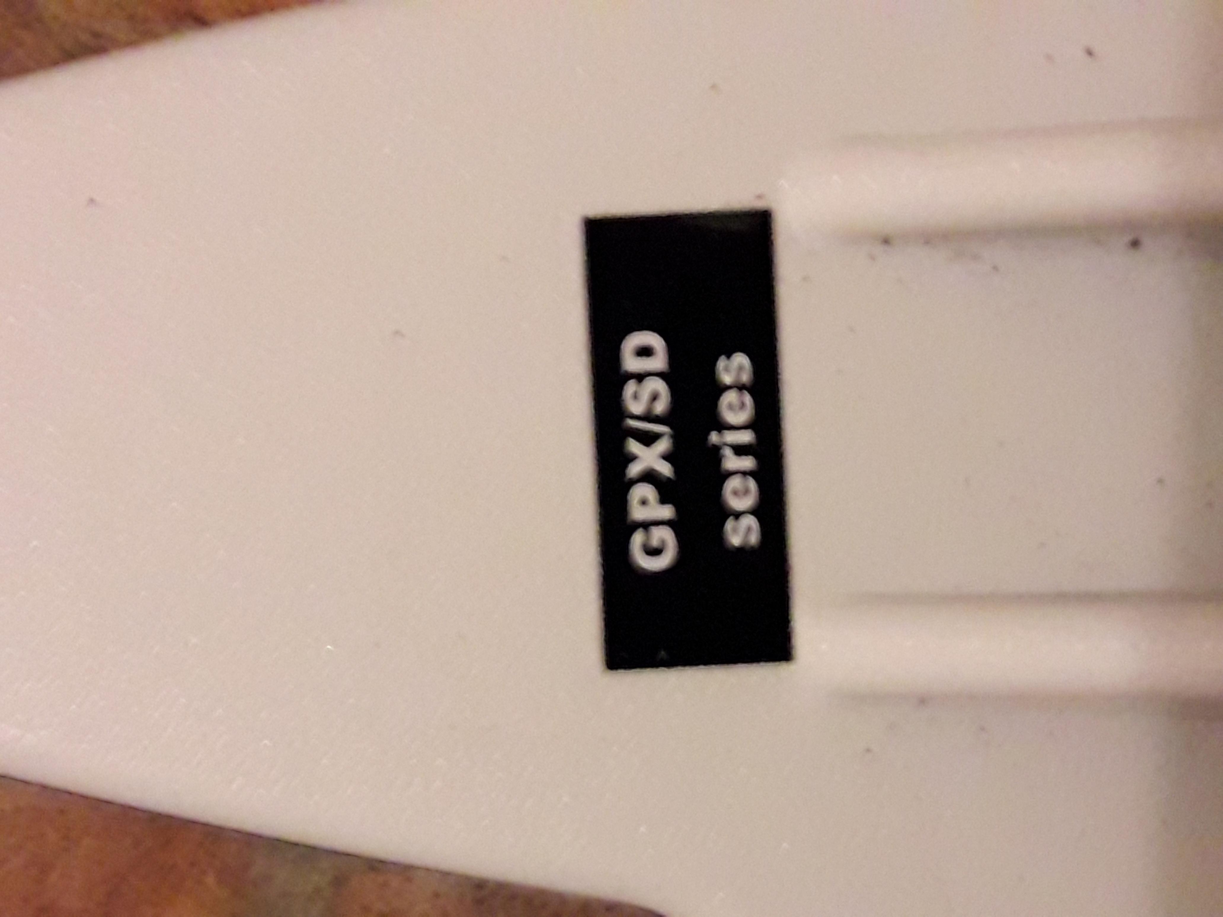

                  Originally posted by TowySalmon View Post
                  It is for the GPX, GP, SD series: https://detech-metaldetectors.ro/en/...lab-gpx-series
                  I do though fear that after doing continuity that something is not right...........?
                  What exactly is written on the coil label ?

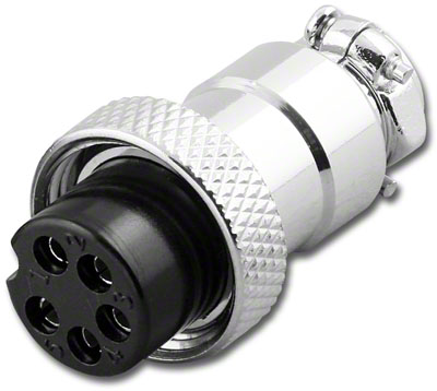

                    The pins should have numbers beside them on the plug front and back, so the pin number is the same weather you are looking at them from the front or back of plug.
                    The plug is also a 5 pin microphone plug NOT a 5 pin DIN.

                      OK - let's see if I can make this a bit clearer. Please see modified PDF attached.
                      In the bottom diagram, everything on the left of the adapter cable is in the Crossbow enclosure, and everything on the right of the adapter cable is in the Minelab coil connector. The connections shown in the middle (between the right and left connectors) are in the adapter cable. The idea of the adapter cable is to connect the Minelab TX and RX loops to the correct pins on Crossbow, and to connect the damping resistor in the enclosure across the TX loop. When the adapter cable is disconnected, the resistor is out of circuit. If you then connect the original mono coil (obviously without the adapter cable), it uses its own internal damping resistor.

                        Well, we installed the jumpers between 1&2 and 3&4 at the box end plug of adapter and checked the connections twice with ref' to the diagram. Funnily enough, I had coloured the connections on drawing very much the same as your revised .pdf. The correct plugs have been used and the layout of pins is now imprinted on my brain as I have looked at them through a magnifying glass so many times.
                        So, picture of coil label and for interest my coloured lines on drawing.

                        And did it work when we attached the (finally) correctly made adapter? No. There is no response from the coil whatsoever?
