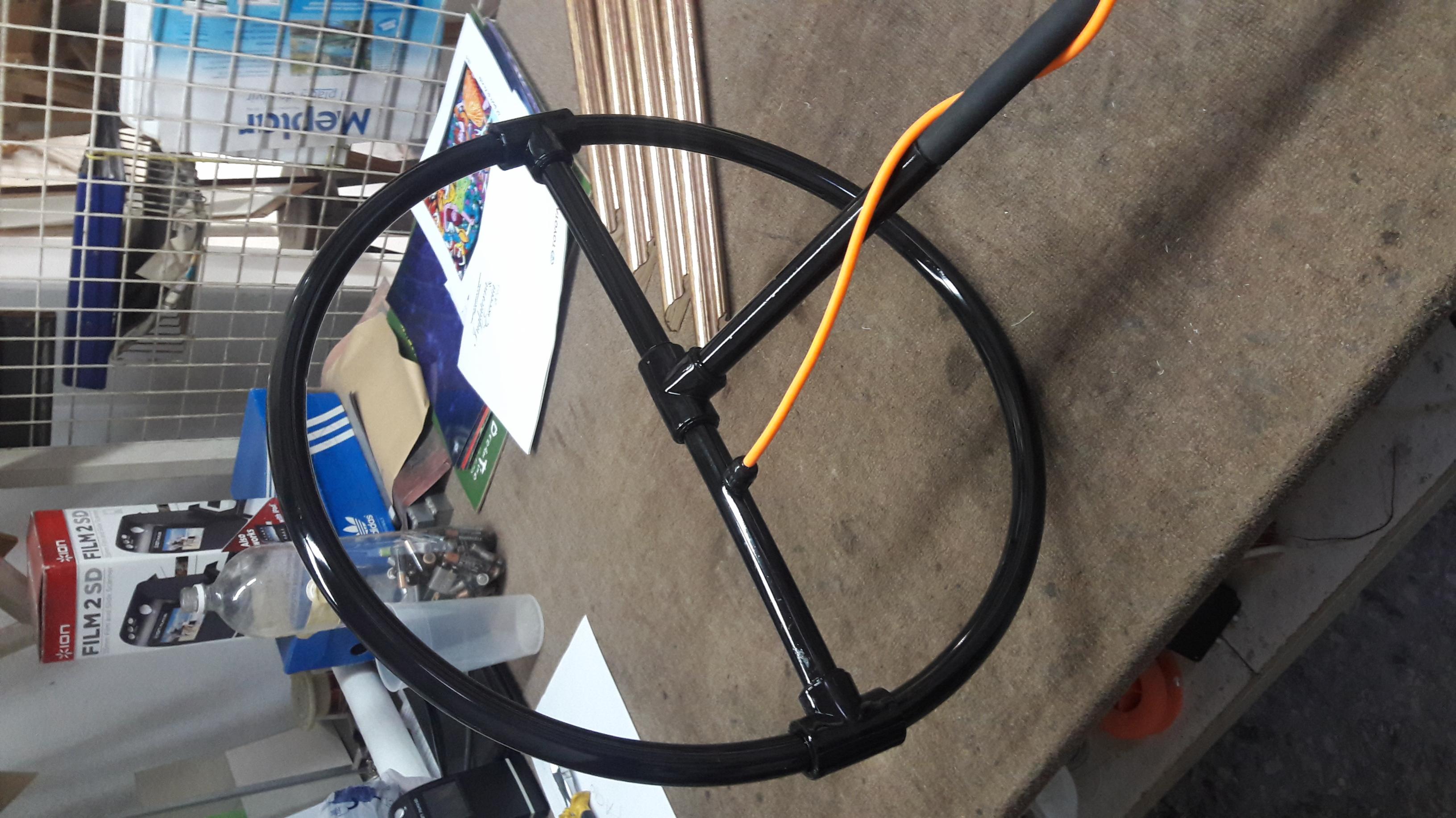

    R7 in the crossbow schematic ? near the U4 ic?
    I build the sandbanks -??? what you meant?
    • Yes
      • http://www.geotech1.com/forums/showt...ghlight=Poland
        • sandbanks has R7 value 100 Ohm. what did you set?
          • In my detector i put 1k x 2w and remplaced for the IRF740.
            I see in my scope the curve of decay the wave (see my photos)
            • This is my search coil 45 cm. 13 turns telephone wire 235 uH.
              • Originally posted by Carlos View Post
                nice coil, carlos do you have any video of your detector working ?
                • hello, yes I have but with a search coil of 23 cm. I already sent the link. with the search coil of 45 cm. increases the sensitivity of the objects by 30%. An aluminum can of 330cc with the small one detects it between 60 to 65 cm. and with the large one at 80 to 85 cm.
