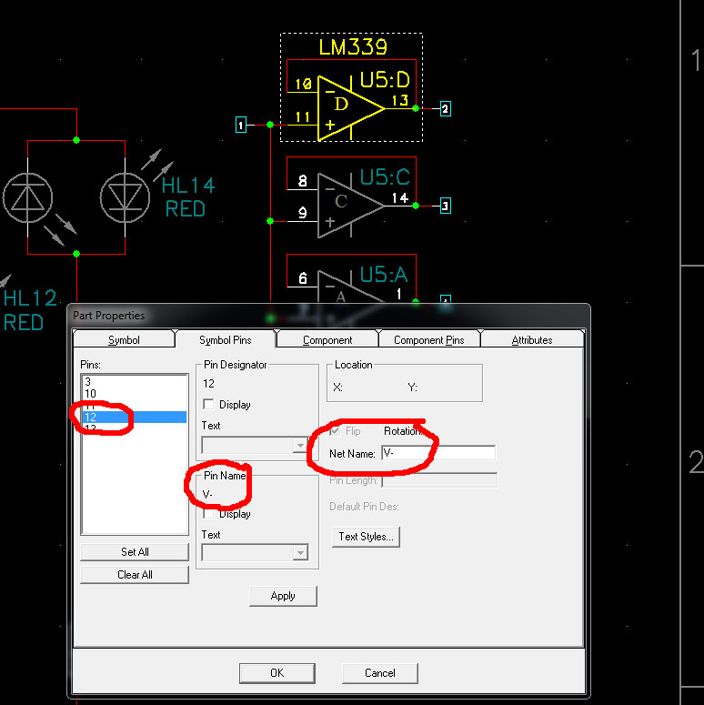

    Hi kt315
    i have question with IC LM339... the pin 12 is -Vcc or GND ?
    Wouldn't Pin 12 connect to the power GND?
    You have any video test with LM339?
    I Have the LM2901 too.
    Best Regards
    • #78
      hi jo
      you see the video with 339 and do now want to trust of YOUR EYES??? LOL!
      pin 12 connected via properties in CAD.
      no mistakes. i always check all power ics' pins.
      original schematic was just for opamps checking. i thought to add 339 because it used in md schematics.
      you will see just half of LEDs lighten, because comparators are with 'open' output and there are not load resistors
      but that's enough for the checking.
      first link above in your post is WITH 339.

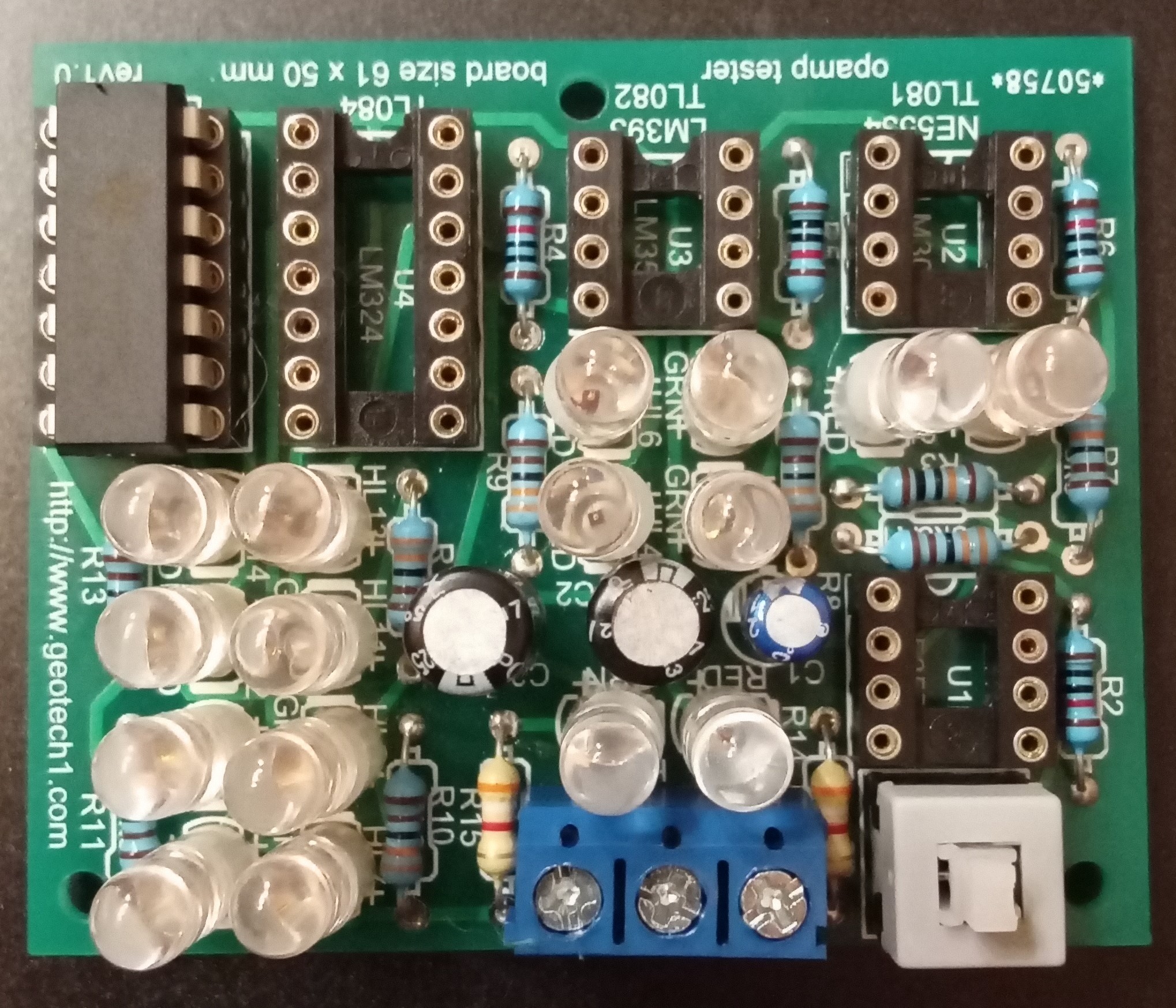

          • #81
            for LM339 i added additional socket. i see LM2901 is same like LM339, one datasheet on both.
            as the comparators are with 'open collectors' output you will see just one LEDs row flashing,
            i did not set load resistors on outputs on board trying decrease pcb size to minimal possible. also, the checking of comparators are just an option,
            but good option.
            pleasure
            • #82
              but good option.
              pleasure

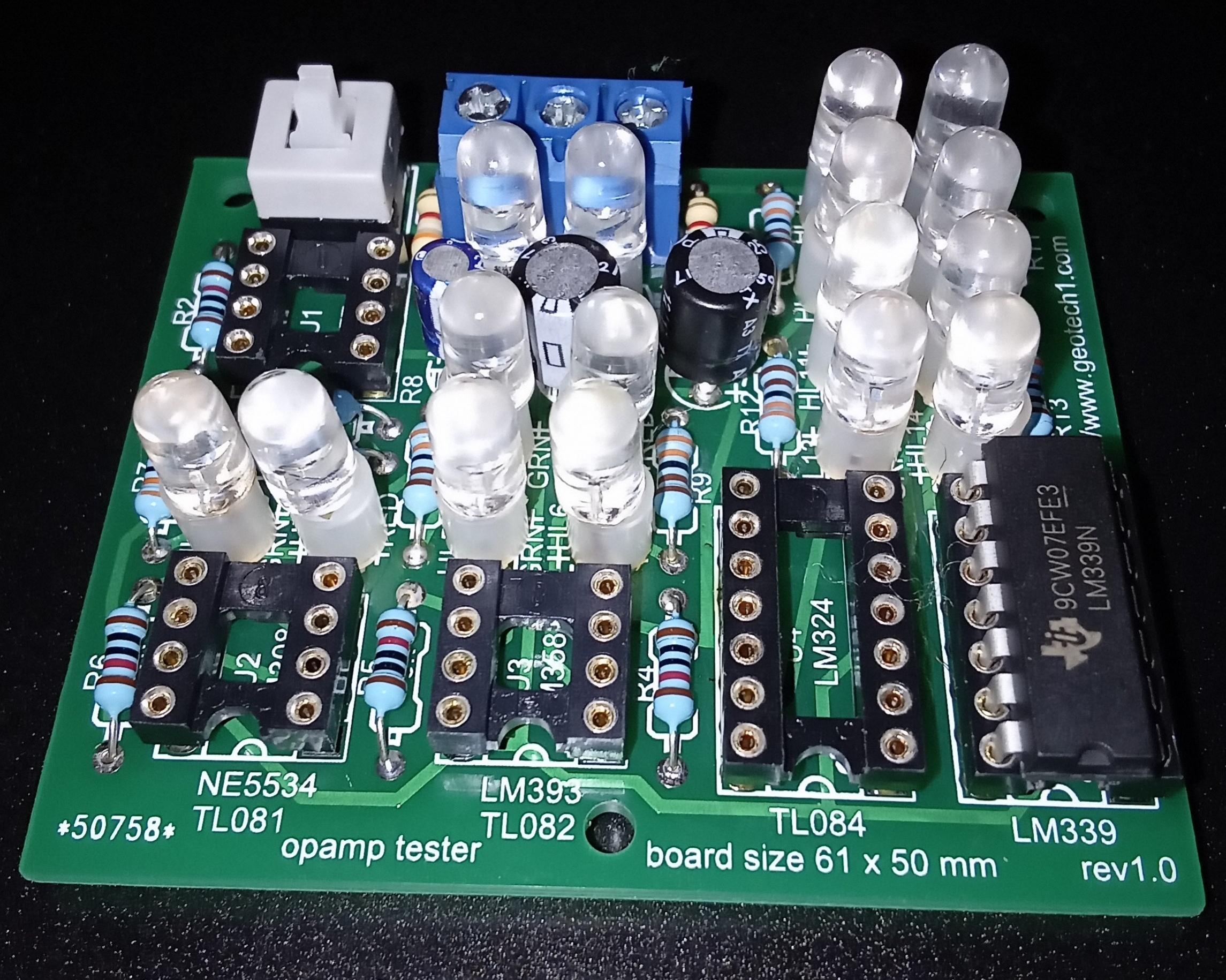

              Hi, how are you ? You could take a doubt, I saw in some assembly photos that you used the resistors R7 to R13 of 1k2 and the board uses 3k3. any reason for that?
              • #83
                hello amigo
                R7 to R13..... they are current-limited resistors for the LEDs. if you take power supply +-9V you choice one value, if +-15V you choice another value.
                this is first issue. the reason is THE current you (YOU) choice.
                second. opamps output is limited on level 30mA, much datasheets do not mention this value but we take this. so 15-20mA through a LED is good and standart.
                10mA is safe current level, for both opamps and LEDs. it gives us middle glow for un-bright/ordinary LEDs.
                for example you have 3V LEDs bright. your source is +-15V. the voltage of opamp output is 15-1 = 14V. you choice 10mA current,
                (14-3)/0.01 = 1.1kOhm.
                • #84

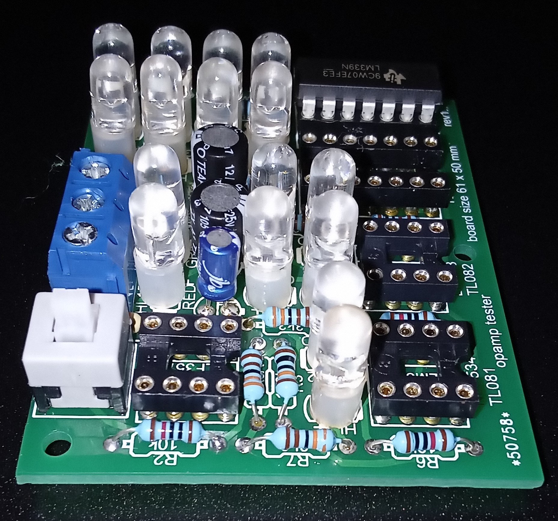

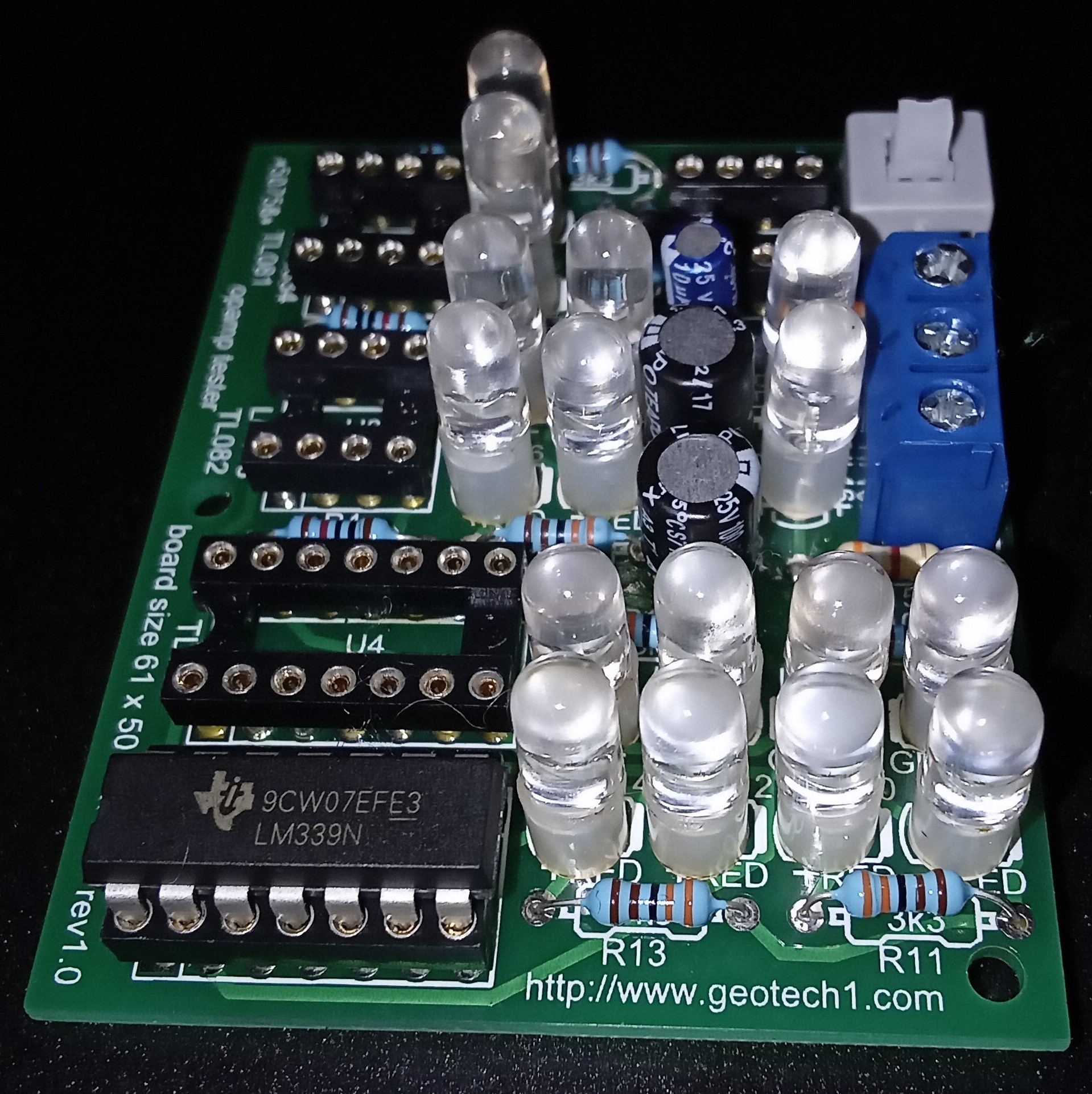

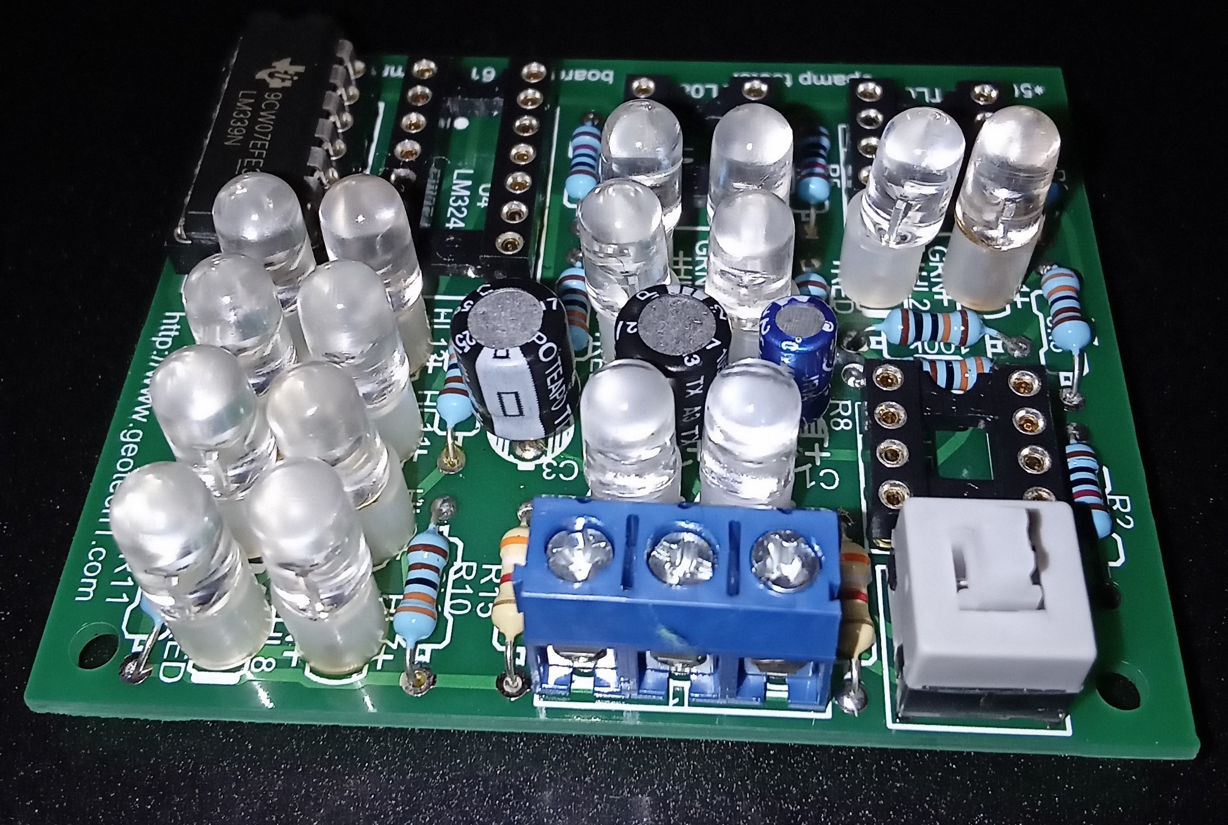

                  Hello KT315. I put photos in fotoalbum in my profile and post for verification. On recommendation, I replaced the capacitors with 25V bought and delivered LM339N.
                  • #85
                    it seems good. this schematic is working just with opamp in position U1. then set another one in U2.
                    if LEDs HL1 HL2 are lighten then U1 and U2 are good.
                    you can use TL061, TL071, TL081 for U1.
                    pics https://www.geotech1.com/forums/album.php?albumid=109
                    • #86
                      Thank you. I want to test the LF357N.I don't understand. I need to put in the TL081 U2 together with the LF357?
                      • #87
                        you can put in U1 U2:
                        1. both LF357
                        2. one TL081 another LF357
                        3. one LF357 another TL081
                        4. both TL081
                        • #88

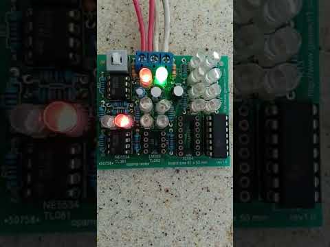

                          Hello, KT315. Is this the correct operation of the op amp tester? I put both LF357.
                          • #89
                            hello
                            yes. comparator has 'open collector' outputs. in one its state LEDs are not lighten.
                            pleasure
