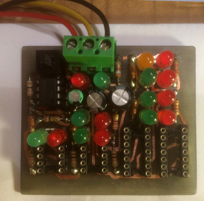

Thanks for the very useful Op-Amp tester. I have loads of old Op-Amps in my 'junk-box'.
I have now tested most of them using the Op-Amp tester which I built for a mere €1 (including a 15 volt symmetrical power supply!).
The only difference I found with the LED lights was that a good LM339 caused the red LEDs to flash (found at the edge of the PCB) - although your 'green' LEDs were flashing (shown as yellow LEDs in your photo).
Please see my photos.
I actually found a genuine LF357 IC in my junk-box - I couldn't believe it - and it shows good although the marking have been partly ground away by some fanatical electonics engineer who had used that IC to build some
unknown electronic gadget years ago.

thank you for report SG. nice home work. all chinese bought LF357s are good, problem was in another place. i see doubled signal
on DD1:A and must find out a source of it. one board was sold with LF356 also chinese and the board was working good to me.
i have access just to 20MHz o-scope now, all anothers mine need repair, so i do not have a possibility to see differences in LF357s bought.

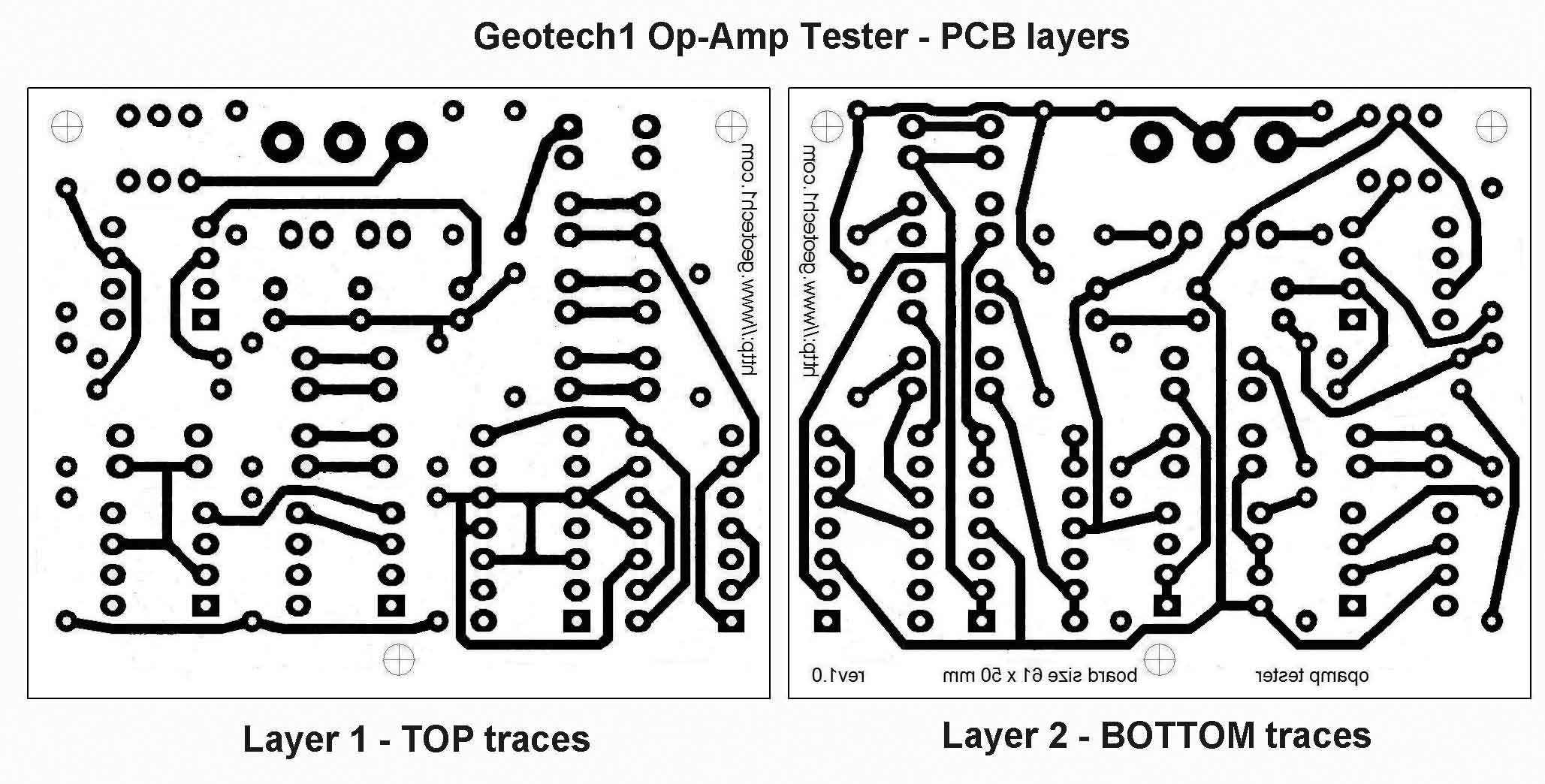

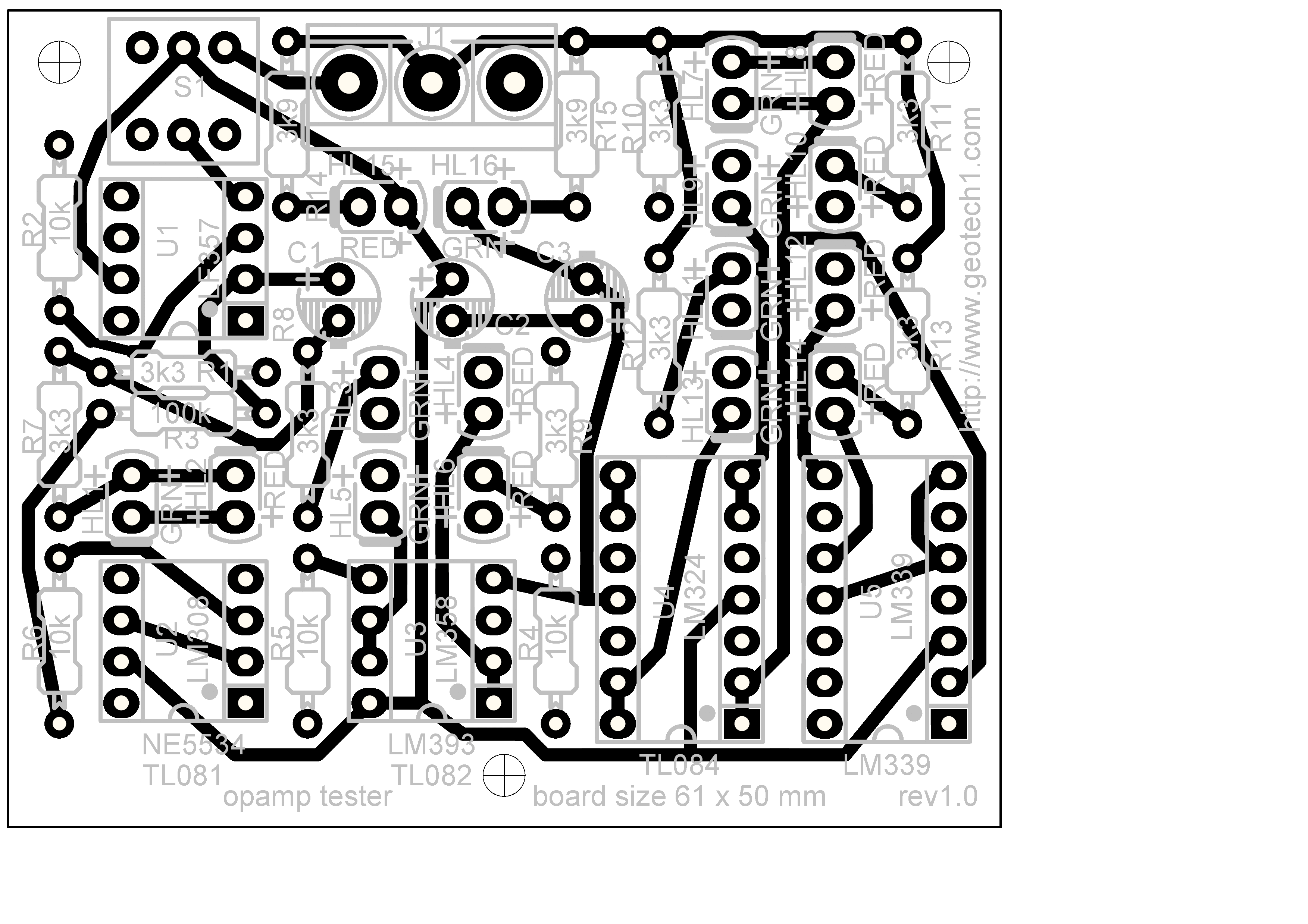

The Geotech1 Op Amp Tester is based upon the March 2005 Elektor Op Amp tester.
In order to facilitate the construction of the Geotech1 version of the tester please find the dual-layer PCB tracks which helped me construct successfully this Op Amp tester, as I have previously posted here.
TOP and BOTTOM copper traces are meant for either:
(a) iron-on OR
(b) acetone-transfer purposes.
I prefer the acetone-transfer methodology and I was very successful using the 80% acetone cocktail.
I hope that this will make it easier for the amateur metal detectorists to determine the condition (good/bad) of their junk-box' comparators when thet assemble their newly-built metal detectors.

good. if LEDs light is not bright enough in your opinion increase a current decreasing resistors value.
you must not increase output max current. 10-15mA has to be good range in all cases, but learn datasheet of an op amp before testing.
also i noticed some datasheets do not have info about the max current.

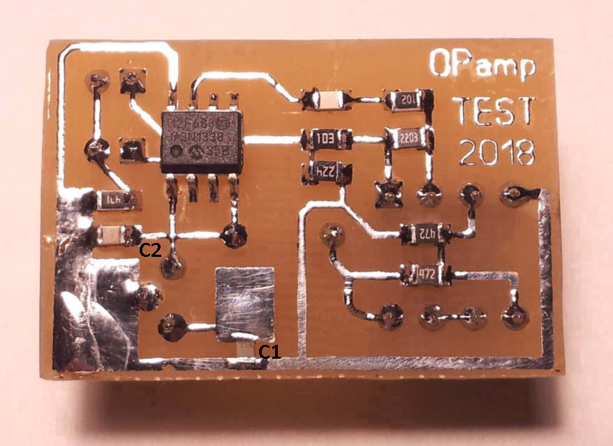

Hi
I'm assuming that Capacitor C2 was accidently misplaced on the actual PCB (it is different from the circuit drawing).
I have attached a photo of the "soldered" capacitor shown in the correct position on the PCB.
