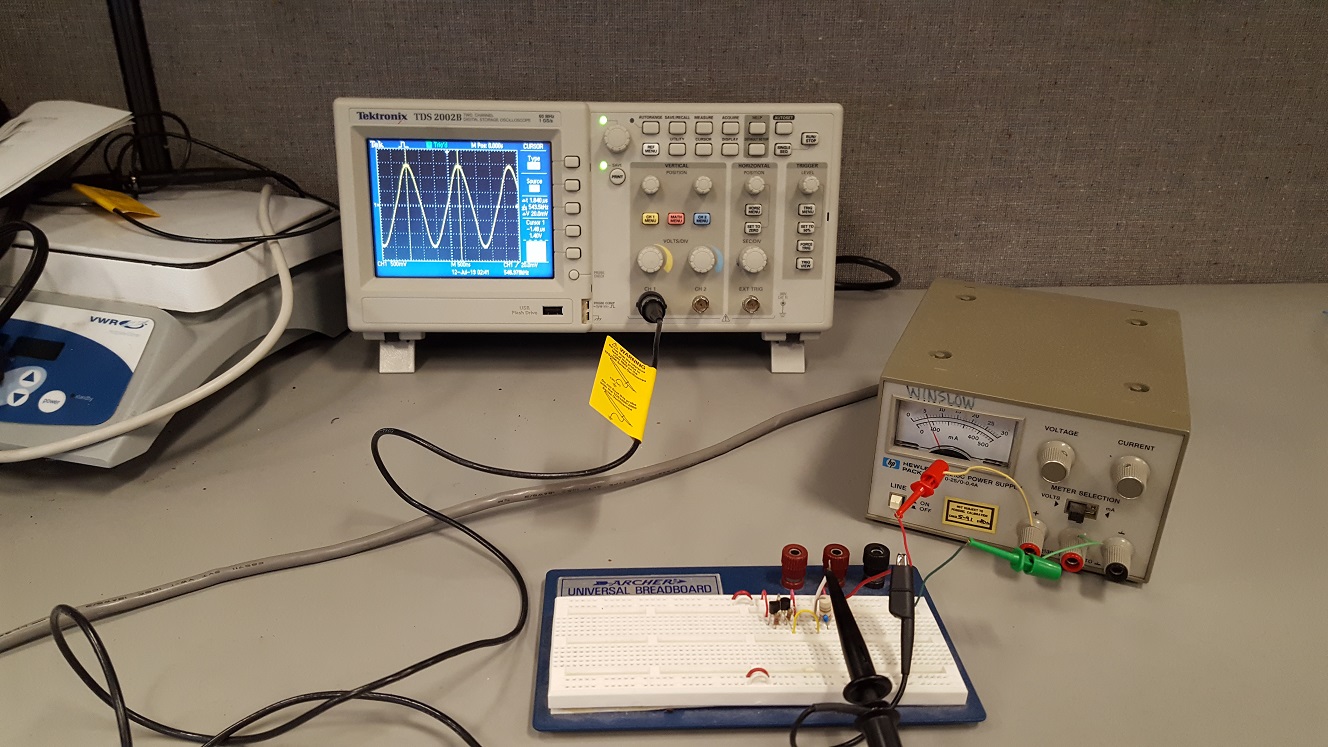

                  So I breadboarded the Peltz oscillator and it works well! There seems to be a lot of additional capacitance from the breadboard and probe since the frequency is significantly lower than calculated. Used a 390uH inductor and a 100pf cap and get 543 kHz.

                  • Useful little circuit, very good.
                    • Tried with 6.8mH and 100pf and got 112.4kHz and a distorted waveform.
                      • That very interesting, will the tank oscillate with say a 20n cap?(6.8mh)

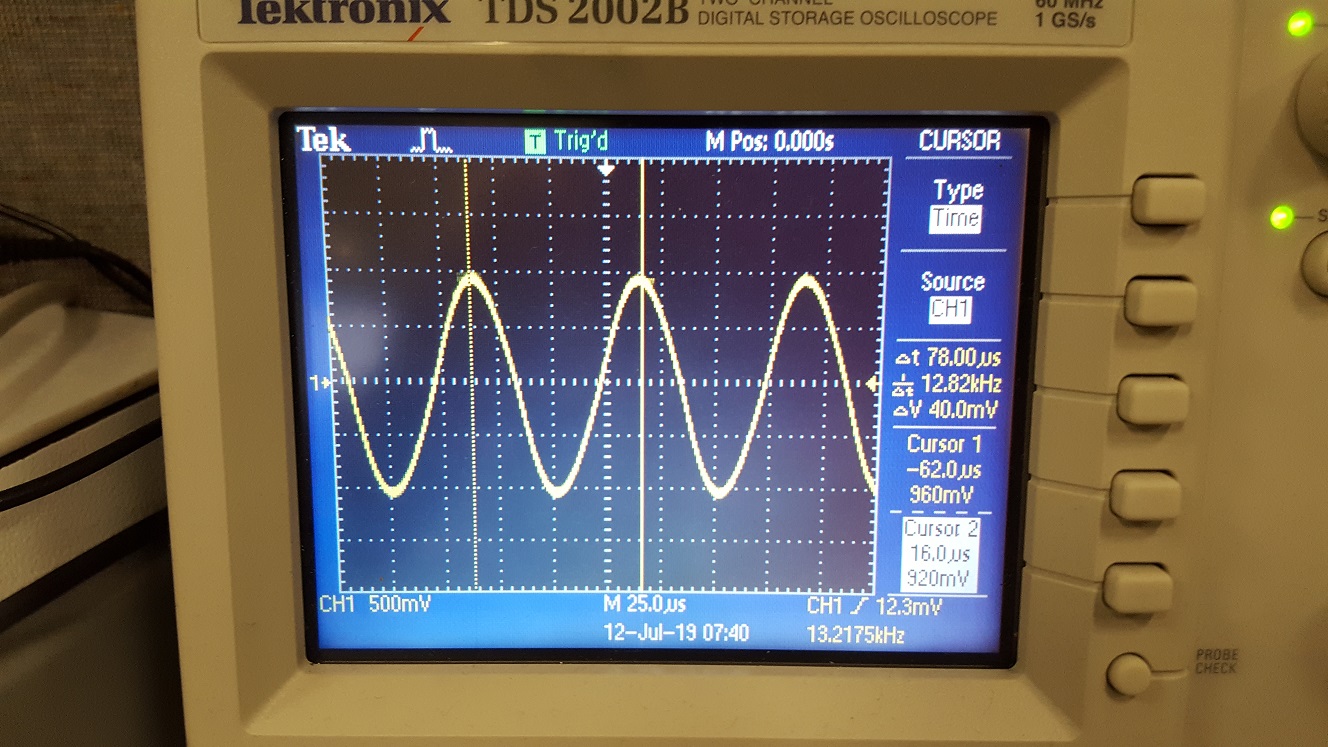

                              Might be a good candidate for a coil tester circuit of sorts. What's the peak to peak across the tank. I need to read the article and play with the spice sim provided.
                              OK, tested with 6.8mH and 22nF cap. The waveform is very nice and the frequency is 12.8kHz. Click image for larger version
                              Using the frequency function instead of cursors, I get 13.15 kHz which is very close to calculated.
                              • That's pretty awesome sinewave, looks clean as a whistle. I noticed a negative supply voltage on the scheme.
