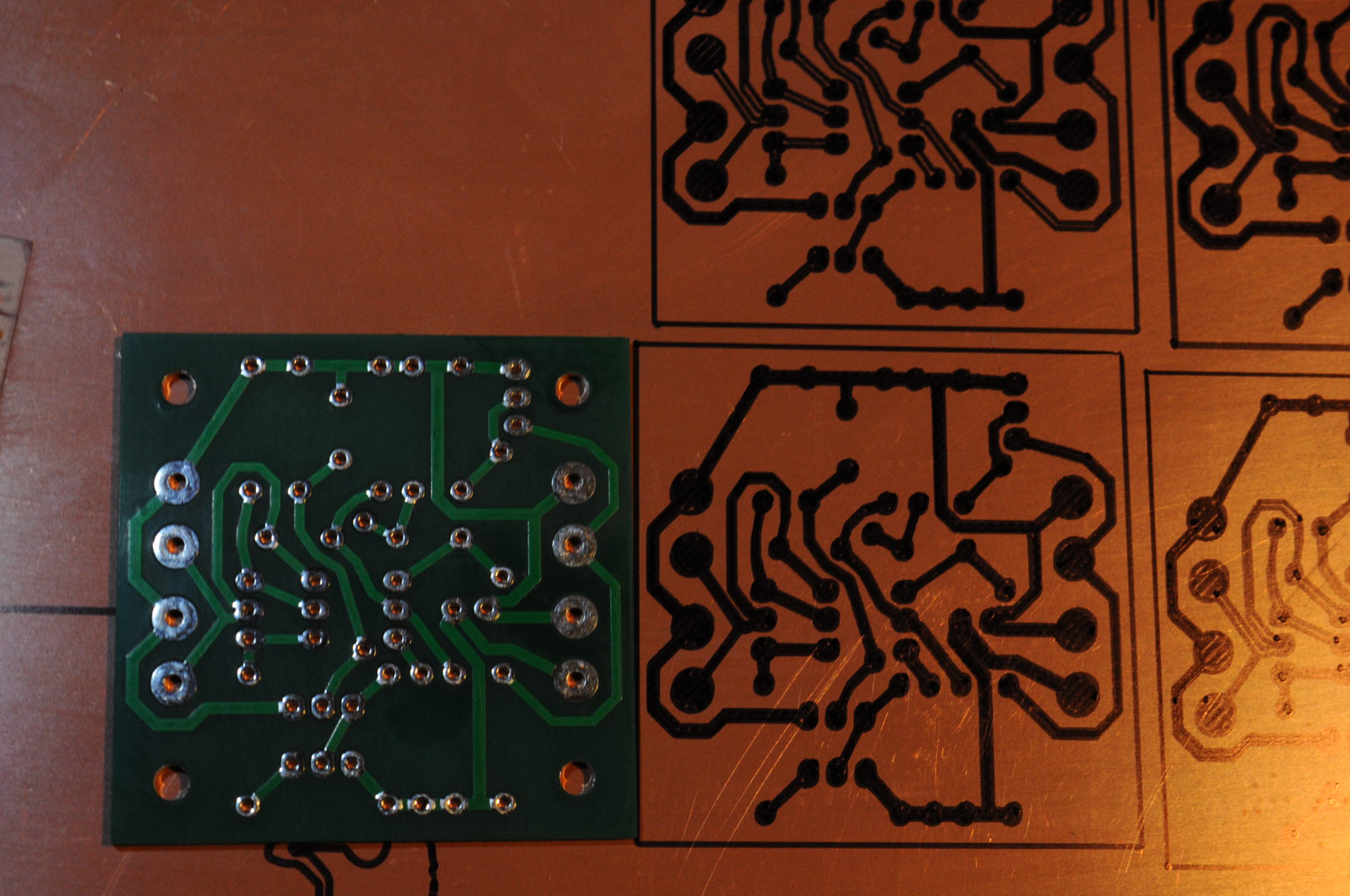

        Thank you KT, it really helped having a real physical one to compare with that im trying to do . here the results, and I feel I can improve by at least 15%. Have a look
          you can check files online http://www.gerber-viewer.com/
          I use flatcam to open the Gbr files and export to .SVG then in Freecam I import the SVG and extrude the vector and export as STL, then I just run it on my 3dprinter. but it seems like a lot of work lol when you think it takes only a few seconds to use a laser printer and ink transform to a copper board lol Lucky I have other uses for it in mind.
