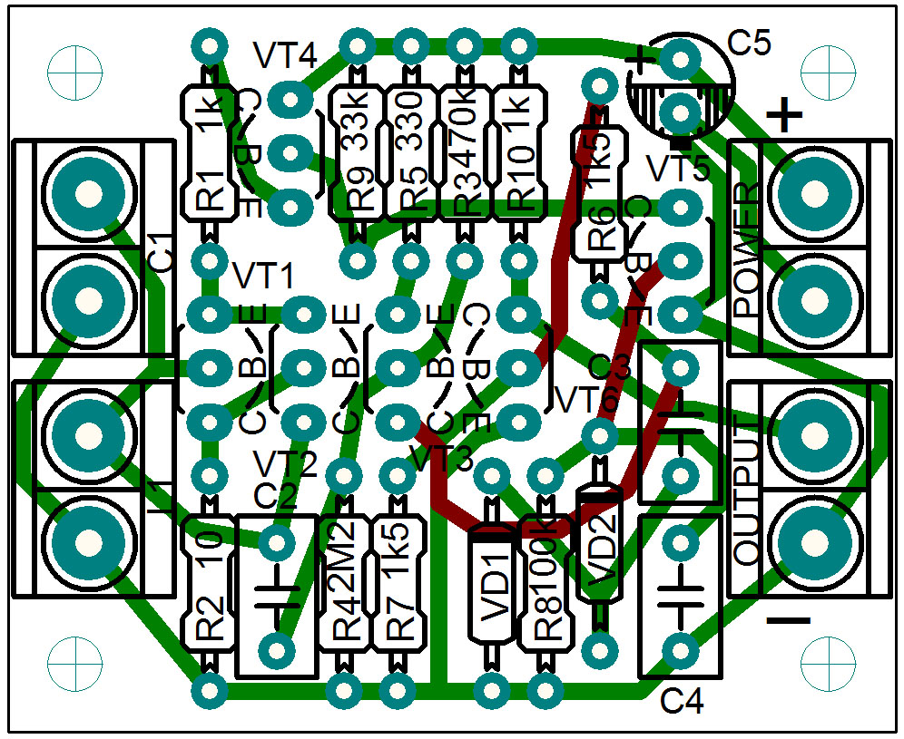

        Where is top layer? The tiny blue lines?
        the blue lines were still not traced lines.

                        There seems to be a fault in the drawing in post #13,,,,one terminal of the 1n4148 (VD2) isn't connected to anything and on the schematic it goes to the 220nf (C3),,,,just wondered if anyone noticed this. Thanks, Marty
                          Originally posted by MartyJ1963 View Post
                          There seems to be a fault in the drawing in post #13,,,,one terminal of the 1n4148 (VD2) isn't connected to anything and on the schematic it goes to the 220nf (C4),,,,just wondered if anyone noticed this. Thanks, Marty
                          If you look closely you will see that it is connected to vd1 and to c4. The green trace is obscured by the component. look at post #18, click on jpeg image.
                            @dbanner,,,thanks for the clarification,,,I didn't notice there was another drawing posted that was different. Does the 'Output' connect to the oscilloscope?, thanks. Marty
