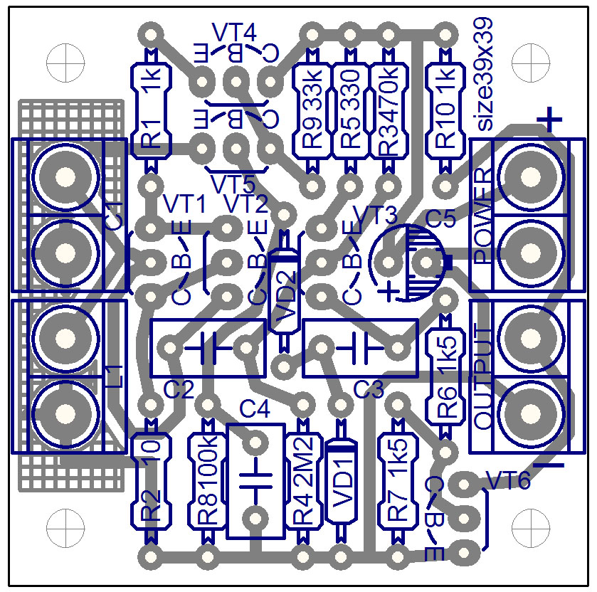

      Ahh! Thanks KT. Now I can make for myself. I am working on new project called Beach bug/Goldhunter @20khz. May need your expertise.
        certainly DB. only copy the layout in sprint-layout and do a hotdog. i will still check it and then will order the pcbs.

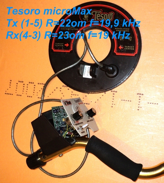

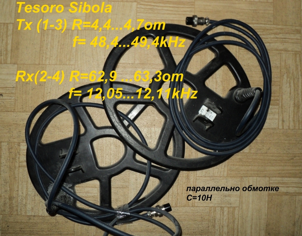

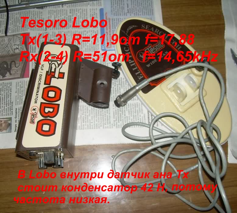

          i give some pics from russians. you see a resonance value of rx and tx.
            Yes I see. Russian guys are very smart.
            Now with coil generator circuit, I can be smart too.
            All Now I have resonance frequency of both tx and Rx, checking one at a time.
            The cibola tx is very high.
            We're these measurements taken with C1 50 pF?
              No couldn't be. Looks like they measured using caps values from schematic unless coils have internal caps.

                    Great when are you getting these little boards made ?

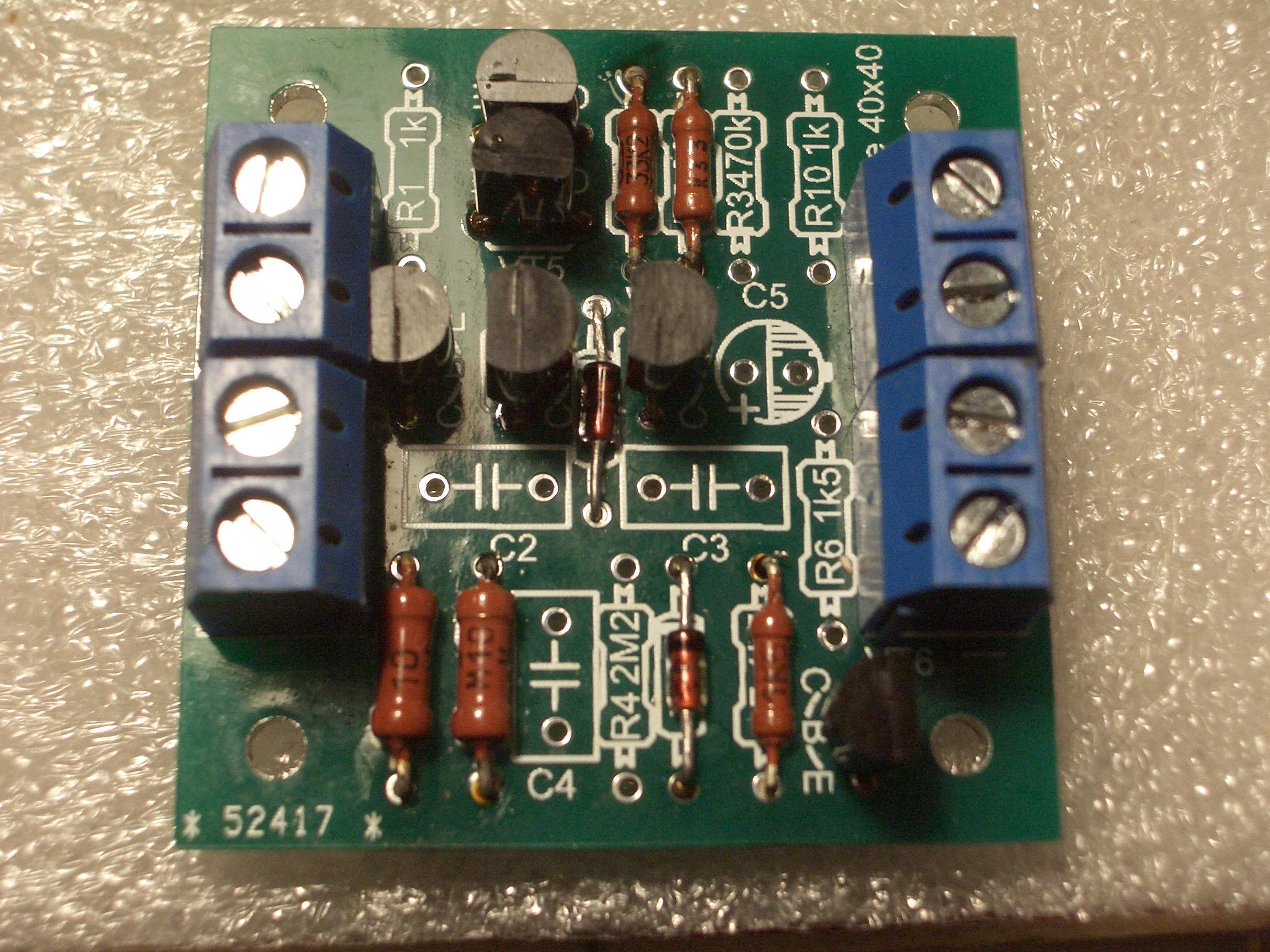

                        received the boards batch. have to solder and test.
                        • #42
                          It will be interesting to see what transistors you choose and if a PI coil will oscillate with out C1.
                          • #43
                            • #44
                              • #45
                                Are those transistors and resistors you used from recycled Electronics ? Keeping true to KT ways? Looking good so far.
