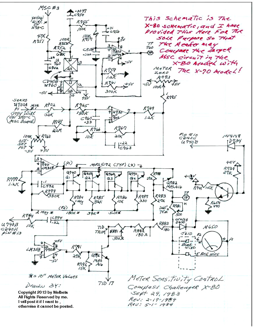

            Found that old drawing.......
            It took me some time, but I finally did find the TID drawing, that I drew in the past, relative to the 1984 Compass X-80 Challenger. Now it shows the inputs, etc which were of the X-80, but John Earle was very good at this TID design, and he left Compass, went over to Whites Electronics and was the Chief Engineer at Whites. So it should give you the start of your TID drawing as it was an EARLY TID meter.
            I am interest in seeing your final design, as I would like to use it on the Compass Coin Magnum which would fit with what you are trying to do.
            Okay, was a problem as I am now using FireFox as my software between the server and this forum, and I now that the photo of the schematic I drew back in 2013 of the Compass X-80 new TID circuit, from the PCB inputs and outputs to the Compass TID meter, and all Nandor needs to do is figure it out. I cannot really explain the circuit, just drew it in the past...

              Now in the year before, which was the earlier version, called the Compass X-70, version C, they had a meter which only shows GOOD or BAD target. I did that machine as well, and here is the schematic of that GOOD/BAD circuit, and from it, you can make one or the other, depending on whether you have a Meter with just a needle, or a TID meter. Now John Earle, had to make each meter target, FIT INTO the meter DISPLAY. And that is what the TID parts do, and the GOOD/BAD parts do, is make the U.S. Coins fit into the meter you use. Ahhh. I give up. There is a fight between the forum and Firefox and I just cannot figure out how to make it work. I guess I am lucky it took the earlier schematic and transferred the schematic...

                  Thank you sir for sharing, I really appreciate it !
                  I try my best to make it as good as possible, cannot be that hard to do. I think the magic is in the sample and hold part of my pcb. Geb signal samples the differential output signal and the phase difference between these 2 signals gives a DC voltage spike. This is held by the capacitor and the voltage follower to drive the needle. IDX has better design for this but it should work with TGSL set on a proper discrimination level.
                  I have to study your desing, all the best

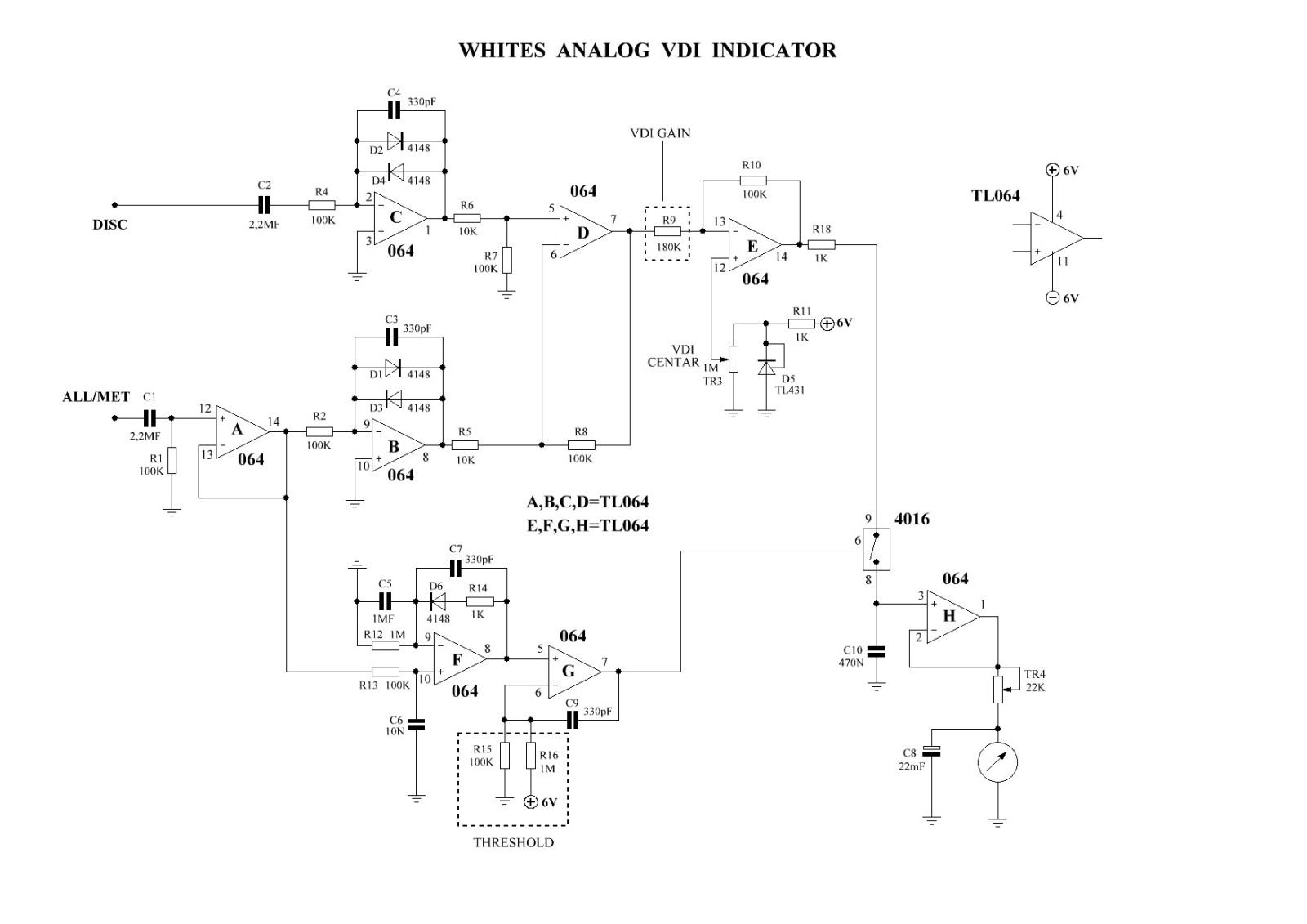

                      I have built the one that Gurdal shared, second page and post #27. It must be from a russian forum, you find the schematic and the lay file in the rar. Made some little modifications for my components thats all.

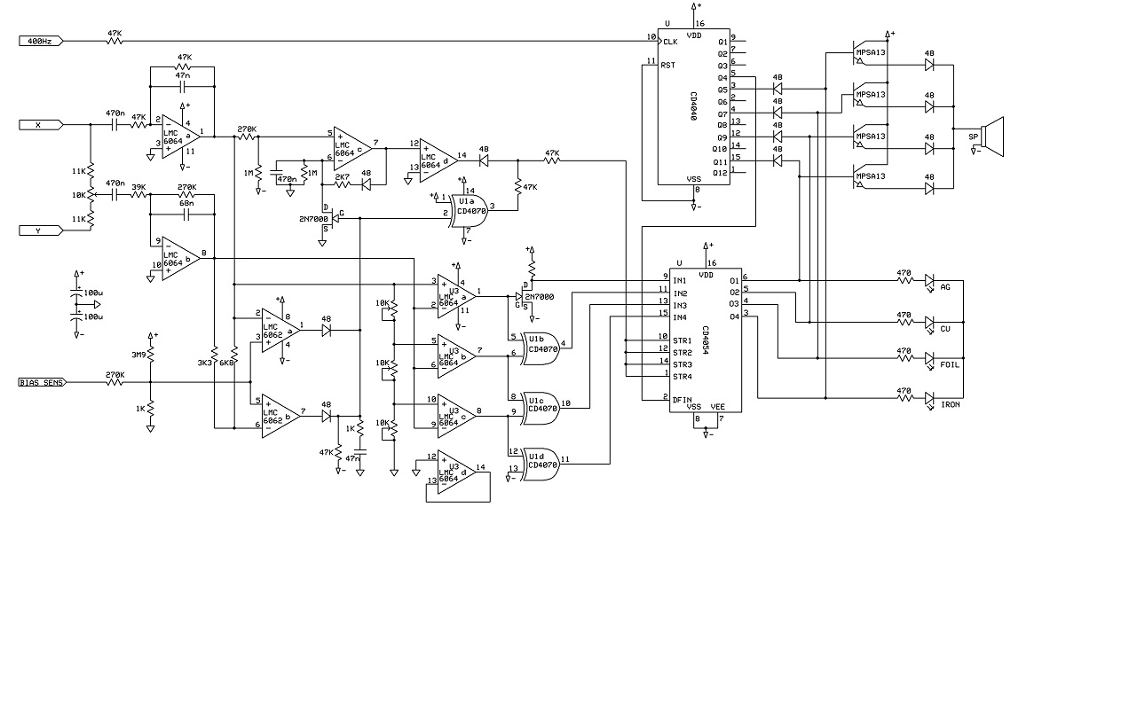

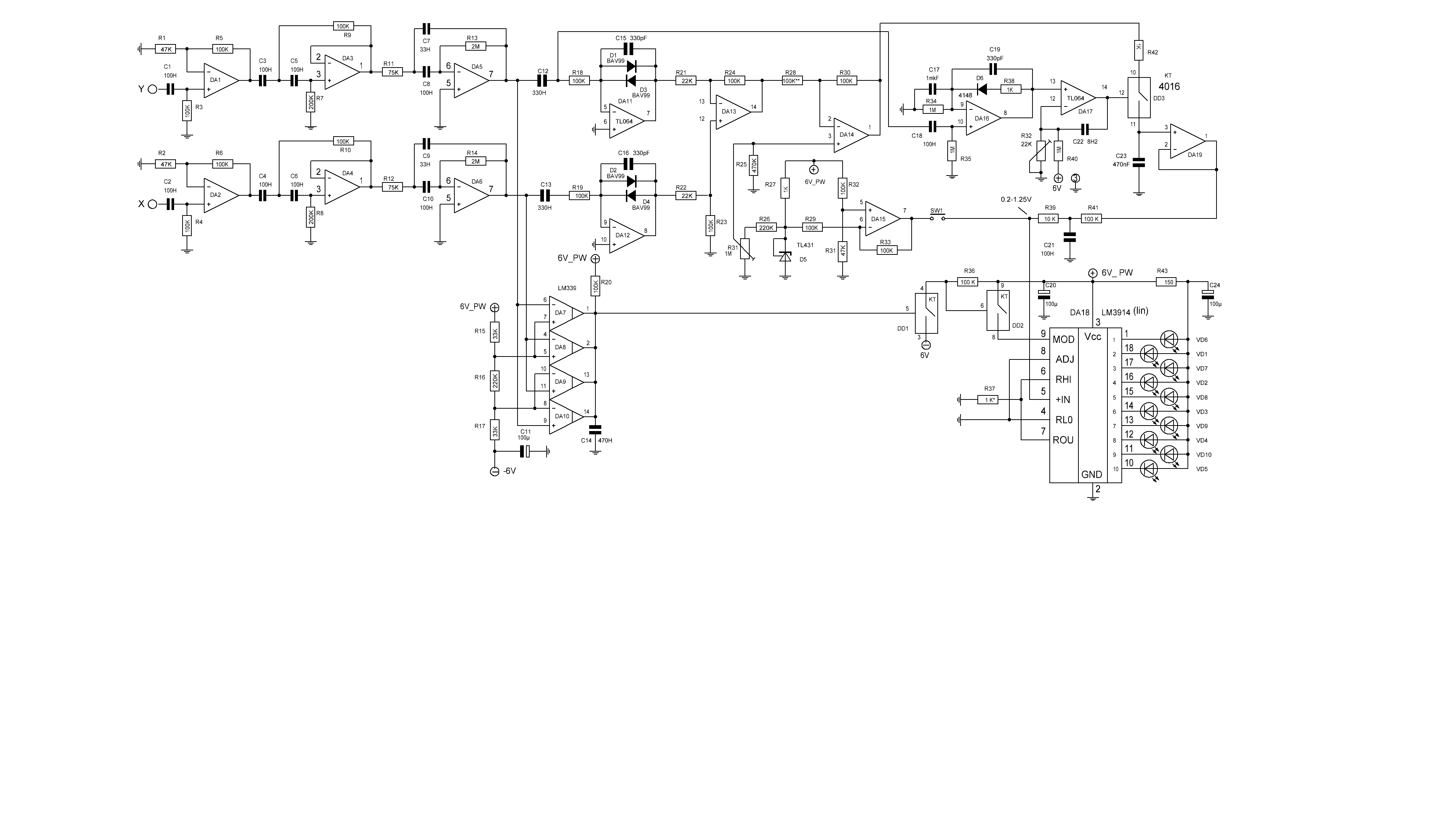

                        Ok... Perhaps someday if I have time I will make PCB for that. I dig a little randomly in md4u got this scheme similar to Gurdal version I suppose, It's from vlaser, he did a lot efforts on that forum. I hope we can learn more..Click image for larger version

                          I found old post around toltec it has analog vdi inside, so I'll be putting here it's a high class artwork by Merc, thanks to him for this.

                            I have both schematics, the second I think is from Eduardo. The Whites patented schematic is very similar. It has phase windows and each has to be preset with potentiometer, thats how the ID series vdi works basically it's analog with LCD.
                            Toltec is very interesting it has separate channels for the RC4200, looks like one fixed and other for hot rock very interesting. There are RC4200 on eBay but they arent cheap and also transport taxes.
