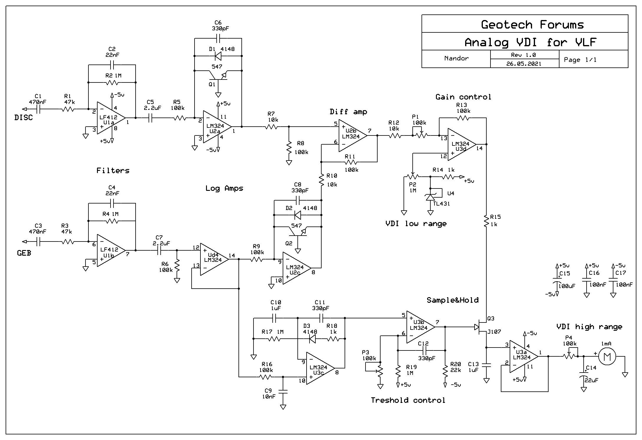

        There is a part after the log amps from the Geb channel that triggers the treshold level when there is a metalic object only, its like a ground exclusion balance so the VDI does not indicates ferrite or soil effects. I have measured the output some times it's almost square sometimes distorted waves depends on the target response.
        Sometimes I use "Ink paper" copy method and make my pcbs with marke it looks good and I feel good making something by hand.
        This is the schematic on which I was working on and I would like to try.

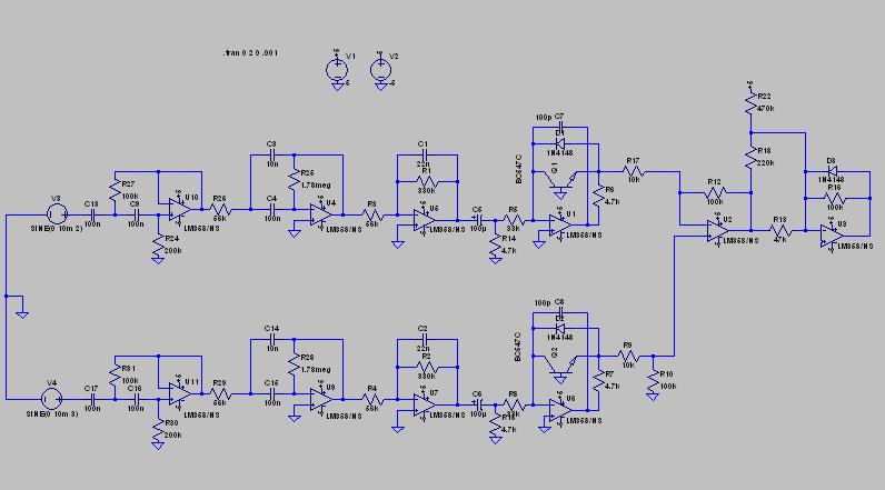

          In your circuit, you use the White's log amps. After the difference amp, l see you vary the design. Extracted your schematic. I had almost forgotten about Express sch. Software.

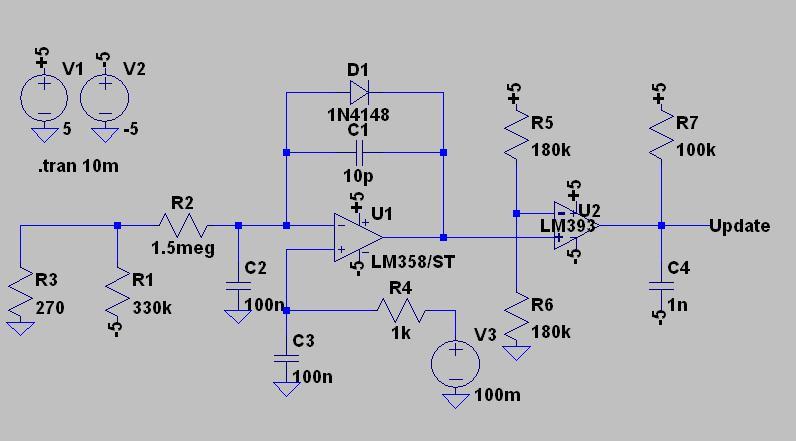

            In White's design, after diff amp, there is a stage with a feedback diode, l not sure what it does. I did simulation of this stage standalone in Ltspice, l put 10khz square waveform input just to see the output waveform, it is a triangle waveform output, which l think is integration? There could be some math going on there. This stage combined with the previous log amps stages are doing something together perhaps critical to proper target ID function.

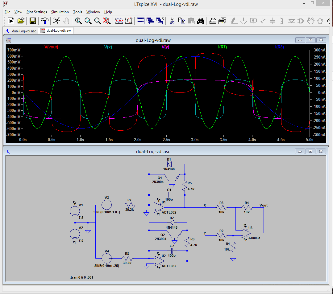

                So at the output of the log amps there are log x and log y. Then after the difference amp we get
                Log x - log y = log(x/y). So that's at the output of diff amp.
                • #83
                  Then comes the stage with the diode in the feed back loop, which I think is another log amp( whose output decreases with increasing amplitude), so now we end up with log( log(x/y) ? Somehow this all works out to present target info on meter. There is a little compensation and adjusting going on just prior to the meter, but that appears to be it.

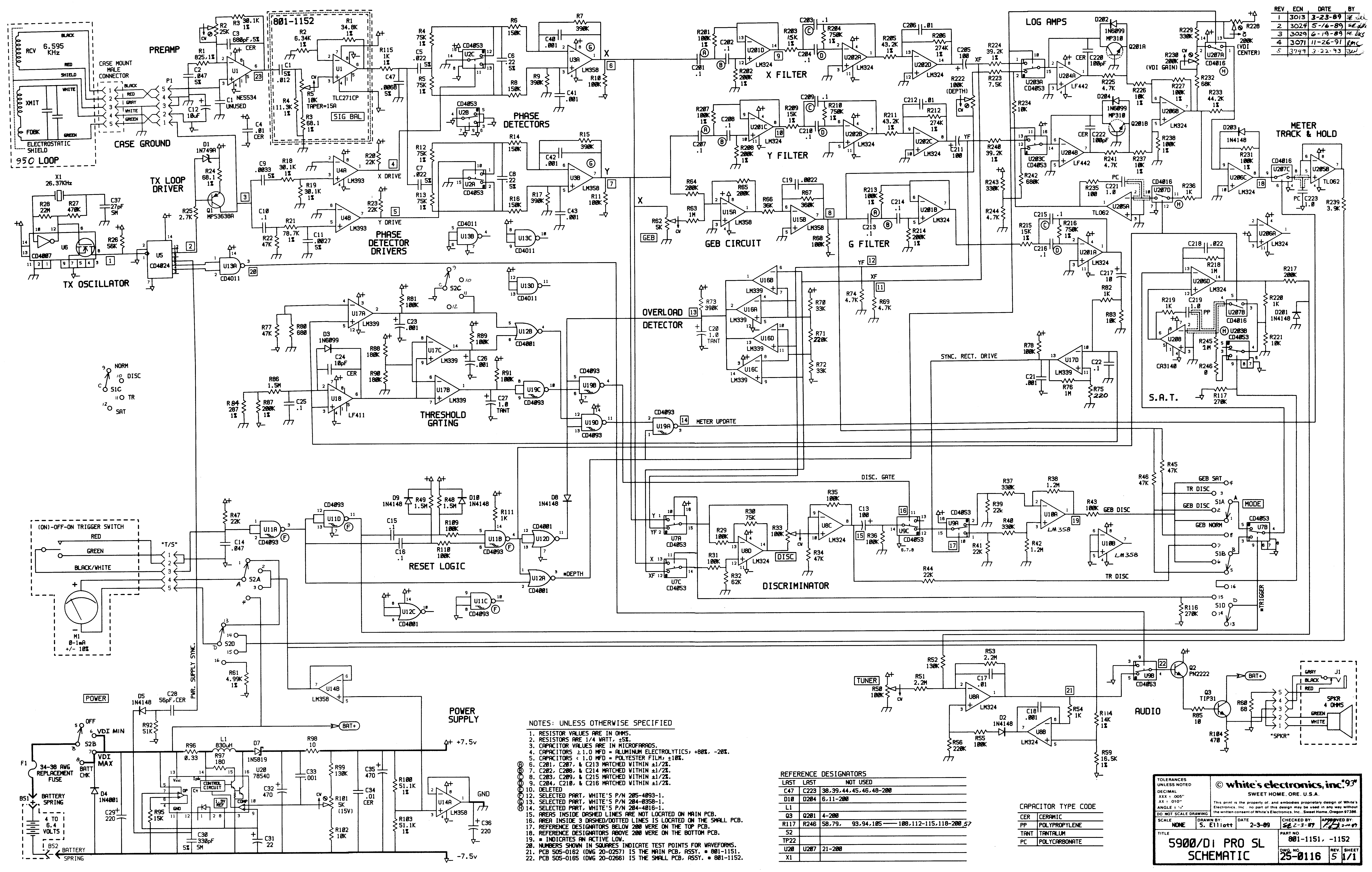

                      I found some simulations of the whites circuit.
                      I remember this was discussed in the past.

                        One curious thing I observed from the whites 5900/6000 schematic is that the Y channel feeds directly to filters and then into the y log amp. Whereas THE X CHANNEL IS INVERTED by an extra inverting amplifier stage prior to feeding into the X filters and then into the X log amp. It is clearly shown and labeled as" x channel inverted"
                        So therefore the the x channel signal ends up at the input to the x log amp as an INVERTED X.
                        The Y signal is not inverted.
                        Don't know why.
                        • #87
                          This schematic shows x inversion after the demods.
                          Not sure.

                            I told you before, if my way of understanding of this circuit is good than it is the ground balance. Thats why X channel is used, my first prototype has no ground balance and it shows ferrite like a good target. That part samples and holds the output of the signal difference and triggers only if a metalic object is detected because Disc channel reacts to soil and that signal phase difference is enough for the diff amp to produce an output.
                            I did not found these, before this topic I searched a lot here and on russian forums but did not found any simulations or working pcbs with meter indicator. You made it

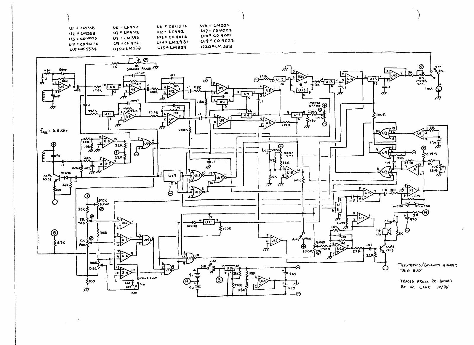

                              Big Bud metal detector has target ID meter circuit. There are few variations of the big Bud series. The circuit used to obtain target information looks very different than White's circuit. I see a lot of CMOS bilateral switches are implemented.

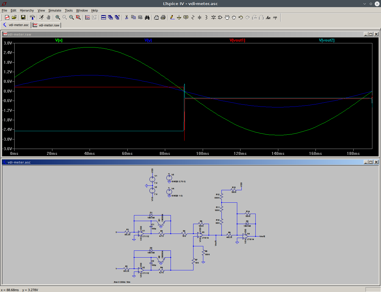

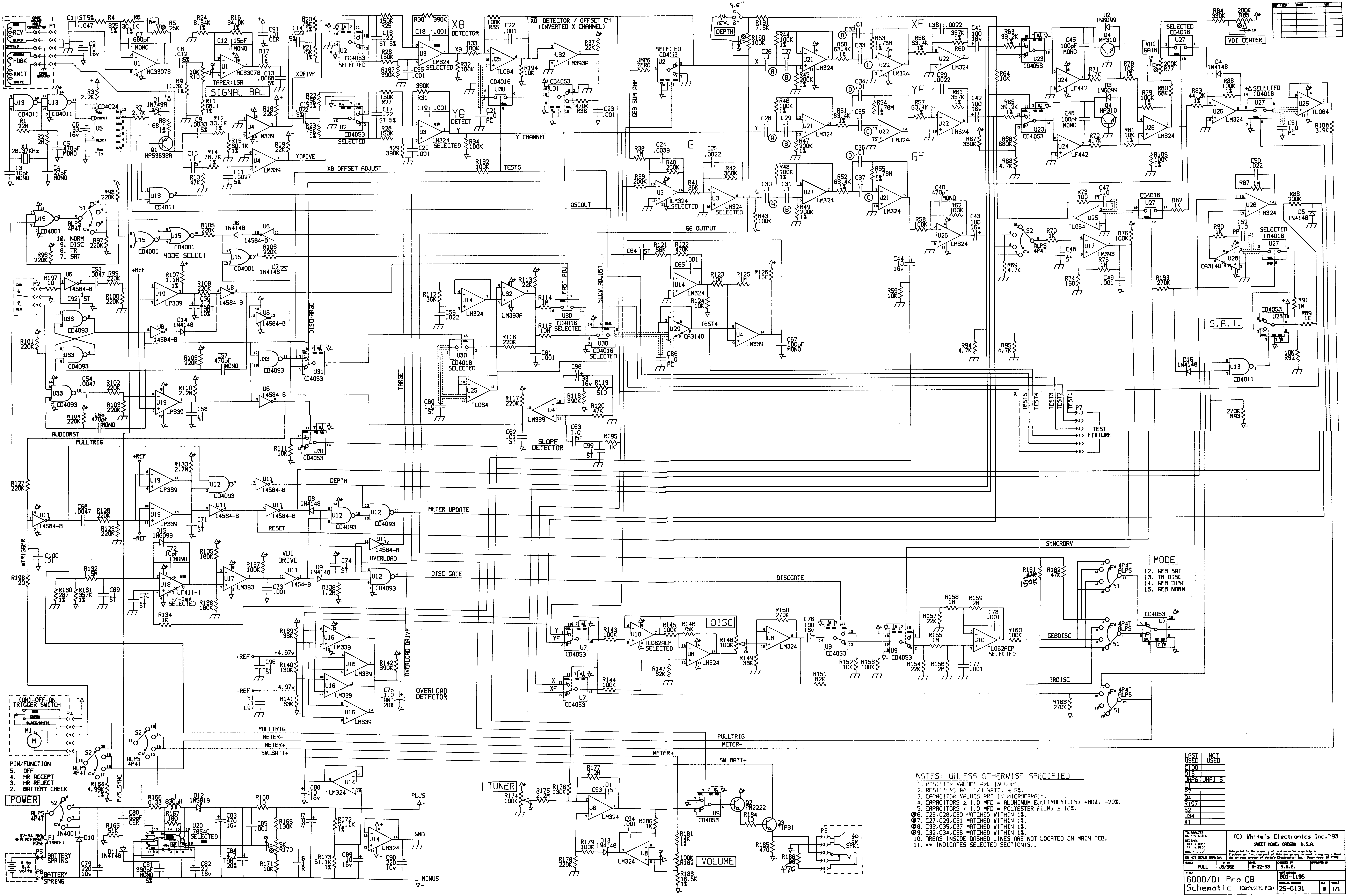

                                The meter update drive circuit from the Whites 6000DI. The input is taken from the "G" channel. The circuit output is active high logic level.
                                I cut and pasted input V sources only to verify that the main circuit is electrically sound. Actual working conditions are not derived here. The 6000DI features full wave synchronous demodulators. Perhaps this has some relevance on how the target ID circuit was designed.
