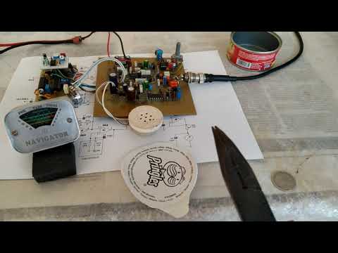

  • Thank you my friend , you gave me a very good idea about the log amps. I tried it and it works now!
    Also tested some Us coins I have, Monticello Nickel 5.2 and US Dime 7 out of 10 .

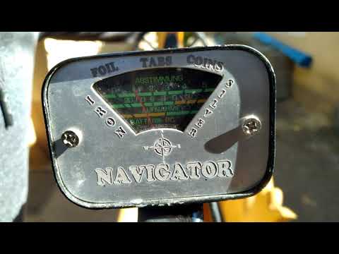

    Disc potentiometer is set to barely "touch" aluminium foil. Distance between the coil and the targets does not really effects vdi number, swept speed is more important.
    I would like to find a proper housing for it and if possible a smaller new Meter. It would be nice to find something like Whites analog meter, this part is very important.
    Also it has to be ampermeter or voltmeter? Maybe Carl can share some specs and info on the Whites meter.
    • Great work! These retro circuits are interesting to study and build.
      Have you hooked a digital volt meter to the output? It would give you ID numbers for each type of target. The Minelab Sovereign did this using a digital panel meter.
      Thanks for posting
      • Thats a nice idea man. I have found a few Minelab ID meters on the net for sale. Would be interesting to see the schematic and the pcb and how it works.
        For now I am happy with the needle meter .

        • Originally posted by Nandor View Post
          It's a 1mA meter.

            • I can't figure it out . On the weekend I will try share another video and some pics with the probes connected to the test points.
              regards!
              • Analog 1mA meter is connected in parallel with circuit as voltmeter. Series trim resistor adjusts meter high end

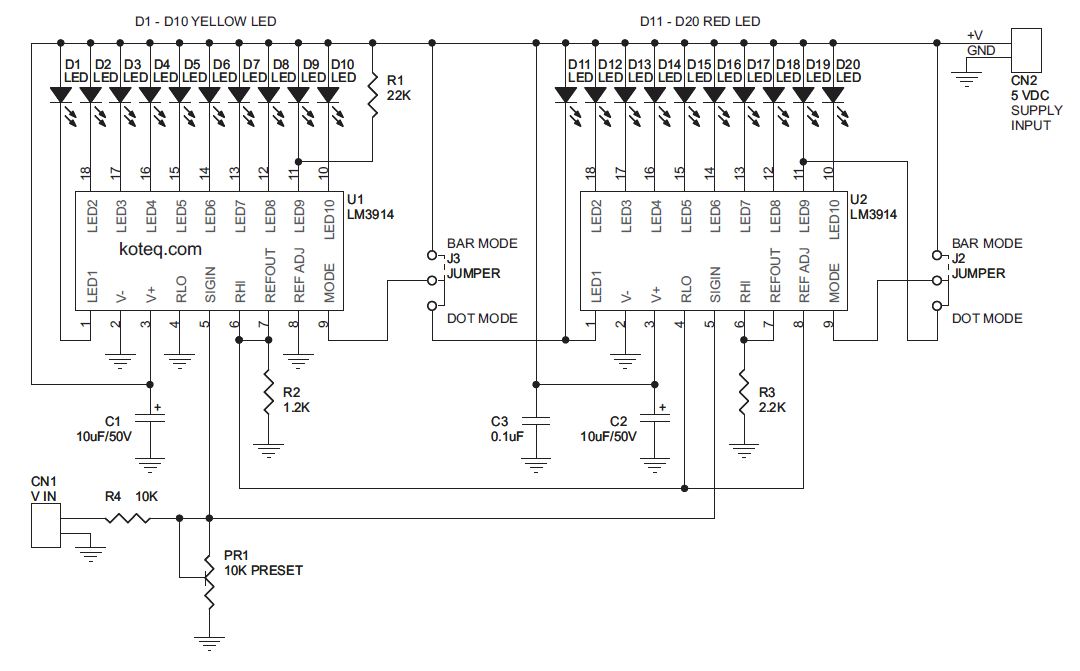

                20 led voltmeter in dot mode using two LM3914, perhaps could make a good display.
