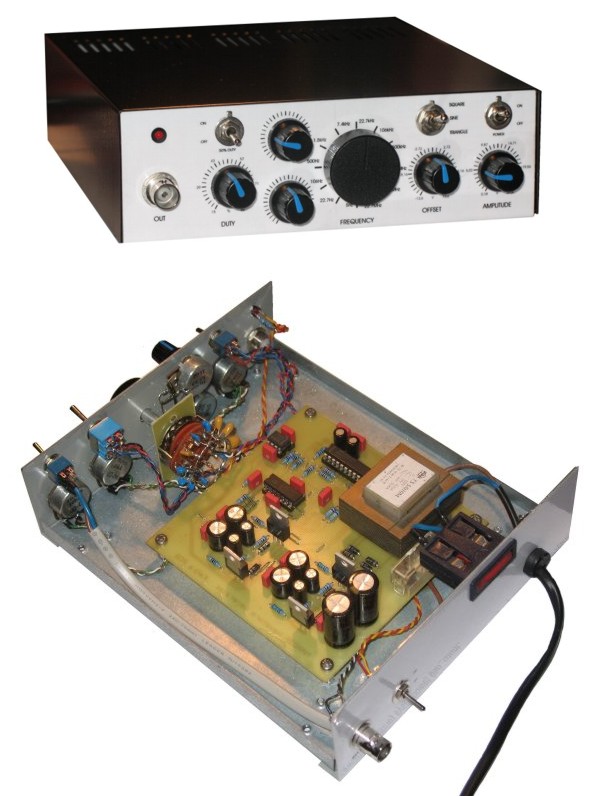

                    I found out that you can still purchase plenty of MAX038's and I sure like this circuit I found today !!!....... Yes , the AD9833 is a superior or better chip , but the external circuits I found for it are much more complex and software is required . I think Maxim is stupid to discontinue the MAX038 chip........Here is one of the D.I.Y. "do it yourself " signal generator circuits I found , the pdf schematic and the Authors prototype photo . I will post more generator circuits using both the MAX038 and ones using the AD9833.........Regards..............Eugene

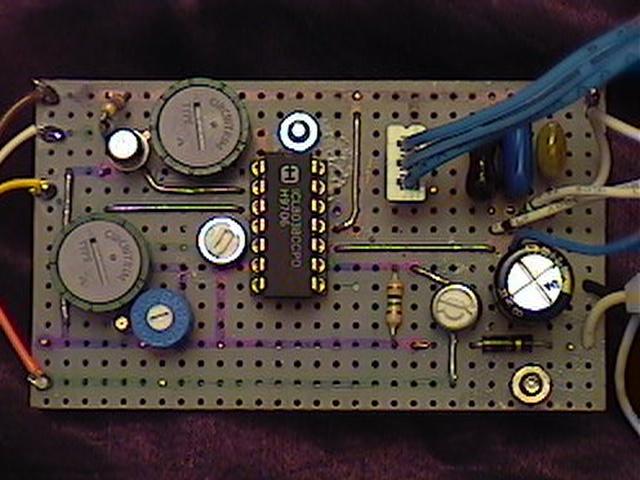

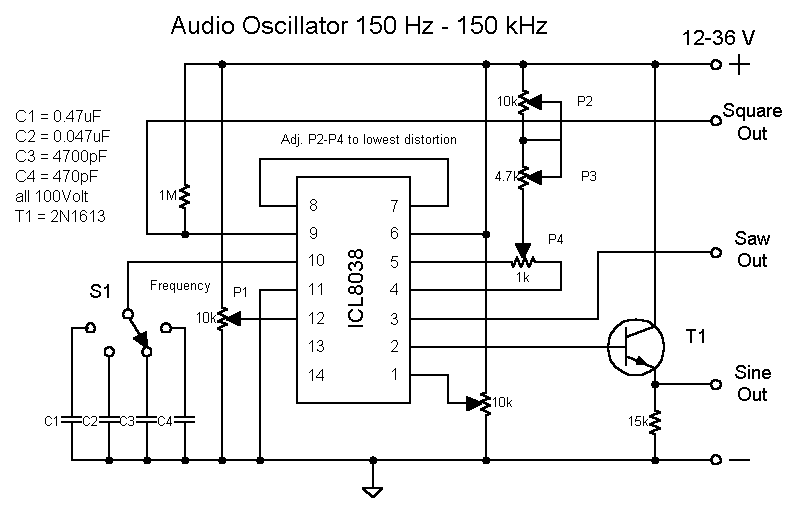

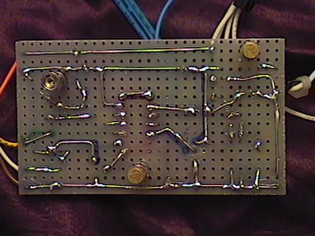

                      Here is another great little circuit from 2003 !!! 5 years ago !!! The ICL8038 is $18.00-$22.00 u.s. dollars , way over priced but still available in limited supplies........Regards...............Eugene

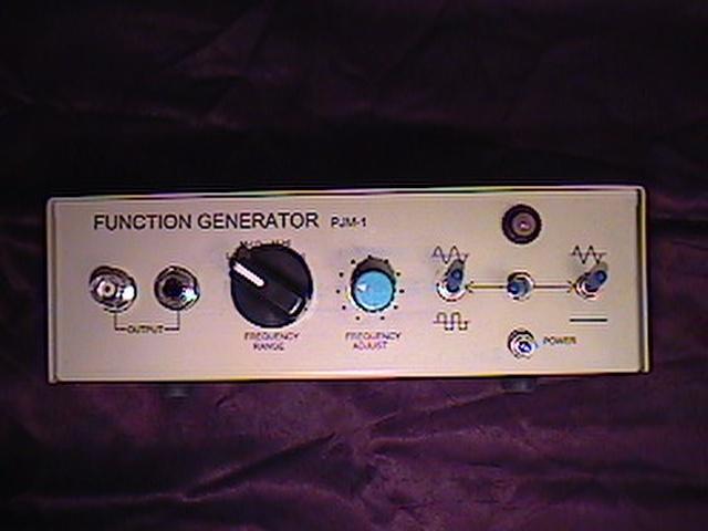

                        I found another function generator project . What I did on this one is , I put everything together in one zip-package . This project "KIT" is no longer available -anywhere . It can still be built and again , the MAX038 I.C. can still be found , if you search......This project was originally from a 1996 electronic magazine , and since the MAX038 i.c. chip is officially discontinued . It is ok for me to post this here , on this Great Forum.........Cheers...........Eugene
