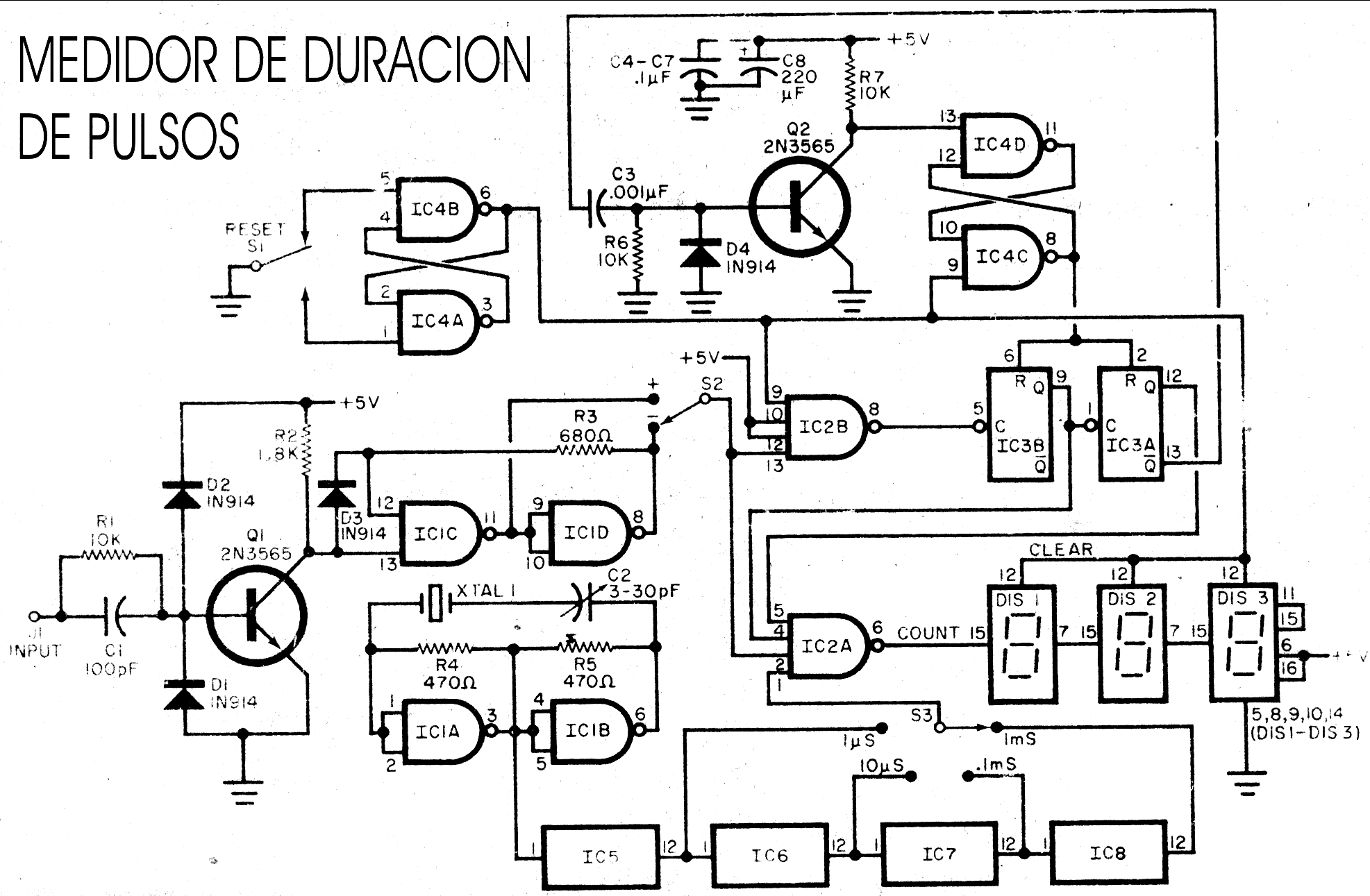

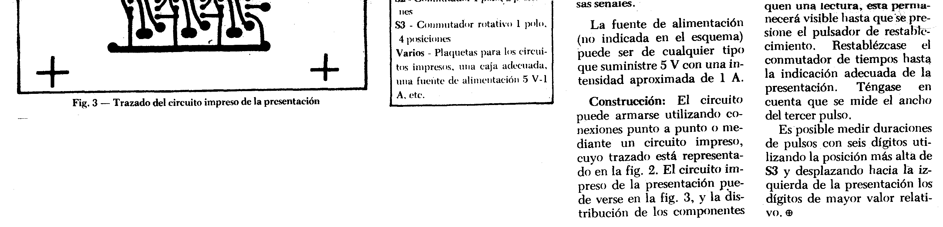

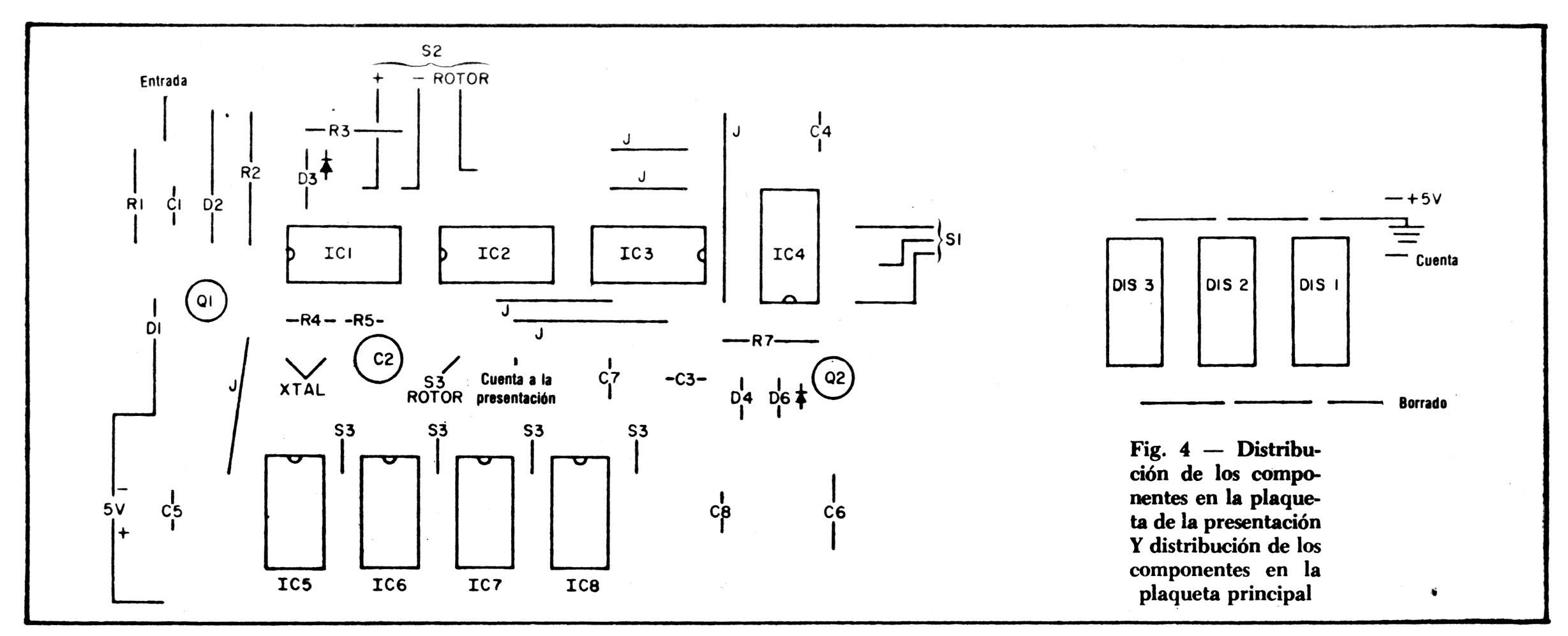

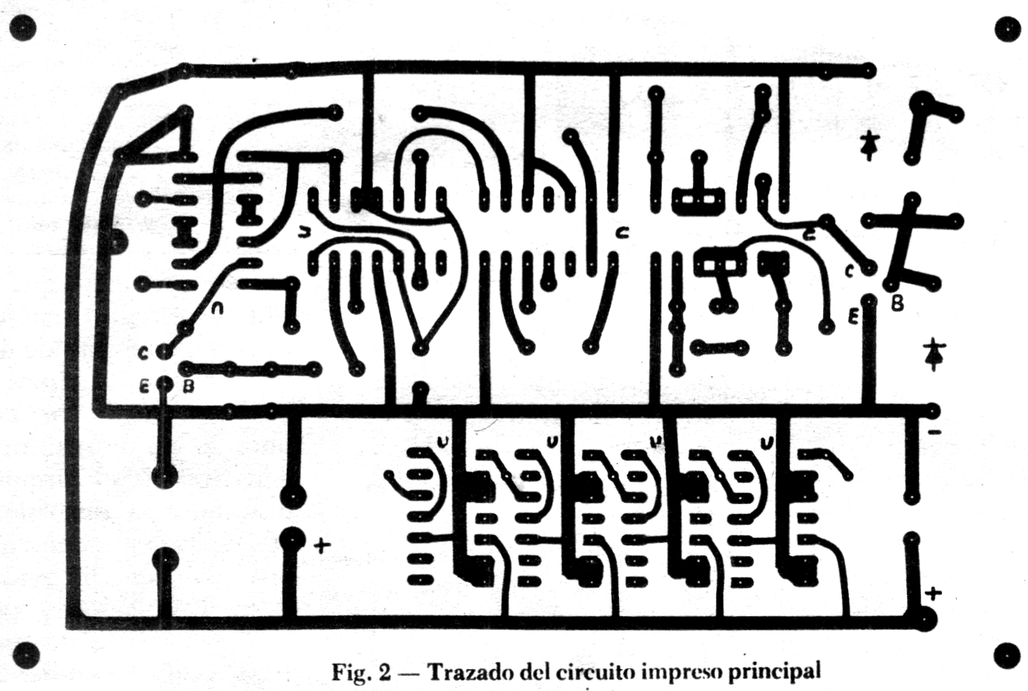

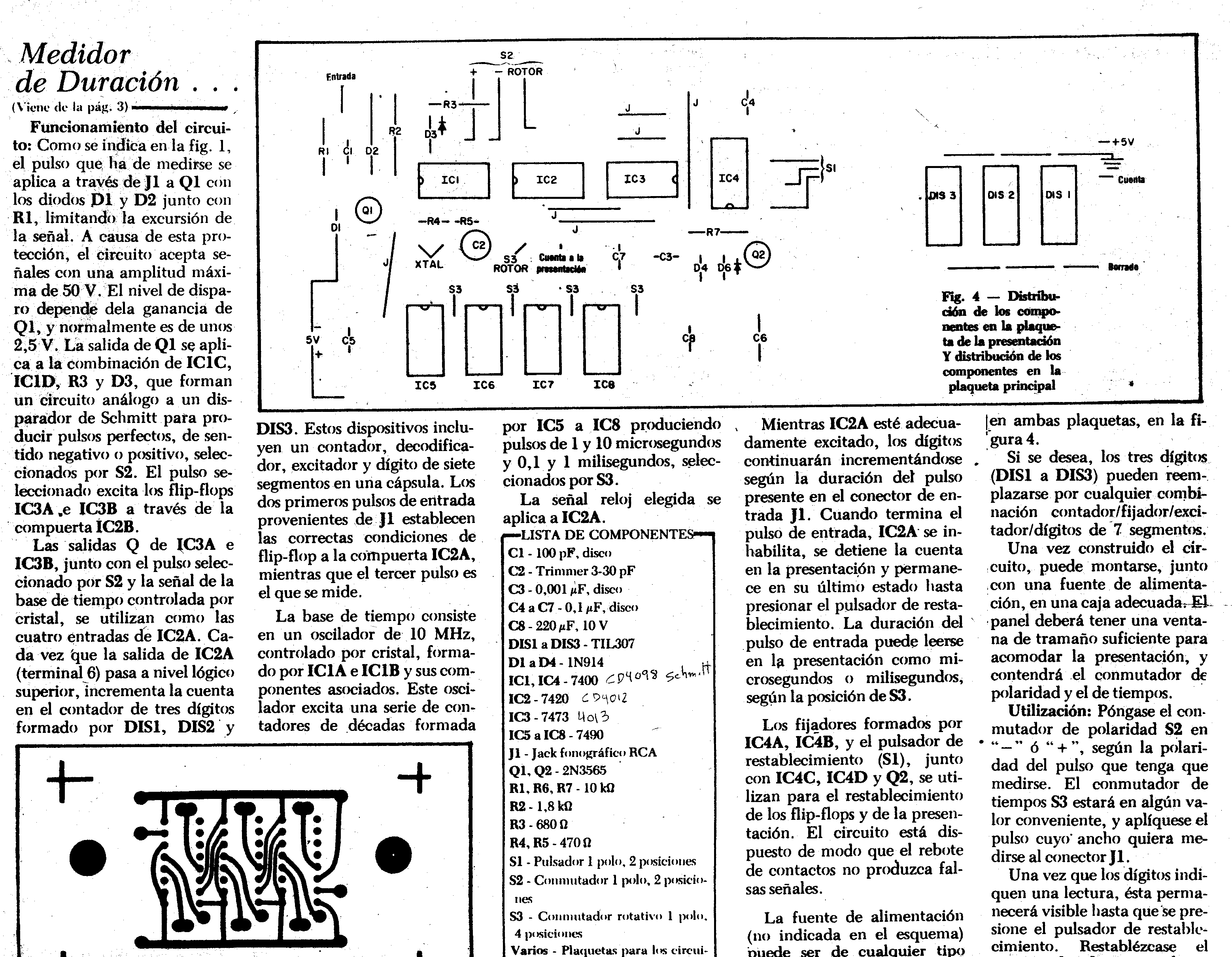

      Les envio un medidor de periodo, lo utilizo para realizar las mediciones de los periodos de los tiempos del detector tipo pi. el contador cambio por el ci 74C926 de 4 digitos, funciona ok!!!
      Carlos
      They sent a meter of period time, use it for measurement of periods of time detector type pi. I change the IC for the 74C926 with 4 digit display, it works ok! there is in spanish
      Carlos

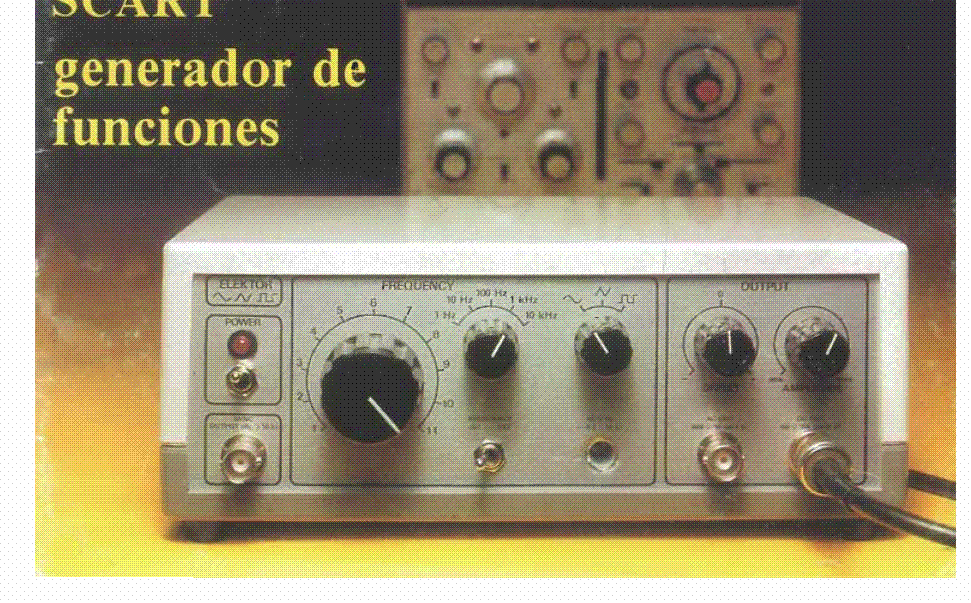

          Thank-You Fred and Carlos for your posts and input . The most important piece of test equipment , besides an oscilloscope or power supply is a Function Generator , But it must have a very , very low signal to noise and low THD !! I am still searching the internet and will post a few more generator circuits . I will try to put the real good ones I find , in a zip-file for easy reference . I know a good piece of test equipment can sure help to isolate noise problems or chatter with the Tesoro Golden Sabre Light circuit !!...........Regards............Eugene
