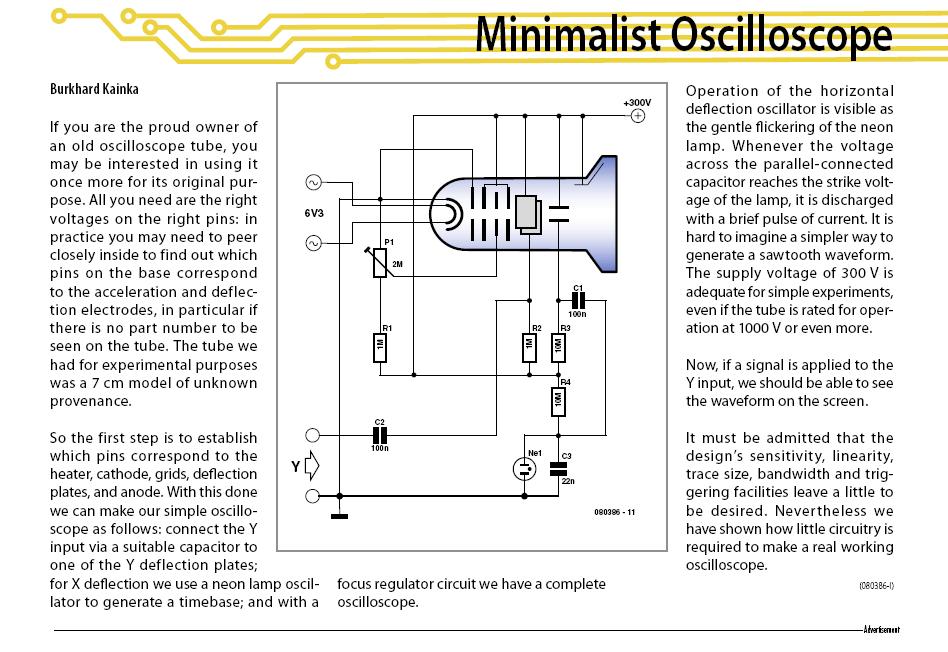

        Just for the fun ...
        • #49
          Build your own Test Equipment !!!
          Thank-You for posting the "Minimalist Oscilloscope" Fred , It brings back many memories for me . Years ago I owned a lot of tube-type equipment , from tube type oscilloscopes to many "Heathkits" and even had tube-type "Graymark" a.m. transmitter kits I bought and built , even had a "top of the line" V.T.V.M. , vacume tube volt meter . Some Memories can sure make the Altzheimers go away !!!!!....................Regards............Eugene

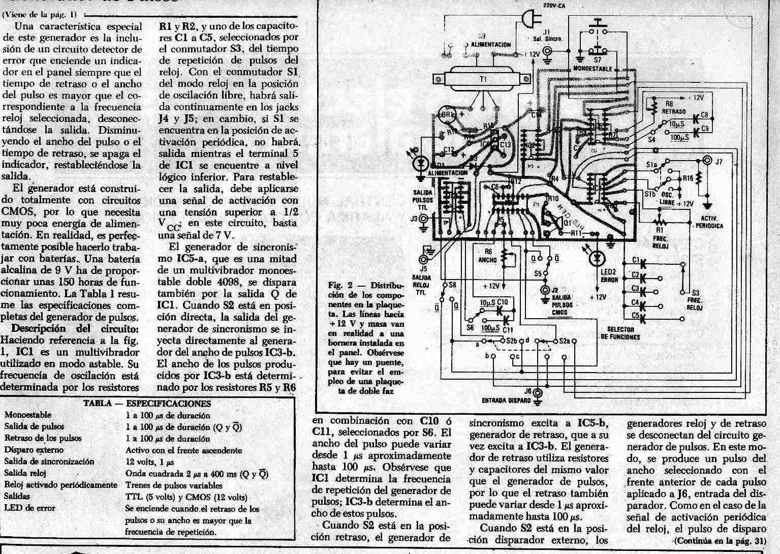

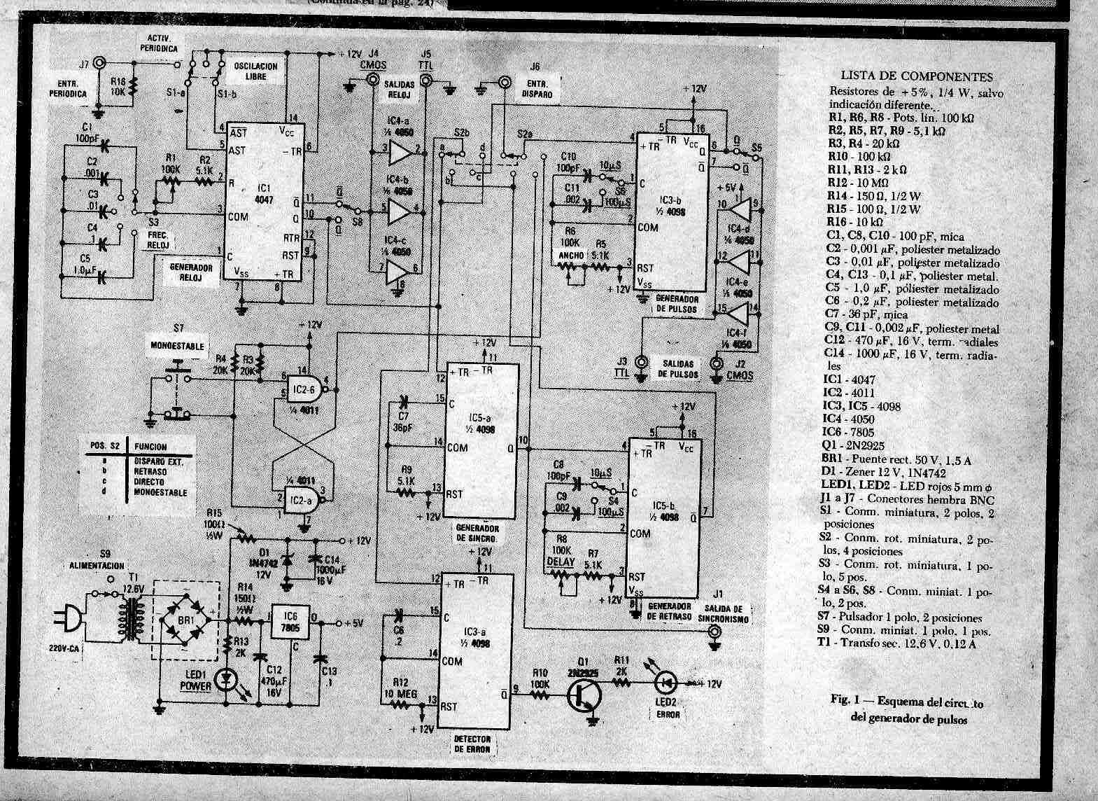

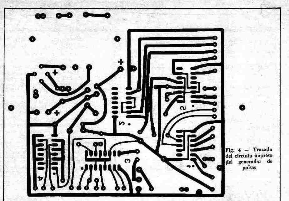

            Hola a todos, aqui les envio un generador de pulsos, indispensable para el laboratorio, las caracteristicas estan en la pagina 3 espero que les sea util a aquellos que trabajan con detectores tipo PI
            Carlos
            Hello everybody, here they sent a pulse generator, which is essential for the laboratory, the features are on page 3 I hope you find it useful to those who work with type detectors PI
            Carlos
            • #51
              Thank-You again Carlos !!! Just when I think we have a good circuit , another good one gets posted !!! Did you post the complete article ?? I have 7 pages here 201-207 ?. Now I am looking up the I.C. numbers because this article is dated 1986...............Regards...............Eugene
              • #52
                Yes, is all the article. it work very well. I build in 1987 and there are any broblems!!!!
                Carlos
                • #53
                  Carlos , this last one you posted is the best !! It is in spanish , so if we need help we will contact you . Later when I have time , I will try to put this 6 page article into a new "PDF" folder for easy copying . We are now done with finding a function/signal generator !!! Next on our search will be for a schematic of a Good and Cheap "inductance meter" !!..............Regards....Eugene

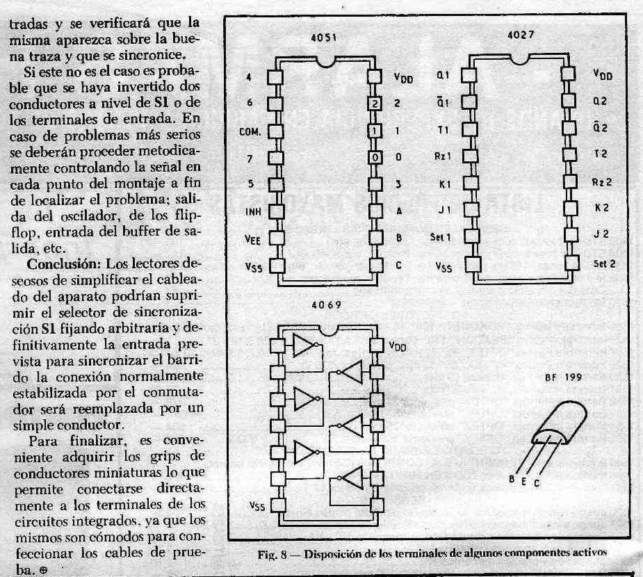

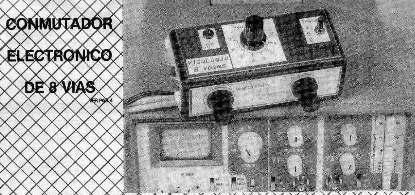

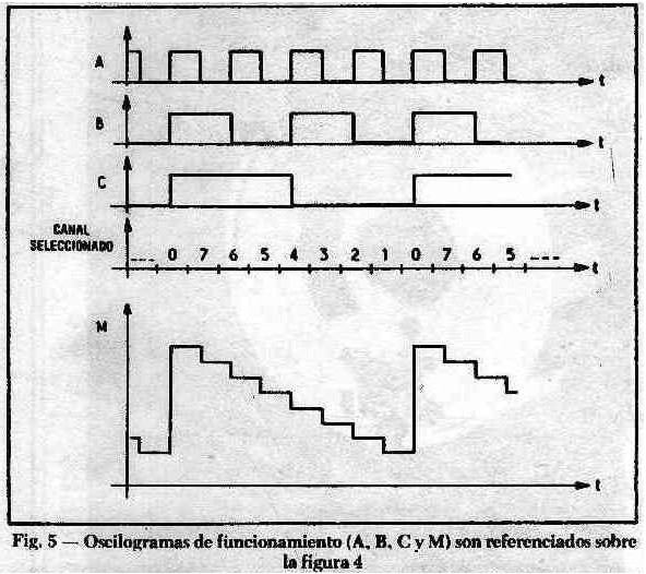

                    Hola a todos, adjunto a esta les envio un circuito de un conmutador de 8 canales para acoplar a un osciloscopio de un solo canal, asi el osciloscopio se transforma en un osciloscopio de 2 canales, 4 canales y 8 canales. Yo no lo arme pero seguro que funciona, dice el articulo que es especial para circuitos CMOS y TTL.
                    Carlos
                    Hello everybody, this attachment to send them a circuit of an 8-channel switch to attach to a single-channel scope, so the scope is transformed into a scope with 2 channel, 4 channel and 8 channel. I do not build but sure that it works, says the article which is special for CMOS and TTL circuits.
                    Carlos
                    • #55
                      more pictures of the circuit
                      Carlos
                      • #56
                        Carlos , Hello again . Is this a 8 channel oscilloscope input adapter ?? Will it accept a standard oscilloscope probe for each input ? Say 50 a ohm impedance to 100 mhz probe ?? Do not forget "Inductance Meter Circuit" next "please" !!!.......Thank-You................Eugene
                        • #57
                          Si, es correcto lo que dices, aca usan cable comun para cada entrada, solamente cable blindado con BNC para la conexion en la entrada del scope y el sincronismo. Si alguien maneja mejor el ingles que yo, podria traducir el articulo ya que no tiene ningun desperdicio su lectura. yo cuando tenga tiempo lo hare para un total de 4 canales ya que mi nuevo scope portatil es monocanal. Sobre el medidor de inductancias, hice alguna vez uno pero se necesita un frecuencimetro para que con la formula Thomson se descubra el valor de la inductancia. Por eso me compre un MASTECH MS-8222H.
                          Saludos
                          Carlos
                          yes, what you say is correct, here the common cable used for each entry, only shielded cable with BNC to connect at the entrance and synchronism. If someone manages to better English than me, you could translate the article because it has no waste of the reader. when I have time I will, for a total of 4 channels because my new scope is a single channel. Inductances meter, but I did ever a need for a frequency with which the discovery was made Thomson the value of the inductor. That's why I buy a MASTECH MS-8222H.
                          Greetings
                          Carlos

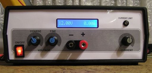

                            look this site for the power supply
                            http://www.electronics-lab.com/proje...003/index.html
                            Carlos
                            • #59
                              Very Nice !!! I see the schematic , the parts list and the photo of the other LCD project , but they do not give any prices !!! Like if you want to buy the PCB board of the 1st power supply ?? ...Thanks for posting Carlos................Eugene
