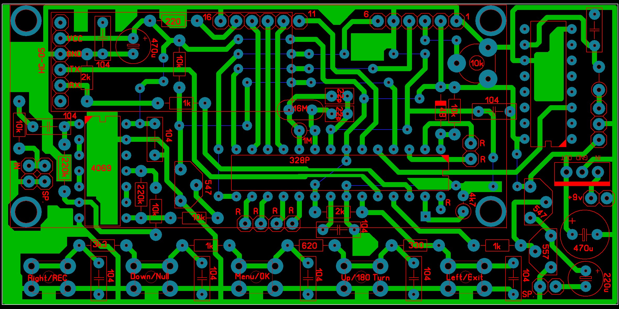

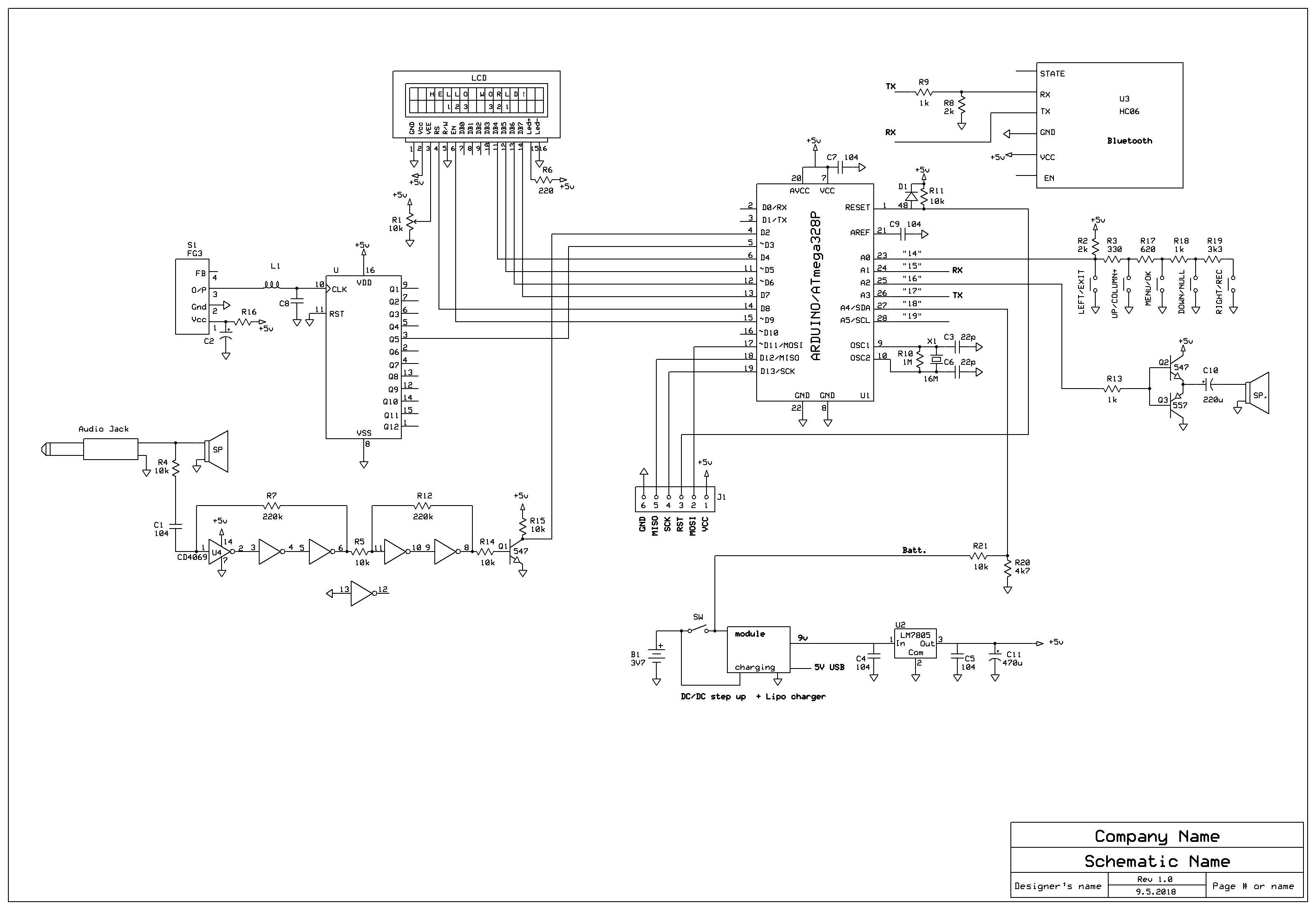

                            This is final version, including not only PI audio logger but also addition of one fluxgate FGM sensor logger too.
                            Idea was to place FGM sensor in the centre of PI coil and use it for the discrimination.
                            Or FGM can be mounted on different "stick" and used as fast probe.
                            This is further modular, can be only PI logger or only FGM probe, by omitting extra parts.
                            In this version i used audio signal to poll the digital pin in interrupt.
                            Since i designed this mostly for use with Pulse Star II detector, which is giving variable (rising and falling) pitch at the audio.
                            So, not only that i can log plain audio response, i can log the "pitch" too, by counting the frequency of the audio pitch.
                            Which is much better information at the end.
                            This is still commercial product, so i am not ready to disclose everything. Code for MCU and code for Windows & Android.
                            So don't expect that from me.
                            But it is still illustrative enough.
                            Using digital pin polling in interrup is rock solid , stable and 100% accurate method.
                            Although using the ADC might work as well. But for better results it will demand better ADC and more processing power.
                            My initial attempt was the use of the ADC. I was not satisfied, since Atmega328p can not give rather usable resolution for what i wanted.
                              By plugging the audio jack into Pulse Star II socket for earphones; you don't lose the audio.
                              There is anotther speaker inside the logger enclosure. So it continues the role of original speaker in PSII.
                              Also there is audio output from the MCU, for the system sounds (button clicks, warnings, alerts etc).
                              So there is another speaker in the logger enclosure too. Smaller one. Or even smaller piezo can be used.
                              Also is possible to use the same one speaker for both audio sources with a bit of rearranging the components.
                              So PSII keeps operating the same as usual. You hear it's audio from speaker included in the logger enclosure.
                              There is a LCD too, showing various data and progress bar style graphical presentantion, and when in menu mode, showing adjsutment variables.
                              The "pitch" (frequency) of the PSII audio is precisely measuring and logged constantly.
                              Than from internal buffer taken and sent by BT to Android aplication.
                              All the 2D/3D processing then is done in the application.
