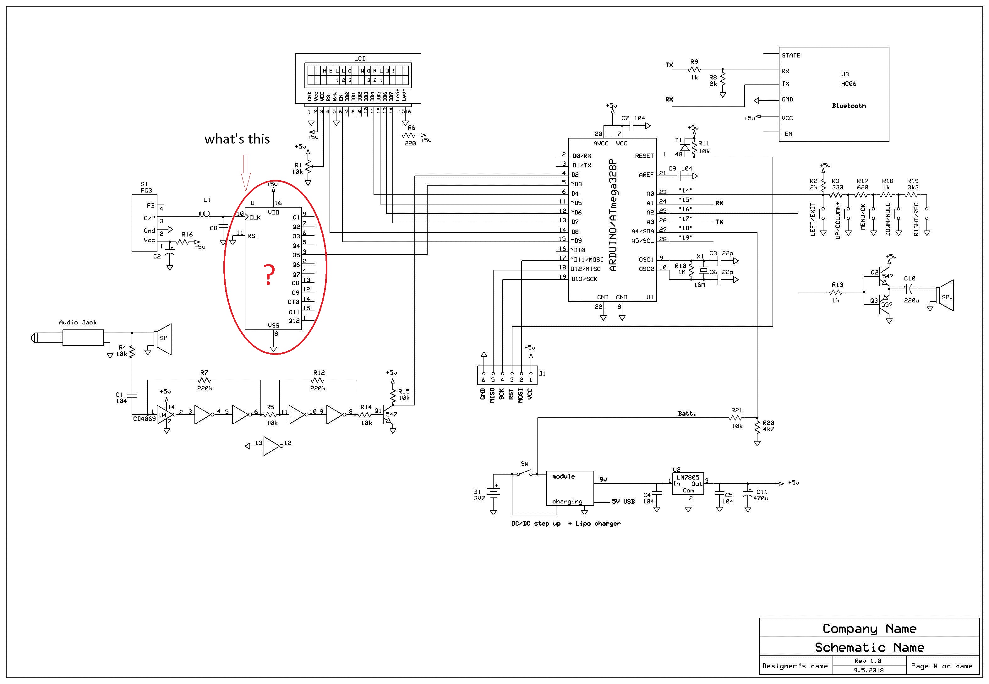

          Originally posted by AK48 View Post
          sorry , question
          [ATTACH]57189[/ATTACH]
          Not relevant for this topic so there is no label on it.
          It is a counter.
            It is a type 4040 integrated binary counter used here as a frequency divider (in this connection it divides by 32).
            Because the processor measures the frequency at the D3 input, it uses the INT0 hardware interrupt. To maintain the continuity of the program's operation, the signal from FGM3 is divided by 32.
            With a signal from the sensor in the range of 40 - 120 KHz, the processor would hang itself - in addition to measuring the frequency, the program does other burdensome things.
              Not only hangs, but chokes totally, when reaches 62xxx samples!

                  I also tested it once, which is why I went the way of direct measurement in T1. Simons in the first version of the DIY gradiometer divides the signal by 4 and everything goes - only there the program is skeletal and completely unloaded. Now in the new version it works on ESP32 but I did not look at what method it measures.

                    And to think that a dozen or so years ago Gradiometer fit me in 2313 but counted upper and lower sensor one by one, and today's CPU 8 bit are still getting better.
