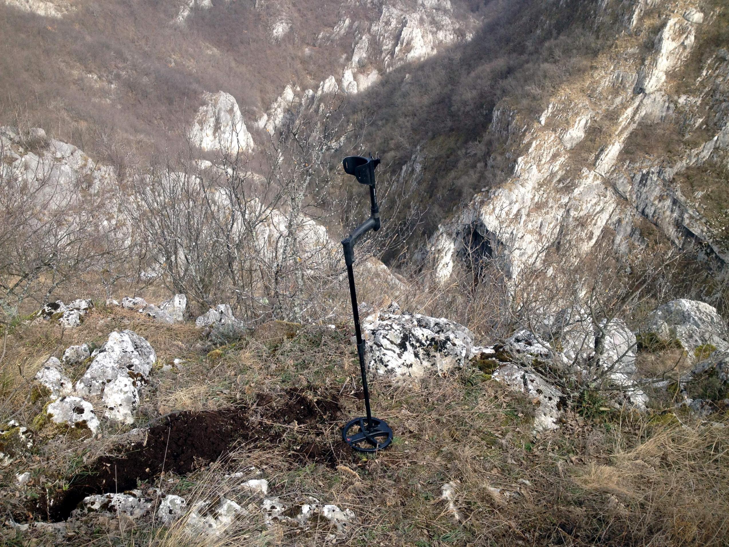

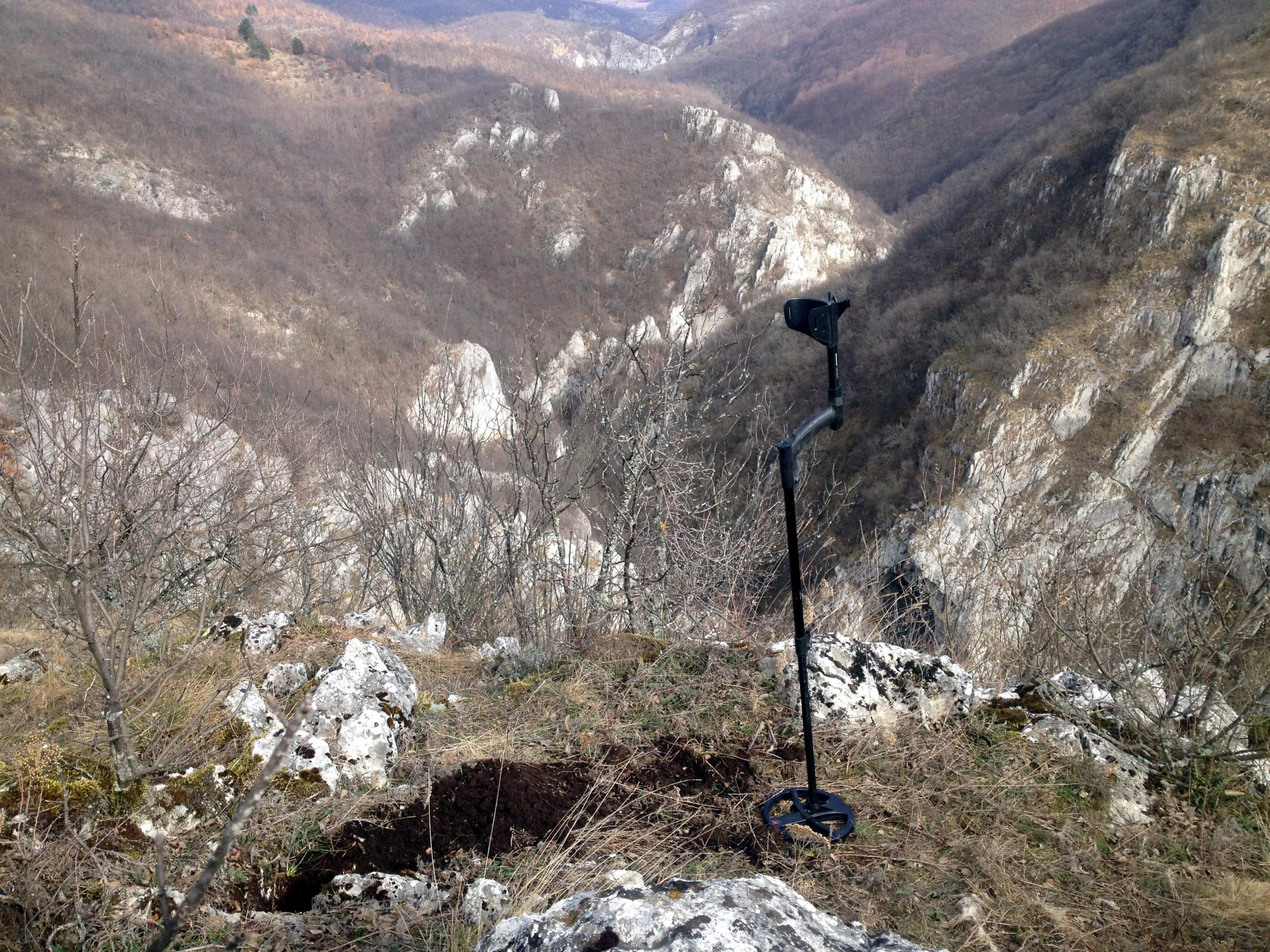

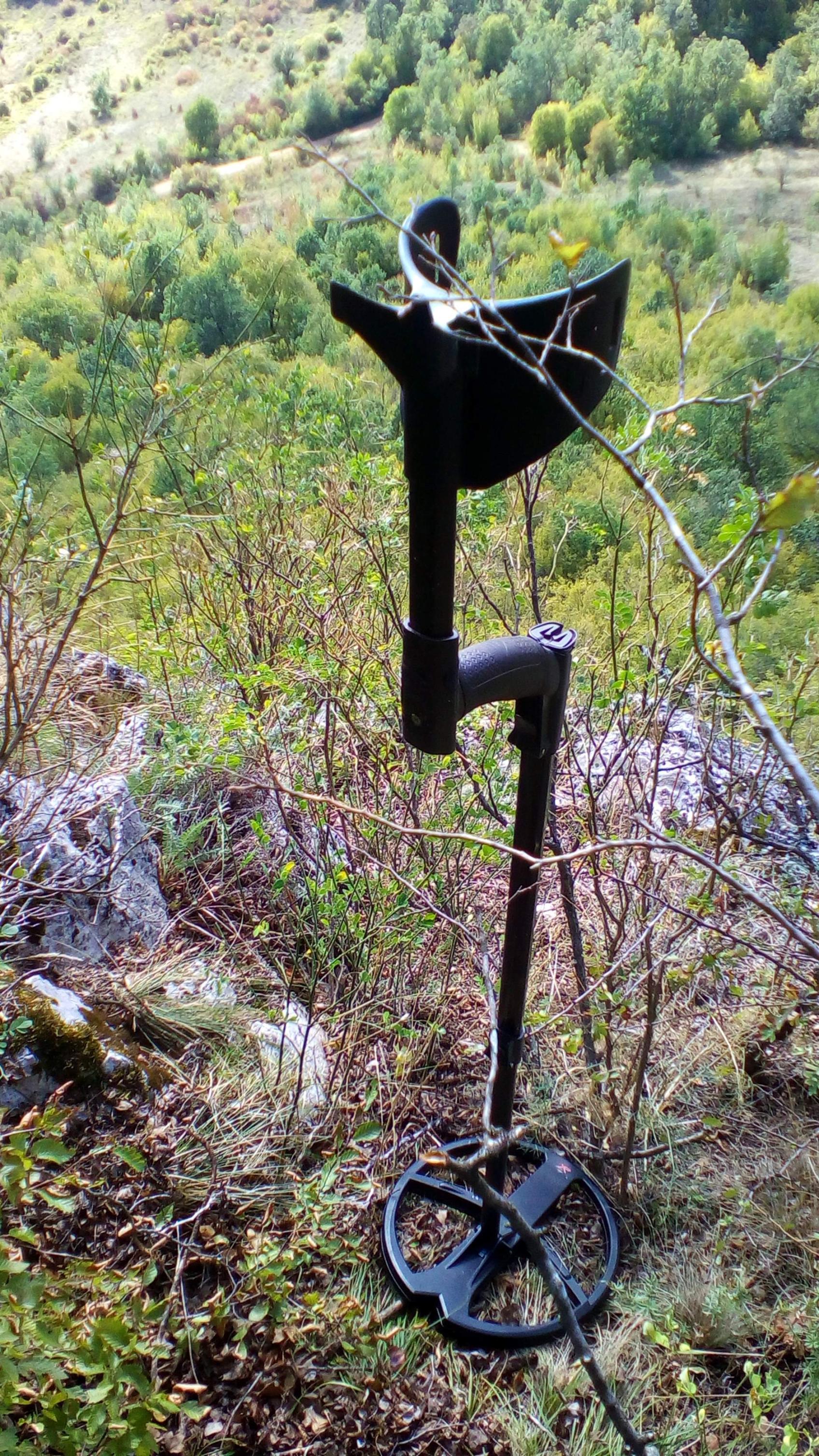

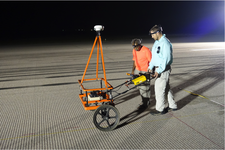

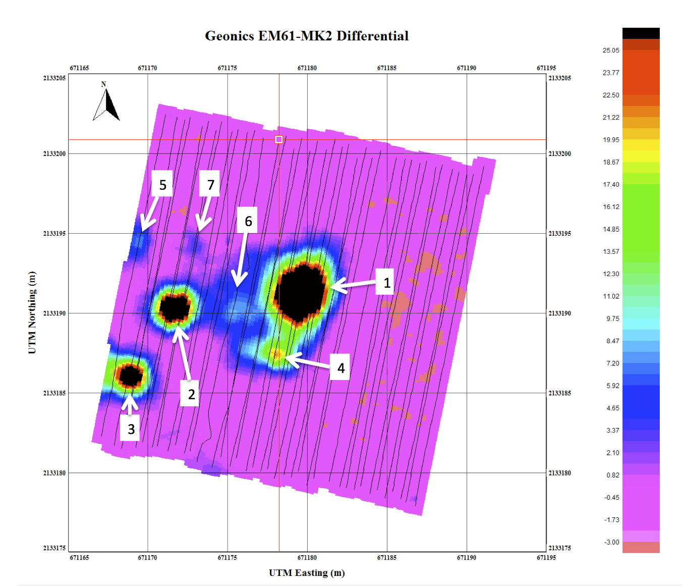

                    The most frustrating part about hobbyist and military metal detectors for me as a geophysicist is that they are still essentially analog output devices where the operator is listening for the whee-whee sound. In geophysics as applied to landmine, unexploded ordnance (UXO), and improvised explosive device (IED) detection all of our metal detectors for almost 25 years utilize the concept of digital geophysical mapping (DGM). An operator could be deaf and it wouldn't matter to us since the sensor output is saved along with the exact time and position of the measurement. Since selective availability (SA) was turned off for the global positioning system (GPS) in 2001, every survey done for any of the applications listed above utilized centimeter accurate satellite positioning. The idea of trying to find items in real time by the sound of the whee-whee seems ludicrous to me. I'm not sure how to bring the industry into the past, not the present, of geophysical instrumentation.
                    All of the metal detectors currently used for UXO detection fall under the advanced geophysical classification (AGC) banner. The instruments are time domain electromagnetic induction (TDEM) sensors with a sufficient number of time gates (~27+) to fully characterize the target decay curve. The receivers all have three orthogonal coils so that we can completely characterize the target response. A few of the systems have multiple orientation transmitter coils. With these systems we can detect 100% of the targets in the ground, discriminate 100% of the targets as UXO or non-UXO, and then classify 100% of the UXO targets by the exact model of UXO, depth to the target, and the orientation in three dimensions of the targets. I can't find a single hobbyist metal detector that will record all of the data at a reasonable rate (minimum 10 Hz, ideally 20 Hz) with a GPS position and time stamp. The Minelab CTX 3030 is the closest to a real geophysical instrument but it only saves the GPS log file and location of any marked targets, it doesn't save any of the data. I do have CEIA CMD CIED unit that saves the sensor output and GPS position, but only at 1 Hz.
                    I have attached one picture of a Geonics EM61-MK2 time domain electromagnetic induction (TDEM) metal detector being used on a project I led on Wake Island in 2015 as well as plotted data from the instrument. We also utilized a Trimble 5700 RTK GNSS base and rover for real time positioning. Geomar Software makes a real time display software for this instrument so you can see results as you collect. This is 15 year old technology in geophysics. The last time I went to Wake Island in 2019 I used a GapEOD UltraTEM-III six receiver array (3m wide by 1 m long TX coil and 6 three component receiver coils) towed by a UTV.

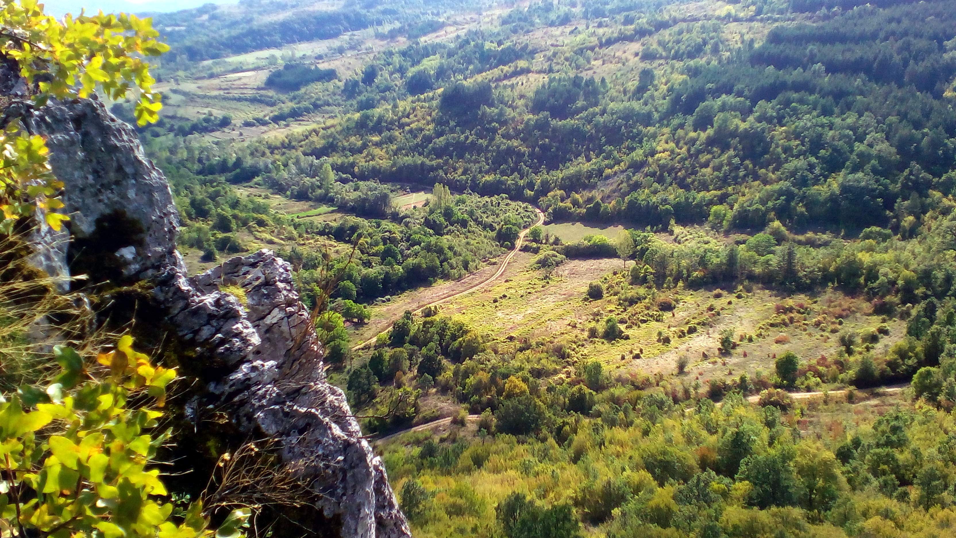

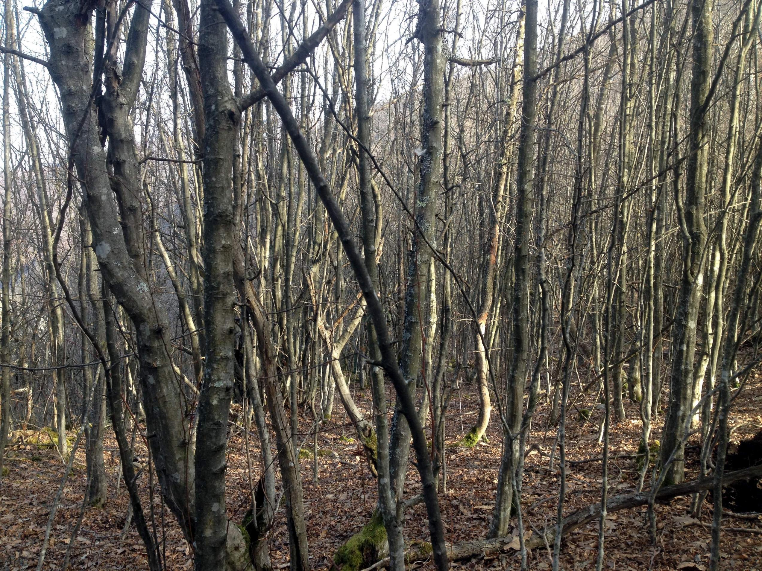

                      90% of the sites i've been visiting in last 35 years are like this:

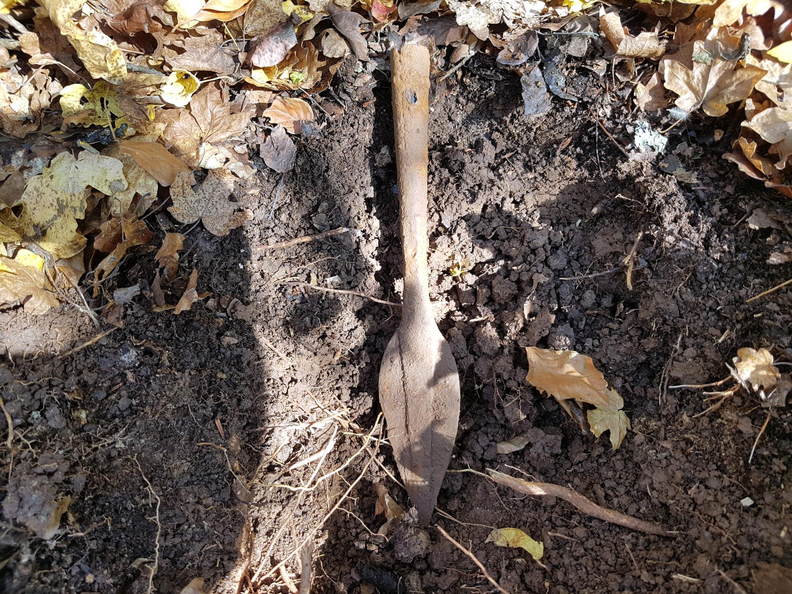

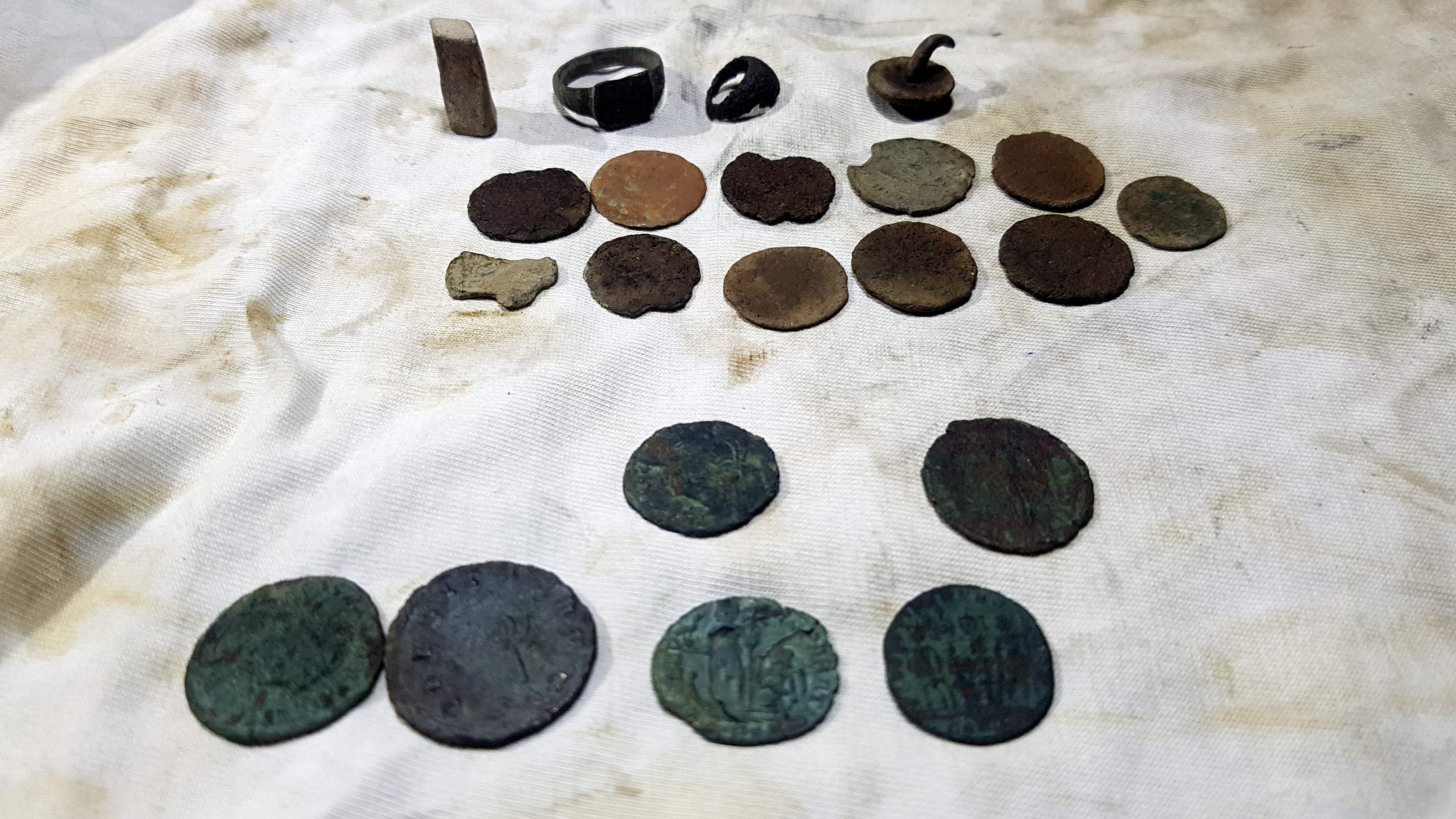

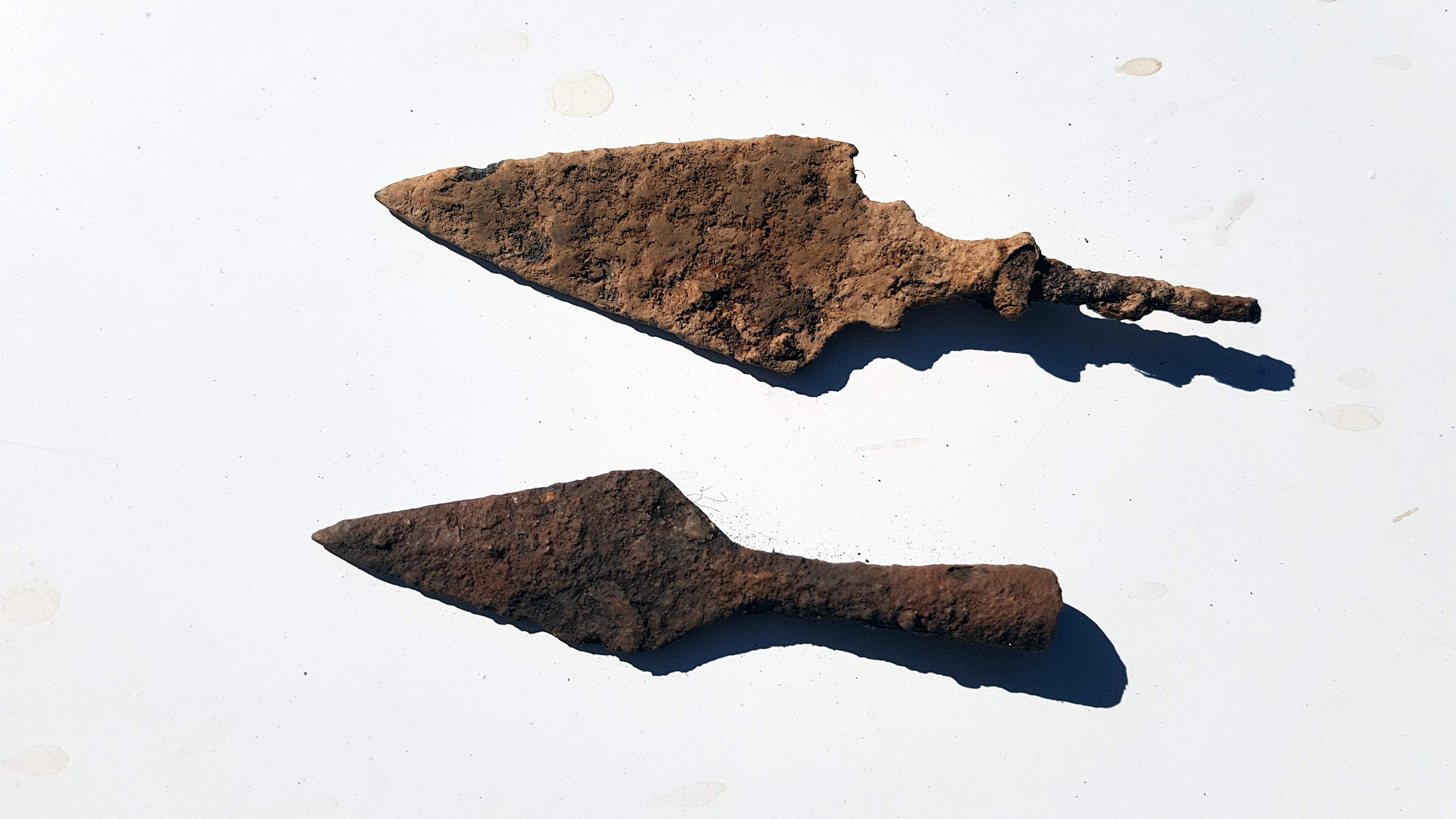

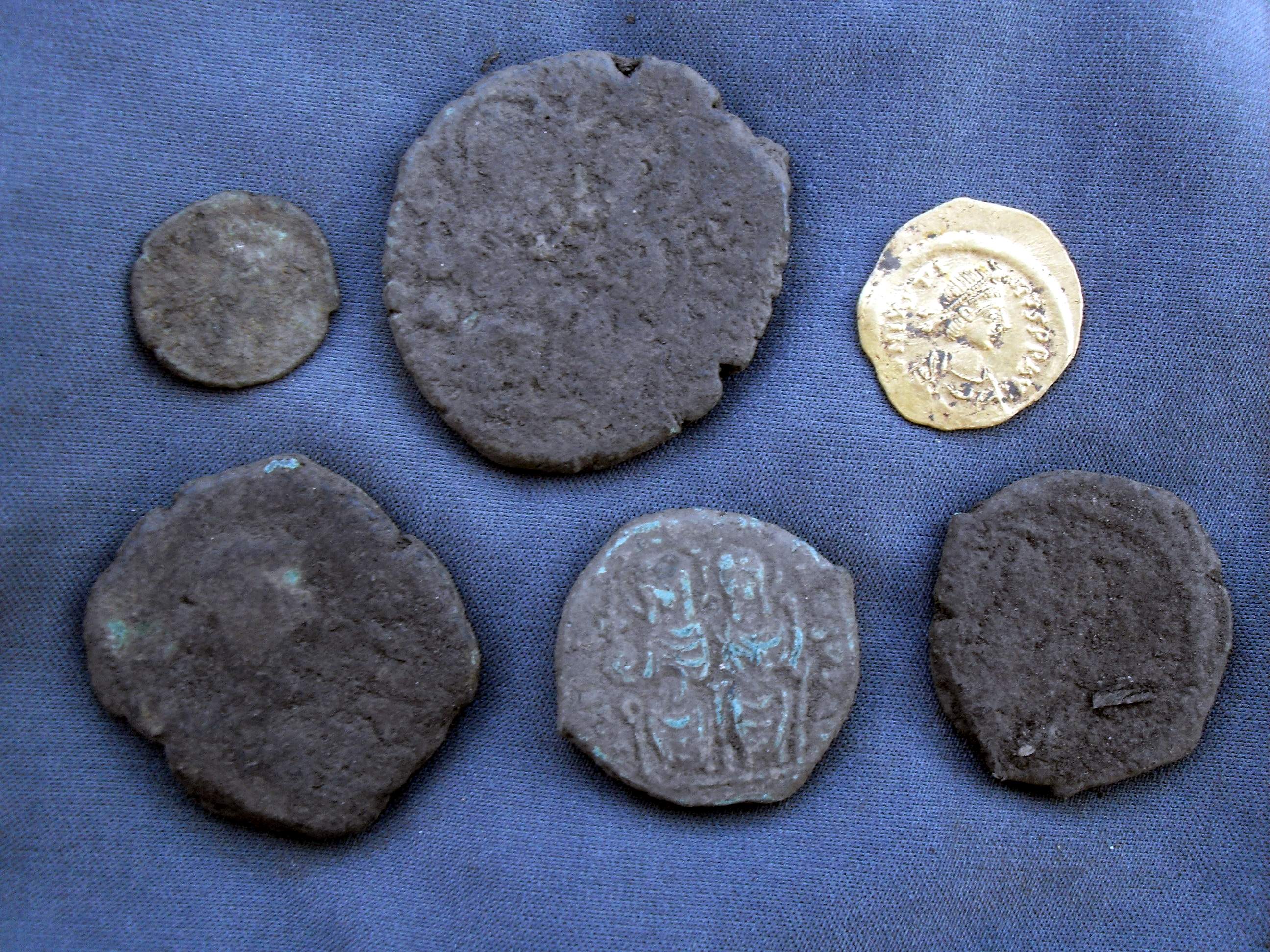

                      99% of the desired finds that i am searching for are like this:
                      50% of situations where risking serious injury or even life; I hold a branch or a convenient part of the rock with one hand and hold the detector with the other hand and check a hard-to-reach place with it.
                      In the described situations and desired findings; the only thing that finishes my job is the "whee-whee" detector, conditionally it is as light, small and convenient as possible.
                      XP Deus with its 890 grams fits pretty well into that picture.
                      I don't see a way to ever do anything with those (from your photos) "baby strollers" in such places?
                      So, every device for finding metal has its purpose.
                      People who work in that industry and who decide to make such a product; they are definitely not stupid and they definitely know what they are doing.
