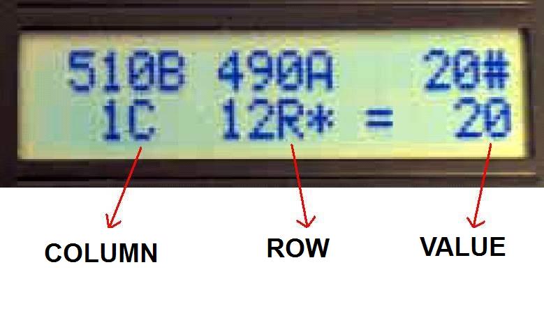

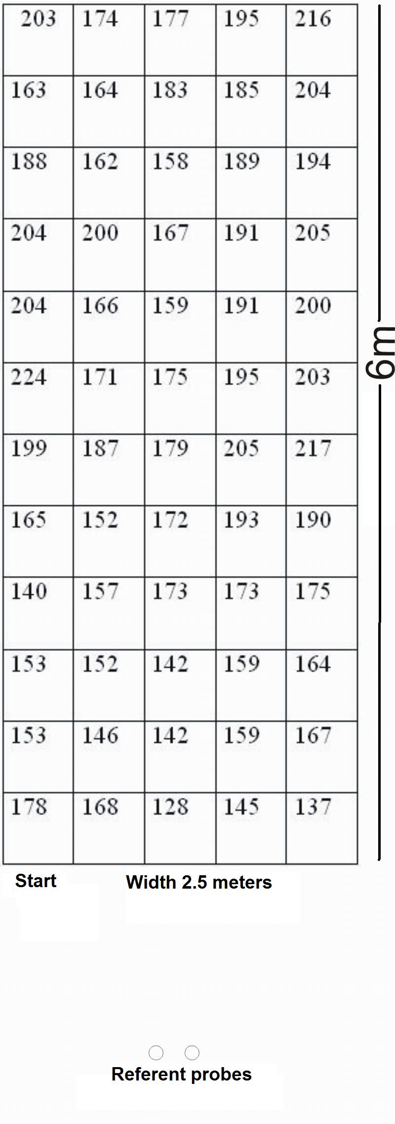

                    • ...what exactly is the sample value that get stored in the eeprom after measuring. Is it real resistivity of the soil in Ohms ? Or is it a relative value (high or low amplitude values to show differences) ?
                      • It never occur to me to compare values from resmeter with what i measure with common multimeter.
                        I have found these two pics on my disc:
Name:	osnovni ekran.JPG
                        • Thanks ivonic;-)
                          .....ok, it says "values" I know;-) ....also in Beckers Text it says "values". But what are this "values" exactly? Is it Ohms? Is it Ohms/m? Or is it just a relative value which is proportional to Ohms or Ampere. Nowhere I can find what the measured "values" are. Normally it should be "Ohms". I thought EPE Resmeter is showing and saving "Ohms" as measured values, but Im not sure anymore right now

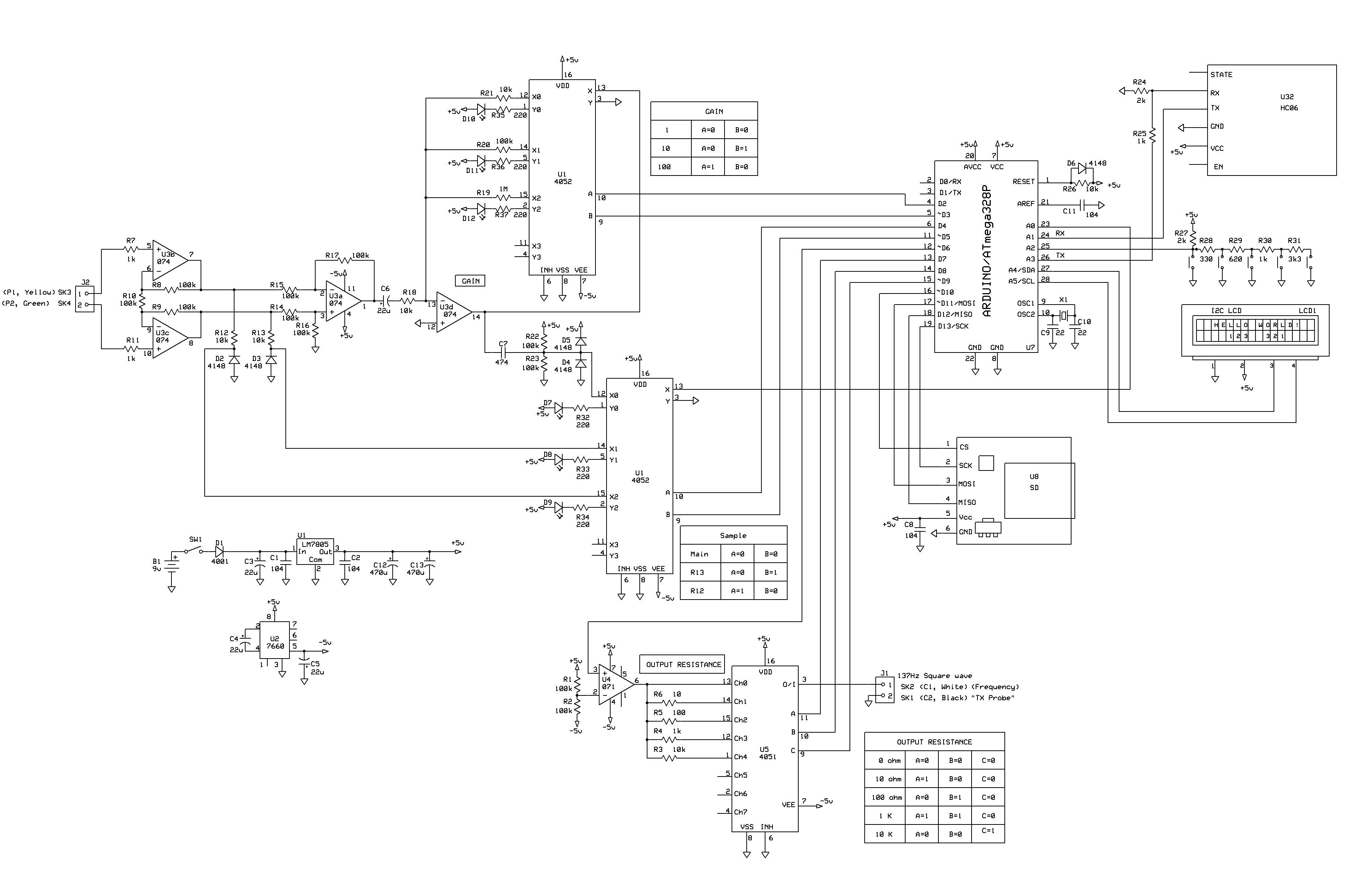

                          • In the same spirit as i did with magnetometer; i am making preparations to modernize also EPE resistivity meter / logger.
                            Yesterday i draw this "sketchy" schematic, sort of proposal, how it may be done.
                            Lot of details to take into considerations yet.
                            One step at the time.
                            This is just first step.
                            • It is always a "pain" to provide enough pins for all tasks from the list.
                              Somehow i always manage to squeeze enough juice from the Atmega.
                              Second step is to build development\debugging system for this.
                              Once it shows good behavior, as planned, and code is there, next important step is to draw proper pcb.
                              This will be my project for this winter.
                              We'll probably see the first working device in next year. Will see.
                              Becker picked 137Hz for many obvious reasons.
                              Now i am thinking on extending that choice, since Atmega is giving me enough comfort for that.
                              Any experiences on this from other professional devices?
                              Signal frequency range?
                              Beneficial choices? And why?
                              • Main task; avoid 50/60Hz hum.
                                Suppress it as much as possible.
