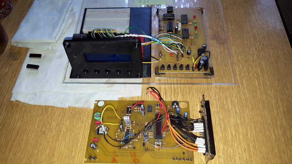

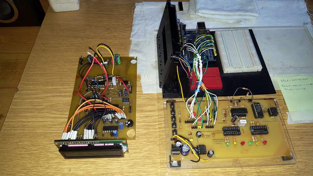

                  nice to see the new epe logger gets alive. Its great that you implemented changeable frequencies. I see you are doing it great,...like always;-) Cant wait to test this thing!
                  • Originally posted by Prospekteur View Post
                    Hi Ivconic,
                    Device prototype is almost ready. Later on goes fixing and adapting Windows&Android software for it.
                    I had weird situations here while testing some code on development system. Turned out that i put broken CD4051 and one of the two CD4052!!!
                    So i did a code that gave me totally weird behavior, due failure chips! So i lost several days to discover that, since i least suspected on those.
                    That's what you get when you rely too much on scraped material and luck with it.
                    So now i ordered new chips from a shop, expecting them in Tuesday.
                    Overall job is almost done.
                    I even had to re-made one EPE resistivity meter to remind myself how it works and to be able to measure some things across it.
