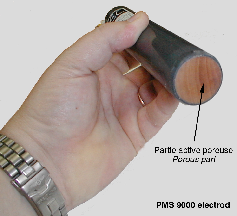

                • hello , could you told me what is
                  the benefift of using non polarizable electrodes
                  ( probes ) in resistivity , thank youClick image for larger version

                    • @AK48: Ive never worked with such elctrodes. I think its used more for soil analysis and to examine deposites. Seems a intersting method (thanks for posting it)....Im reading the following paper at the moment about this method (but you can find a lot of papers in the internet):
