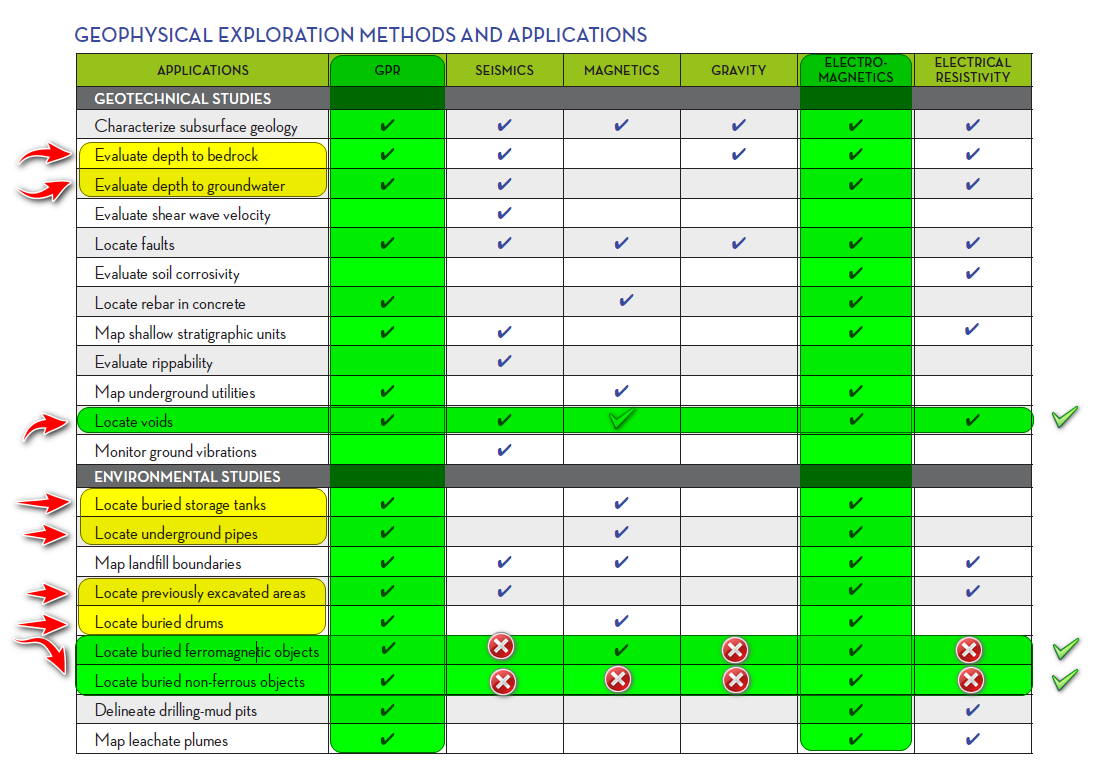

                  • I thank my friend Nicholas for the table, but I have some questions about the method of analysis and knowing the space. Is it possible to help me in the way of knowing the spaces and minerals and determining the depth on the program? Thank you very much
                    • If anyone can help, I want to do it too.
