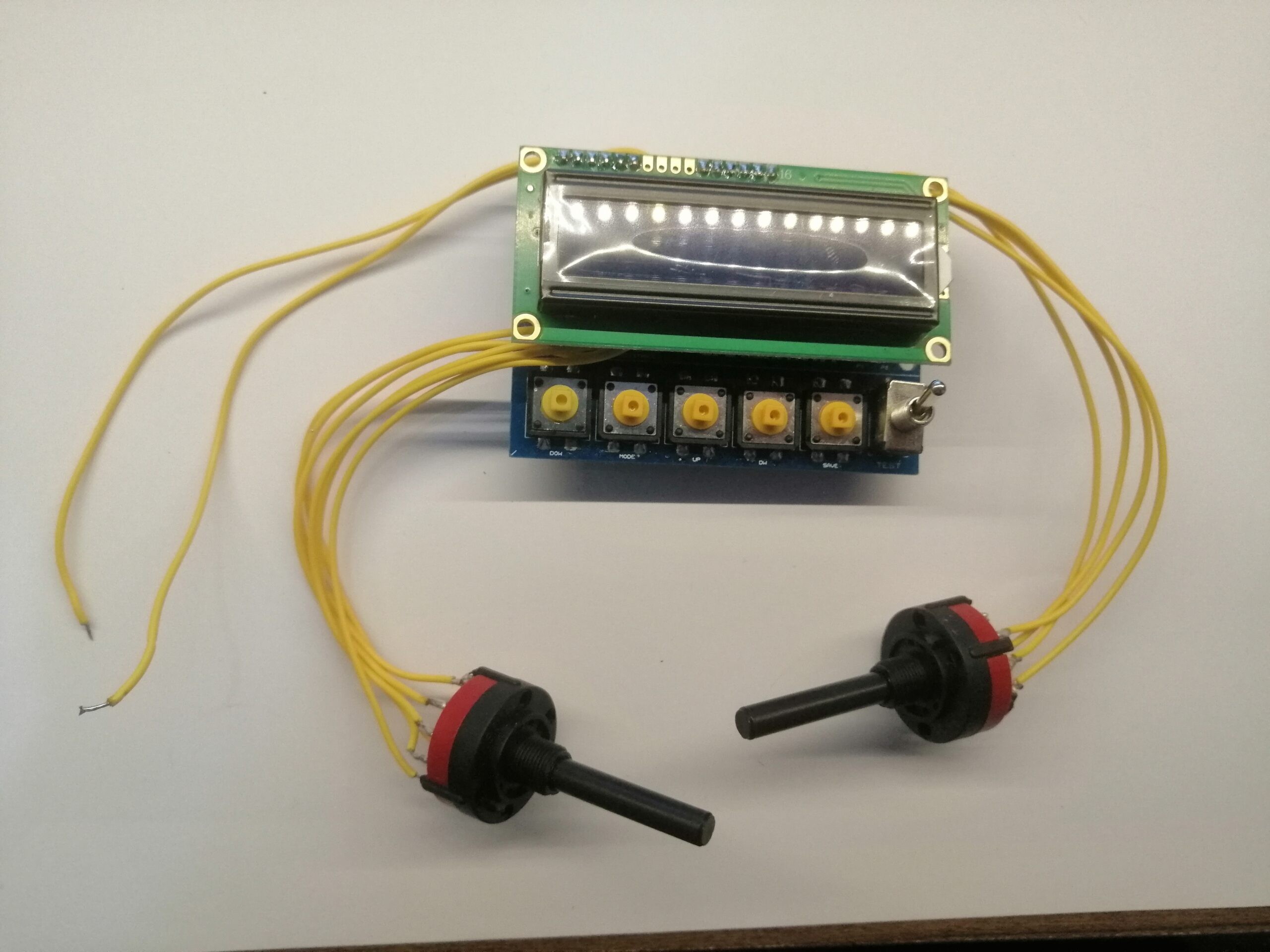

            • Hi I am interested in your redesign of the EPE resistivity logger. I made this unit a couple of years ago and have used it quite successfully. I modded it as follows.
              1. I removed the test switch.
              2. I added a buzzer to the save switch.
              3. On setting I start at column 1, row 1 instead of 0, 0.
              4. I added the facility to auto increment the readings, on save, on the odd columns, and to decrement the columns on the even ones. It's easier that way to know where you are.

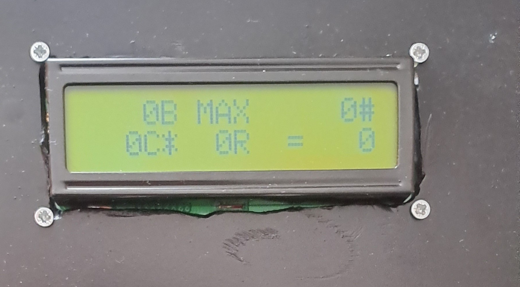

              • Please can someone what he did and did get 0B 0A indication instead of 0B MAX If there is someone that had in the past same problem that i have showing max istead of 0A please tell me what u did and solve that problem .
                • If someone face the same problem please tell me how he solve that problem

                          • Can Someone please answer who had same problem with this device say what to do in order to correct it and i am talking for the reading that is max instead of 0A
                            • Non not a single answer to max instead of 0A indication there are people here who had the same problem in the past i saw it in posts and i did not get a single answer . My GOD is it so dificult someone to answer ???

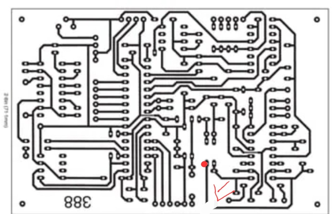

                              • For those who are going to build this ERM logger in the future they and will face the same problem that i face on the display getting Max indication instead of getting the right one which is 0A you will have to perform the next modifications in order to fix it .
                                1. Cut the track between R16 And pin7 of IC4 (as it is mentioned in the part 2 on the epe magazine ) i am showing with an arrow in the picture .
                                2. Connect the now-open end of R16 to the pole of Switch S2
                                (in the picture i have place a red dot from where you are going to solder the wire )
                                3. After you do that and track is cutted R16 and S2 pole connected Turn on the erm press first and hold S6 (mode) and then while you are pressing and holding S6(mode) Press and hold also S8(Save) and the message (Ref saved will appear)
                                as you hold and press those two buttons release first S8 and then S6 .Then the value from Max will go to 0A .
                                Quote make sure the wires of the output are separeta and are not very very close .
