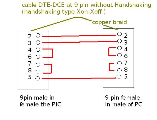

    This is born from the fact that I can no longer do the downloading of data. I also did the hardware variant Joe Farr proposed in the text. But I can not. I built this straight serial cable without handshaking. In your opinion is the cable? How can I fix the problem?
    Another thing: in your instrument Click image for larger version
ID:	337289, in test mode to the letter B in the first line of the display always or sometimes max 0, while in the normal way is not it? There is some contact to control?

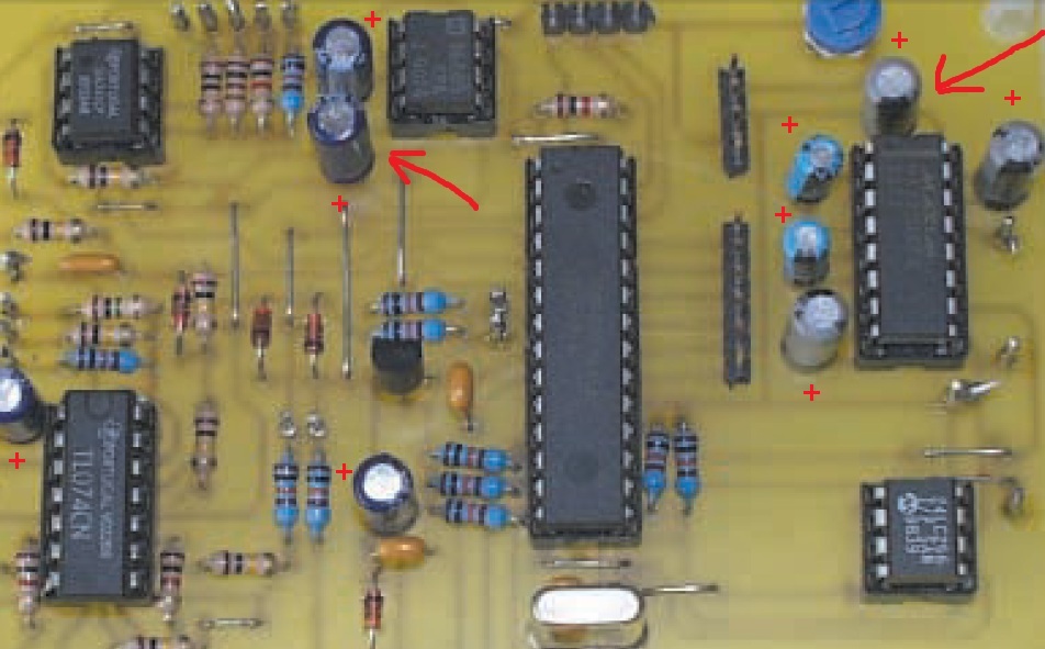

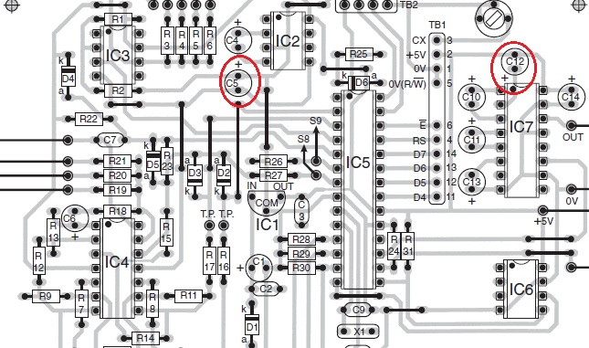

          Hello, I have a strong doubt on the patterns of EPE resistivity and ask for help to the experts: in the scheme of Becker, capacitors marked in red are well oriented (+). But in the picture of the same magazine the two capacitors highlighted (1 near the max 232 and the other near inverter) are on the contrary oriented. What 'is the right position? I have the problem of not being able to do the download of data and always appears on the monitor, in test mode OB and Max A. Can you help me to solve? Tank's in advance.

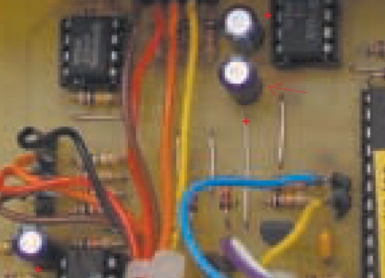

              For you the scheme of Backer is correct?.
              But it's have inserted in article two foto very strange with discrepancy in this two point. For me the capacitor in the 2 foto are the same tipology and of same constructor and ..... are inverted!!!

                    I have an EPE Resistivity Logger which is non-working, that someone gave to me some time ago. One day I'll get around to getting this working.
                    Considering the two capacitors:
                    C5: +ve goes to pin 7 (GND), and -ve goes to IC2 pin5 (-5V). IC3 is a 7660 used to generate the -5V supply for the opamps. The PCB layout matches the schematic, but the photo appears to show the capacitor inserted incorrectly.
                    C12: +ve pin goes to IC7 pin2 (V+), and -ve pin goes to TB1 (+5V). Again, this is correct and the schematic matches the PCB layout, but the photo shows something different.
                    It looks like to me like John Becker inserted a couple of his capacitors back-to-front when he built the prototype.
