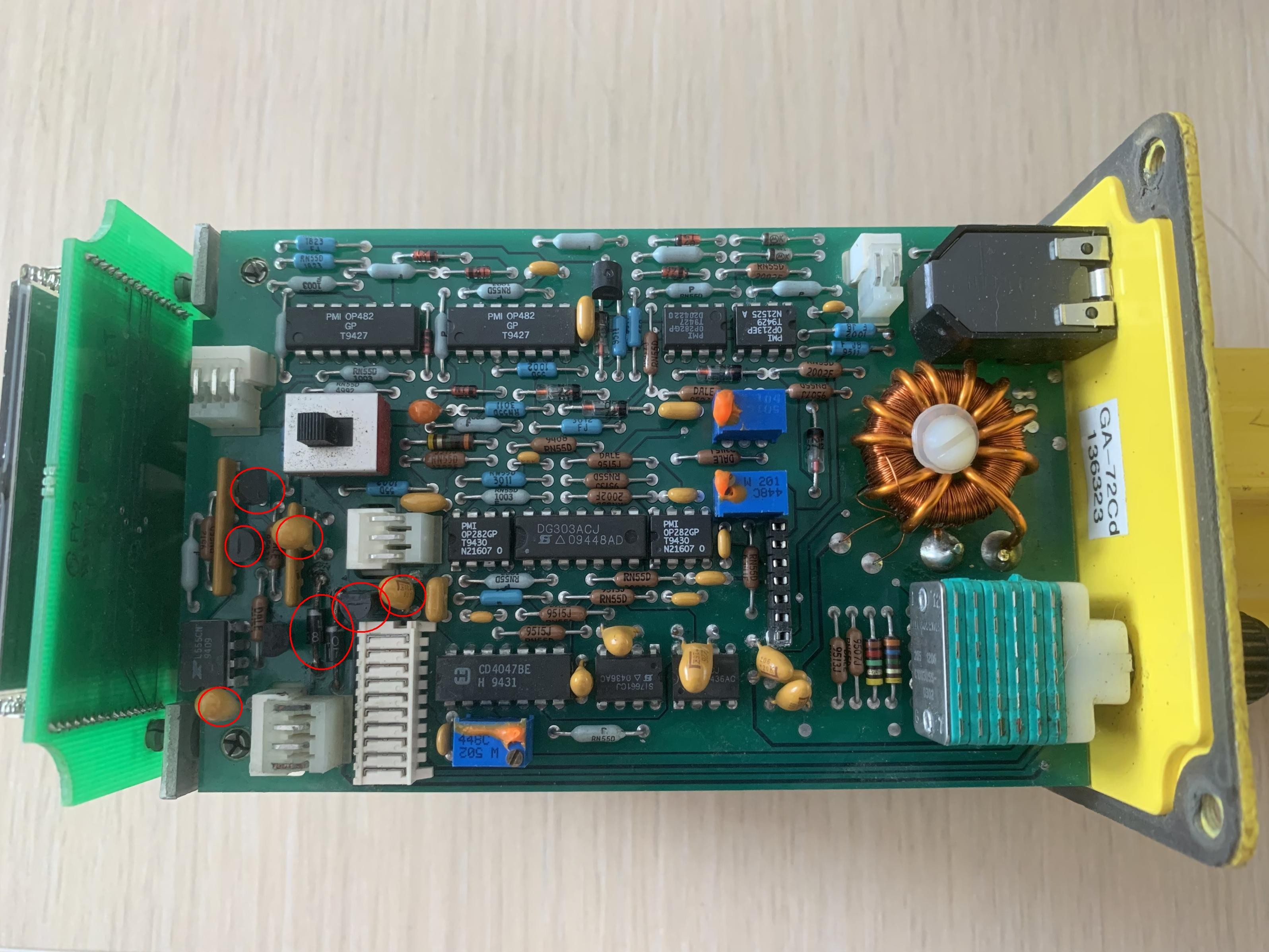

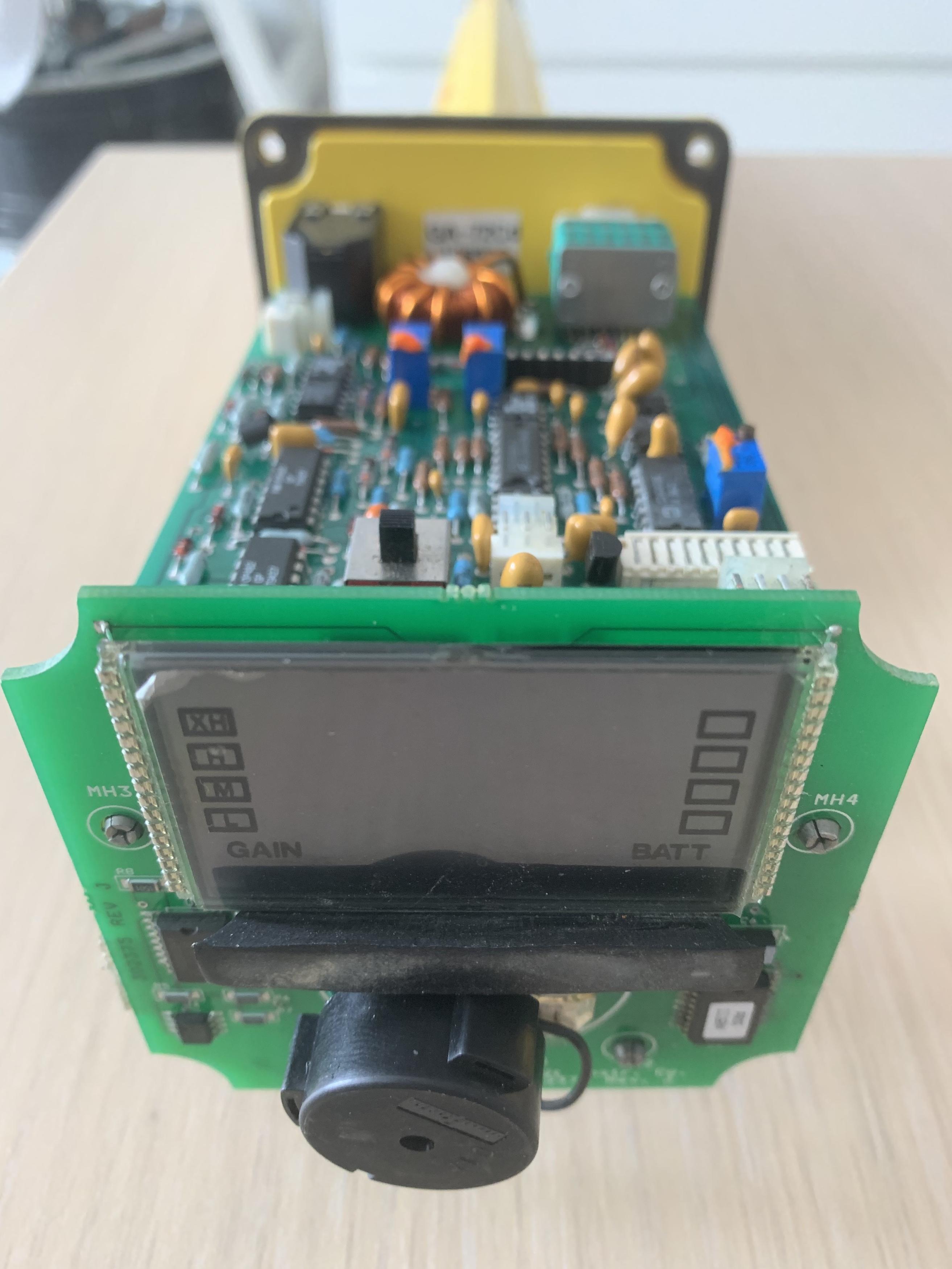

    Hello. Does anyone has the audio output schematic for this device? I got very low audio output on both headphones and piezo (3pin).

    It is unlikely that you will find someone who can directly help with such exotic devices.
    But there is no need.
    It is most likely a 555 audio generator and if the output (3rd pin) does not go directly to the piezo;
    then you should also check those few components that look like transistors.
    As well as powering that part on the pcb.
    It is clear that someone has already desoldered those two black diodes and the component near them that looks like a transistor.
    There's probably a problem somewhere there.
    And one more important thing to mention; tantalum capacitors!
    They are very reliable, but once they start to fail; then they know to cause a lot of serious problems.
    I marked with red cicrles all the components I would check first: (you can zoom In to see clearly)

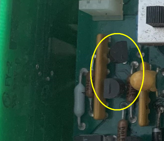

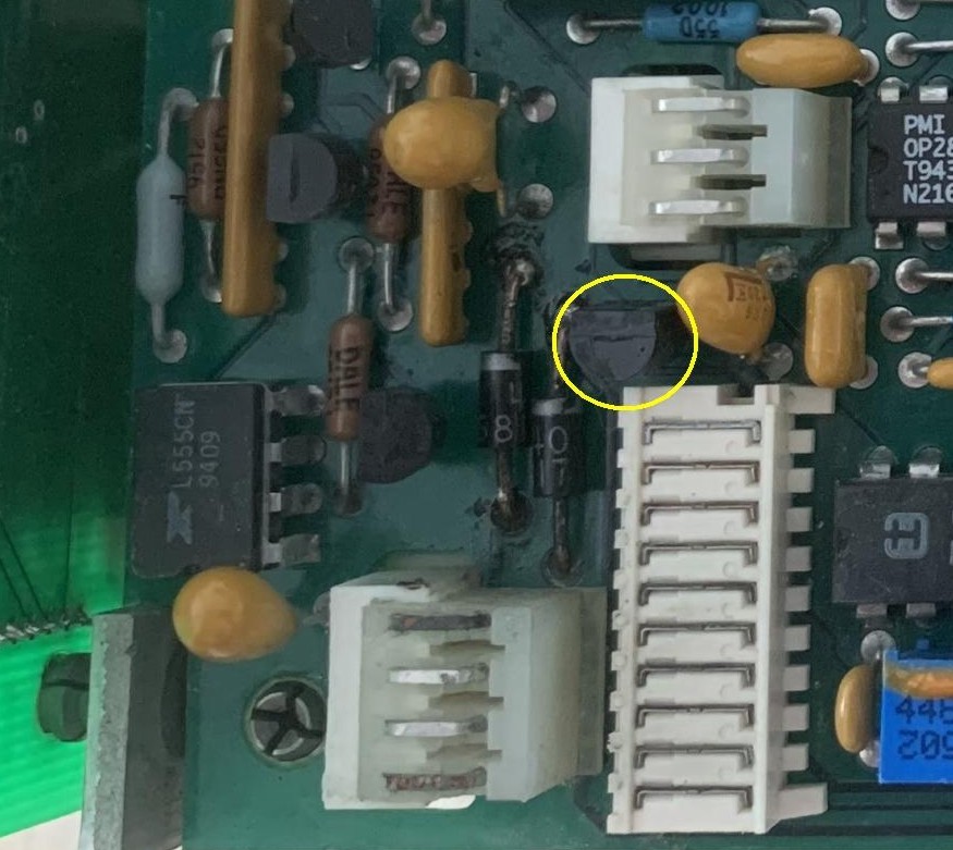

      Let me pretend to be clairvoyant; this component is probably not a transistor but a voltage regulator/stabilizer?

        These two can be audio "driver output".
        Signal comming from 555 is "buffered" through them.
        Just an assumption, of course.
          I would be very interested to see detailed pictures of the sensor, provided it is not totally covered in epoxy.

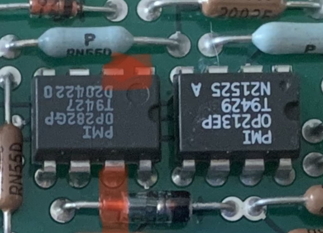

              According to a bunch of high quality opamps presence; I assume that it is a refined "preamplifier" of the signal coming from the passive sensor?

                    OP482 x 2 Quad Low Power, High Speed JFET Operational Amplifier $12
                    OP282GP x 3 Dual Low Power, High Speed JFET Operational Amplifier SMD $5
                    OP213EP x 1 Single- or dual-supply operation, SMD $8

                        I have a GA-52 and two GA-72Cd's. On the GA 72 the green switch 5pos . Is on/off, L, M, H and XH gain. I think it switches the 4 resistors that are near
                        Wanted to reverse the GA-52 pcb, but never got around to it. It uses a RC4152 for the vco, The tx/demod oscillator is HEF4047, DC-DC ICL7660,,OP421, OP421. CD4053. The blue chip is a 10K resistor array.

                          #2 - that side of the pcb is exactly how you described but 555 pin 3 does not go to the piezo/headphone, it goes into the yellow resistor network (ladder).

                              Where the 555 is it is connected the power supply (2x9v battery which is going separately to the pcb.
                              The piezo wires are going to the other corner of the pcb (opposite to ic 555) to op282 connected at pin 12 and pin 7 (which is output).
