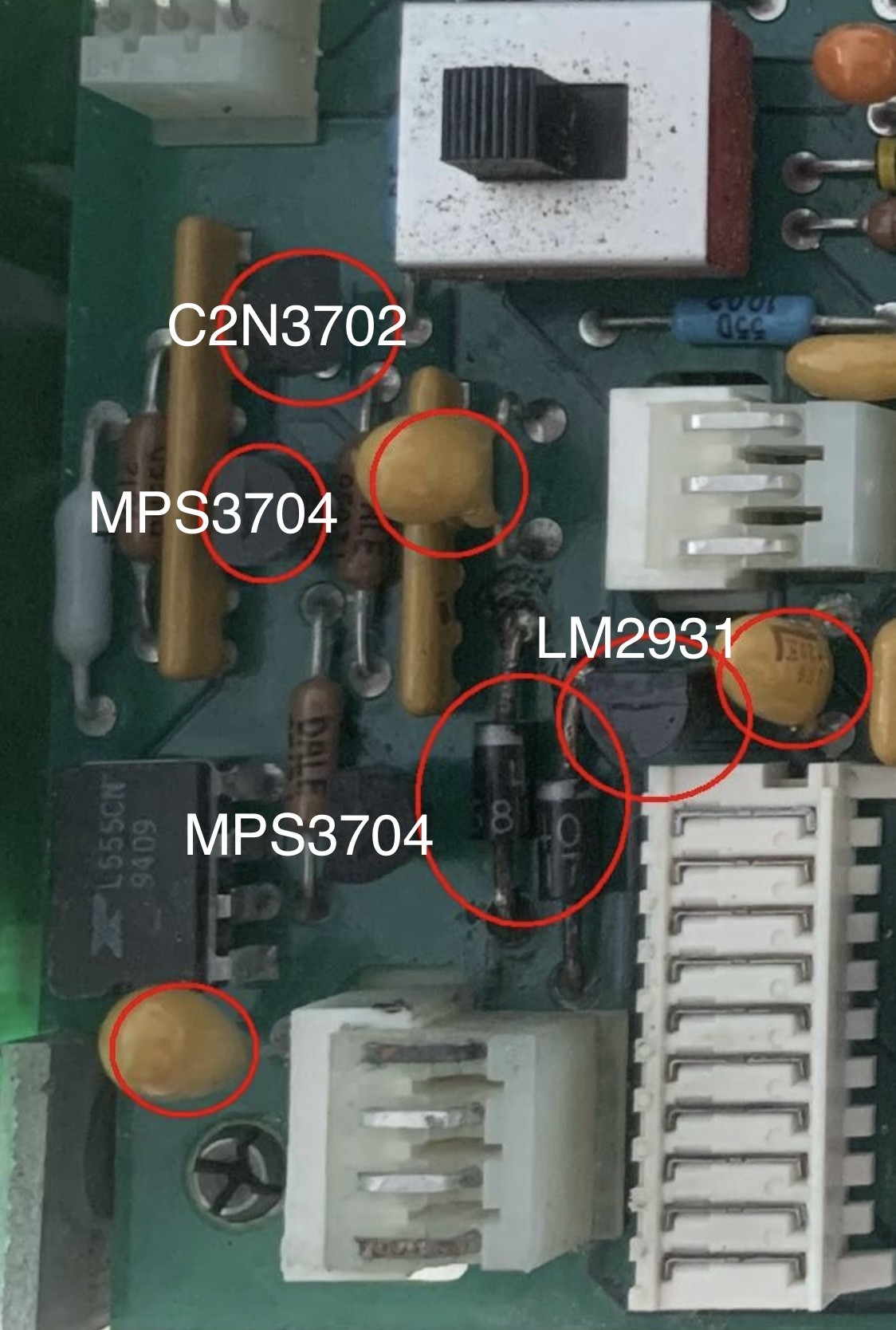

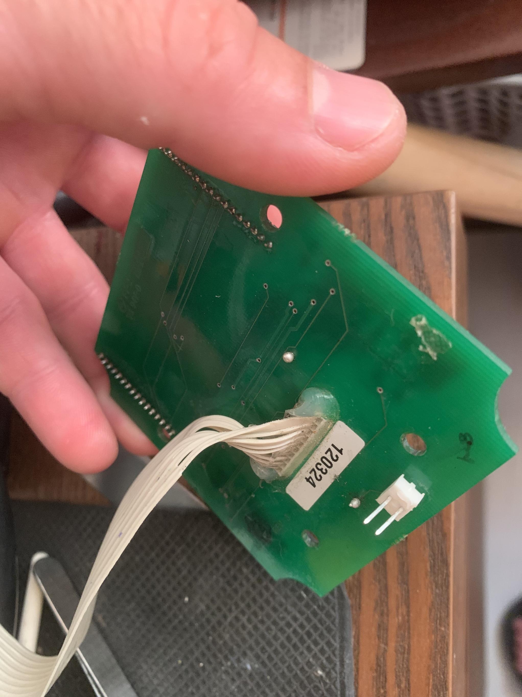

    Here are some photos of the pcb

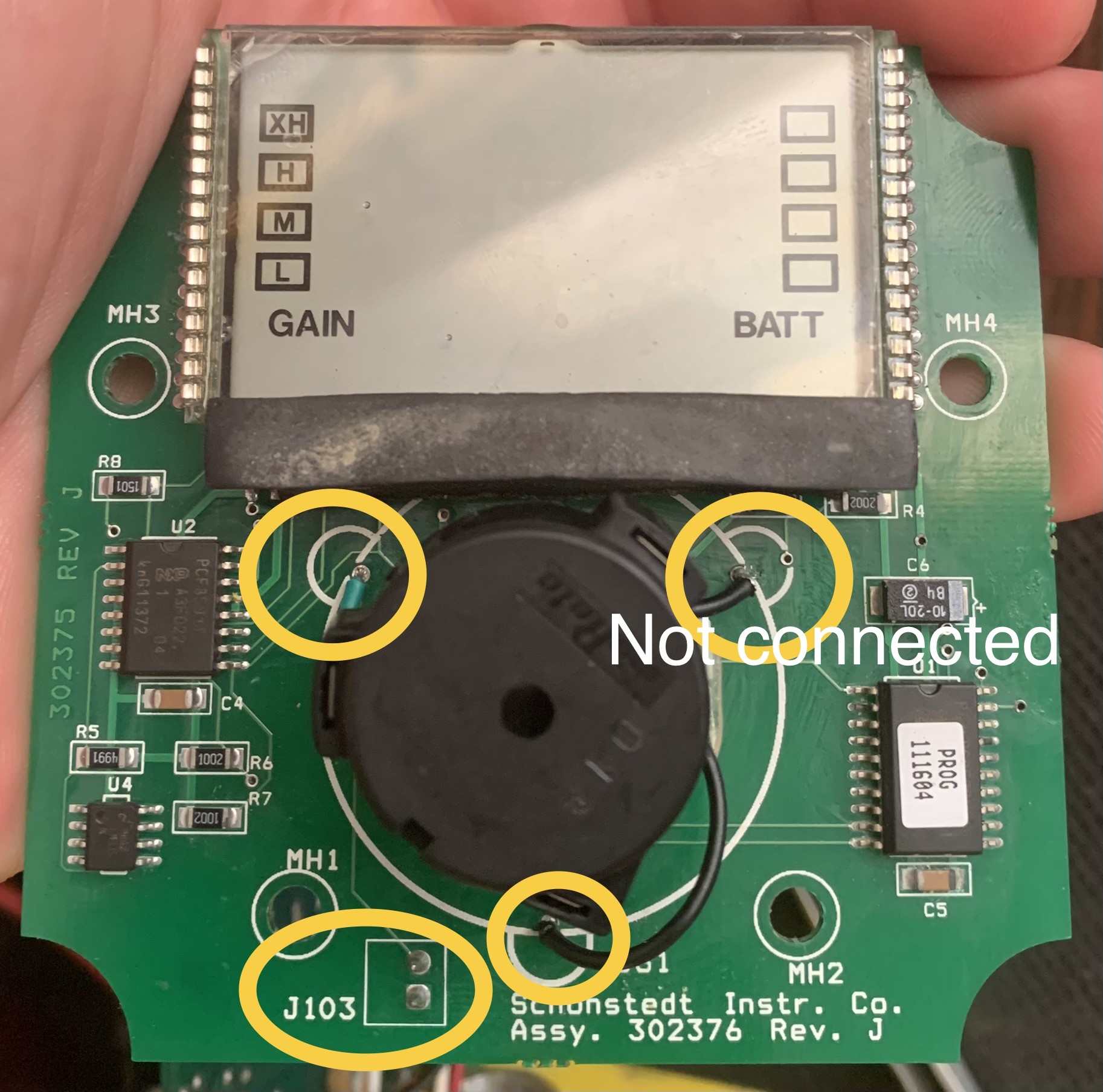

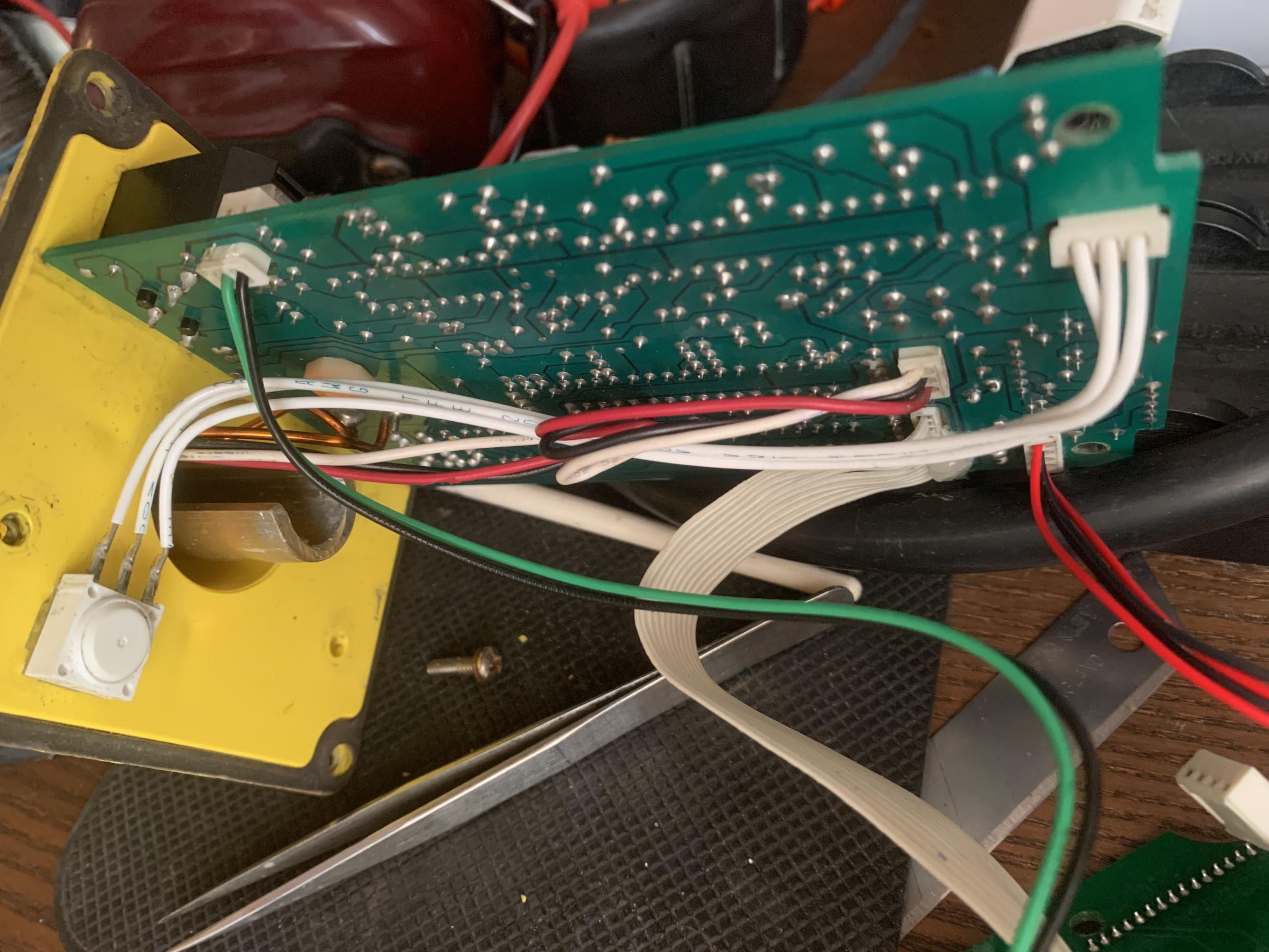

    Hello Altra. Thanks for helping. Do you have some pictures on how 3pin piezo is connected? Someone worked before on this and the piezo wires were disconnected.

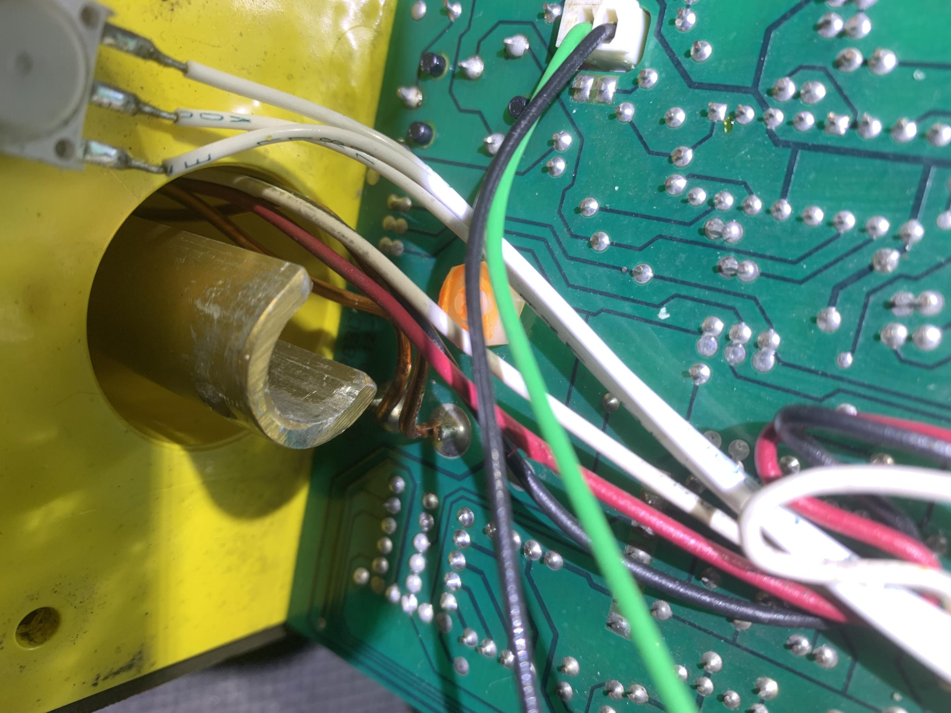

      Hi. on my unit the piezo is 2 pins. A two wire jumper runs up to the headphone jack. The volume pot has 3 wires?
        Piezo connections
          Yes, same like you. Volume pot has 3 wires, piezo running 2 wires to the headphone connector area. Piezo has 3 pin but one pin wire to the pcb is going no where - on the pcb is no copper trace.

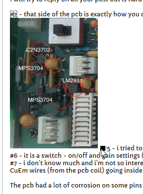

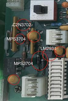

            #2 - that side of the pcb is exactly how you described but 555 pin 3 does not go to the piezo/headphone, it goes into the yellow resistor network (ladder).
            Click image for larger version  Name:	28974D8E-9CC9-4A21-A77D-4D842542F53E.jpg Views:	0 Size:	276.8 KB ID:	414313#5 - i tried to remove the sensor for you but I cannot pull him out from the case and i’m afraid damaging it…
            #6 - it is a switch - on/off and gain settings (L, M, H, XH) si it is a 4 position switch.
            #7 - i don’t know much and i’m not so interested in it because my time for metal detecting is very limited for now (lost of interest unfortunately- maybe because of hot weather) but i can inspect more if you want. This device is for industrial use - a friend has it. Two CuEm wires (from the pcb coil) going inside the shaft and 3 small insulated also.
            The pcb had a lot of corrosion on some pins and i tried to resolder and clean. The result is: device not power on anymore
            I was right about LM2931, it is low drop voltage regulator. There must be additional inscription bellow "LM2931" about the voltage, is it 5v or something else.
            https://pdf1.alldatasheet.com/datash...MI/LM2931.html
            What can you do else?
            Check the power supply and voltages at all opamps and chips.
            It is easy at quad, dual and single opamps, pins are standard.
            There must be a reason for faint and low audio. Usually it is voltage drop somewhere of some faulty component.

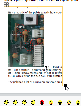

              When you upload photos directly in your post (also you can Copy&Paste into) , once photo is inside the post "box"; you can resize it by clicking on the bottom right side of the image and pull it up and left.

              To avoid exra large image across the whole display.
              Because it is aesthetically more acceptable that way, it is easier to follow the post and the entire page on the topic.
              Image resolution remains unchanged, who wants to see details; simply click on the image and zoom in to detail.
              Forum engine is fine. You just need to get used to the new functions and find methods for manipulating the elements in the post.
                It is LM2931AZ-5 so 5V regulator. I will check the power supply in all ICs. Thanks

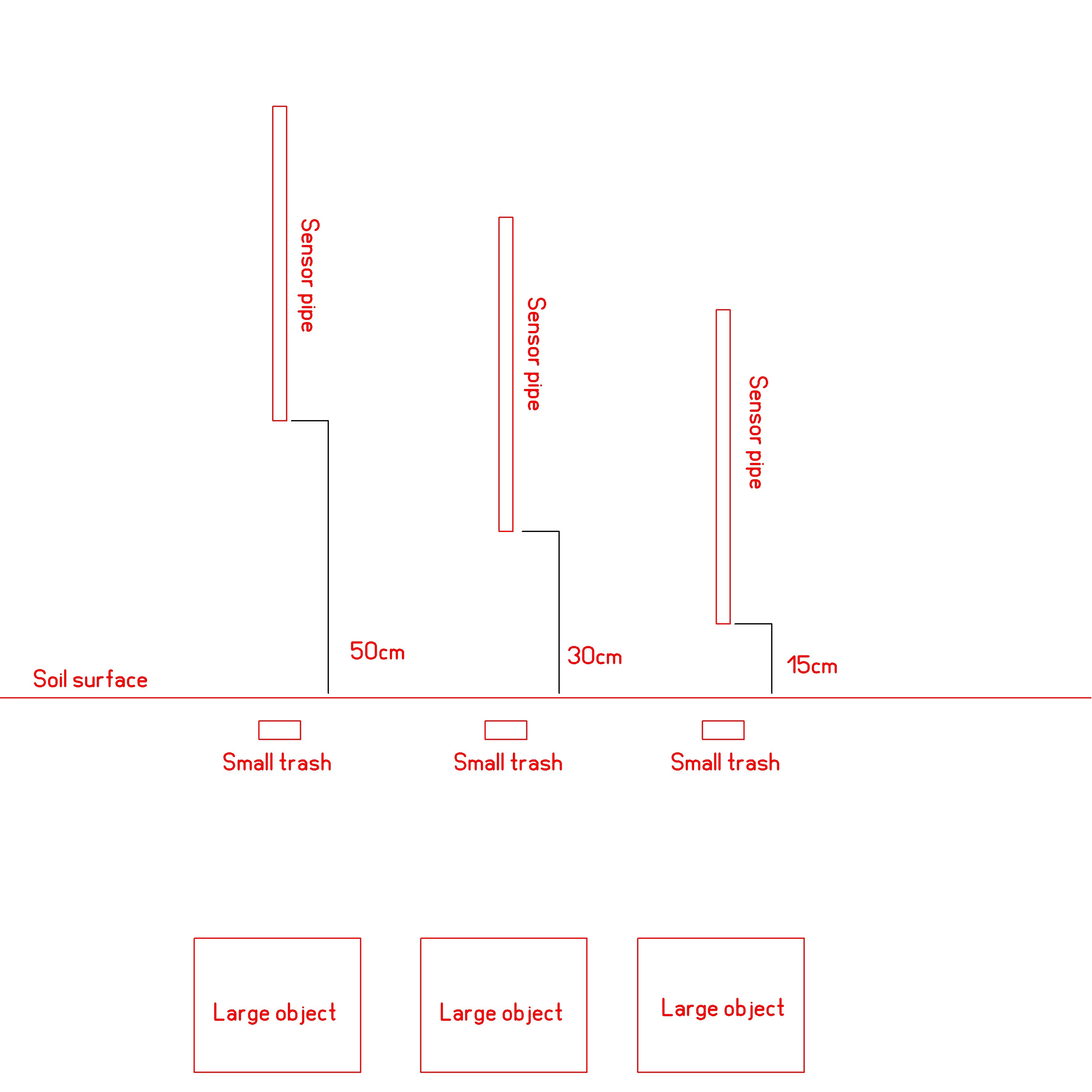

                            I will not interfere in the topic so as not to offend anyone, because that is not the point, but an exchange of opinions..​For me, all members of the forum are one big family, that's how I experience it.​
                                One of the simplest "tricks" that a beginner learns first is what I drew.
                                If there is a large metal object in the depth and some metal debris/trash/smaller objects at shallower depths in line above it, as in the picture;
                                by simply lifting the sensor tube from the soil surface: "signals" or "anomalies" in the magnetic field on the soil surface are eliminated.
                                To correct myself; "eliminated" is a misnomer.
                                Those "anomalies" are still there, but they represent an insignificant change in the overall "anomaly" represented by a large object at greater depth just below.
                                Further lifting of the sensor tube; those small changes become even smaller, insignificant and do not interfere with the correct and accurate location of a much
                                larger "anomaly" in the soil magnetic field, which is represented by a larger object at a greater depth.
                                So that surface "garbage" does not represent any problem in locating strong "anomalies".
                                "Military" finds such as helmets, remains of weapons, various chests... these are "HUGE" anomalies in the eyes of the magnetometer.
                                The sensor tube can be carried at a height of 1 meter (and more) in search of such findings.
                                Well, it's just one of the simplest "tricks" to solve the problem of surface debris.
