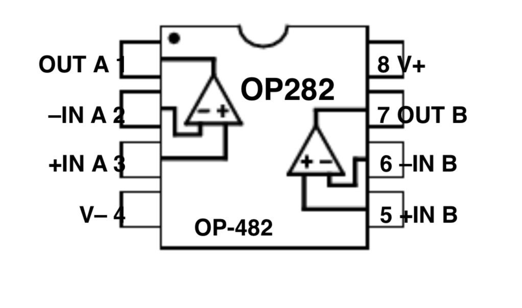

      Managed to make the detector working again (power side). After alcohol cleaning and reflow some corroded pins one via from top to bottom was not making contact anymore.
      Now, regarding the audio output (pin 1&7 where piezo is connected) op282 (power supply is ok), if i connect one speaker from pin 1 to gnd or pin 1 to + i have clear and loud sound. (Also if i connect pin 1 to pin 5 and pin6 i have sound) But if i connect speaker at pin 7 to gnd or pin7 to + i have no sound. I assume op282 opamp (one of them) is defective.
      When i will make some time, i will test the device for you.
        Attention!
        You must not connect a regular speaker to the piezo output!
        There's a chance you'll burn the opamp.
        Piezo is triggered by a DC signal while speaker is driven by an AC sound signal.
        Be carefull!
          Is it possible the headphone jack corroded? This might cause the problem since it is switched through the jack.
            Yes that's true. Actually a common "fault" at older devices.
              Headphones have low volume same as piezo. I’ve checked the on/off switch(phones/piezo) from headphone connector and the contact is ok. The only thing I suspect is the output IC, because, again, psu for ic is ok. I need to put the scope on imput of IC to see if it is good.
                You can replace it with TL082 and check.
                ...072
                ...062
                I missed reading (if you mentioned); are the piezo and headphones connected to the same "source"?
                It shouldn't, because of the impedance differences.
                If they are, then the suspicion on the opamp is justified, if they are not, they are driven from different "sources"; then maybe it's some other problem.
                In older devices, it often happens that the resistor increases in value.
                Rarely but it happens.
                Check all resistances in that circuit.
                  I’ve bought and repaired several ga52cx’s and CTX/Berger models. I haven’t come across a bad electronic part yet. Always the switch, audio jack, or bad connection. Try flexing the board to see if you get audio. Spray deoxit on the jack connections. Volume control might be bad.
