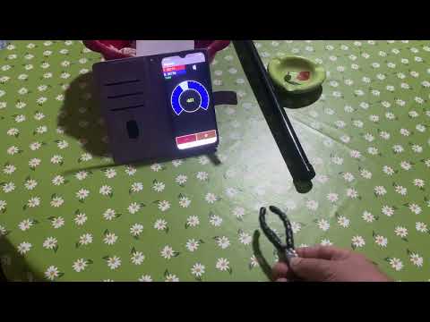

                Such a skim "test" in the room, armature in the floor, "million" electrical devices turned on, interference on all sides.
                All this is not authoritative and I just recorded it as a demonstration example.
                This is just a pinpoint mode with a very low sensitivity setting.
                The Android application also has a standard 3D logging mode.
                The metal box on the floor is made of a very thin alloy with aluminum (of course, there is also ferro material in that alloy).
                Final software settings are in progress.

                    And for those who cannot (or will not) purchase FGM-3 type sensors ... an alternative solution (even with slightly better performance):
                      Audio "threshold" is set to 500nT (scale is 2000nT) in both videos.
                      Because I'm in a room full of industrial noise and various small local magnetic fields.

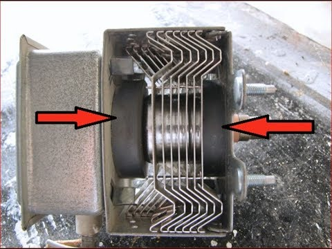

                        Can you check the distance with ferrite magnet as on the picture, magnet diameter 5.5 cm ?
                          Where to find such ferrite?
                            I have it from microwave oven

                              Good tip!
