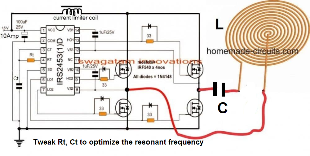

                    Originally posted by Tkjordan82 View Post
                    1 kilohertz to 1 megahertz with a power of 25 to 50 watts
                    Consider this type MOSFET driver, TC4425

                      I appreciate your support
