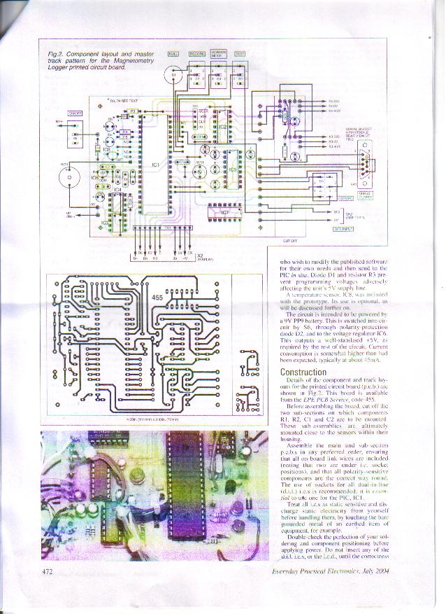

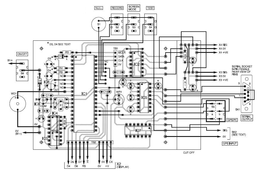

    Does anybody have schematic or mounting schematic, i have this but it's not enough visible

      Hi Strujas..
      hope not too much copyrighted .. John Becker and EPE magazine are the best..

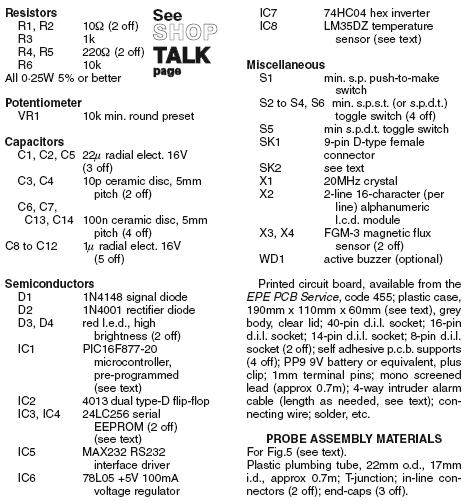

        Thanx Leto , but what abouth values of parts?
          sorry, forgot about it...

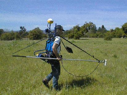

                    Nice, i am interesting how did you made mehanical part, is it possible to looks like device on photo under, is it matter how much over ground is a sensor?
                      Nope, this is high resolution cesium magnetometer from Geometrics inc. mounted with GPS.. way out of our league

                        This is g 858 one my friend have it, but had he destroyed sensor and now its in a bag, repairment would cost more than 2500 euro
