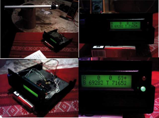

                Recently i got FGM3 sensors and made epe. It is alive and seems working....but.. i couldnt find 24lc256's in local shops and i can not start it in SCREEN mode to see the rest of options.
                It says " reached limit....connect to pc.." or something like that and it freeze.Also detects 0 memory chips (to smart ).
                So i was wandering how to solve this problem? Ok for a start i could use only SCREEN mode and follow values on the lcd from both sensors, but it wont let me to that point .
                How to solve this? Can i use 2 identical ....let's say 24c32's instead or simillar i can obtain?
                Or...can i put just one memory in socket and make it work in SCREEN mode?
                Point is to make it work no matter the recording in memories.
                Maybe i can change source code? But how? I am not familliar with pic's that much to mode source just like that.
                First i had problems with programmer.I used brenner5 clone and it "programmed" pic just like that.But when put in socket on pcb it refused to work - just blanks on lcd. Than i tried various options in brenner software and finally somehow i managed to programm it right. So now it is starting with starting screen and responds to commands on front panel.Everything seems to works just right. Yet without memories i can be sure that it is really right and workable...
                Any suggestions?
                  Oh i pulled out some premature conclusions!
                  It can work without memory chips, no problem!
                  I just mixed up switches previously.
                  It reports missing memory chips but than continues to work properly. Hurrahh!
                  After realizing that i still searched for some 24xx chips at my scraps and found 24c32 and 24c64. And epe than reported "2 memory chips" !!!
                  So...what to say more? It is working "by the book". No problems at all.
                  It is damn sensitive, not possible to calibrate sensors indoor, in workshop. Must rearrange sensors assembly and go outdoor, somewhere in deep forest to properly calibrate those, there.

                      I used Speake FGM3 sensors.
                      It is good idea to try to make own. But so far i dont have a clue.
                        Can anybody ascertain me this;
                        on original FGM-3 sensor there is FB pin. According to earlier presumption i measured inductance connecting FB and GND pins from sensor. So it measured approx. 1.2mH when sensor is oriented E-W and a bit less, 0.9-1mH when oriented N-S. Ok...sensor was off supply - "inactive".
                        Very interesting thing. But later i made very small coil using plastic tube 4mm diamm. and wound so much windings to reach arround 1mH inductance.
                        Than i did the same thing with it as with original sensor - connected to inductance meter. Turning arround and changing orientation i got same inductance - not changed reffering orientation!??? How come?
                        Also...on original sensor (off power) when FB and GND again connected on inductance meter and some ferromagnetic closed to sensor, inductance changes significantly but on my custom coil not, bairly measureable changes??? I tried to use as thin as possible wire i could work with.
                        Also i used small tube as former....
                        So now i am a bit confused?
