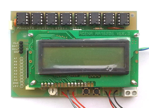

                    I made the magnetometer – gradiometer from Fat Quarters Software & Electronics

                    Gradiometer and two sensors worked just fine , but today as i received the Pcb for data logger it was completely different with the Pcb in the manual pages (probably an older model) .
                    Is there anybody , who have datalogger kit 877 with the correct instructions of the pcb
                    My email : [email protected]

                      Hi
                      Have this one.. works OK but not very suitable for logging carl's gradiometer.

                        hi Leto , first of all , I thank you for your reply to my problem
                        1o - Yes , this is the pcb I received but with different instructions inside ,
                        which means different electronic plane,do you have the correct (manual and instructions) ?
