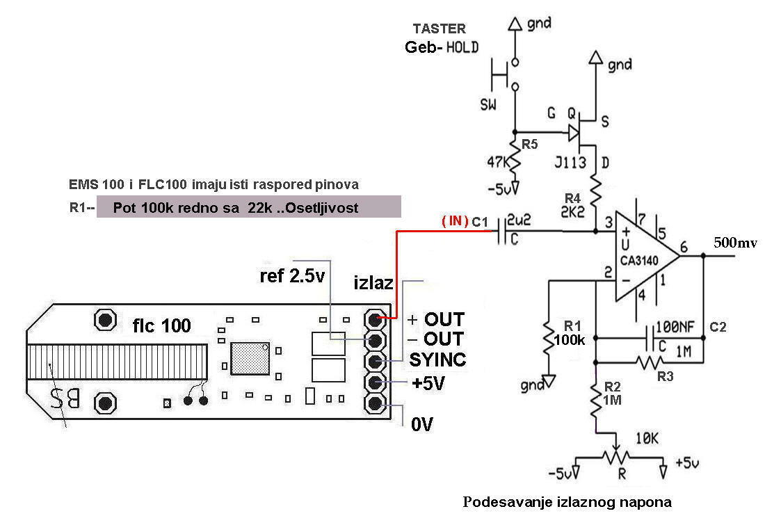

      • Thank you very much, that's what I'm thinking of doing with the 555, but should I connect it directly to pin6 of the 555?
        • From flc 100 directly to 555 will not have sensitivity flc100 two pieces go first to the comparator and then into the amplifier and from amplifiers in 555 I don't remember exactly whether directly to pin 6 or through a diode.
          give this a try:Click image for larger version
Name:	POJACIVAC - flc 100.jpg
          connecting two flc100 to Fluxer Click image for larger version
Name:	sema povezivanja flc na  fluxer.png
