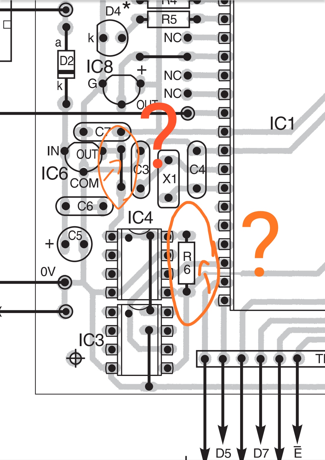

  • Good evening guys, in the earth resistivity logger the eeprom works properly in the epe magnetometer neither of the two eeproms works properly, is the connection wrong? Can anyone tell me the answer
    • Good evening, is the connection I have in the photo correct? Why does it not show <2 eeproms chips>? Is there a mistake in the circuit?

      • Originally posted by Omerta 1312 View Post
        [ATTACH]53627[/ATTACH]
        No mistake. It is wire jumper. Correct.
        Also R6 is 10k resistor.

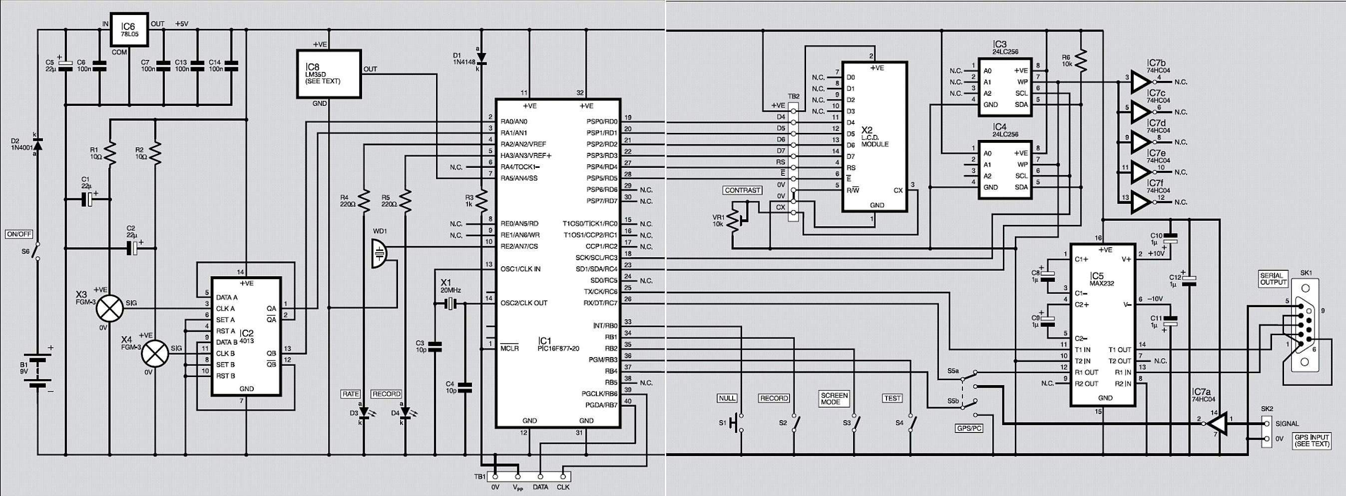

        Don't you have schematic?

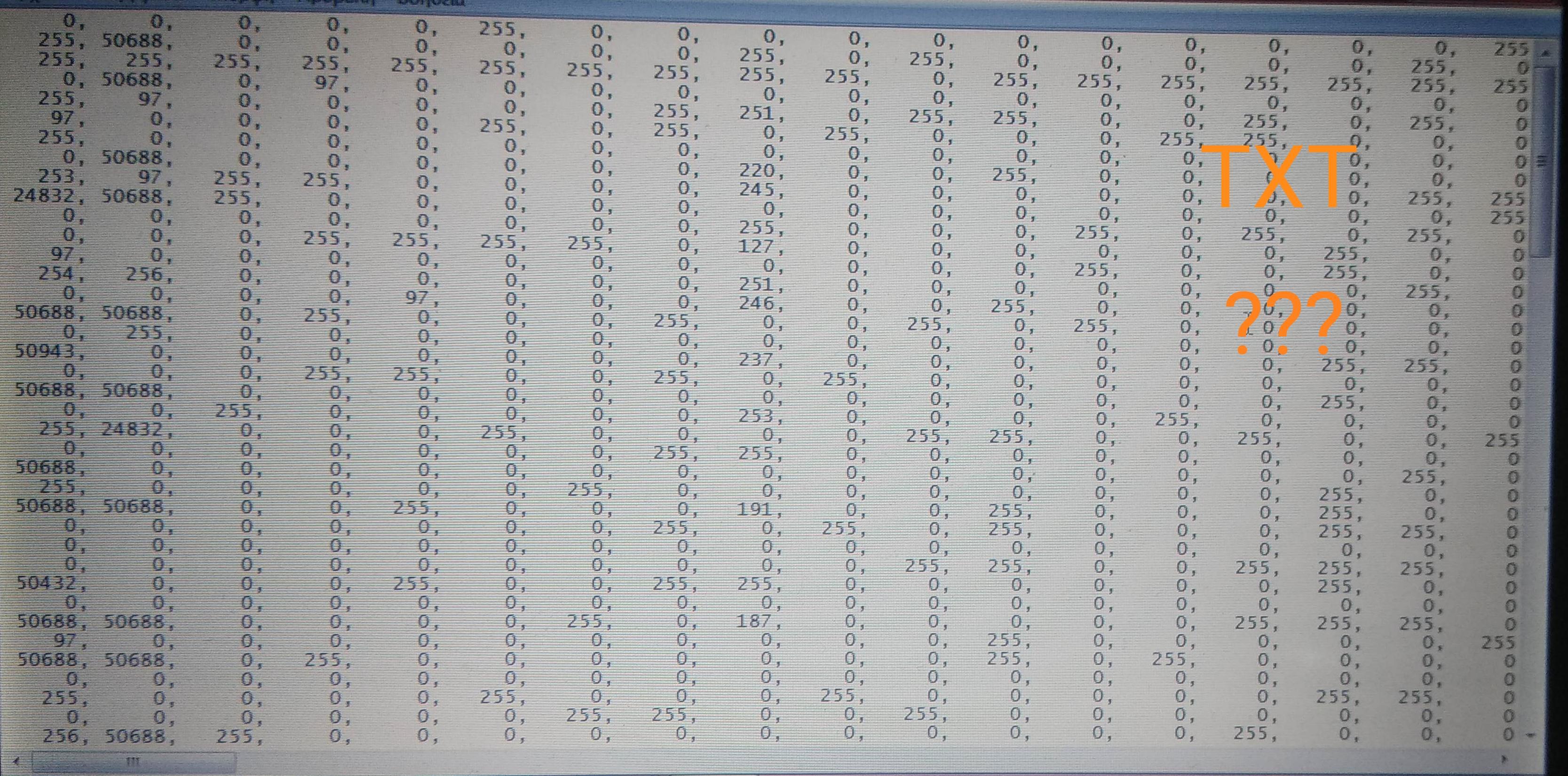

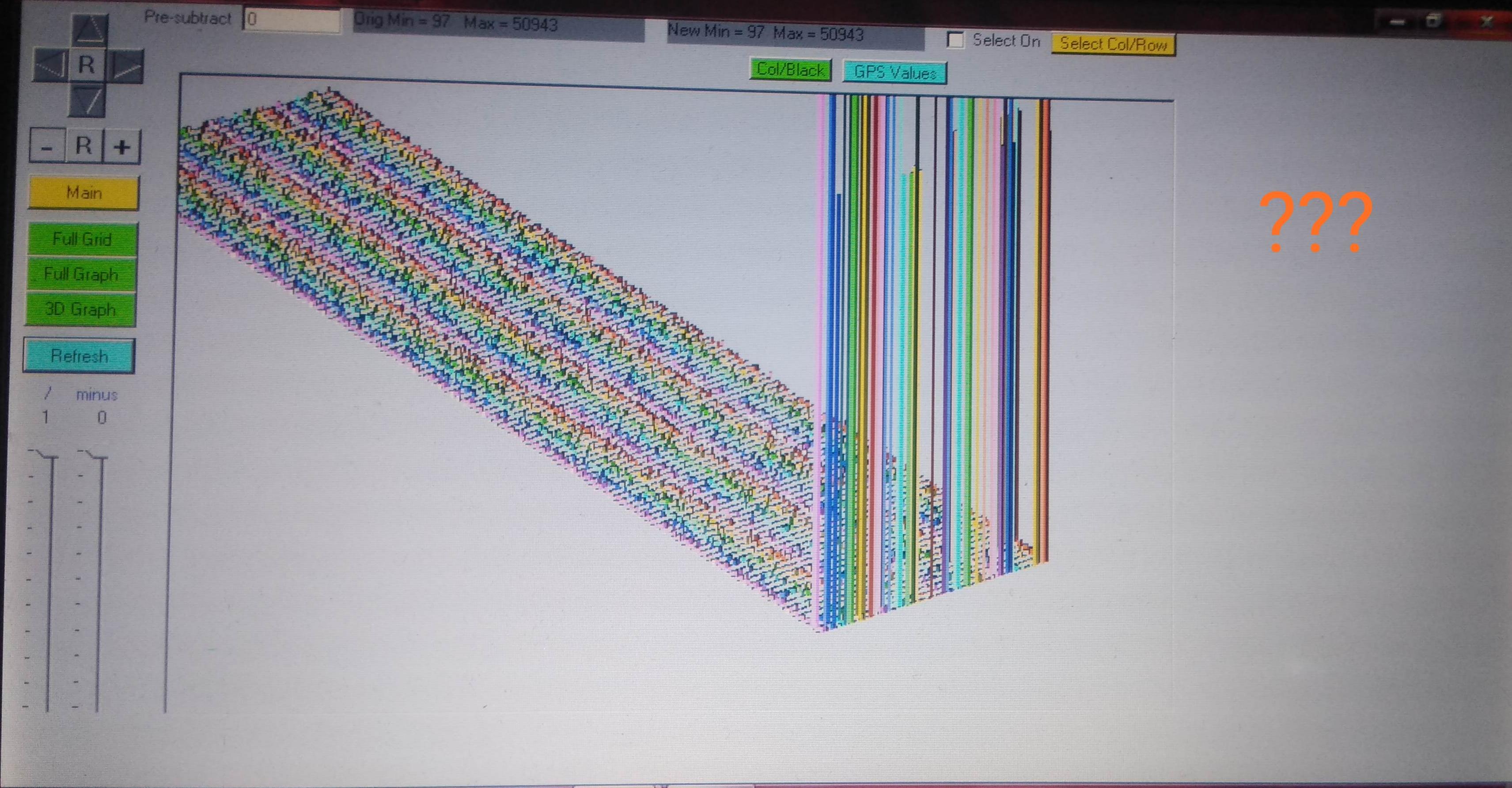

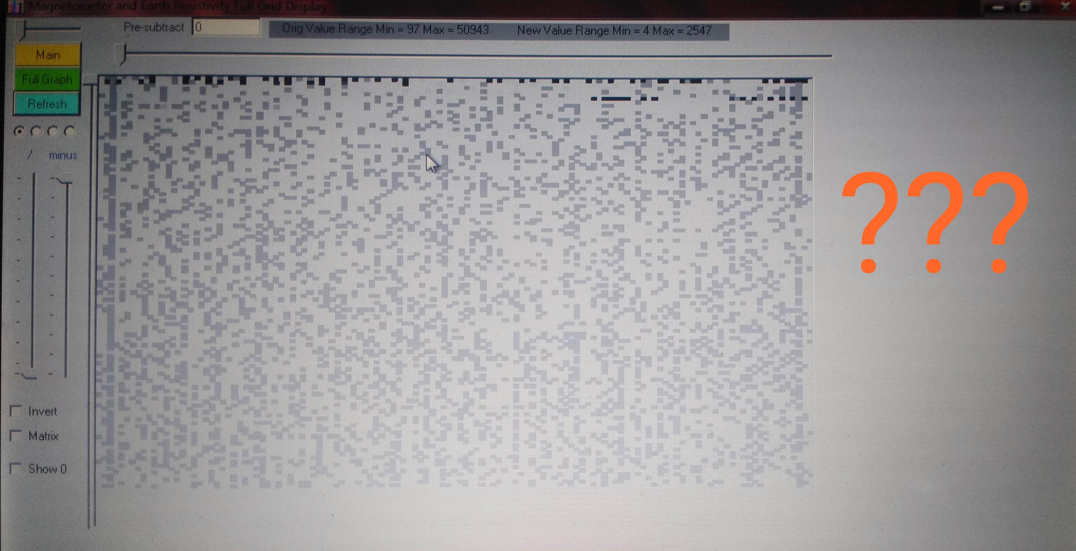

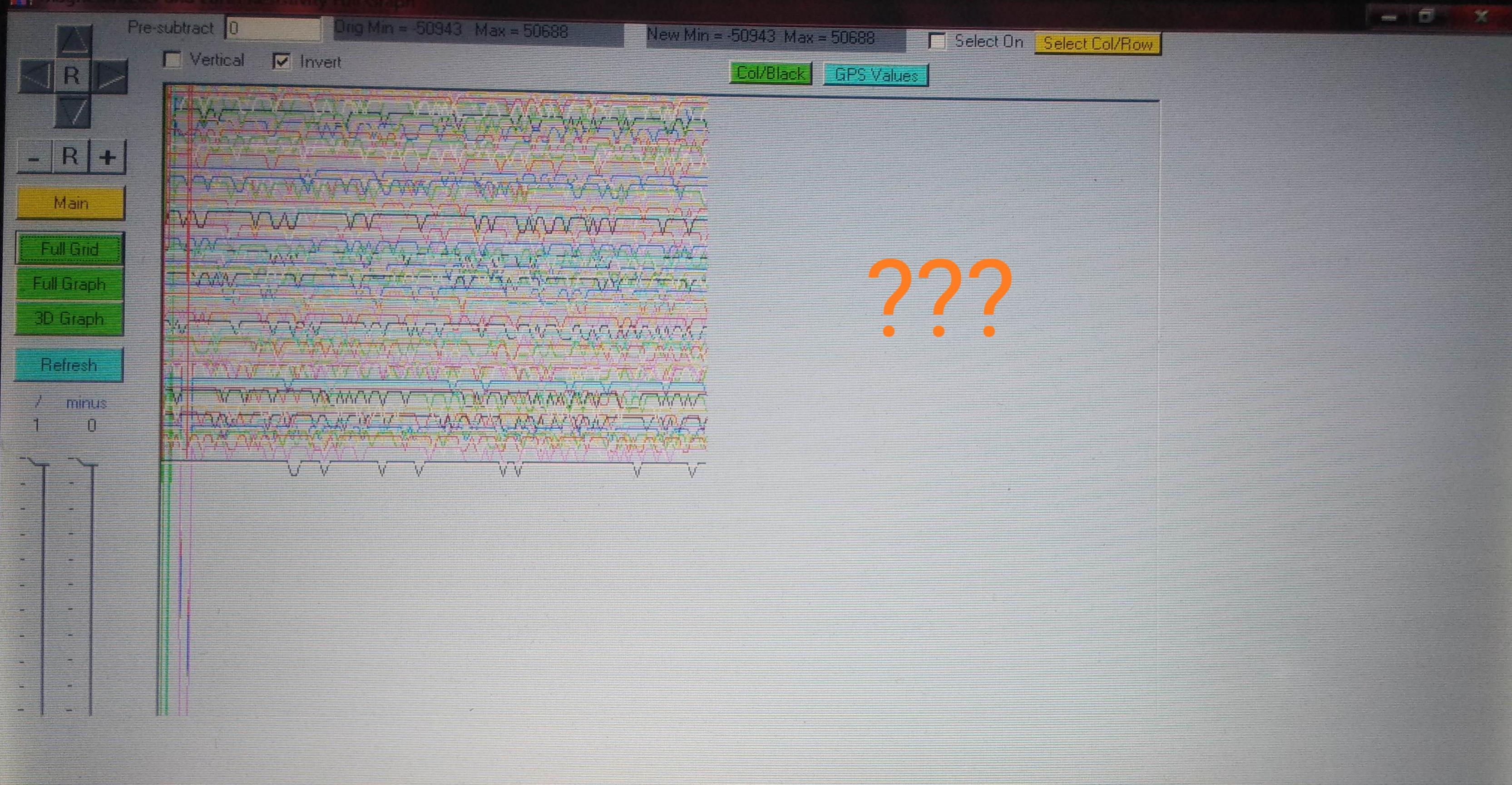

        • I have put them as in the circuit when I open it it gives me "2 eeproms chips" but when I send the data to the computer the graph is wrong it does not send the data correctly. It shows me the whole column and not the correct column-rows, Example see the photo below

          • Delete eeprom chips first.
