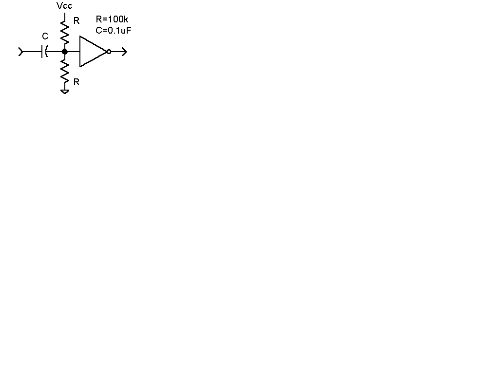

      ->Normally you have a sensors that gives 40khz, the flip flop divides to 20khz, the pic compensates, so finally a 40000 value.

      =>I'm going today to my local electronic shop, and will add something to reduce the decay of signal that triggers the flip flop. This decay is reduced when the sensor goes to n-s where you've got the least frequency, and so the flip flop is not twice triggered anymore.
      I can also suggest you to try to make your own sensor just for testing purpose. Basically it is sort of relaxation oscillator (reminds on Armstrong or Meissner). It has fb and tickle coils both wounded on mumetal core. Core is thin and flat, low mass so it doesnt need much power to saturate.
      The way you explaining your problem looks like cores at your sensors are oversaturated at some point, shortly but enough to make problem!?
      =>Yes, I think you're right. but they are satured for a frequency above 40khz, the decay is enough to trigger the flip flo. And normally this device can go from 35khz up to 105khz, so there's a problem with those sensors. Maybe one day, Bill Speake will explain, but now I've got to find a solution by myself, to make the epe work precisely as it shoud work. After this device works, I've planned to build a proton gradiometer, but that's another story.
      Maybe trivial, but check power again
      =>alreay removed the sensor, and putted a +5,2 v on it, got a measurement directly on the sensors output, same decay problem...
      Tie cap and resistor as closest as possible to sensors pins.
      => it's the case, they are at 10millimeters...:-(

          Yes I did. I made a final test yesterday : remove completely one sensor, use another +5v power supply, and simply make a measurement.
          Exactly the same results !
          I'll try this evening to solder a 100n capacitor between fgm-3 output and ground to reduce the decay, if it 's too long, I'll try a 2,2n.
          I'll report here the results and picture of the signal !
          • #95
            I finally managed to get rid of this fgm-3 problem.
            There are two spikes on the signal, and a decay between them, this causes the flip flop to trigger when the fgm-3 frequency is above 42-43 khz.
            Under those values, the second spike gets lower, and the flip flop doesnt trigger, this is really problematic as the flip flop goes directly to a frequency twice as less as it was before.
            a single sine to square converter resolves the problem, I've tested it and it works, the fgm-3 is well squared, the spikes and decay are eliminated by this converter, so the fgm-3 signal is stabilisated. On the schema I've provided, the hex inverter is a 74hc14.
            I've mailed Bill Speake 2 times, three days and two days ago. I dont have any answer from him and his company, so if you buy the fgm-3, you know what can happen to you, but you can make the little converter and the problem will be gone.

                            • overshoot in FGM
                              Hello
                              Stephane.mg
                              Not that it helps regarding the sensitivity of the gradiometer. There seems to be a reversed diode in your FGM-sensors, based on the circuit of the sensor this will result in a overshoot, and negative spikes due to the back emf not countered by the diode similar to the ones you experienced on your scope. Maybe you could file a complaint and get a refund. Good luck with your upcoming purchase of the PPM. Remember that as for the sampling you will have to sample with the PPM as for the FGM type, descibed by Ivconic to get the resolution you want (surface search for small anomalies?). Sampling is limited around 1 HZ as the PPM precession rate is in this area.
                              Sincerely
                              olsteffe
                              • yes you're right, surely a reversed diode. but when I've read in the fgm-3 specs that there were sensitivy differences between devices, I decided to give up everything.
                                for example , one sensor rotated at the max sensitivity, orientated e/w gives 50000 hz, put to n/s gives 54000
                                the other, same conditions : 48000 and rotated to n/s gives 49000 hz !!!
                                even if I modify the microcontroler program, it will be not precise to make some serious detection. the fgm-3 sensor is not well tested, and they dont have serious building tolerances, so it's not a serious product.
                                what I would do if I didn't bought the ppm from willy is to replace them with the honeywell hmc1001 which seems pretty sensitive and surely built better than the fgm3. I would have to put a voltage to frequency converter to feed the epe with frequence. But I will not do, I dont need anymore the epe, and I'm really disappointed by Bill Speake who didn't even responds to my emails.
