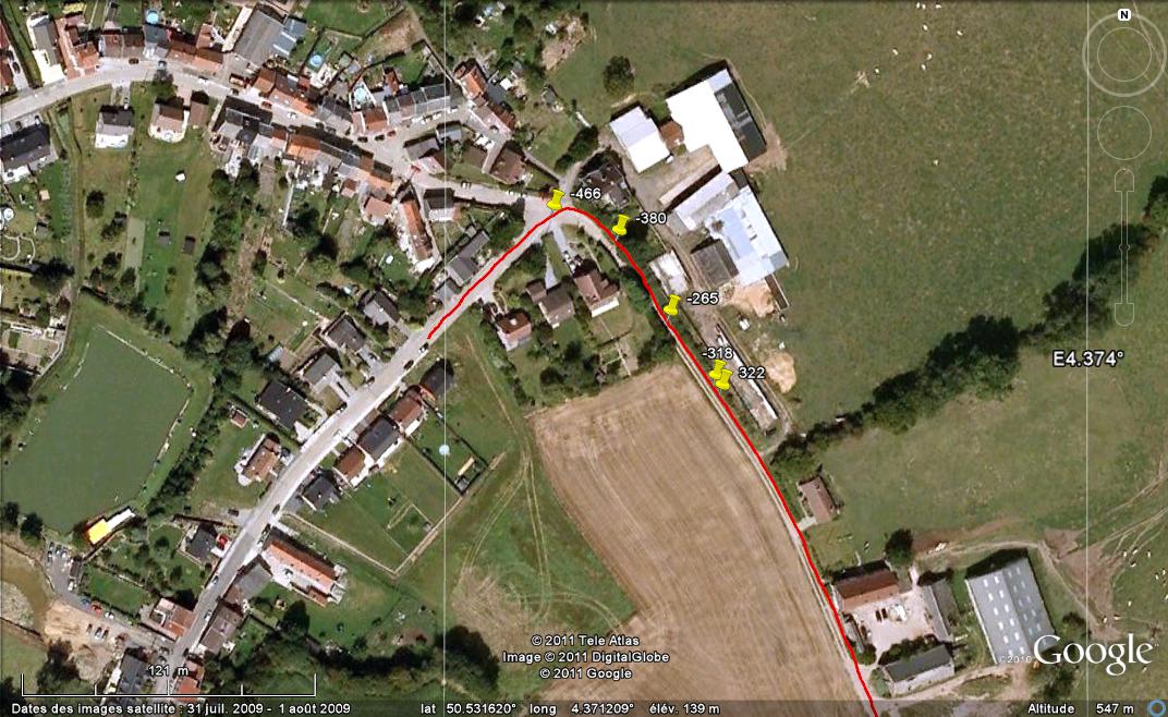

          Hi again,
          This is an experiment I have made to demonstrate the potential precision of a single commercial-grade GPS engine used to locate a PPM survey and the capabilities of our MarkIV system to support very large field gradients.
          I made this test on a dirt road in the countryside. I went up and down the same road and I crossed the path of a large gas pipeline running under the road. Thus, I went twice over it. See the large field gradient and still, I only got a single bad reading. The other large gradients are due to my car parked along the road. I passed at three or four meters aside of it.
          With an HDOP of average 0.8 and 11 satellites in view, the GPS tracking is perfect. On one leg of the path, I walked exactly on the same side of the road and on the other leg, I walked on the other side. This is perfectly clear on the XY plot. Finally, I walked back to my car along the road but at 3meters aside of it.
          - The first picture shows a KML file as displayed by Google Earth with some of my annotations. You can clearly see that the precision of the GPS fixes is more than sufficient to locate any potential target within a radius of one meter.
          - The second file is the survey file itself loaded as a zipped Excel file with the plottings of its main data.
          - The third file is a screen dump of a Wndows program I have written to review such a GPS-based survey file. The field gradients are displayed as a time-based barchart and as a XYZ plot using dots of varying colours and radius.
          Both plots are responding to mouse clicks by giving the corresponding lat/long and B field values.
          Willy
            KML generation
            Hi all,
            I have still improved the grid review function by allowing the PPM operator to generate a KML file (Google Earth) with the full GPS track and any specific waypoint selected by the operator during the review.
            The GPS track is traced as a red line by Google Earth and each generated waypoint shows its location as a pushpin and the field gradient value there.
            Thus, it is now possible to study a GPS-based survey track and select the potential target locations without using any PC.
            The generated KML file is then displayed in-situ by the Google Earth program and any comment can be added by the user using the Google Earth program itself.
            I have attached a JPG file to show the effect of a small example of a GPS-based PPM track and a few potential target indications generated by this function.
            I also have attached a ZIP file containing the actual KML file which you can use in Google Earth if you have installed it.
            Willy

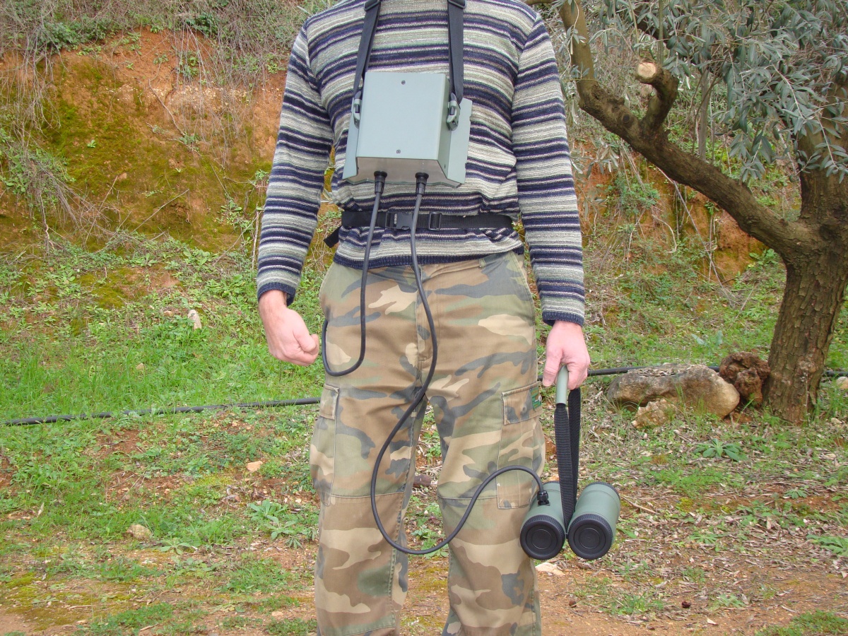

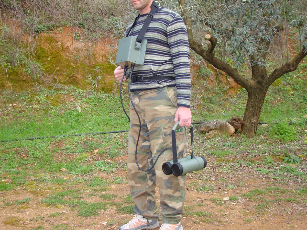

                  PPM MarkIV custom packaging
                  These are a few pictures of the customized packaging of the MarkIV with GUI option built by one of our clients.
                  Note the simplicity of the front-panel due to the fact that the GUI module has a touch screen.
                  Willy

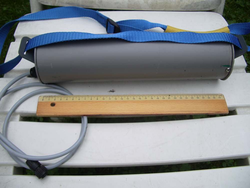

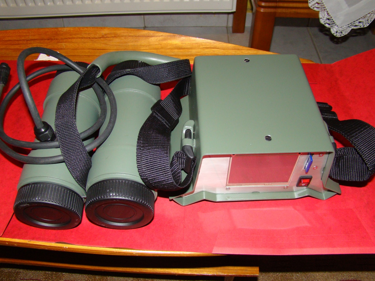

                      Note that the MarkIV system pictured on the previous post has been packaged by one of our clients based on the KIT of electronic boards + GUI option + Sensor option.
                      The MarkIV system as delivered in its fully assembled package mode + GUI option is packaged in a watertight NEMA box as shown below.
                      The standard sensor packaging is as shown below.
                      Willy

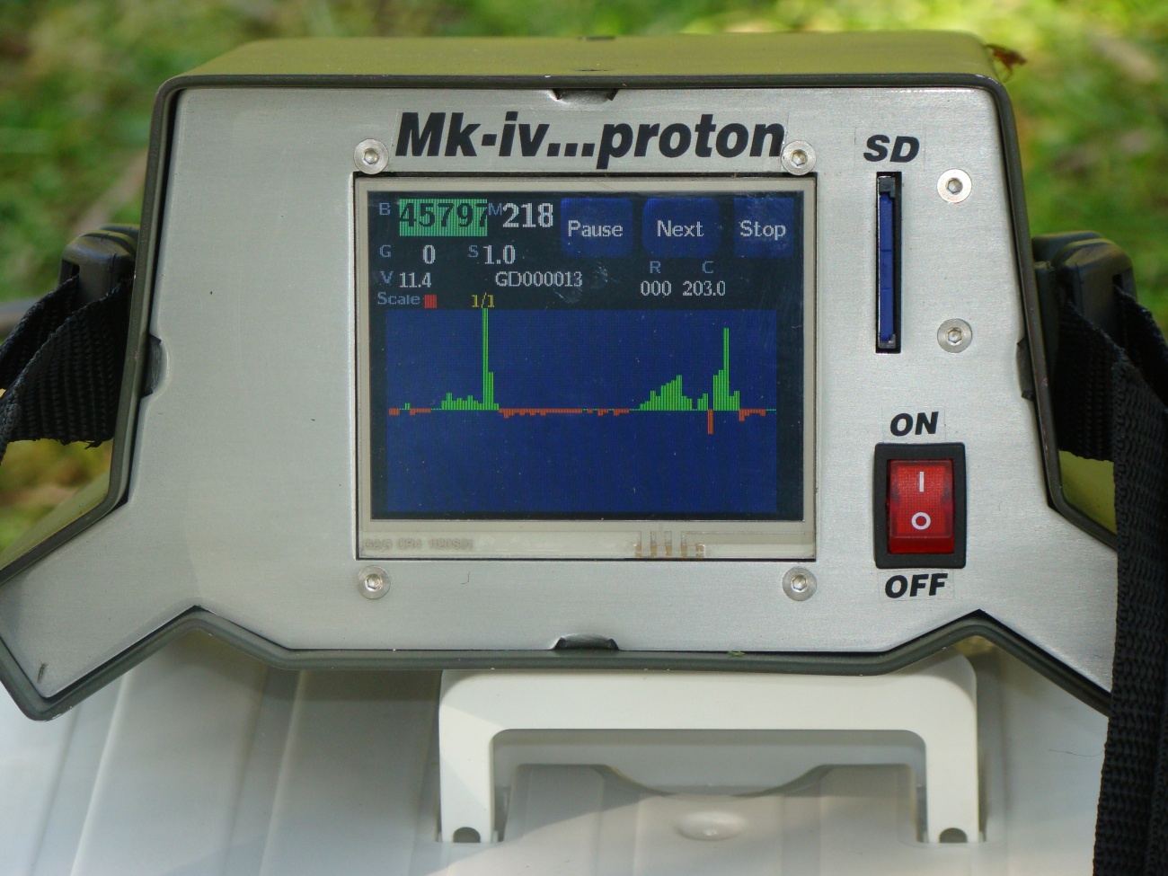

                        video PPM-MarkIV with GUI
                        This is a first video of the MarkIV system with the GUI option.
                        http://www.youtube.com/watch?v=5a7Ev...feature=digest
                        It shows several aspects of it:
                        1. Its very good stability in static mode. It makes one reading per second with the sensor at a static position and no external disturbance. This demonstrates its high Signal/Noise Ratio. The field variations it measures are just the natural variations not exceeding one nT (see the bargraph and the G value on the screen).
                        2. The setup of its various parameters.
                        3. A review of existing grid files with a 1D (bargraph) and color 2D plotting on the instrument's screen. The two grids have been captured on a test ground described in our web site in the benchmark testing report document.
                        The next video to be published will show a phase of a real survey session.
                        Willy
                          Hi.
                          A test in real time [by Mark-iv] to iron mass to 4.40 meters deep! With surface 1.5m x 0.70m.
                          http://www.youtube.com/watch?v=jR_WgOQcv7E
                          Regards-Leon.

                              Hi Alexis,
                              The nice looking packaging you see on the video has been built by Leonidas from a MkIV KIT (just the set of electronic boards) he bought from us.
                              Our own packaging is different but the functionalities of the final system are exactly the same.
                              The basic version of MkIV unit packaged in its watertight NEMA box with LCD and keyboard costs 1995 Euro and the smart GUI module option with touch screen replacing the LCD and keyboard costs 400 Euro.
                              Willy
                                Dear Alexis, the results they is precisely the himself, simply the box it changes.
                                See Photos.
