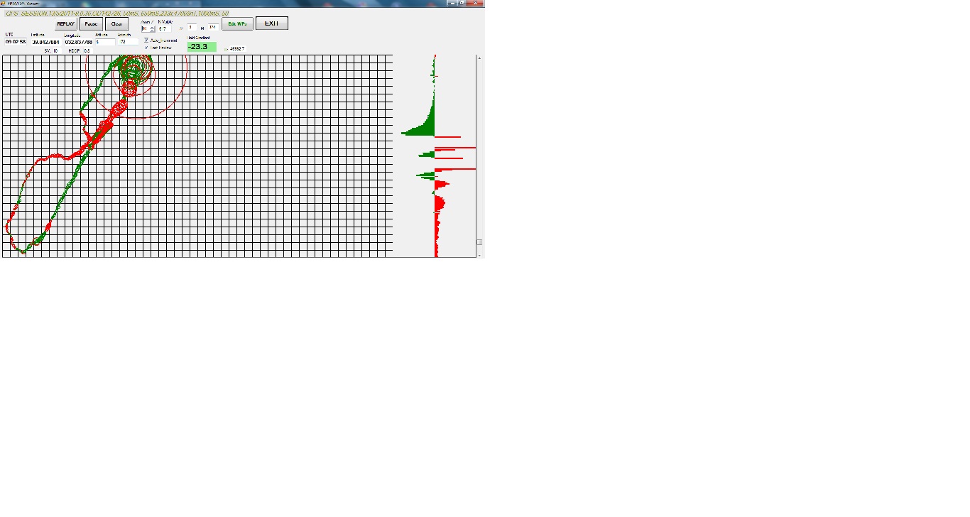

      I have attached a screen dump of the program in operation in relation to a PPM MarkIVB equipped with the GPS Option.

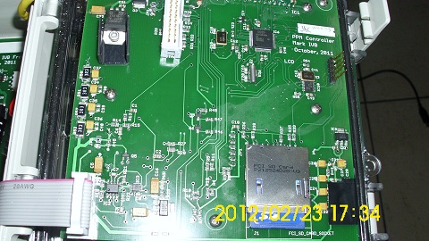

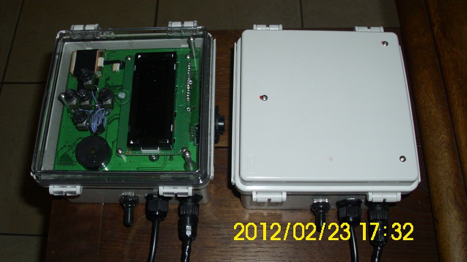

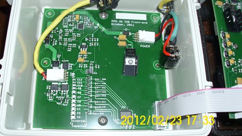

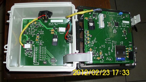

              This is few PIX of two markIVB systems built for underwater surveys. The first one has an LCD+keypad to be able to make underground as well as underwater surveys and the second one is a 'blind' configuration. Both have a USB connection to an operator interface on a PC.
              You can see the two boxes closed, one box opened and two pix with the details of each board.
              Inside the box with its transparent cover, you can see the GPS module at the upper left of the picture.

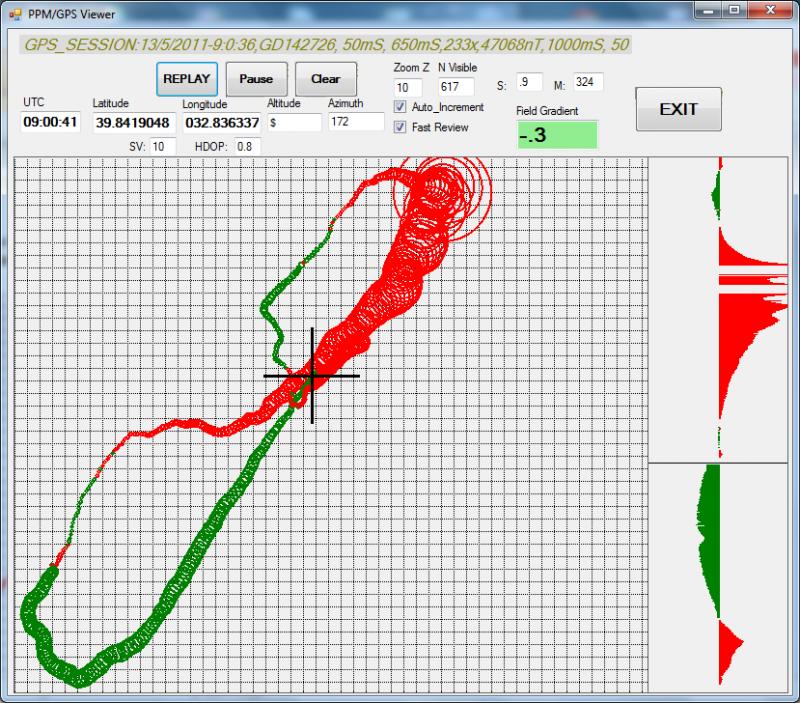

              The last picture is a screen dump of the PC program while reviewing one GPS-based grid file.
