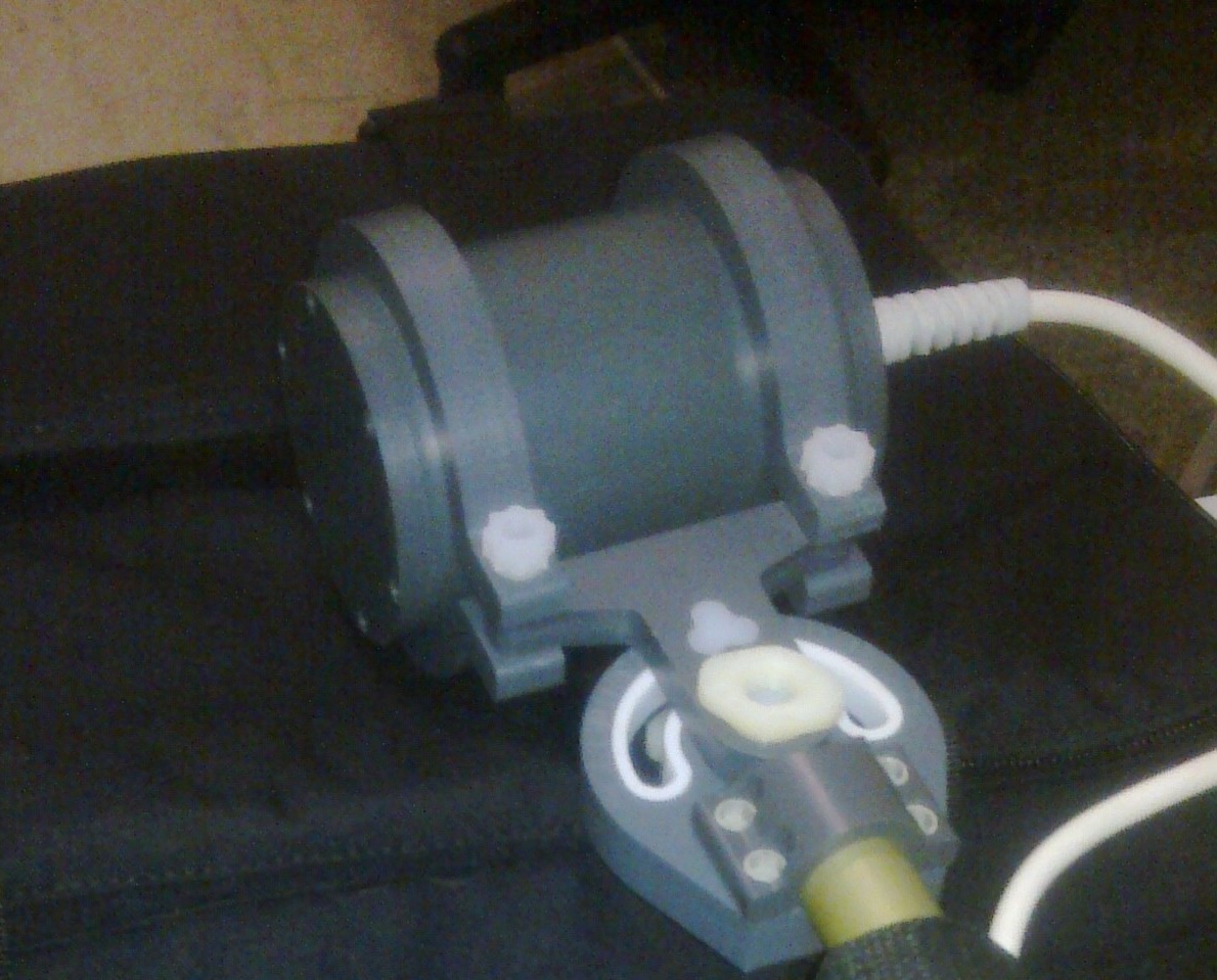

      • #48
        Development the overhausers sensor is even more difficult task than creating a proton magnetometer. If I give for you detailed description, you are unlikely it to repeat. It took us more than two years before we got a working sample. For a start, we tried to copy the finished commercial sensors.
        For example, for tuning the RF resonator are necessary skills in radio engineering. To select the desired radical - PhD in chemistry. For the manufacture of glass ampules - a good glass-blowing workshop. To remove oxygen from the solution - a chemical laboratory. Going this way you will get an increase in SNR by only 10-15 dB.
        In an attachment - a photo's of the sensor prototype.
