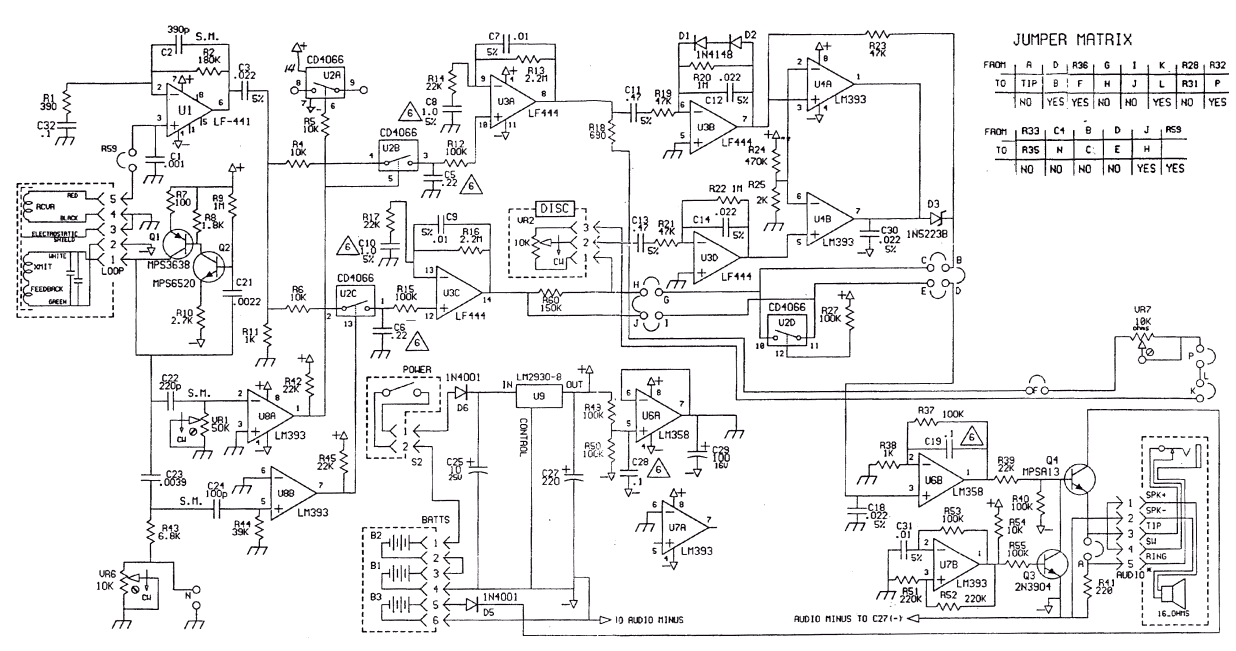

          Ok, Does anyone have a CL II and a CL III schematic to compare, I've found a CL I but no CL III. I know they both have 6.59khz freq, It has to be something on the frontend of the recv circuit. Still no call back form Whites.

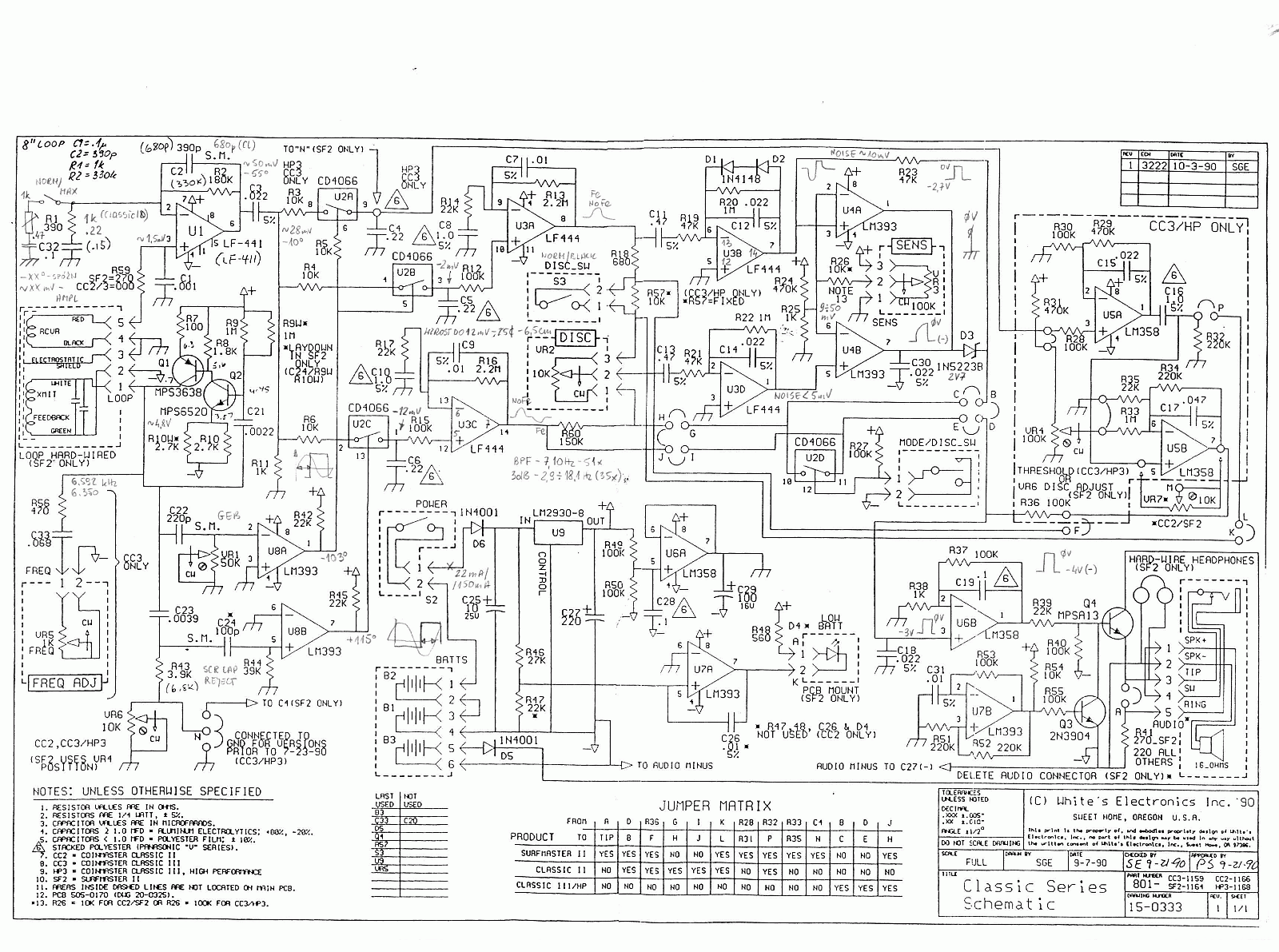

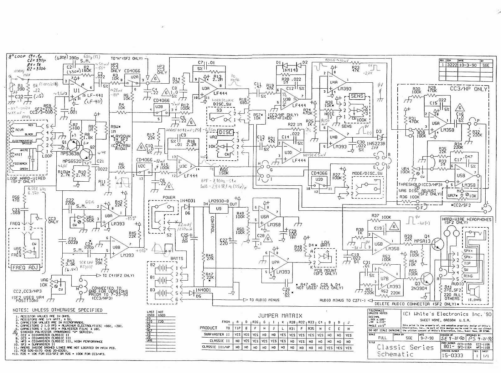

              • To save some time for others, here they are , CL I, CL II, CL III, CL IIIHP and Surfmaster II. Now to figure out how to make the Bluemax work on the CL II.

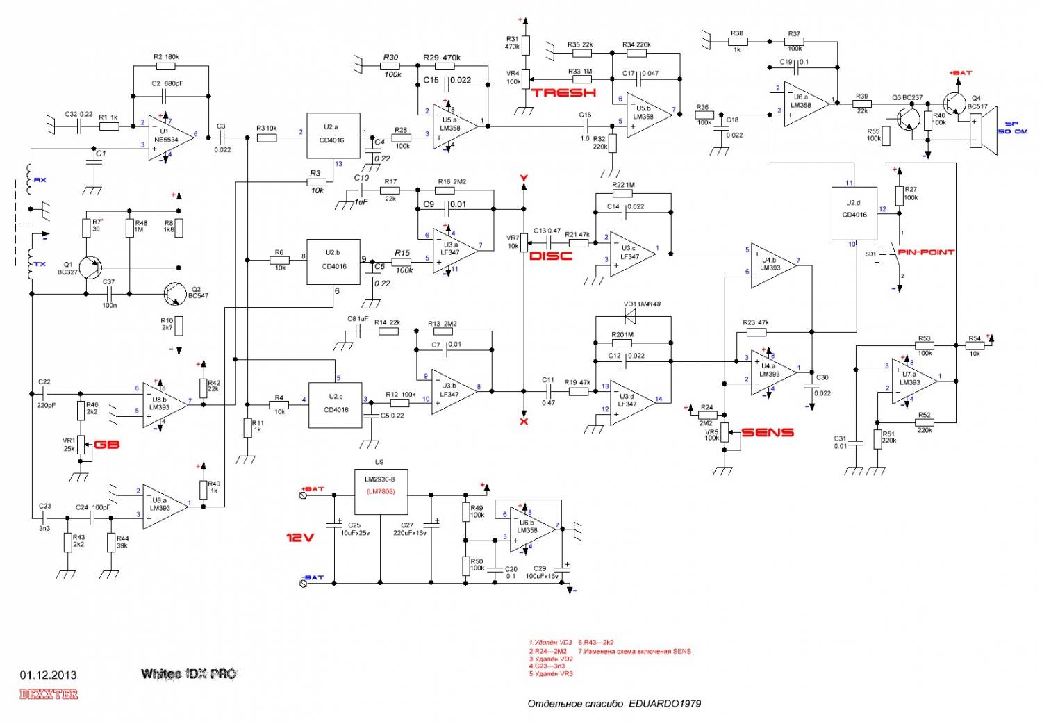

                • Here the IDX Pro which takes the Blue max, as you can see there's slight differences in the GB circuit.Click image for larger version

                      Very similar to the one I posted on #203. I'm seeing a few differences, The old obsolete transistors Q1 and Q2 are replaced with newer models and the biasing has changed , but the main thing I noticed is the GB circuit did change. I don't think this will be a big issue to swap over to the newer coil now.

                          • ground balance
                            IDX 2.2k to 27.2k
                            II 0 to 50k
                            I suspect if you put a bluemax on a Classic II it will just need the ground balance adjusted internal
                            I have tried the other way and round and Run out of adjustment. But it works fine if I add a 10K resistor
                            • And maybe change R43 if the disc is way out ?
                              • Originally posted by Koala View Post
                                I may just copy the IDX GB components to the CLII and upgrade Q1 and Q2. What couple dollars worth of parts and 2 hrs work. I'll just do it all when I do the Mr. Bill mods. Right now I'm working on a Tube amp so the bench is kind full.
