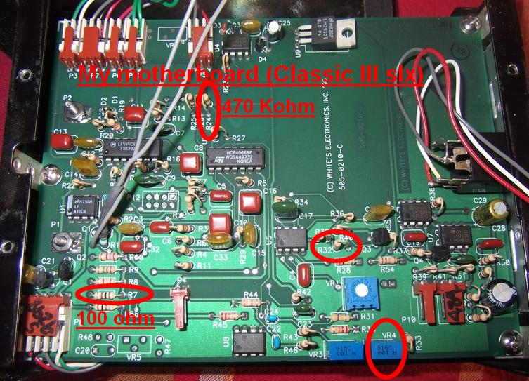

        Hello.
        I'm new to the forum.
        I'm in France. I have a classic 3 slx for many years (1999).
        I want to realised (myself) Mr Bill's mods on my detector.
        The Classic 3 SLX is made factory with the "ground balance".
        I have to check and modified the following points:
        1) Replace resistor R24 with a 2.2 Meg. You could have either a 470k or a 1.5 Meg there depending on when the unit was manufactured.
        2) Check resistor R7. If it’s not a 51 ohm resistor, replace it with one of that value. It’s most likely a 100 ohm from factory. Later manufactured units had 51 ohms.
        3) S.A.T changes. R32 220k resistor can be changed out. Raising the value been installing a 375k running it through a toggle switch with the 220k.
        4) Threshold: Remove VR4 trimmer off the board replacing it with a 100k linear taper, single turn potentiometer.
        Yes but……
        5) Ground balance: Remove VR1 Trimmer off the board. Replace with a 50k linear taper, single turn potentiometer.
        Should I make this change knowing that my detector already has a "ground balance"? See photo
        Risk of malfunction or inconsistency if I add this mode?
        Thank you in advance for the help you bring me

            • #51
                          Hello
                          Following my previous post, here is the picture of my motherboard. Is it the same as the Classic sl ? .... Can I do the following mods ? :
                          Tial
                          • #58
                            It looks like the same.
                            But I see that vr1 also on the motherboard.
                            And that is the ground balance!
                            Best regards Theo.

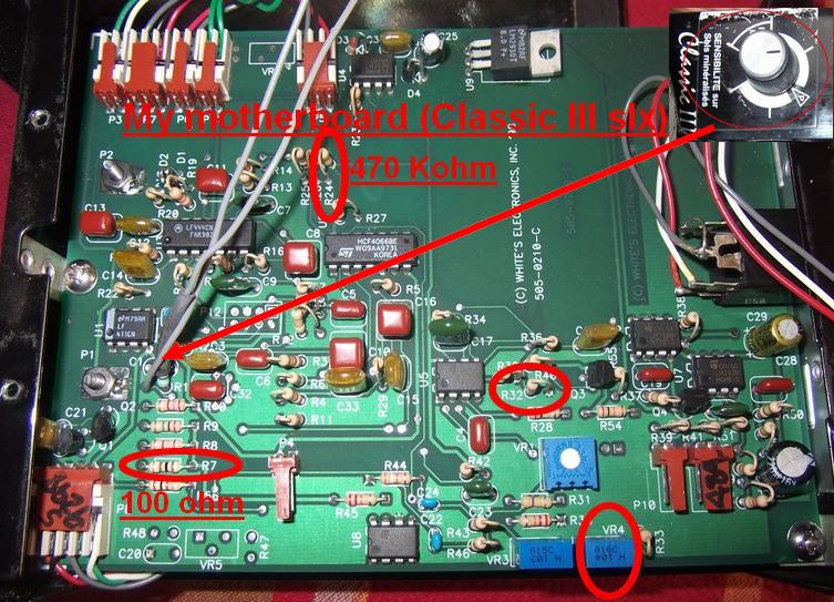

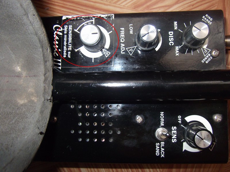

                            • #59
                              Best regards Theo.
                              The Classic III SLX already has a ground balance . See the gray cables connected on the motherboard.

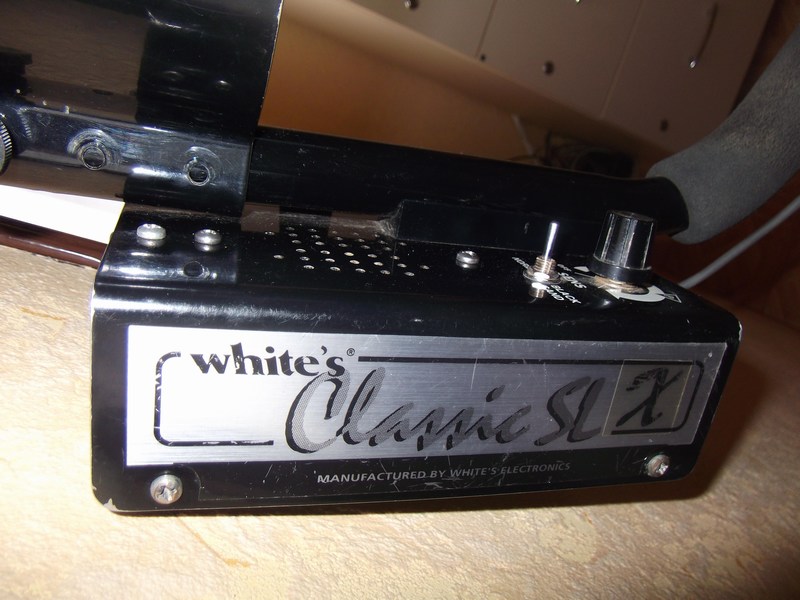

                              • #60
                                Yes I know, that's why I find it confusing!
                                It is therefore a slx?
                                I only know the sl version!
                                On Internet is almost nothing to find about this version.
