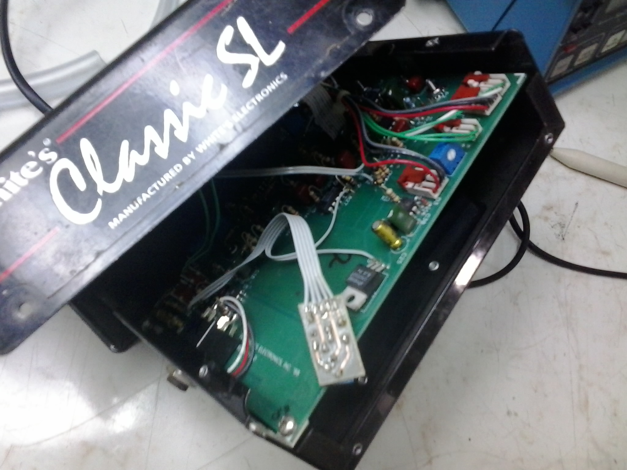

                • #68

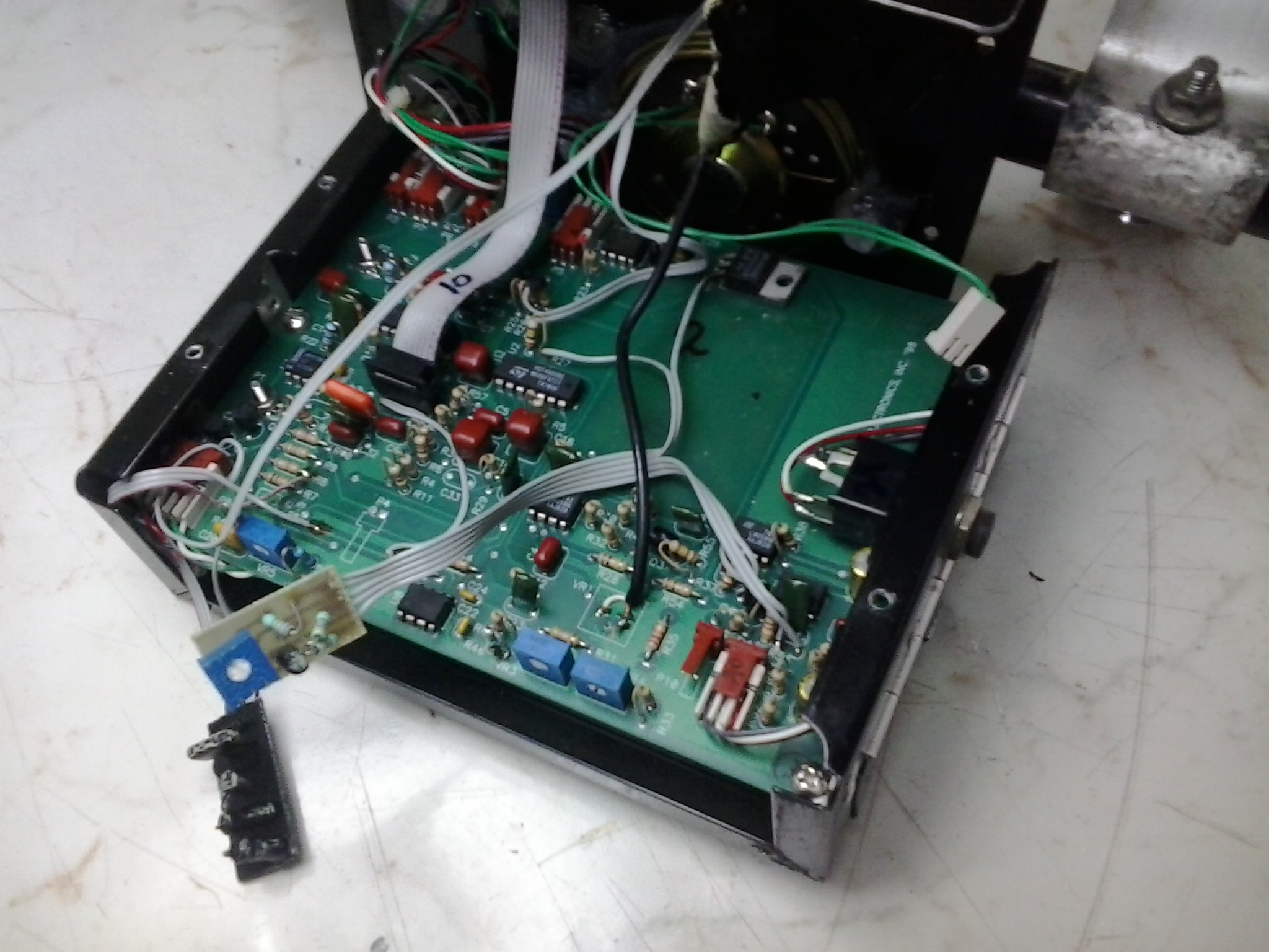

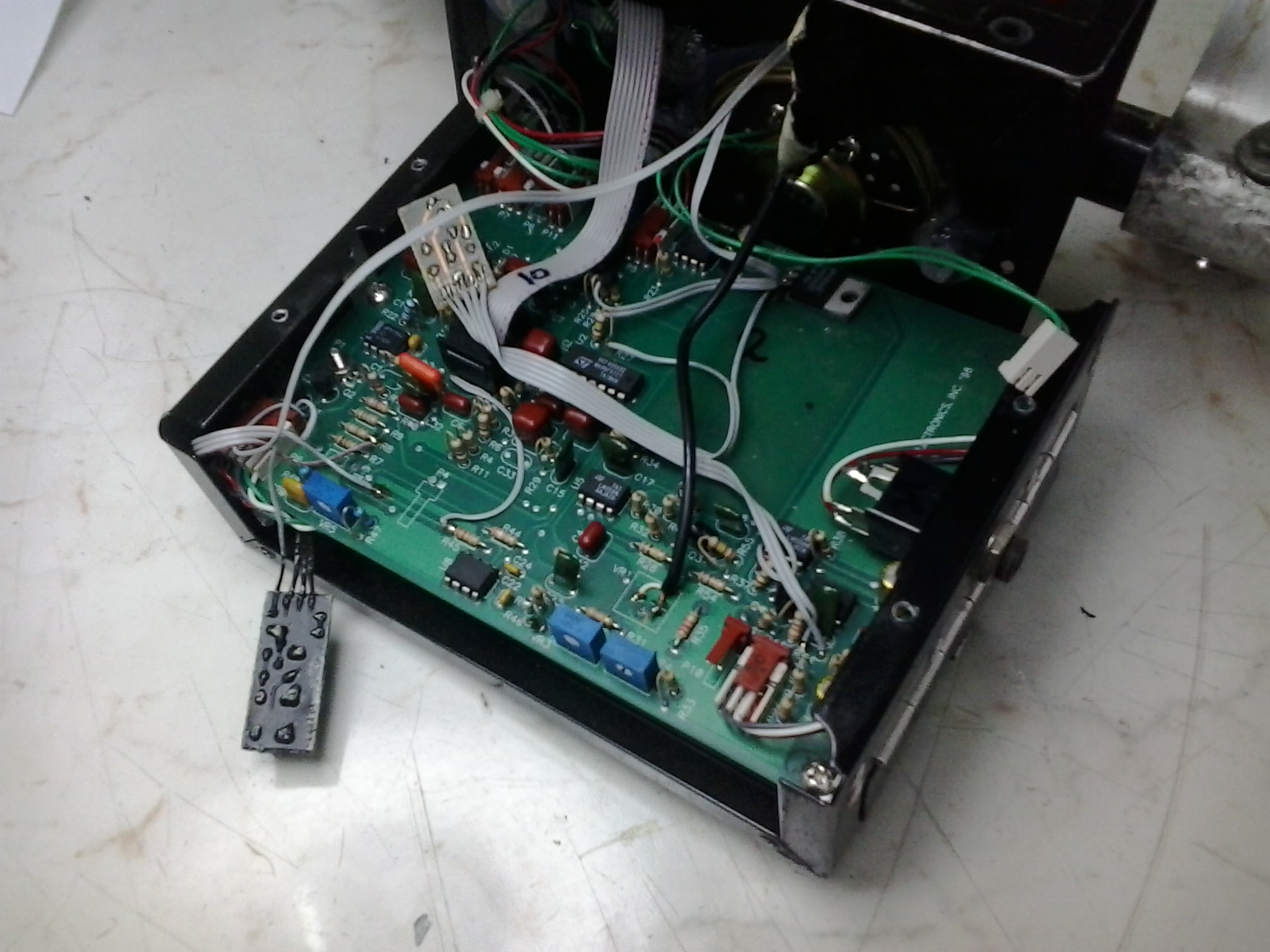

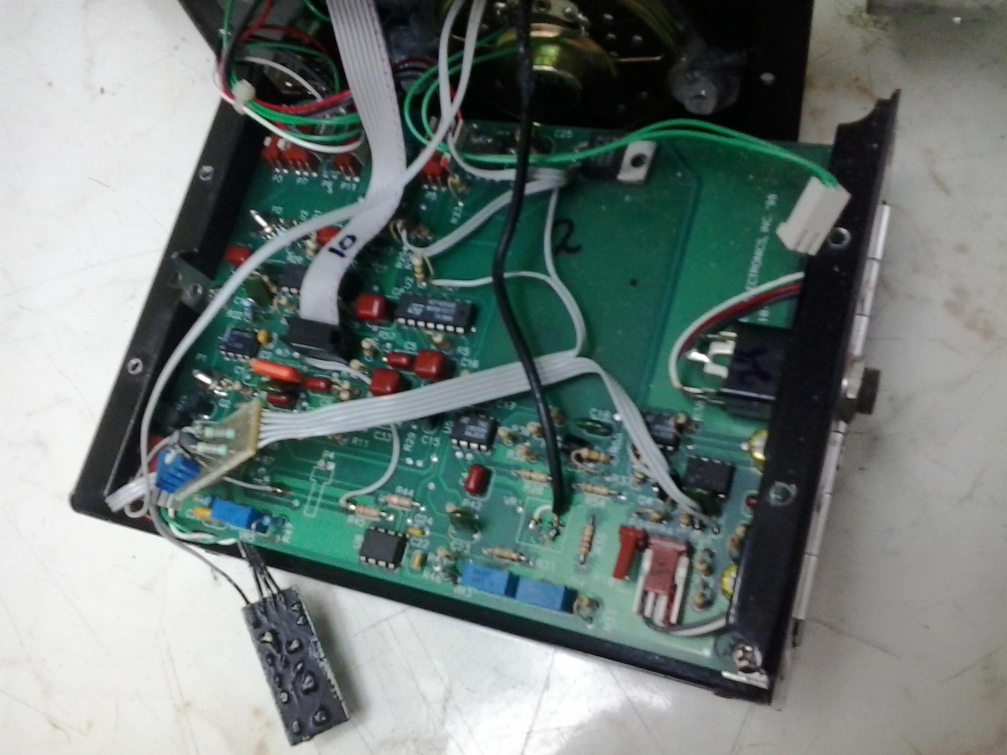

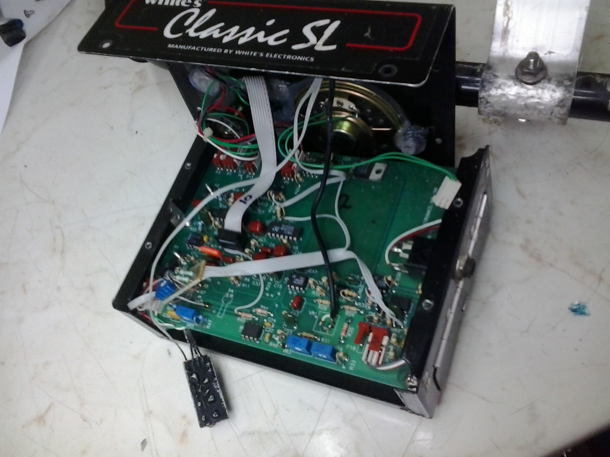

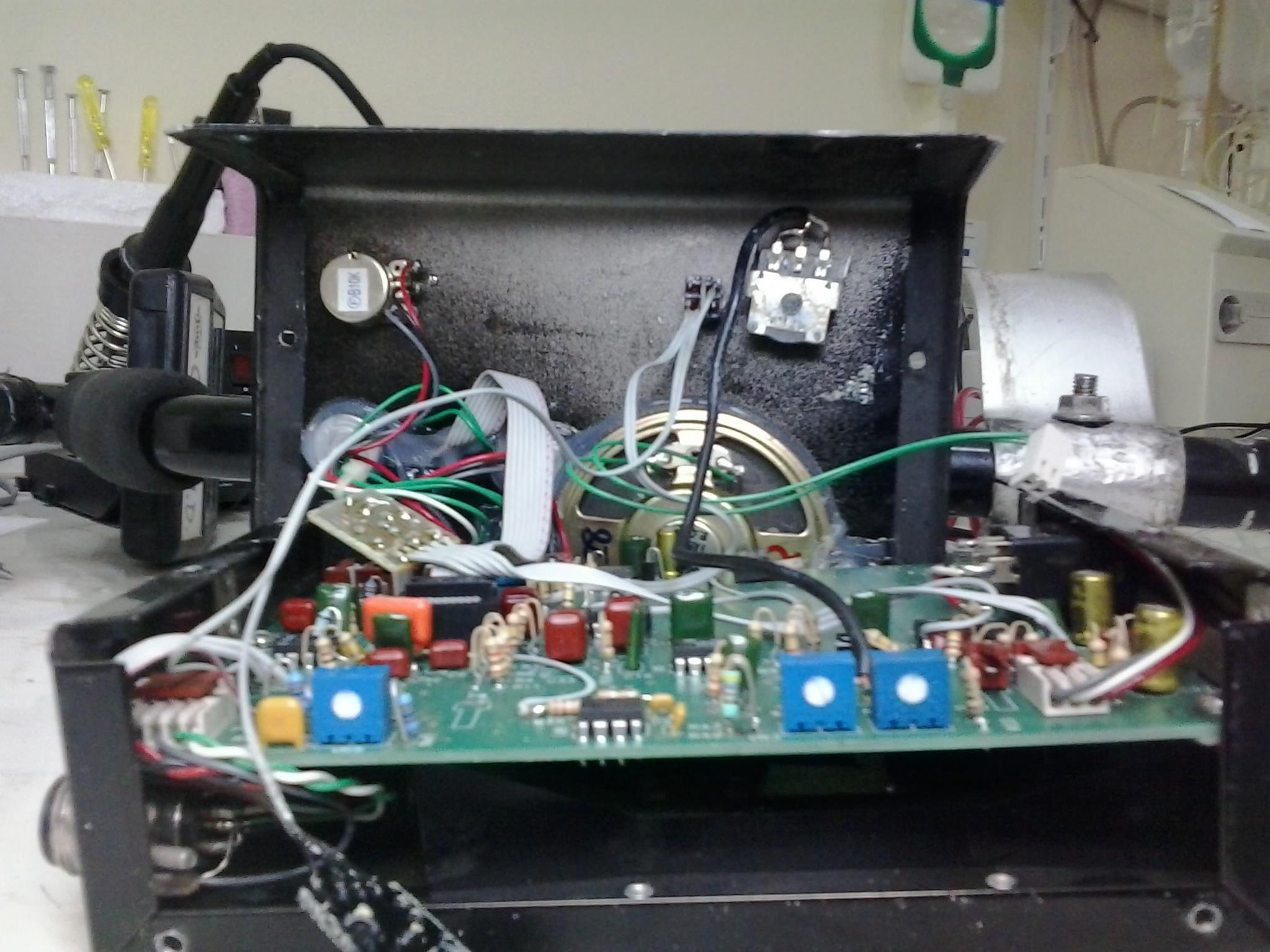

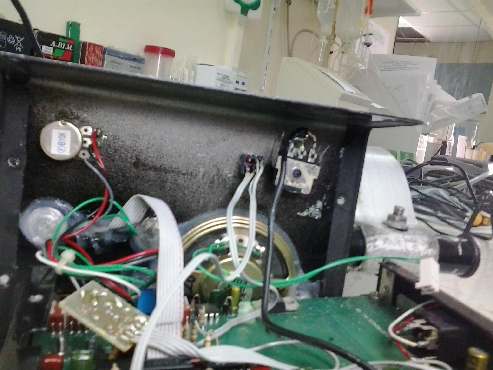

                  in a classic sl opened found two conversions. Two small pcb. One was painted black. Does anyone know what they are doing ?
                  Has anyone the schematic ?

                  • #69
                    My old friend is the one who wrapped his White's detector around a tree and ran his bayonette right through it's ten-ringer and mailed it to the factory saying "I killed it". They sent him a new one with modifications for bad ground..
                    is this you ask?
                    • #70
                      you mean,that are factory conversions for heavy soils...??? and no need for europe ?
                      Has anyone the schematic ??

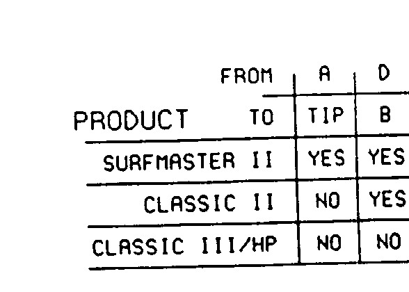

                        I have read that Mr. Bill used to do his mods to the Surfmaster II. The VLF machine with the standard 9.5” 6.5 khz stickered as “amphibian” coil.
                        I have one and do not see it in the lineup of supported machines for the mod. I emailed Bill a week or more ago and I am not sure if the email address was still in use or if he responds so I will ask here.
                        Mr. Bill or anyone knowledgeable can you tell me if the modifications are the same for this machine. I understand that adding external pots would be a chore on a waterproof machine but the depth and sensibility is less than I expected.
                        I had to replace the coil. I got a brand new one and figured while I am soldering on it this would be the time to do the mods. Interesting that the coil was slightly different it is a 950 style coil with yellow and blue stickers not the older 9.5 blue max types with the yellow and blue Amphibian sticker like it originally had. I purchased the coil from a genuine Whites repair person who sold it is an “Amphibian”. Perhaps Whites changed them at some point. It works; I was just surprised it was different.
                        I know they had a surfmaster II and a surfmaster II plus. Both VLF Does anyone know the difference?
                        It is also I little quieter than I expected. I don’t think it would be heard at the beach over the serf. I know this isn’t meant for saltwater I am just saying that to give you an idea of how quiet it is. It has three blue pots on the board but I don’t think volume is one of them.
                        Thank you for any help in advance. I can’t wait to get out to my local lakes with it.
                        • #72
                          Surfmaster II and Coinmaster Classic II use same PCB marked like as '505-0170-B'. we discussed on this... but difference of Surfmaster II Plus is unknown, no photos for the comparison...

                          • #73
                            Yes, I figured that out. Thank you for the reply. I have two control boards the one I was looking at was 505-0170-A. The new old stock one I am using is labeled with the -B. I do not know if that makes it a plus. Both boards are similar.
                            I will have to reread the thread again. Do you know which of the mods Bill would do to the Surfmaster II? I don't think it got all of them but obviously I do not know. I am compiling my shopping list now and noting the locations. This is great. Thank you.
                            • #74
                              honestly I am not in course... but may be same like for IDX I told here as schematics are similar
                              http://www.geotech1.com/forums/showthread.php?18925-White-s-IDX-Pro-PCB-and-mods&highlight=IDX
                              Mr Bill has been asked did answer me that it is not his mod I told about.
