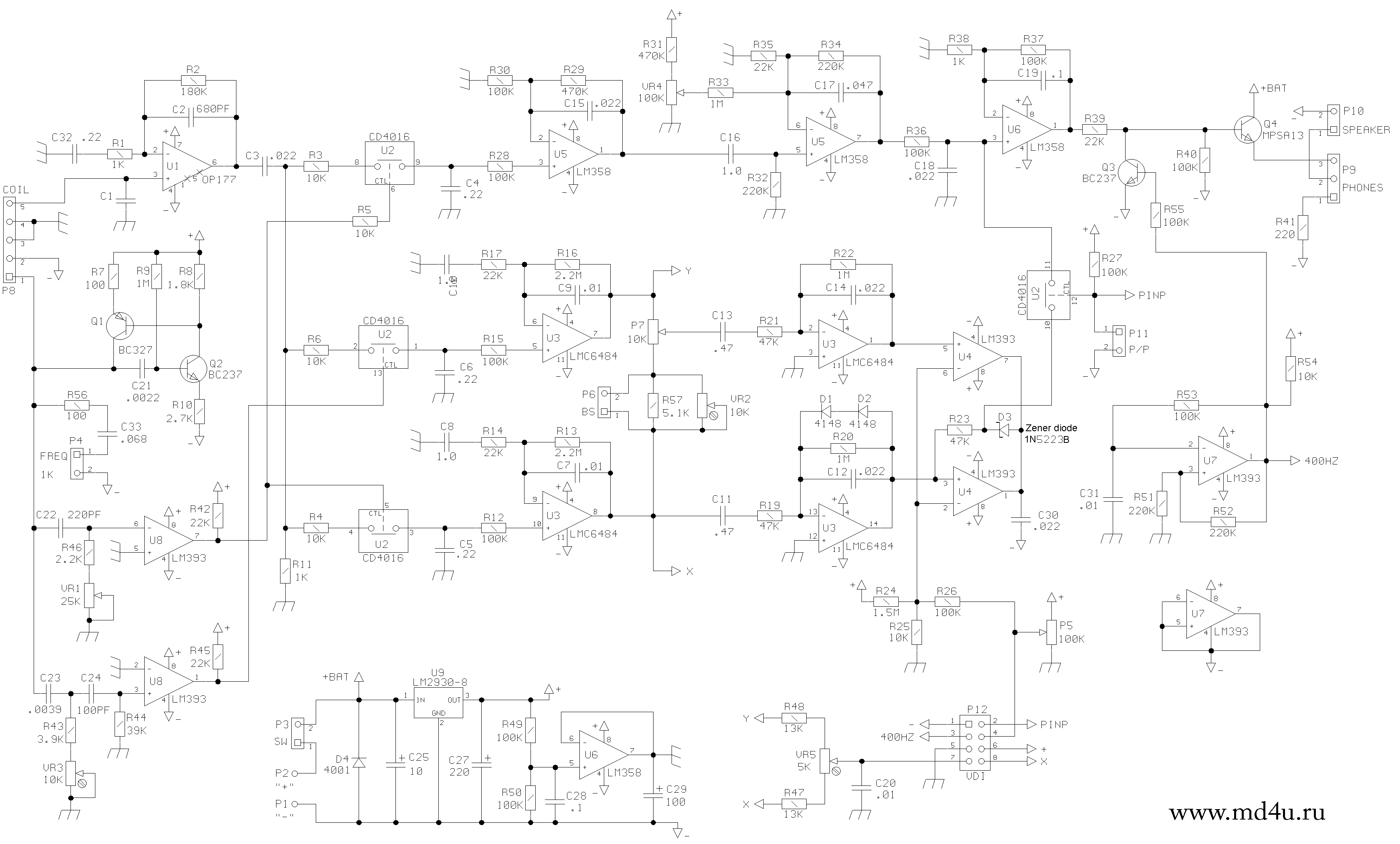

        I just performed all of these mods. I am a retired navy electronics technician.
        When connecting the ground balance pot, I just connected it like the original trimmer. I'm not sure if this is correct and I have been unBle to locate any images or references on how the wires connect to the pot. I did see in Mr bills original post that he only used 2 wires...
        Can anyone shed some light on this for me please?
        Use two wires. look carefully at the Picts on post 17. The VR-1 wiper and resistive element are joined at the board at one end. Then when you run three wires to the new pot this is not an equivalent circuit.

          Thankyou TH'r... I completely missed that... I was even looking right at the traces trying to figure that out.... Thanks again

                • #83
                  schematic
Name:	White's IDX_sch.gif
