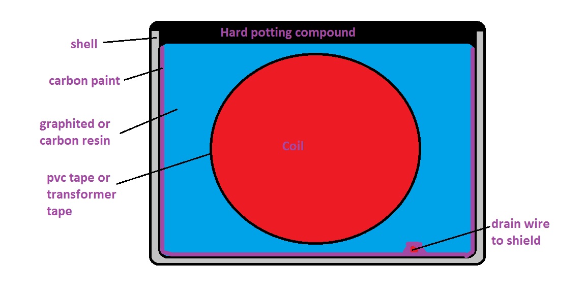

              • both of these constructions work.

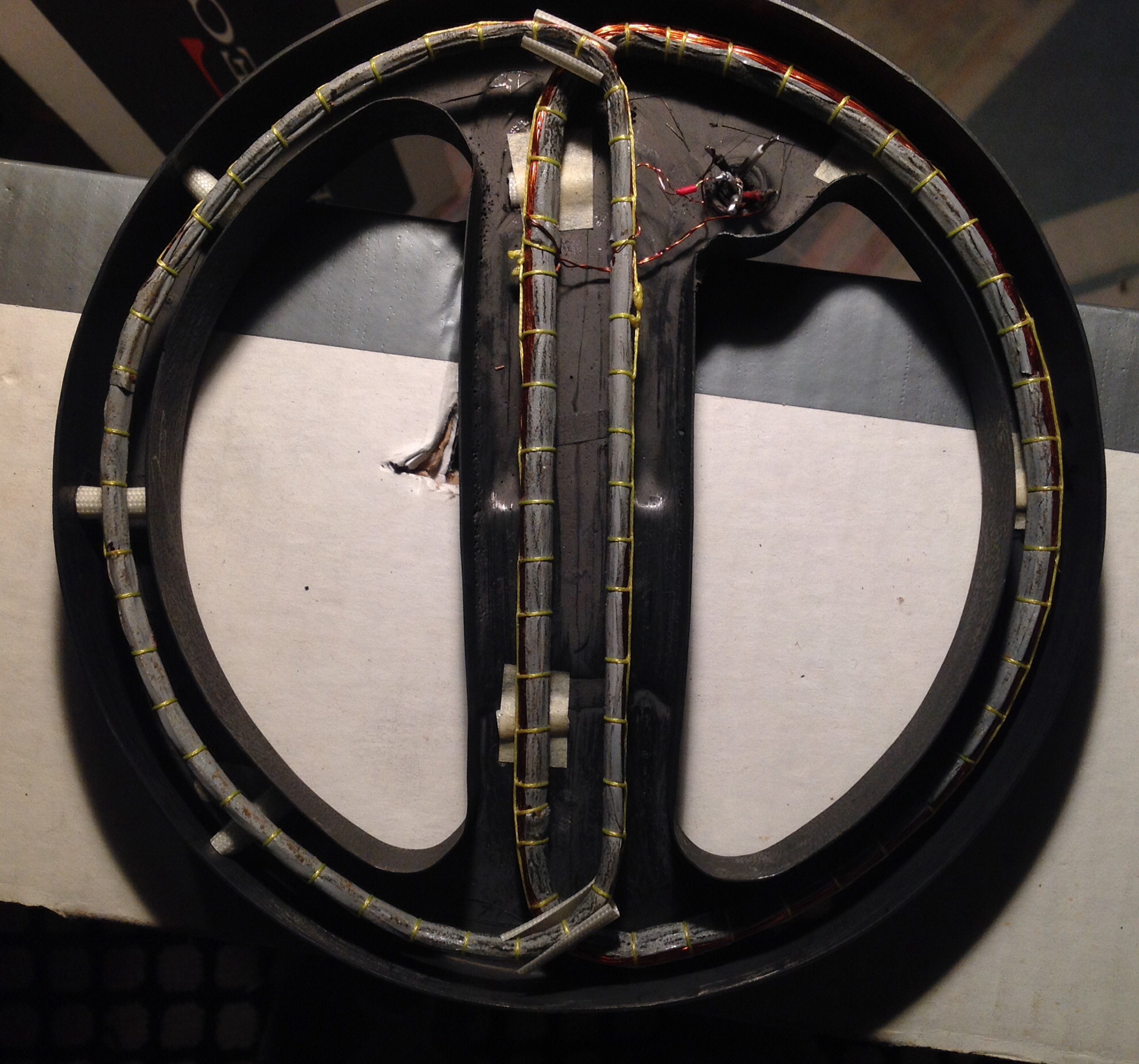

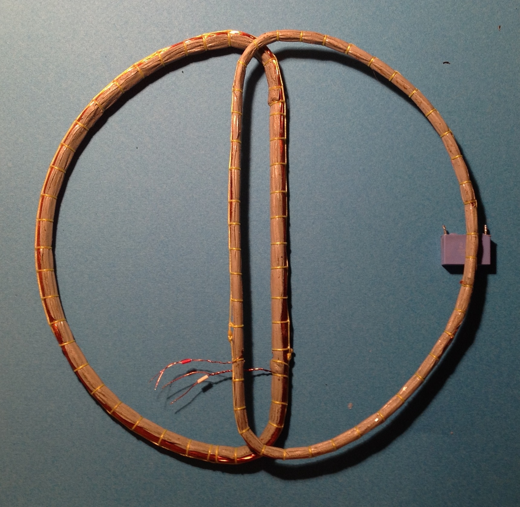

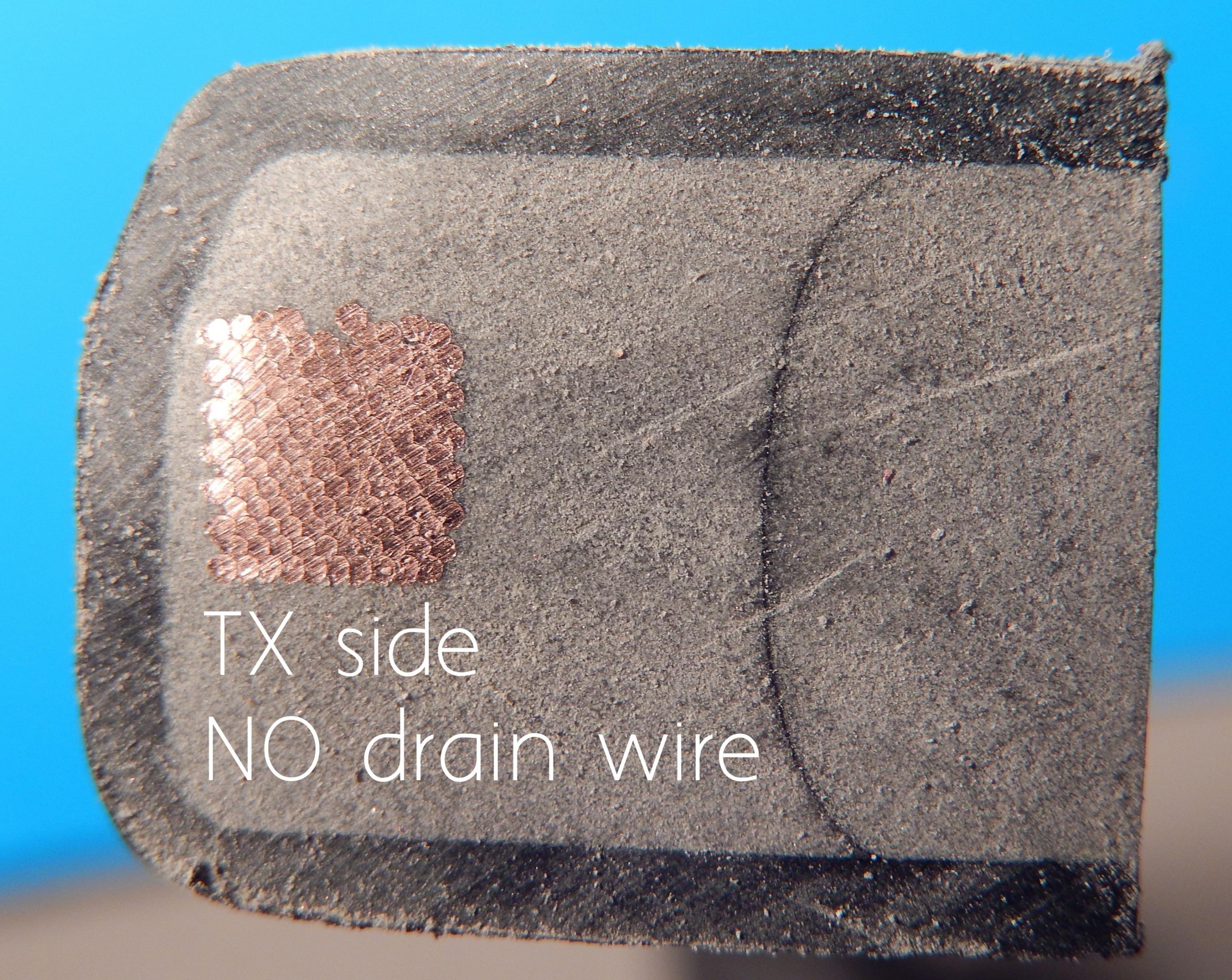

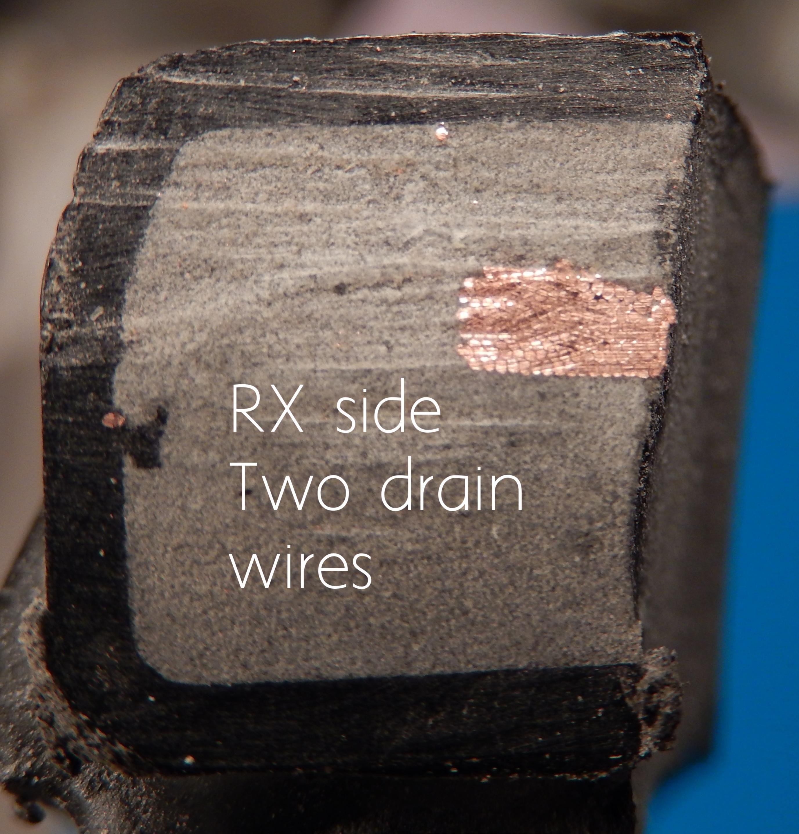

                  • RX and TX ready to coil project no.2.
                    Pictures 1 and 2
                    Henrik

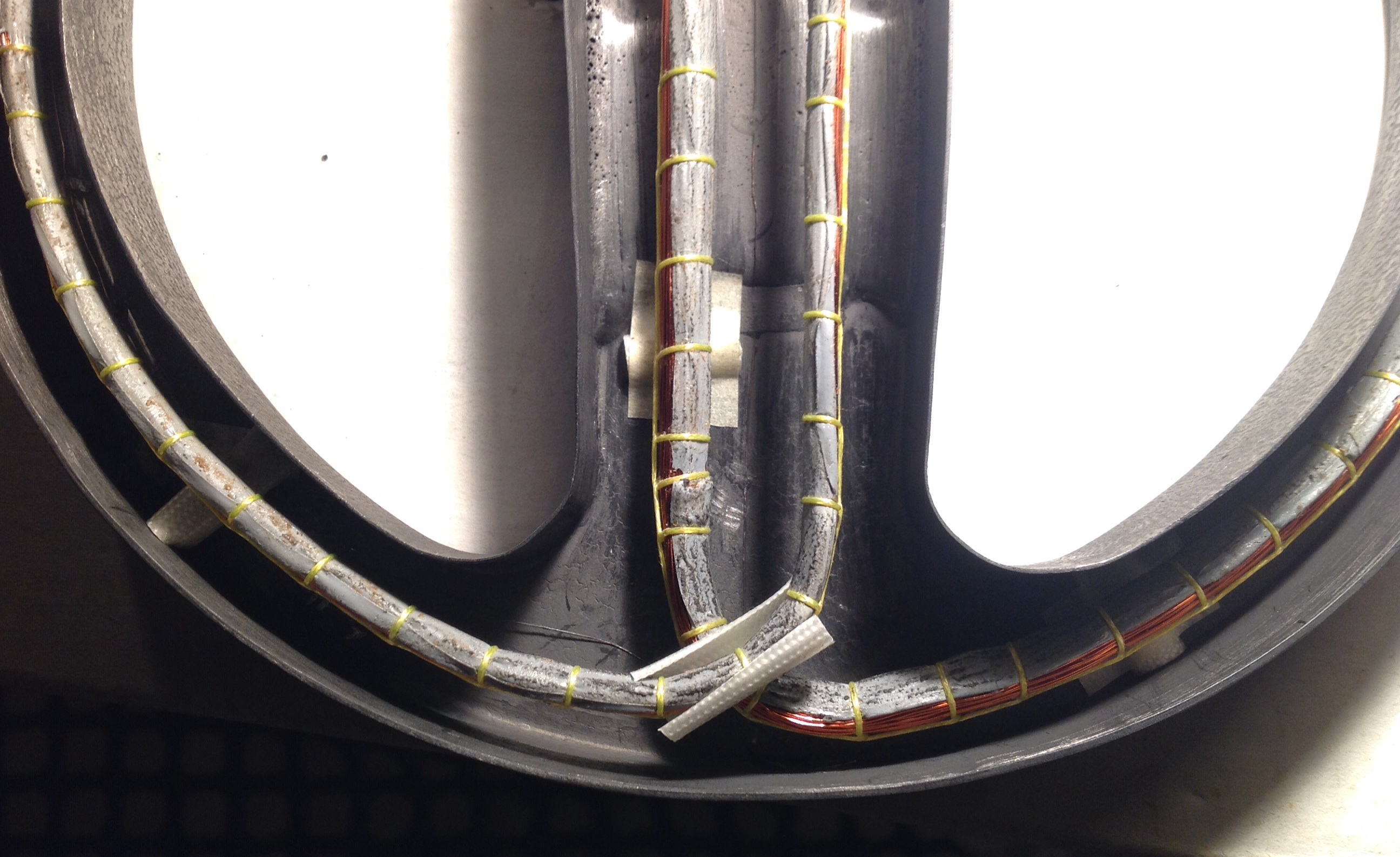

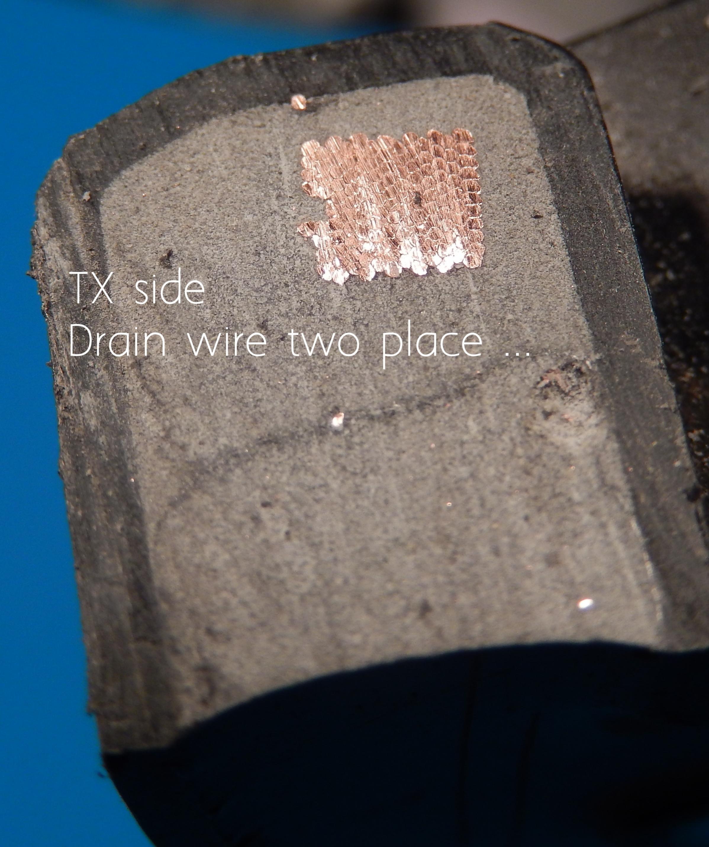

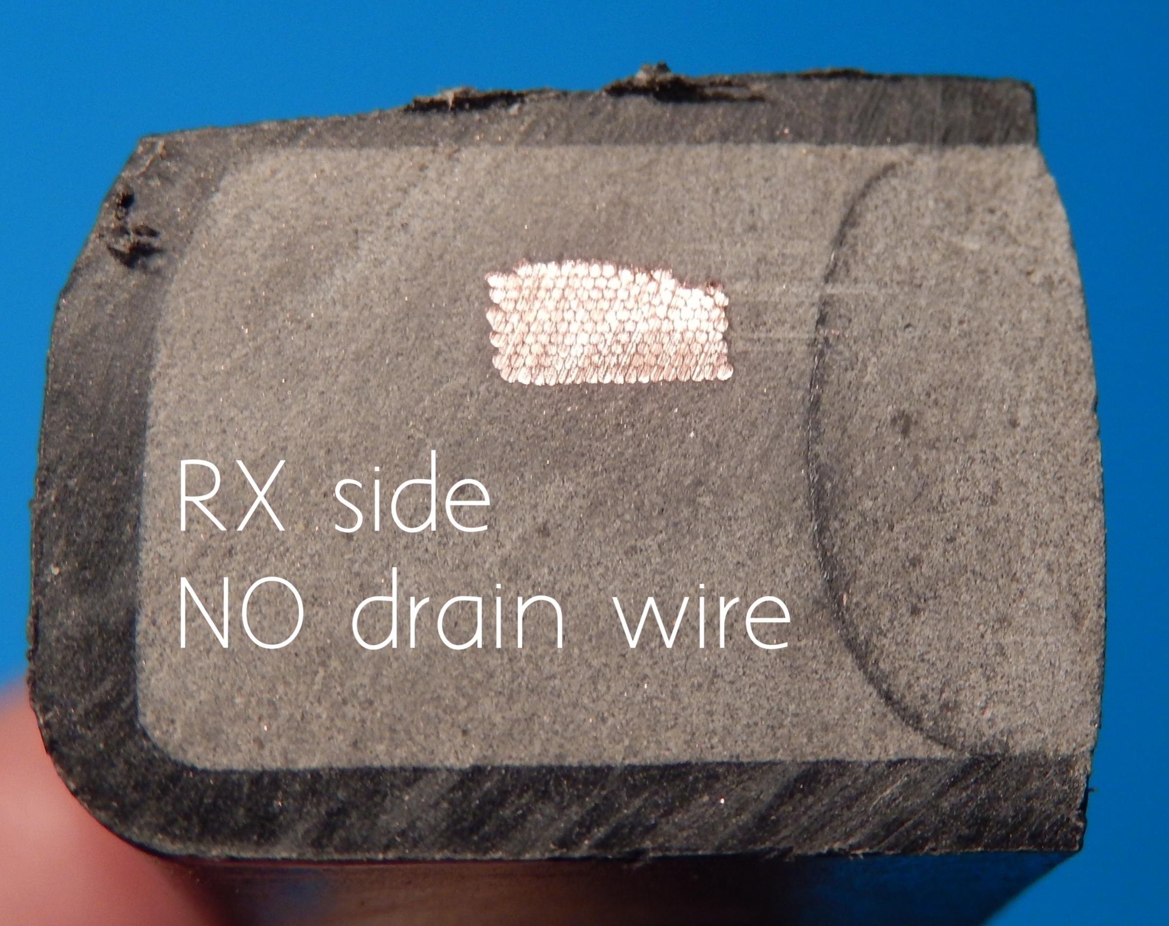

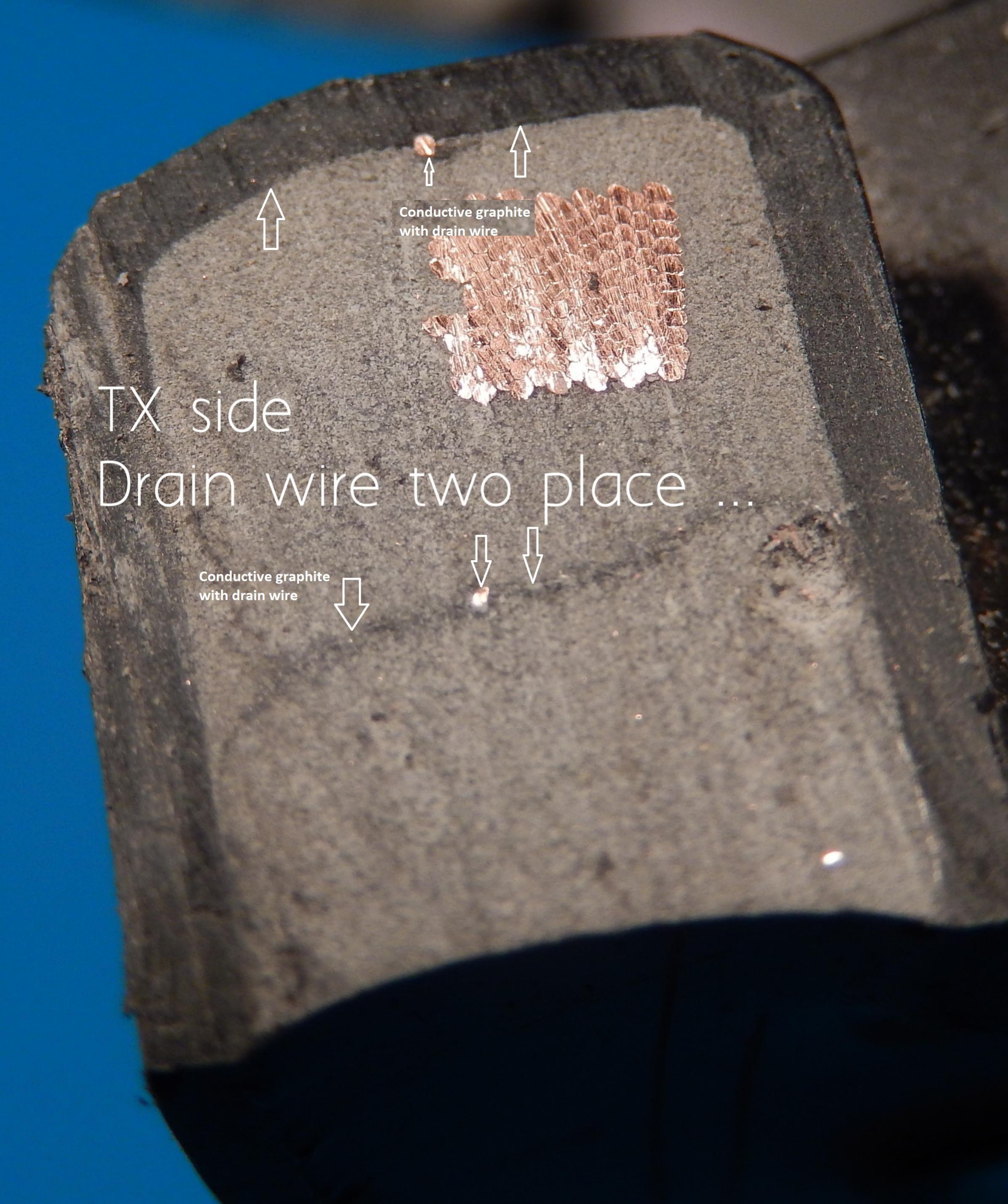

                    • I got to change statement... There was much more drain wires at the Stock coil.
                      They avoid loop with the drain wires.. See pictures - no drain wires at some places.
                      Henrik

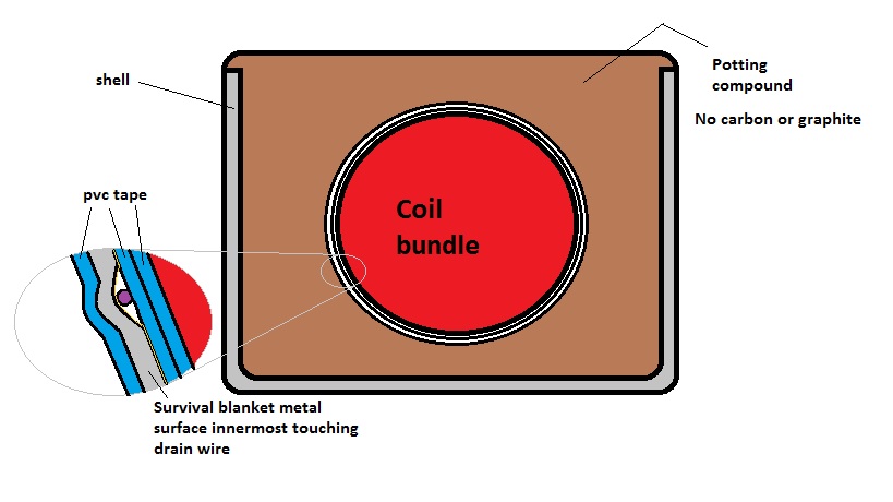

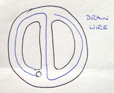

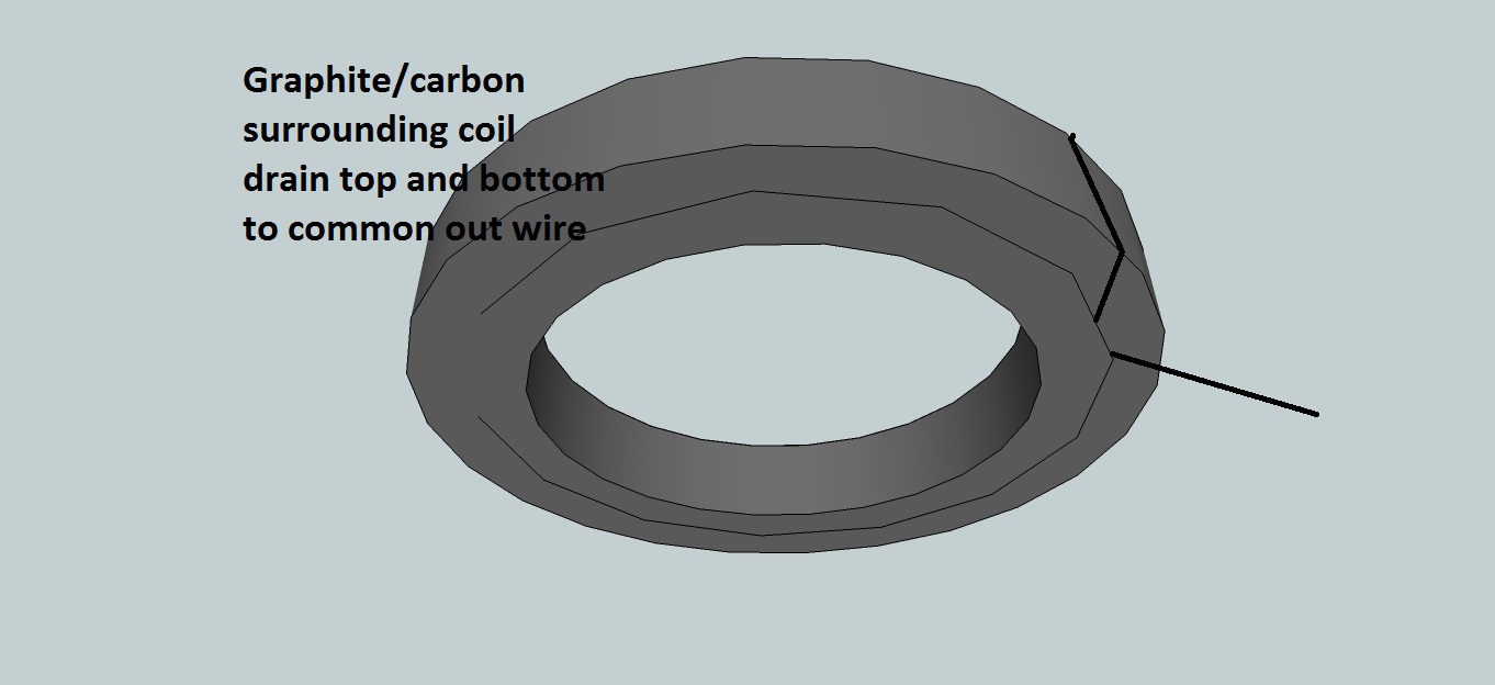

                      • I guess they didn't put drain wires everywhere for cost reasons. This doesn't mean you have to faithfully copy what XP have done. The wires are undetectable to your machine, add them if you want. I have attached one simple way of fitting the drain wire.
                        I have a small test coil, that I used for experimentation, it is about 50mm diameter, 100 turns of 0.2mm diameter ECW. In total, there is about 10 grams of copper there, length about 15 metres. It is completely undetected by my machine.
                        I see you've 'balanced' the coils using a large capacitor. Very novel. HeHe.
                        Good Luck.
                        • Yes Skippy... I Understand more and more about this. But I can allso say, that I made some mistakes earlyer.
ID:	339770There is graphite on the first potting pour, with a drain. Then top up epoxy with no conductivity.

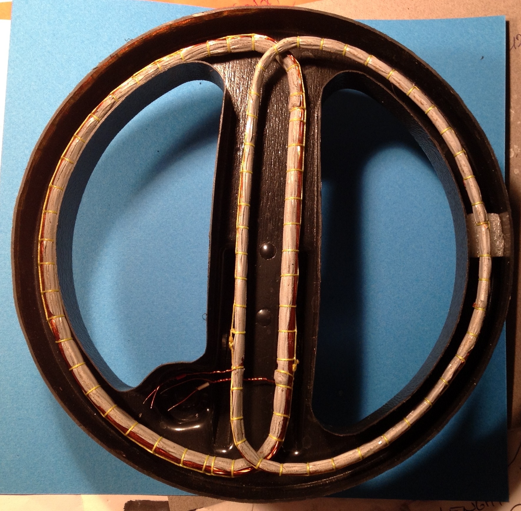

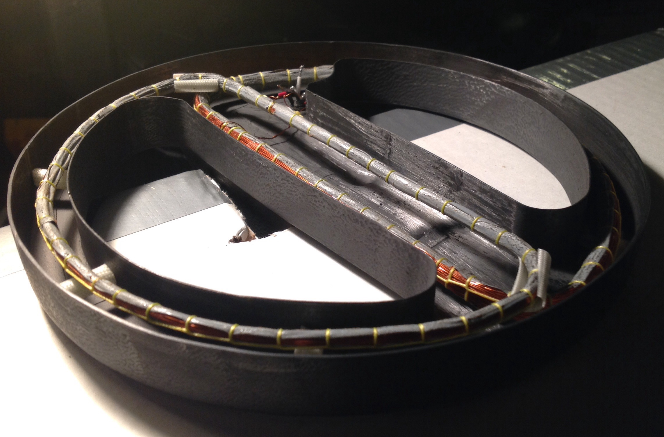

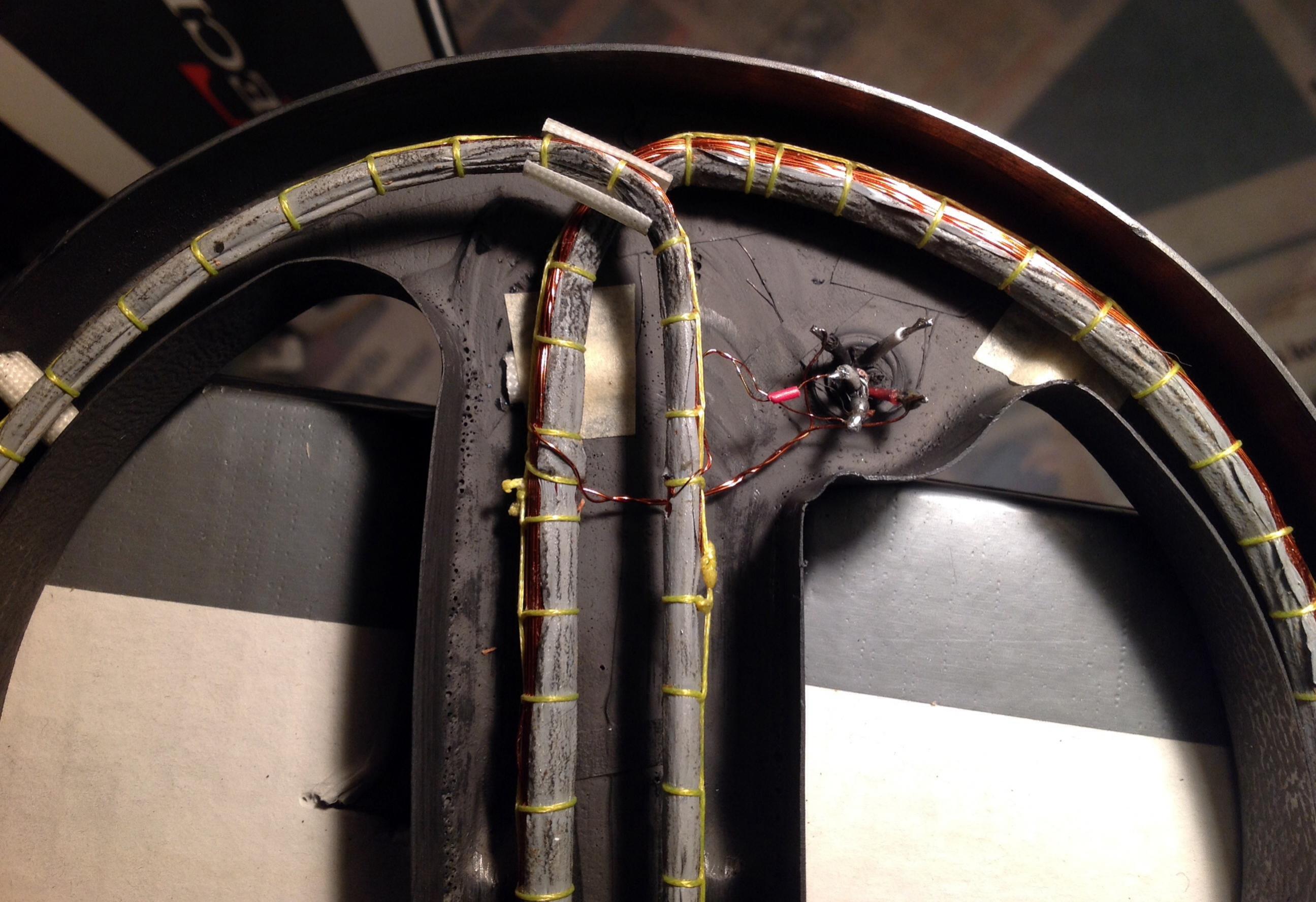

                              • Hello -
                                Close to Be ready with coil no.2.
                                Learned a lot to day.
                                First problem was the same with coil no1, it couldn't work with low ID like Coke and Gold. Reason; the TX must Be spot on with the Inductance and the resonans. I had to take of 2 turns (now 197 - 0.315 wire).
                                The meter was at 19.45mH (goal 10.4) but the resonans was 150-200 hz to low... After taking to turns off (tryed with one first) everything just was more easy and it WORKED.
                                Another important thing I found out... There is a hole lot different in chattering (Remember I'm indoor), depens where the outer wire from the RX and TX is connected... Best proformance is the hot side both RX and TX coming from the outer, this wire where the coils is ends Winding them. That Strange and Maybee only this project there got this.!
                                I'm ready to close it... But please take a look at the Video. Link
                                Ps. I gave up the idea to go out and do some test, before closing up with the Compound mass... Its to difficult to glue and hold the coils.
                                A Big HOPE it will work this time.
                                I did the shielding with paint and sand and paint again... Now its 1-2 Kohm allover. Some place lower that 1 K, but Thats small area close to the drain wire.. I think Thats normal ?
                                pictures of the searchcoil ready to close.
                                Henrik
