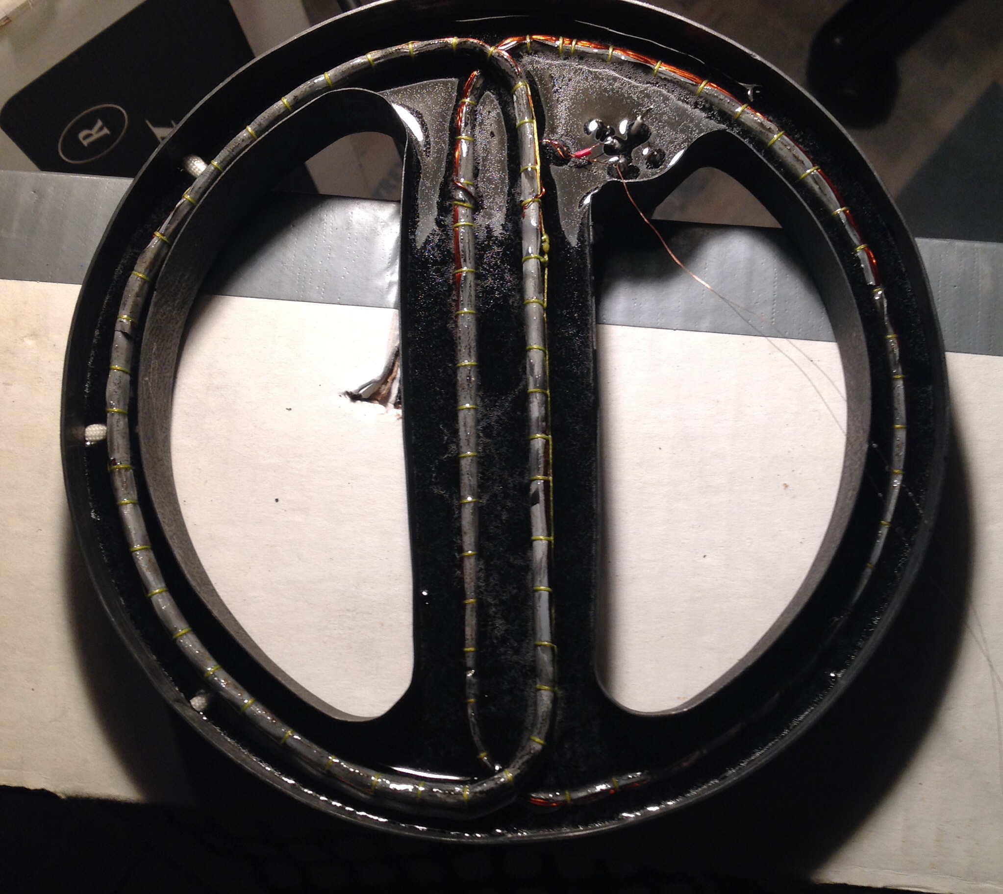

XP deus coil modification
  • Thats a really good effort and result Im impressed.
    You nearly got your objective sorted, Steve
    • Thanks Gulfnut..
      Just filled in 50-60% of the Compound mass. But only just so the coils are covered. I want to test it outside, before its closed and before the bottom shielding is made... It will give me some knowledge about shielding, and properly an idea "did I succesed" (chattering).
      Ps. If somebody else should try this some day ; Dont go after the perfect Null... Ist impossible at all frequency.
      Finding the best Null at 11.4 khz and 17.3 khz at the same time, is Very difficult. Mine is now 12-15 mv at both Freq.
      Henrik.
      • Quote:"First problem... the TX must be spot on with the Inductance and the resonance. I had to take of 2 turns (now 197 - 0.315 wire).
        The meter was at 19.45mH (goal 10.4) but the resonance was 150-200 Hz too low"
        This is why I suggested winding a small number of extra isolated turns, like 199+2+2. Then you don't have to remove / add turns, because they are already there, just wire them up as needed., like 197 = 199-2, or 203 = 199+2+2, etc.
        Quote:"Don't go after the perfect null... It's impossible at all frequencies"
        It's not impossible, but it's a more advanced technique, which maybe you could try later, but for now, a 1 or 2 frequency null is good enough.
        It is looking good so far.
        One idea for next time, if you keep one wire of the TX connection to the co-ax cable looped up in the air, so it is clear of the resin, then you could cut it and add a small nulling loop if needed, for example if the resin affects the null as it cures. I will try and add a pic to explain, later.
        Does your resin have graphite powder in it, or are you waiting for that to arrive.? If you use conductive resin, you have the problem of keeping it away from any of your un-insulated wires, like at the end of the co-ax cable.
        • Thanks Skippy....Yes I learned that Very small changes Winding the coils, matter a hole lot. You nailed it again, but Lucky me I could take off 2 turns and safe my work.
          Good idea to keep up the TX wires.. That would I do the next time.
          The graphite is still the Contact 33 Graphite.. Its a new supply I got to day. The drain wires made like you said ( S sharpe ). This idea from you did it so easy to make the graphite lay and keep 1-2 Kohm... The outside lay got connection from 4 x small holes with drainwires and the outside hold 1.5-2.0 Kohm..
          This graphite powder I ordred isn't arrived. First I must learn how to use it (mix with what?) That will Be another time and another coil project.
          Henrik.
          • I agree, trying to find out how much graphite to add to resin is difficult. I have been looking at this myself, I saw it mentioned that up to 10% by weight was possible (eg. 10 grams graphite, 90 grams resin), but you likely need less than this to get useful shielding, maybe 1 to 5 grams per 100 grams? I understand one problem with mixing graphite into resin is that it doesn't mix evenly, it settles together in corners, settles in the bottom, things like that, so it's resistance will vary a lot.
            • Just what I had in mind... And to make one or two coils, with a good drain wire, ist not so exspensive with the standard graphite paint.
              • You will see the null alter as soon as the resin goes in - I readjust as necassary during the cure.
                Hope the second drain goes well - so you have one above and one below your coil

                              • LATEST NEWs about the Deus 7" coil...
                                Oh my god - why shall it Be SO difficult!
                                Situation - Its working perfect in lab, but outside the soil / ground is Breaking up the signals, just like deep and weak targets at the Stock coil, but with my homemade coil allso bigger object close to the coil, they or not clear.. Like there is interference from the ground, or like the ground is making iron signals mixed with goodies I had dig down.
                                air test outside - perfect. All the disc. \ ID's are same like the Stock coil, allso perfect.
                                This utube is made before the bottom shielding - but it tells Very Well the problem. Listen to the silver coin - like iron arround it.
                                link. http://www.youtube.com/watch?v=YUOK1MVXM6k&sns=em
                                1. I can't get into my mind, that I got a phase problem - Its working in lab. - !
                                2. Its must Be shielding problems and EMI / ground interference problem - !
                                3. Could it Be that the Graphite I use, is the wrong type ?? - Or I did something wrong doing the shielding ?
                                4. Could it Be that my 1.5 Kohm is to high... Even the Stock coil was measured 1.5 Kohm. ? (Graphite type, drain wire - different )
                                5. Could it that I made a mistake, when I found out the Shielding drain wire was connected to the RX cold side at the Stock coil,
                                and some how XP did it different, just dont know how.
                                Hope you got some VERY good ideas... I'm in trouble.
