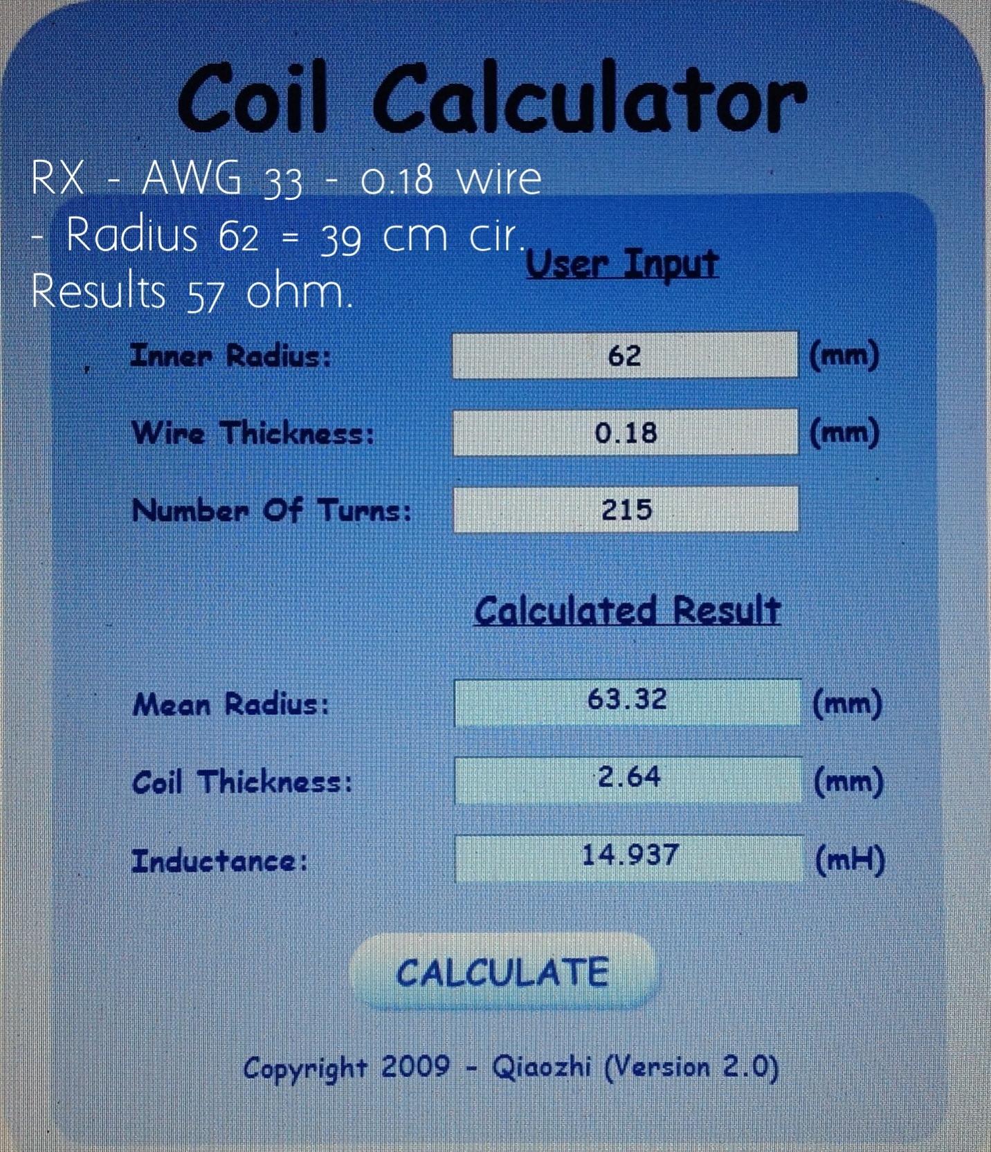

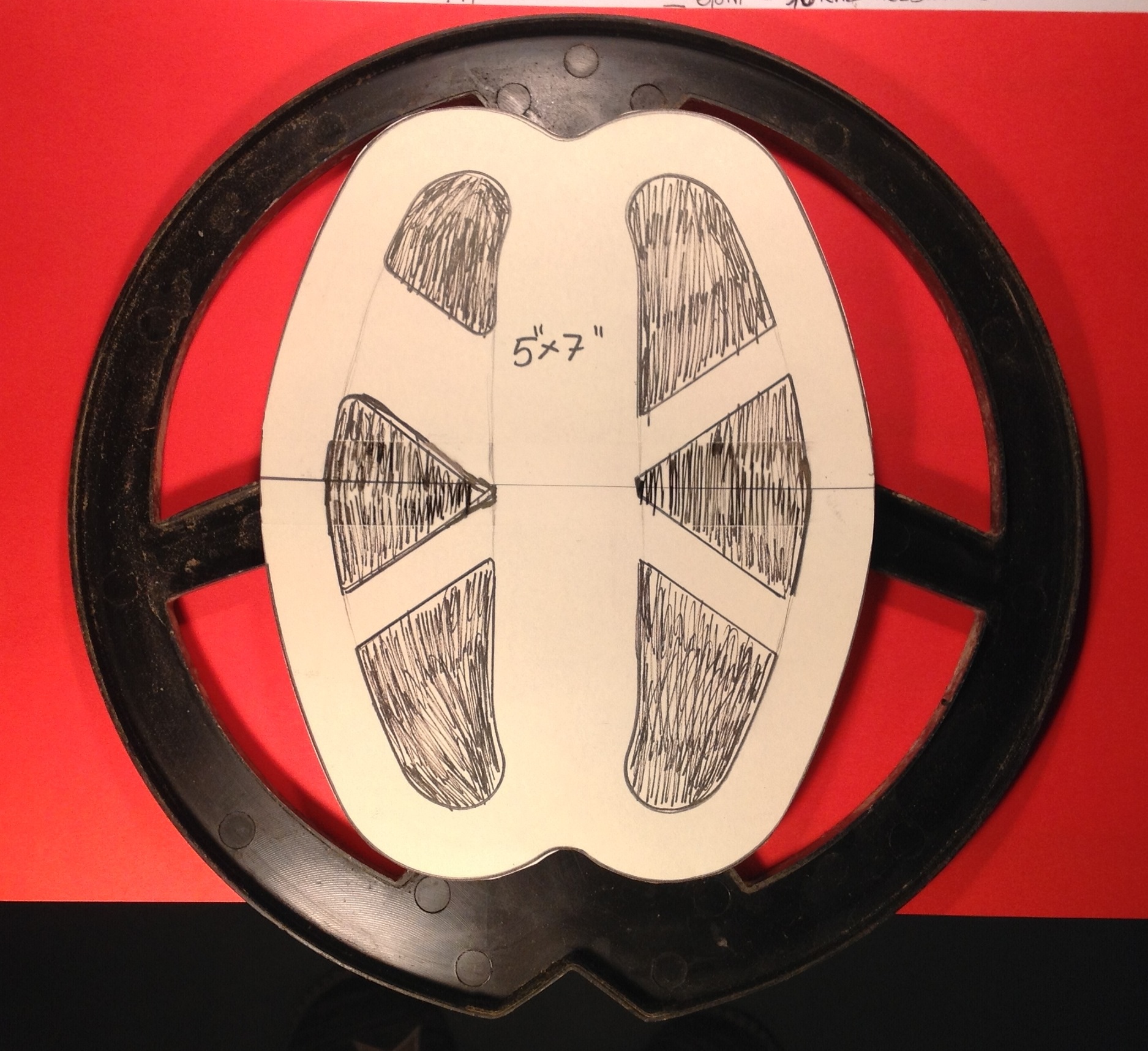

                The first try would Be a 5x7" coil. (See picture). Is a coil cover 5x8" shortened 1" in the middle.
                One turn is 39 cm = Radius 62 mm.

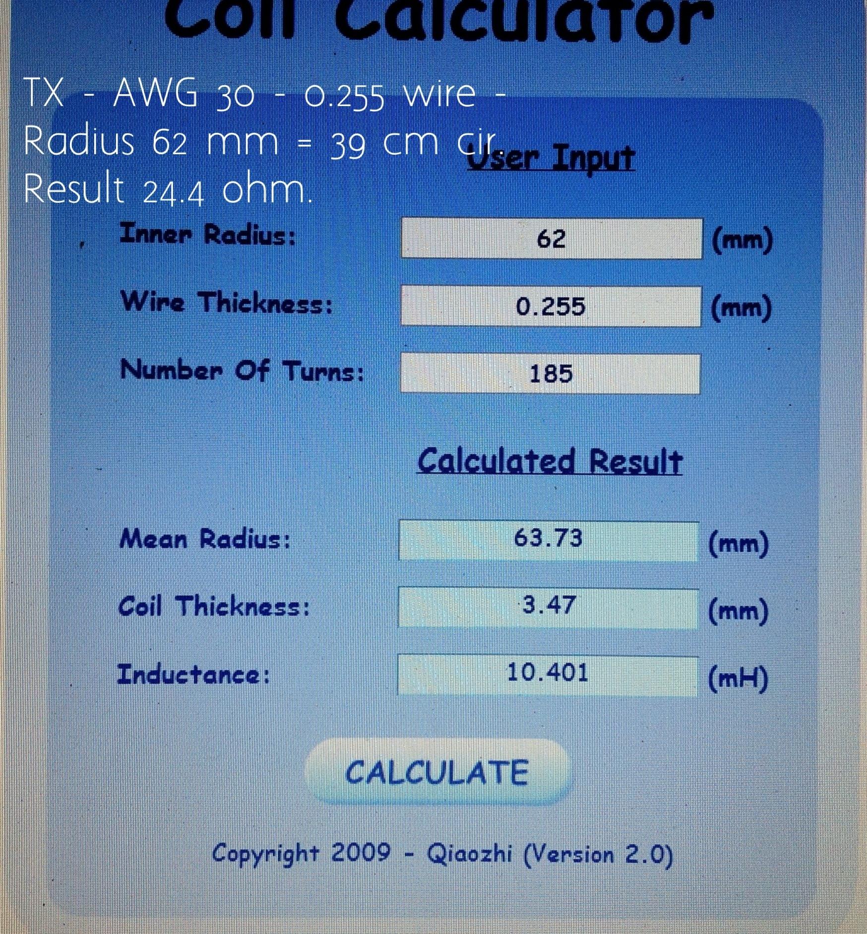

                I've ordered AWG 33 (0.1 and from a earlyer project I got some AWG 30 (0.25). See pictures with the result by Qiaozhi's Calculator.
                Couldn't find AWG 29 (0.2 at my supplyer Brocott in UK. Tryed others and Ebay, but it wasn't easy.
                The AWG 30 will properly end up with 24 ohm (21 ohm stock coil) at the TX side, a little to high.... Hope it wouldn't damage to much.

                  Well, you gotta start somewhere, I guess, and you've bought the wire so there's no point me telling you to change things now. You forgot the +4% factor, so add 2% more turns to your windings than your calculator shows. And the 62mm is actually the mean radius, so you should be entering 60 or 60.5mm as the inner radius, probably.
                  Have you heard of www.wires.co.uk ? They have large stocks, but I don't know about International shipping, costs etc.
                  Surely cutting the coil cover in half is going to ruin its rigidity? I've no idea about the plastic tubes....

                    The selling point with the ellipse coils is ground coverage. They are often fairly big. Longer ones are not that deep, thats not their job.
                    You want a small, local iron exclusion footprint on your iron rich worked sites... but you still would appreciate some depth - A round one fits the bill Id say.
                    Depth would suffer with a small ellipse - with a commercial ellipse, the depth is limited to the smaller dimension So say an 7"x4" would do about 4" max on smaller coins. Not great depth and would still pull in signals from local iron as long pick up footprint.
                    With a 6" round DD you will get 6" depth- still with good exclusion of nearby iron as footprint 6"

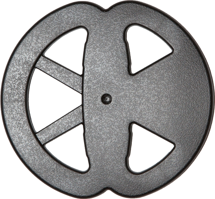

                        Easier to get a shell ??? Can you help with a link or where to buy 6" Shell.
                        • #72
                          Sorry its not easy is it for a 6" Hayes elec stopped trading , the bulgaria guys are not 6", and Georgi on here, his are bigger
                          The only thing I suggest is modifying a ML 3030 coil cover.
                          http://www.joanallen.co.uk/minelab-6...er-p/20219.htm
Name:	3030 6inch cover.jpg
                          or a plain round 5"
                          http://www.metaldetectorshop.co.uk/s...oduct_id=62354
                          or buy a broken one and hack it out for your coils
                          other option is get a coil which has no caps in like tesoro and find one with similar L values. S

                                I've ordered the CTX cover 6".

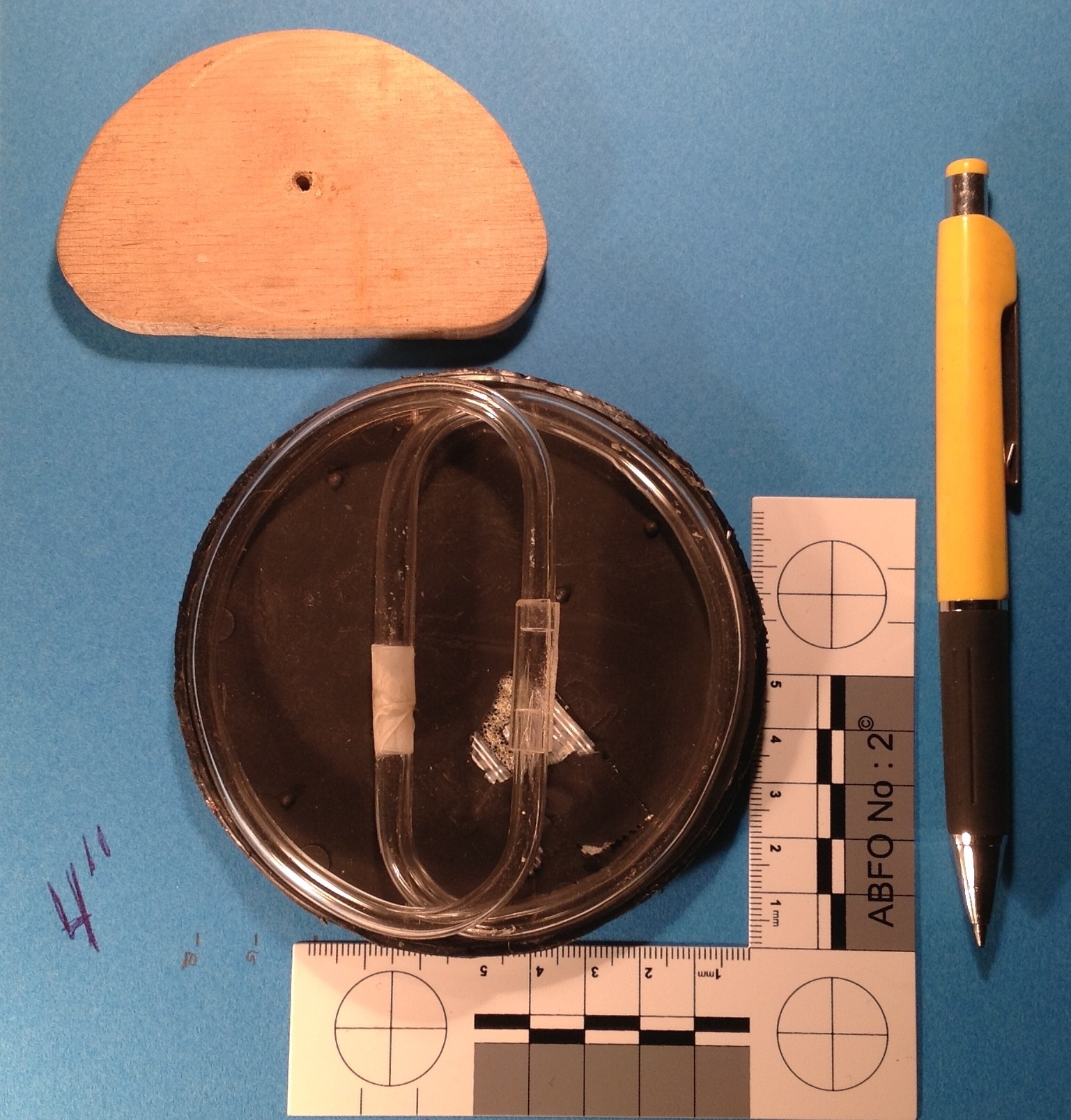

                                While waiting I had look at a 4".... (Look at the pictures).
                                It is so small !!!
                                I dont know what you think, but Maybee is it worth a try.
                                This Plastic tubes is okay to work with... I think I would get a stable coil, If all the Winding goes nicely inside.

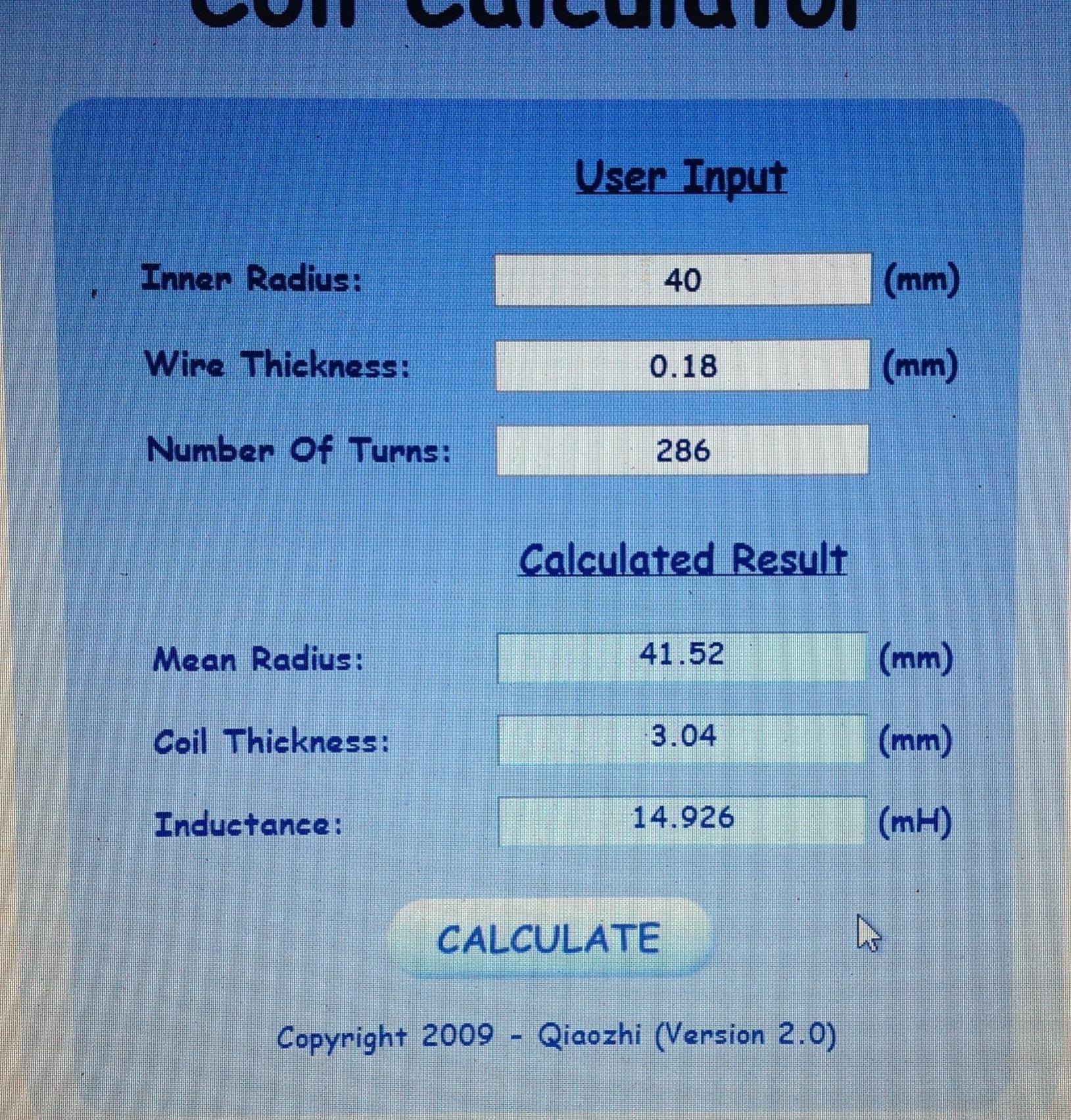

                                One turn inside the tube was 25.4 cm / thats a inner Radius at 40 mm.
                                And I have to add 8 windings to get +4%... (Total 296 - properly up to 300 would Be a good idea first try).
                                One tube / coil form is 3.5 mm inside the other 5.0 mm (TX needs 0.25 wire).
                                I will use the Wood a the picture to hold the tube, while Winding the coils.
