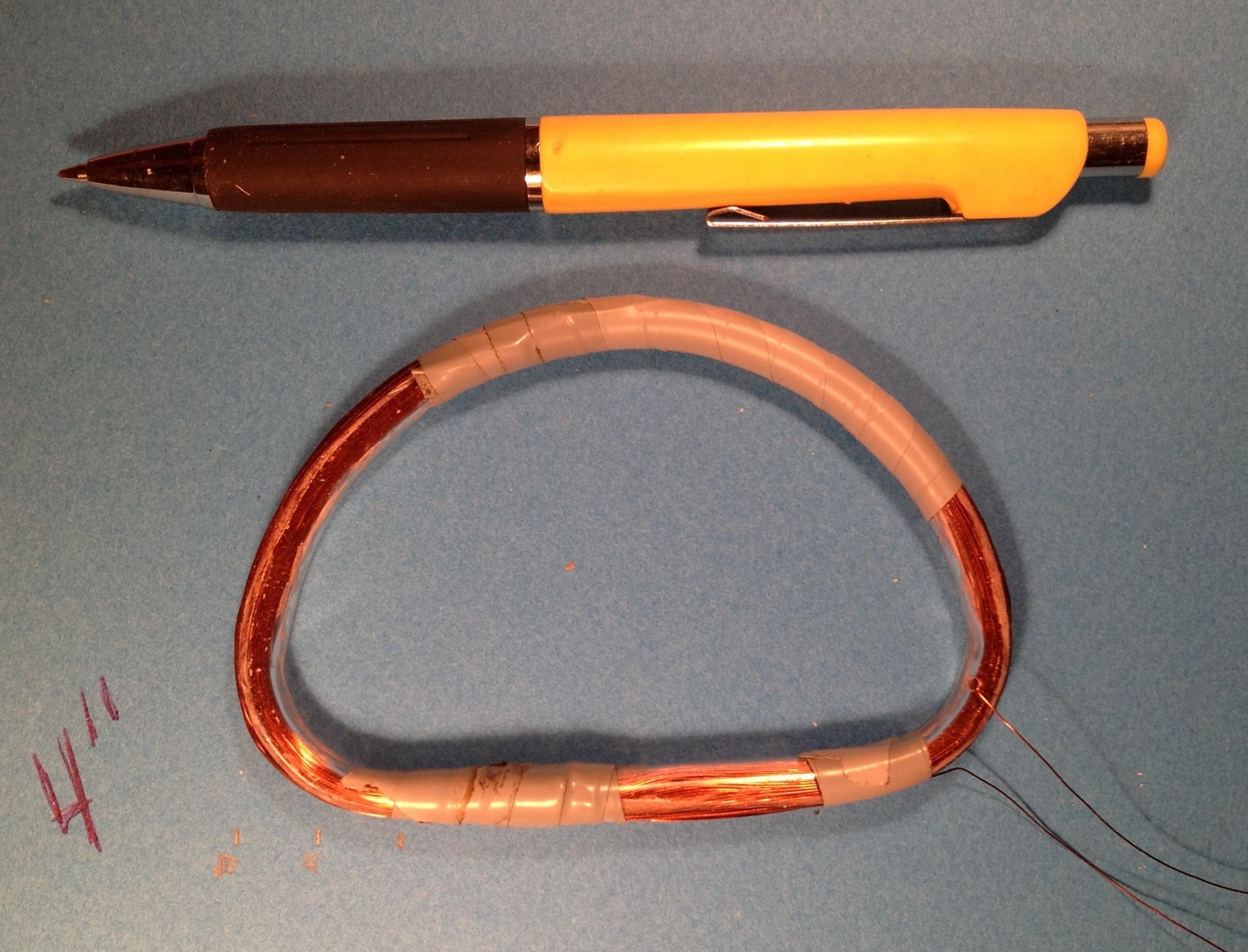

    Do you put the turns thru with straight pipe and then bend up?
    • #77
      If you make that 4 inch coil, with the coil shape shown you should only expect a 2% inductance drop (from circular), so only aim for +2% extra L when using the coil calculator.

              So much for the theoretical calculations and ideas. Did a test with 0.25 wire.
              To get 10.4 mH it should had been 246 turns + 2-4% - I only got space in the plastic tube to 255 turns and ended with 9.8 mH and 25.2 ohm. One size bigger Plastic tube and 0.28 wire will Be needed. Back to the order office.
              It must Be this small coil size, there is causing that I must add 5-6%.
              No Big deal I'm in no hurry with this project.
              Henrik

                It could be the fine detail that's causing the error, things like the radius actually is 49mm, not the 50mm (or whatever) you did calculations for. Binding up the bundle tightly increases coupling between each strand, increasing L by 1 or 2%. Also, is your L meter actually a good accurate one? Have you checked it on known inductors, etc, or compared it to a quality lab one? That might account for theory and practice not agreeing. I found Brooks formula worked pretty well, though it is actually for a rectangular/square section coil, with the wires in neat rows, not for a round bundle, with the wires taking on a 'hexagonal close packed' arrangement.
                Edit: I've just laboriously resized your pics of the 4 inch coil, blu-tacked wire to my monitor screen, and worked out a mean circumference of 252mm. This gives a mean radius of 40mm for the circular coil. putting into the Qoil Qalculator: inner radius=38mm, (mean =40, outside=42) with 0.25mm wire, 258 Turns gives 10.65mH (=10.4mH + 2%). Whaddya think?
                Just an idea - could you cut slots part-way into the outer edge of your plexiglass tubes at 8 points, then bind up the wire bundle with cotton thread through these slots (if that makes sense)

                  You nailed Skippy... Small error by me causing it.
                  1. It was Very hard to take off the coil of the Wooden form..( Lower diameter.)
                  2. the windings got a little lose and had to use tape to hold them, after it got off.
                  3. The plastic tube must Be made 1-2 mm larger next time, because all the wires do pres the plastic, and it ends up with smaller diameter.
                  But good to learn all this.
                  Do you agree that I should try to hold the TX down close to the 21 ohm or even less If its posible ! 19-22 ohm will Be my target.. I dont like it going up like this test today (25.2 ohm) and it had properly ended with 27-28 ohm, with some more windings to reach 10.4 mH.
                  I know what to do... A. Order some 0.28 mm wire or B. make a new plastic tube form a little larger and with sharper corners to get a little more circumference. It depent what you will say ! Is it worth a try with a TX ending up at 24-25 ohm ? (Properly limit with 0.25)

                    I don't know. That's one reason i suggested making the RX first, it's not so critical on the R measurement. Then you can make the more-critical TX better, by learning from the RX experiment. Here's an experiment - accurately measure the winding resistance. Calculate what lenght of wire this is equivalent to, then divide that by the number of turns, gives you the mean circumference. See how that differs from 252mm.

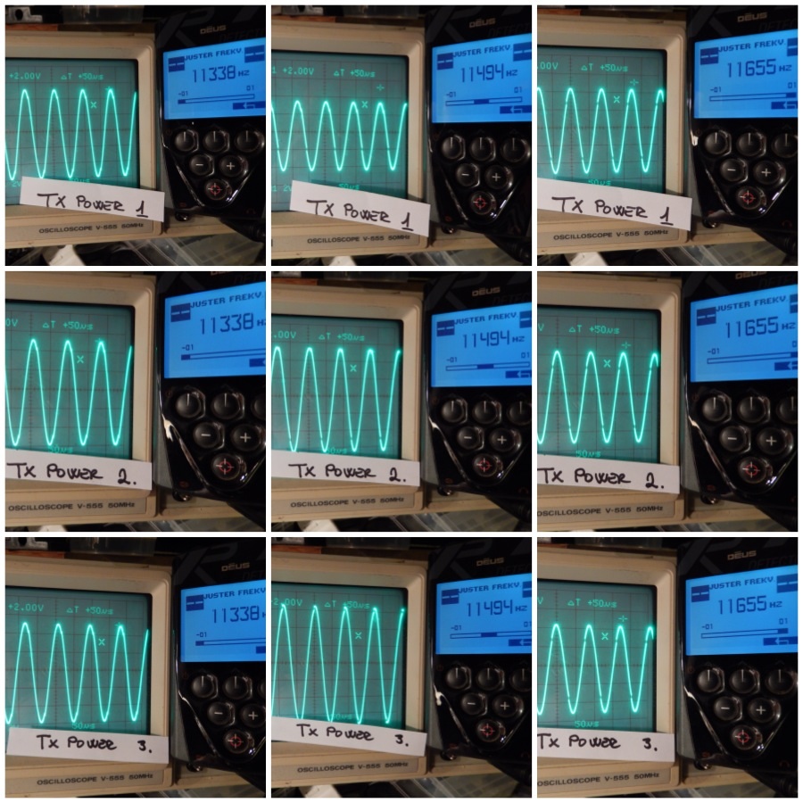

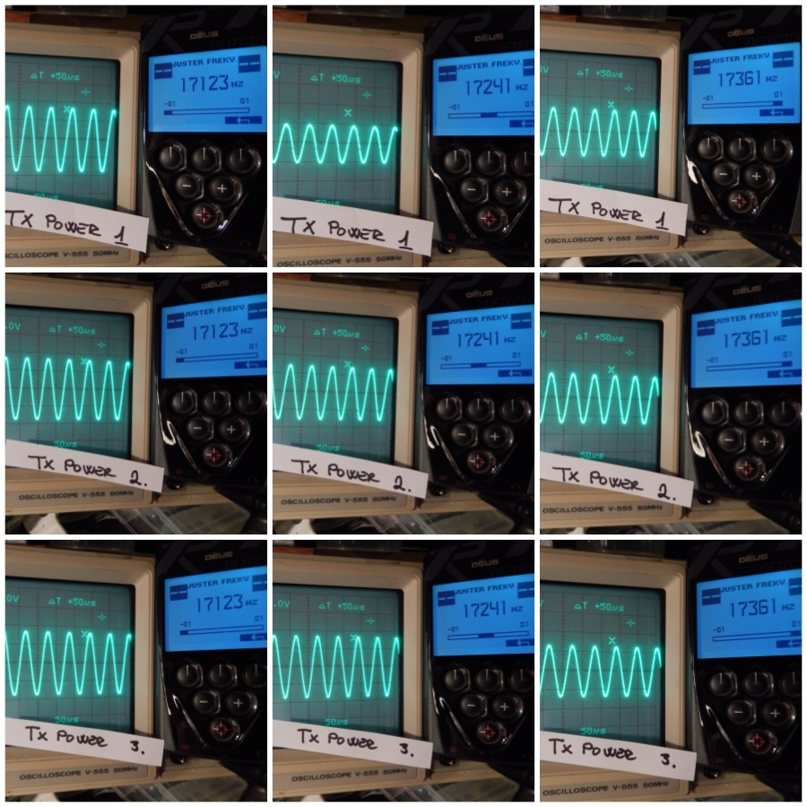

                        Hi all.
                        Some scope with TX 1-2-3 at the 11 khz and the 17 khz area. (See pictures).
                        One Very good thing to know; The TX adjustment will only work in middle Freq. (11.494 - 17.241).. and the Deus will only use TX2 if someone try to change Freq. at the Expert menu. (See the 11 khz scope pictures right and left, the same amplitude at the lower and the highest Freq.. But at the middle Freq. the TX is working. (This coil properly got its peak at 11.494 khz.)
                        But at 17 khz is different ; The 17.123 / 17.241 is closely the same high peak like TX3. And the high Freq. 17.361 got similar like TX 1.8 or something like that.
                        I hope this could Be usefull to other Deus owners. (TX power is not linear - Freq. got a issue)
                        Henrik.

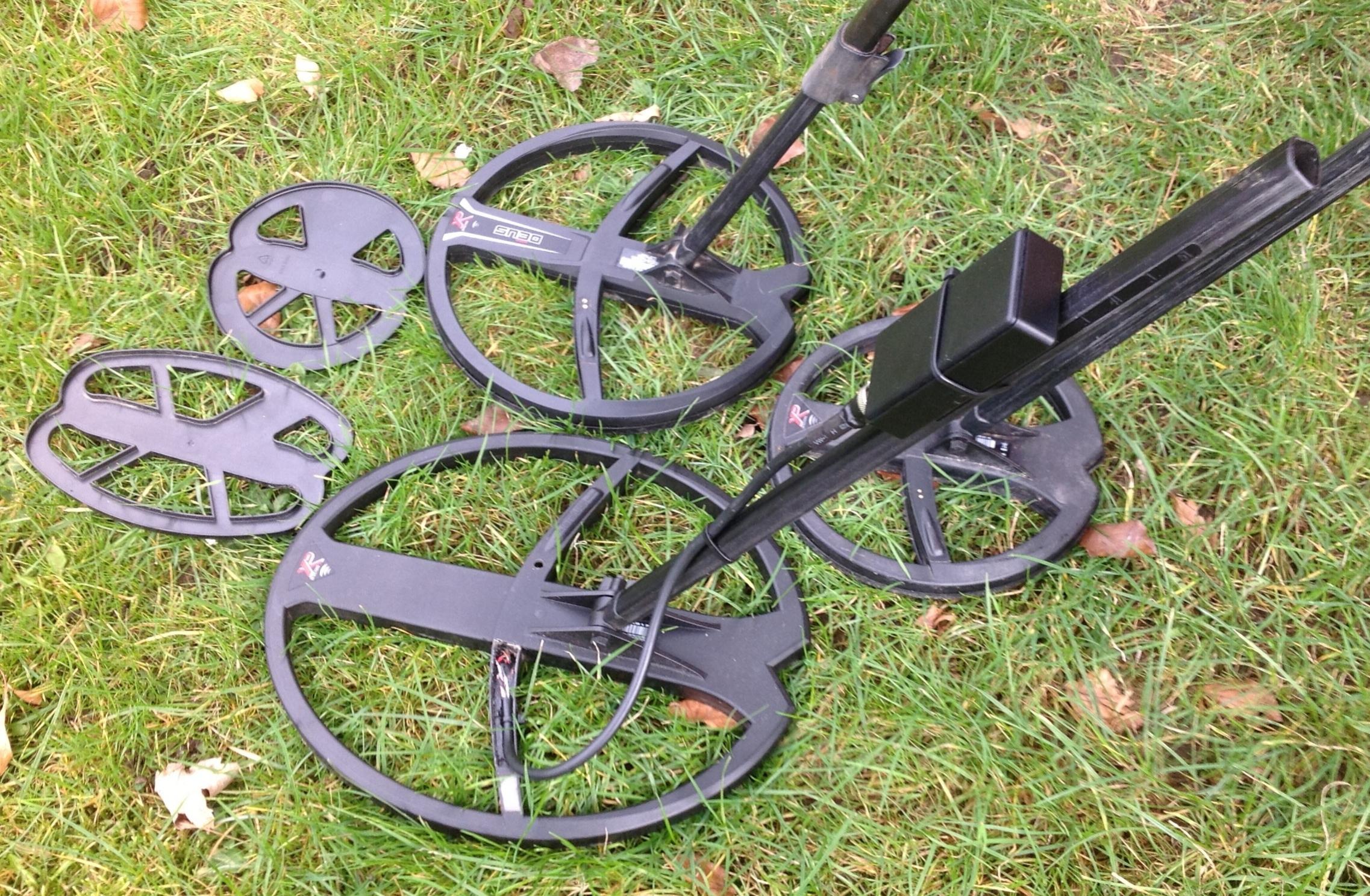

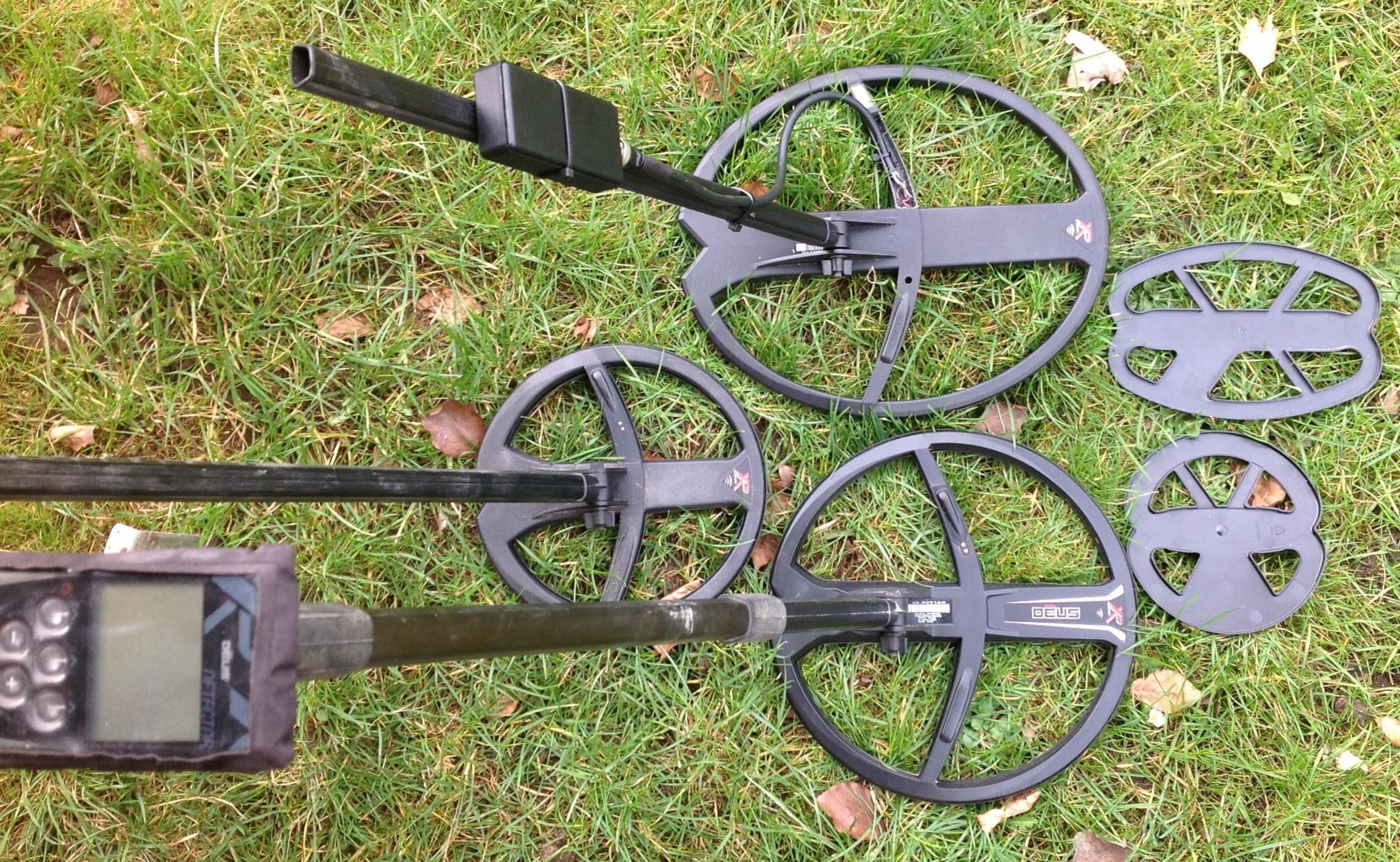

                            Hi Once more.
                            Step 6. Been out testing the Stock 11x13" coil with electronic at the stem.. First try GB gave some problems, then back to the lab and shortne the cable. That help a lot. Somebody recommend short cable and that was true.
                            The coil is working really good. Made some compair with my other coils and Very small lose If any.
                            picture shows where I had place the electronic and the coil sizes to give a look how small 6" and 5x8" is.
                            Henrik
