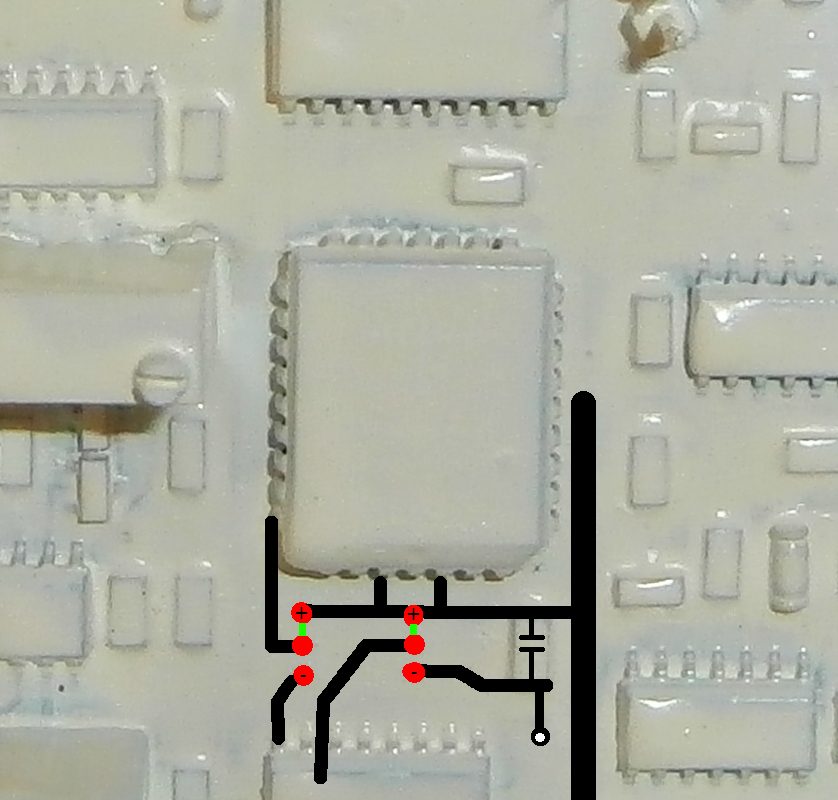

              I've now received the F1 and carefully removed the paint to expose some of the tracks and lands next to the EEPROM. I've also tested around the place with a meter to check continuities.
              Looking at a photo from geotech of the eeprom, there's 6 little lands. I have a feeling on some revisions there may be a couple of 0R resistors there covering two traces, which could be what are being referred to in the post you reference above. I'm working on a REV3.2 board.
              Firstly a little disclaimer - I'm sharing this information as there seems to be a lack of it available. It seems in the past there was a bunch of secrecy surrounding these mods but I've emailed detectormods asking for info and he's said he avoids working on them now, and I can't find anyone else still active on forums that's actively modding these to ask, so I'm assuming no one's really trying to rake a profit off these mods anymore. Nonetheless, if anyone loses their shirt over this info being public, just let me know and I'll be happy to remove it. I'm not out to rustle any feathers.
              Anyway here's my findings:
              - The top two are connected to VCC.
              - The left middle goes up to the EEPROM. The right middle goes down under the IC below the EEPROM.
              - Both the left and right middle are connected to VCC via traces to the lands above them.
              - The bottom two are connected to GND.
              Here's a super professional drawing based on the one I found here at geotech:
              This is leading me to believe that I'll need to:
              1. Cut the traces which are connecting the middle two to their respective top lands (shown in green)
              2. Switch the middle two between their corresponding top/bottom (top == high & bottom == low)
              If I'm correct, this will give 4 possible combinations of timings ....A level 3 modded F1A4 pictured at https://www.prospectingaustralia.com...c.php?id=18986 shows 4 levels of timing (big/gen/std/fine), but I'm unsure of what the other knob does. Most other modded machines show 3 levels of timings so maybe I've got something wrong here... At some point I'll see what my scope tells me but I might have to wait for my logic analyser to arrive before being able to see the big picture.
              I'm probably going to wait a little while before testing this theory...Planning to take the machine out this weekend and would really like to get at least one use out of it before potentially releasing the magic smoke.
                After doing more research it appears the gain, threshold and tone mods are going to be pretty simple. I'm referencing the SD2000 circuit as a very rough guide as some of the sections appear quite similar, comparing pin connections with datasheets of components.

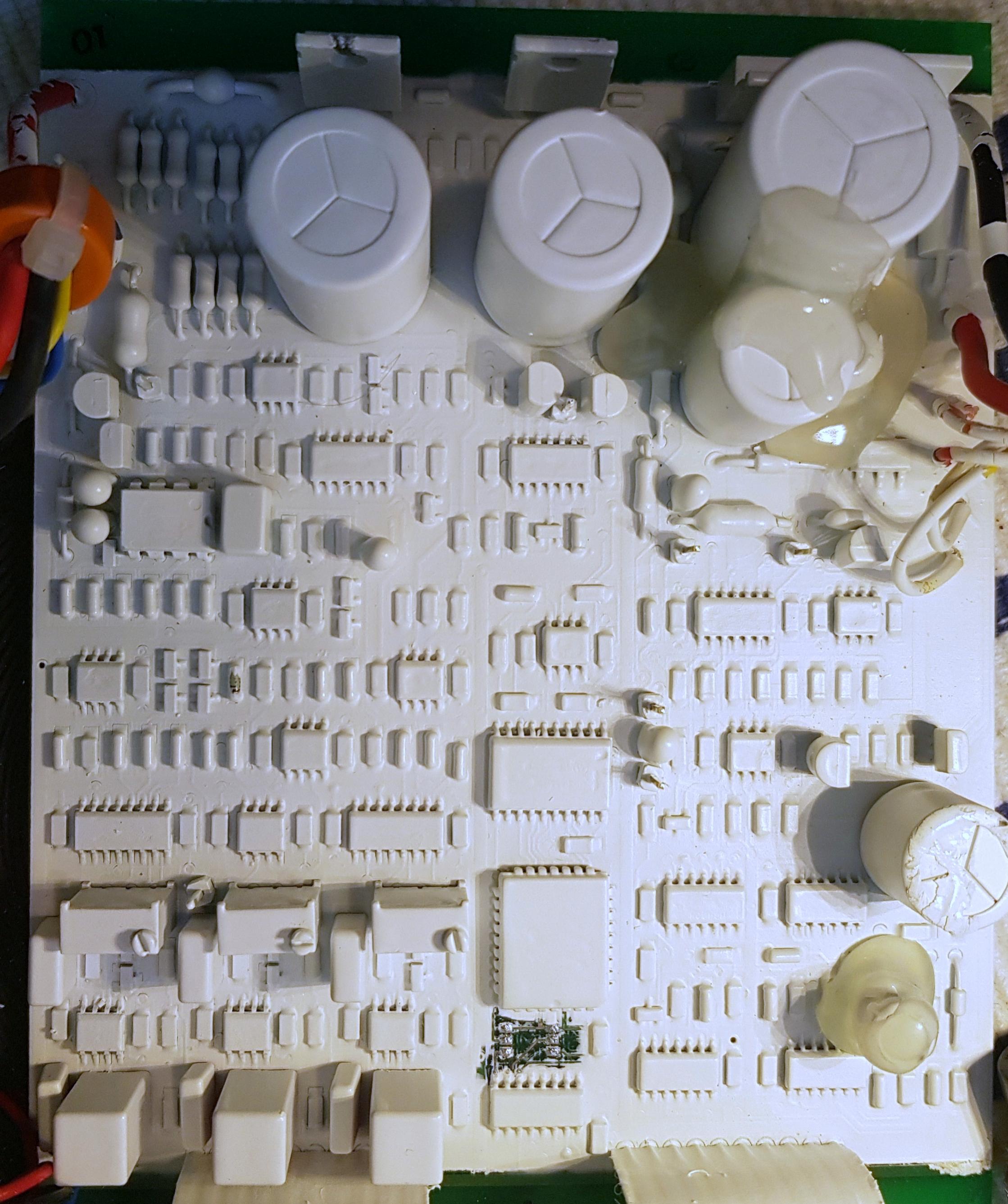

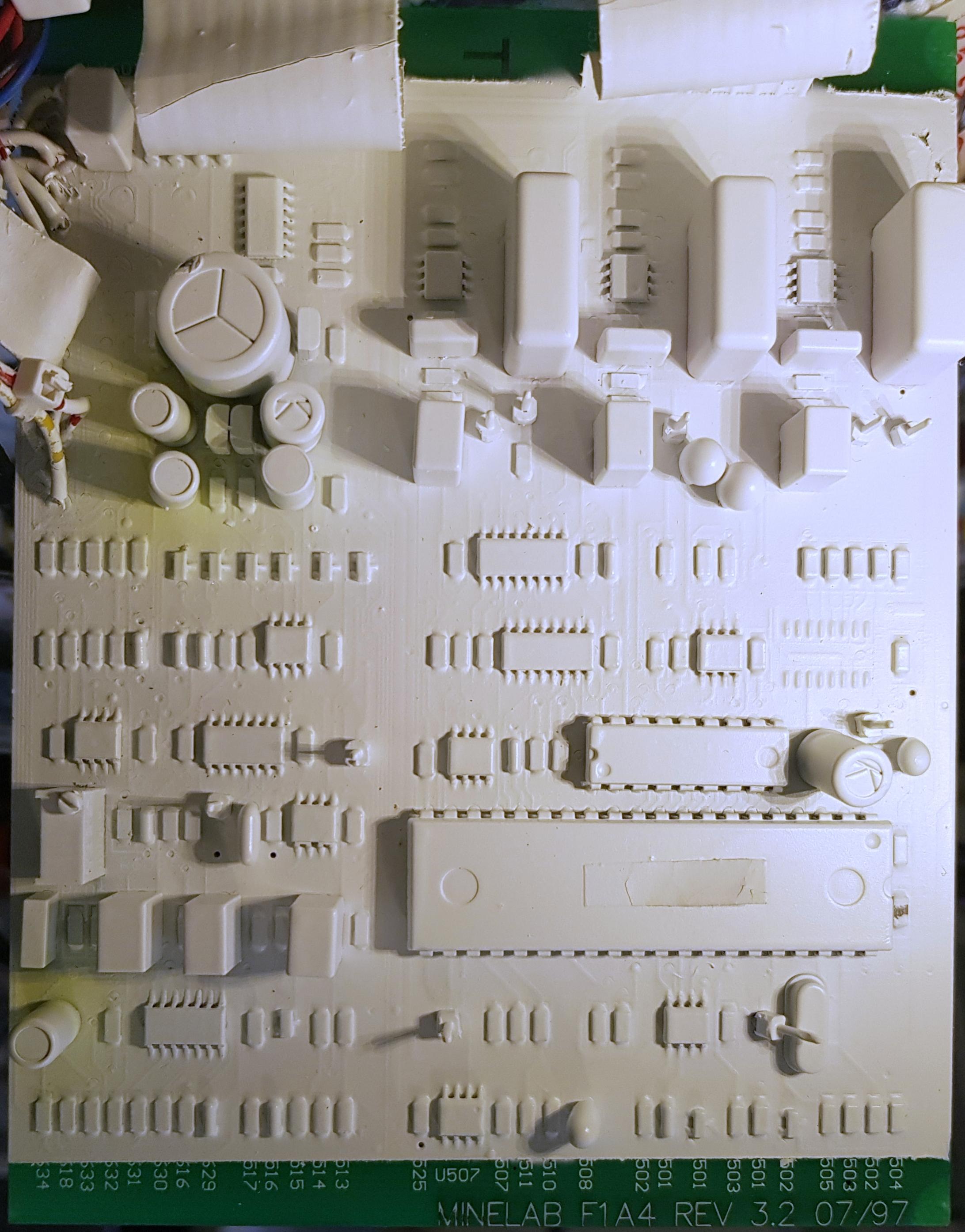

                  Post some pictures of the board. Is it closer to SD2200, or SD2100 perhaps.
                    Apparently these are indeed more closely related to the 2200, however the circuits do seem to follow some similar design principals to the pulse & frontend sections of the SD2000 circuit available here on GT - such as the use of blocking fets, dumping diodes, paralleled damping resistors, parallel fet pulse output etc. Of course there are a bunch of differences though. The issue here is that I just don't have a SD2200 circuit to follow
                    Images attached to this post somehow.. I'm a forum noob and don't know what I did there
                      Yes it looks very similar to SD2200. The lack of 4th channel is obvious.
                      TX section and timings look the same but somewhat less component count on what on the SD2200 can be seen.
                      If you're up to modifications maybe look into reading and modifying the EEPROM chip on board 1, but I guess that's a bit hard (modification).

                          Are you sure about the make of the large MCU on board 2? I would bet it's Motorola, similar to what they used on the Sovereigns (MC68HC705).
                          There isn't too much stuff you can do with it anyway.
